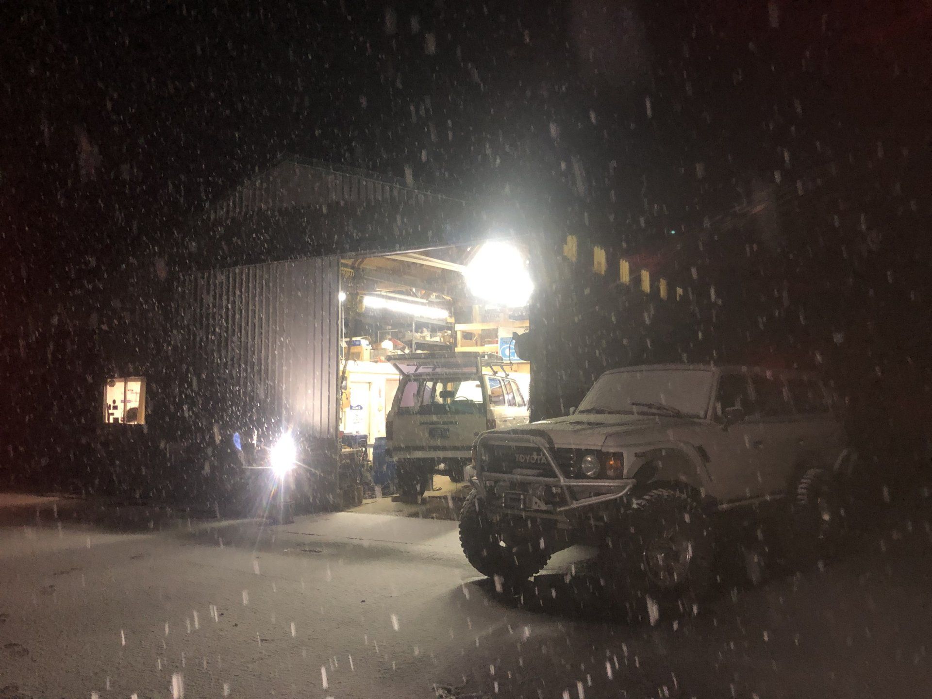

Looked out the shop door and it started dumping heavy snow.
1922877
Took the opportunity for some photos.
1922876
Got just over an inch and took Snowball out for a drive down the road and onto the highway and back to make some fresh tracks.

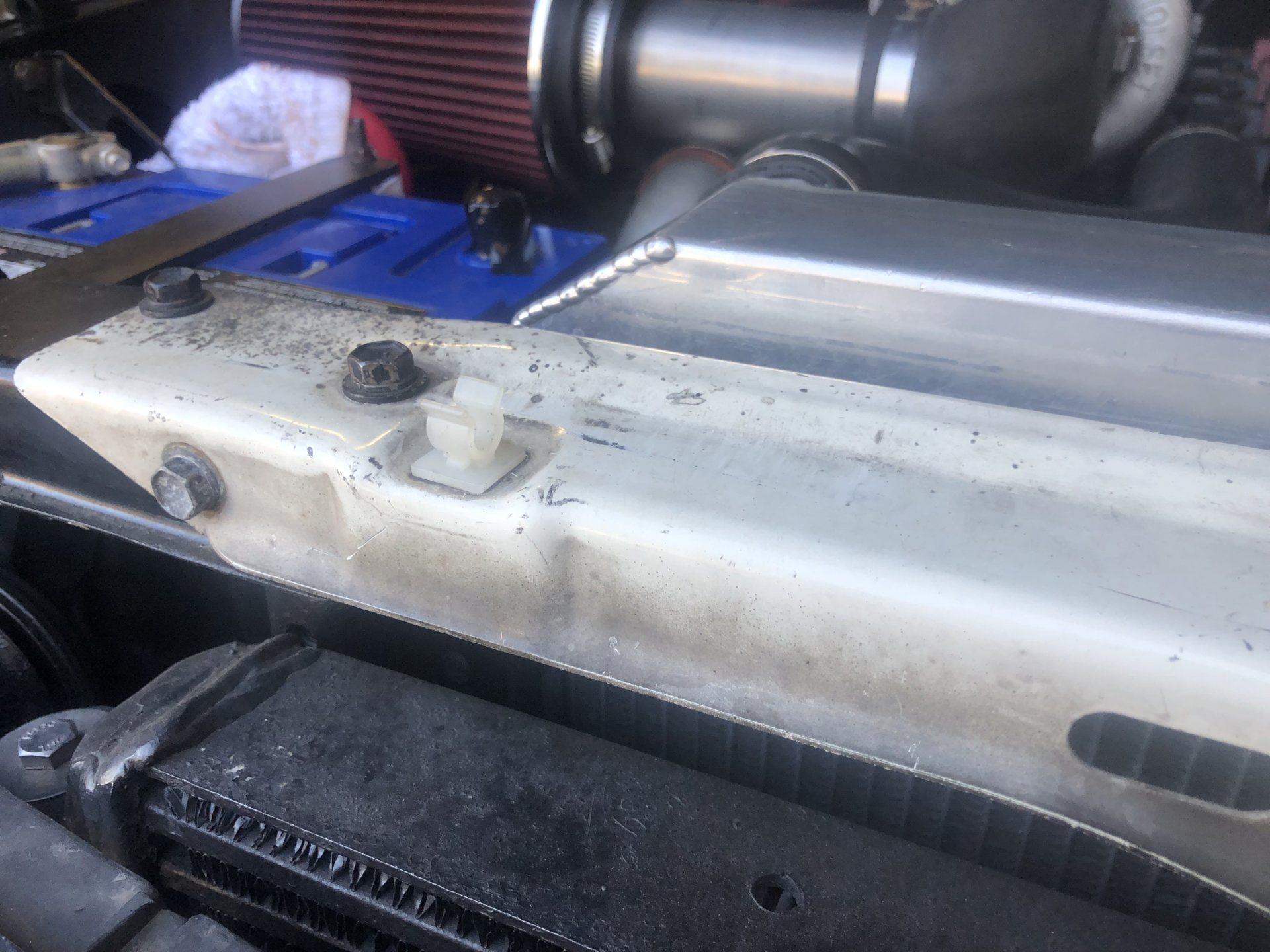

Installed the hood rod holder
1923350
And installed a rubber grommet for the hood rod support.
1923349
Knocking down the nitty gritty details. Be nice not to have my hood rod rattling.

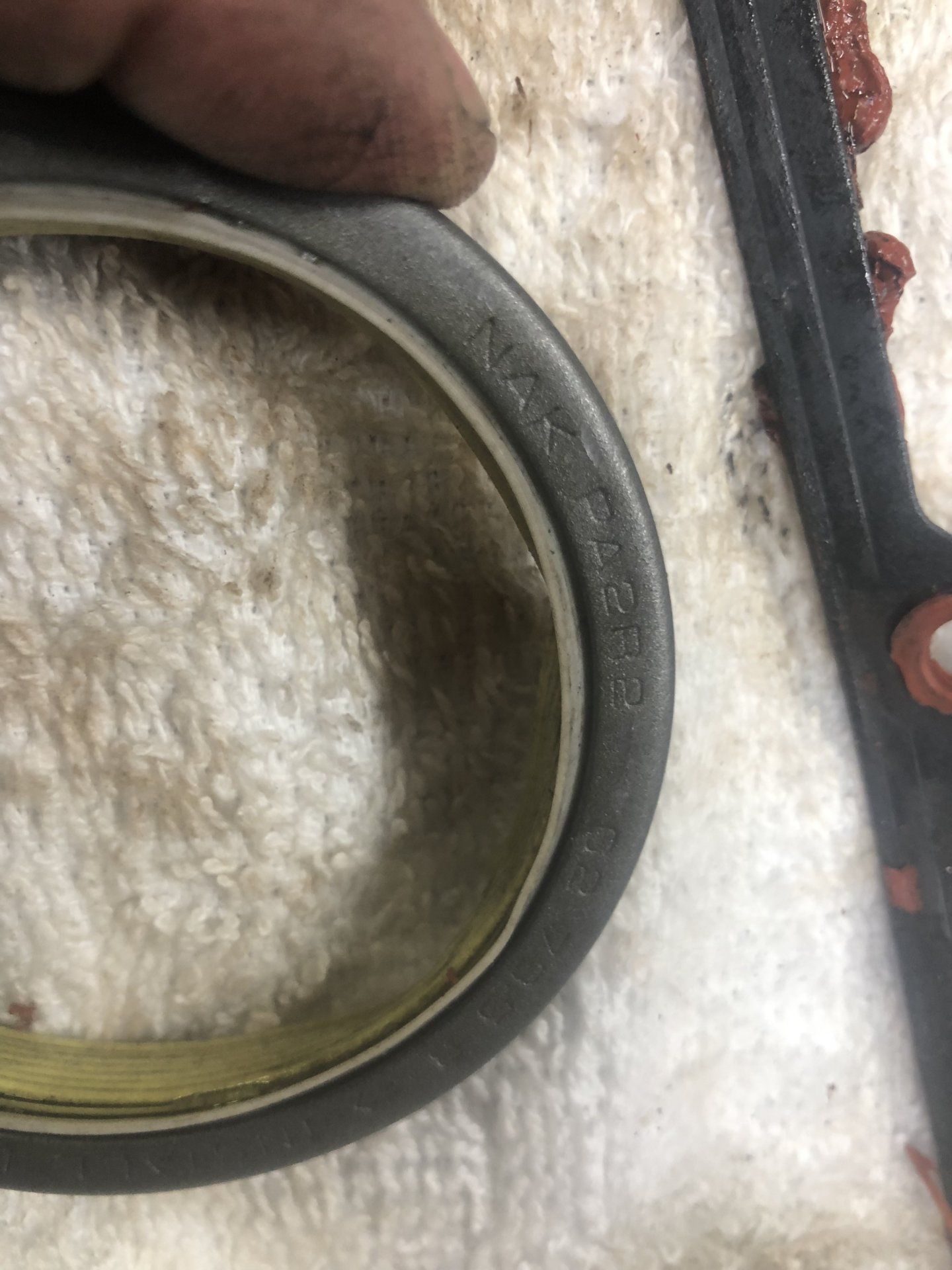

Removed the front timing cover to find a bad front main seal.
1923739

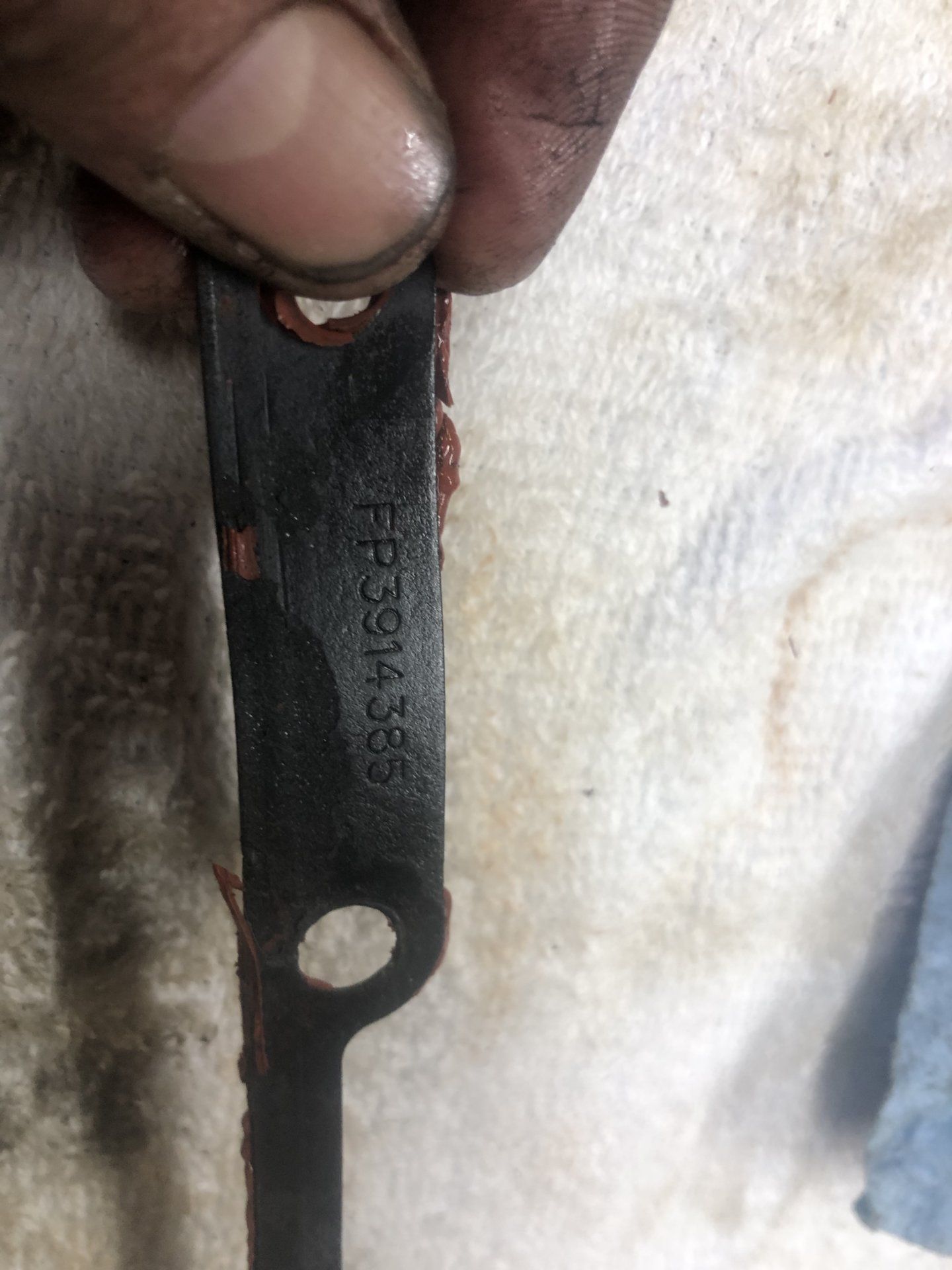

Got the timing cover gasket kit with front seal earlier this week and found it’s not the right size.:bang:
1923744
Part number off the timing cover gasket.
1923745
Front main seal
1923746

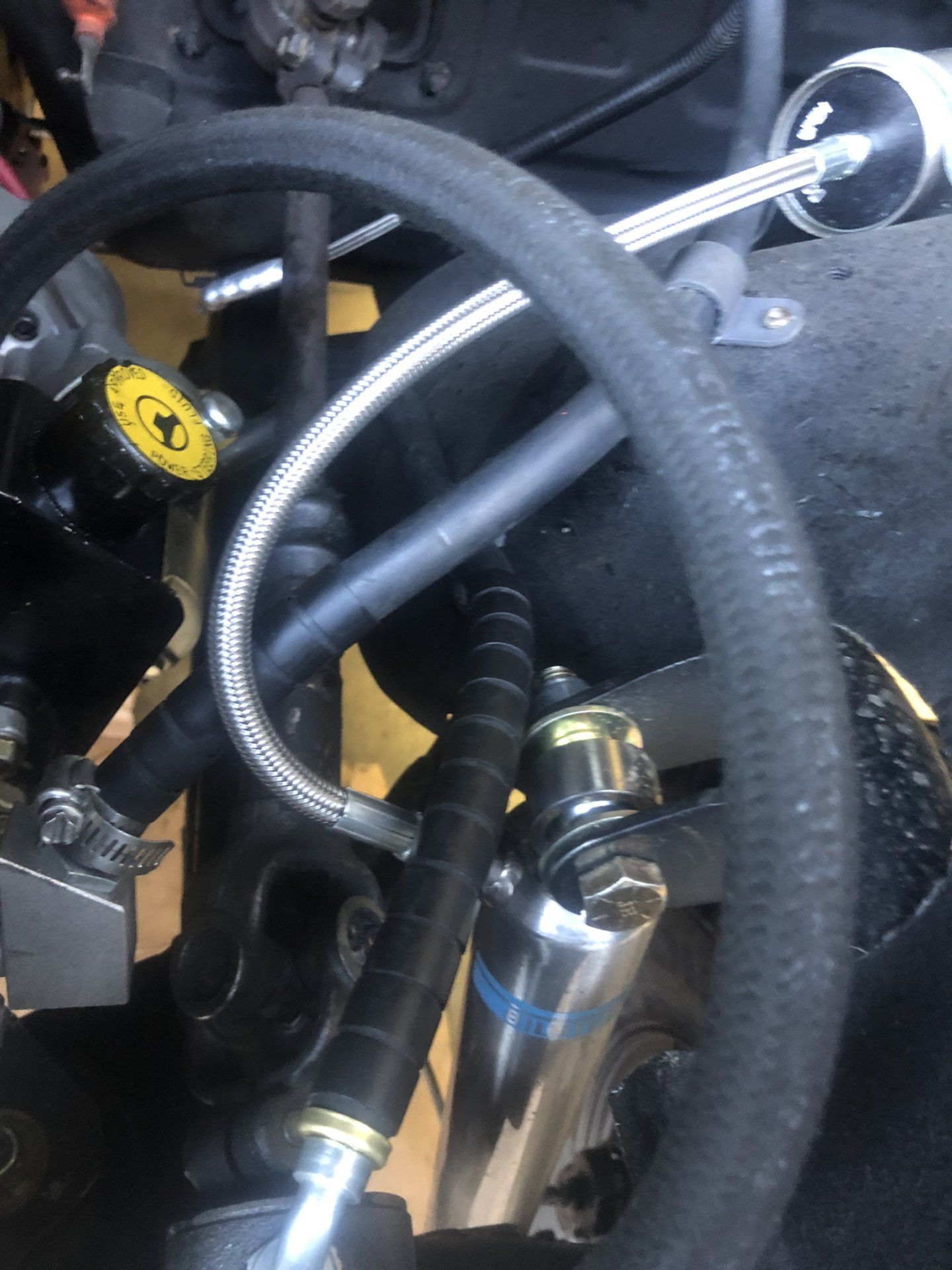

Also had time yesterday to clean up wiring and protect hoses in rub locations with this wire protection wrap.
1924018
1924019
So much cleaner than wiring nightmare of the 2F motor setup.
If you haven't done a front main seal on a cummins before here are some tips:
Use the metal driver ring included to pound on and set the seal depth in the gear cover. Leave the plastic inner collar in the seal and use it as a guide to slide the cover with seal onto the crankshaft, then pull out the plastic collar once the seal is on the crankshaft surface. Make sure the crankshaft surface is clean of all oil and dry when installing. The main seal should not be lubricated for install, it goes on dry.
Seeing the folded lip on the seal you pulled out I bet that plastic collar probably wasn't used to keep the seal expanded to go over the crankshaft surface which is probably why it folded.
