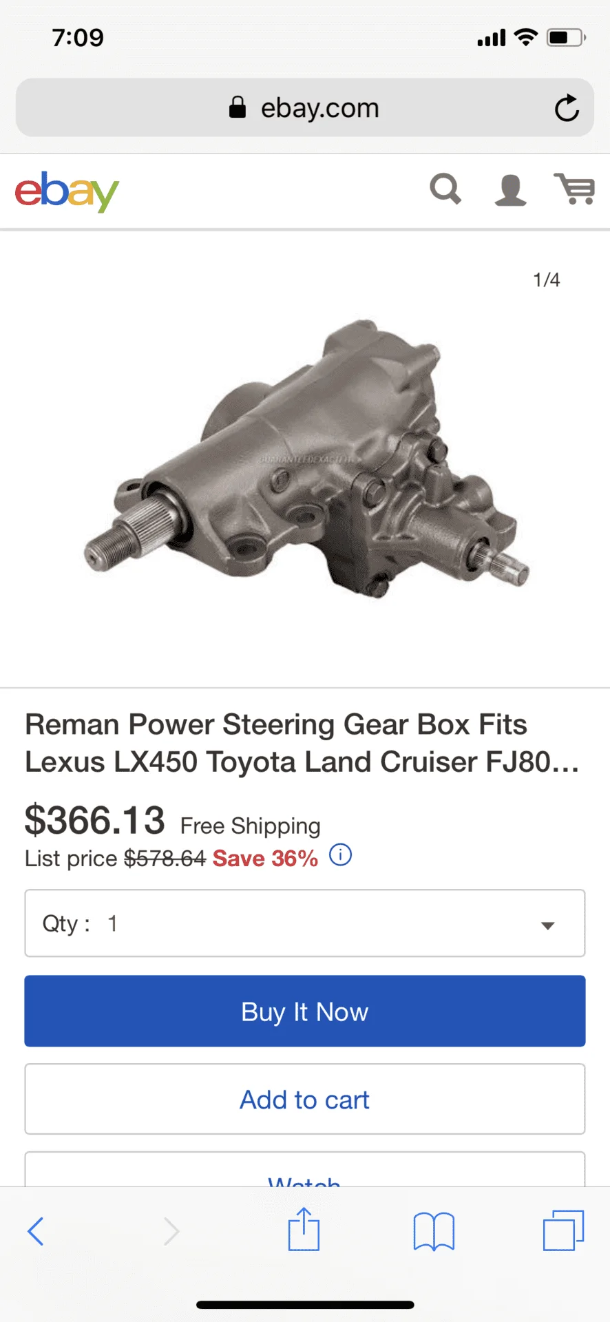

That steering box will work, and an 80 TRE will work with the 80 box obviously, but it won’t fit into the 60 passenger side TRE. The tapers are different.

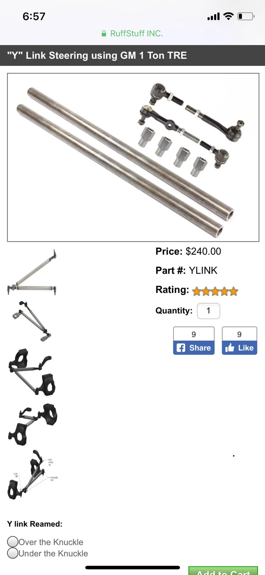

$150 is a lot for two TREs.. Like I said, it may just be more straight forwards to convert everything to the GM 1-ton ends with the Ruffstuff kit.
Trying to get this all figured out. This must be the kit your talking about. This would work with the 80s PS gearbox?
They don’t just fit, no.
You would have to change the taper in the pitman arm and steering arms. Theres a specific GM reamer out there for this.

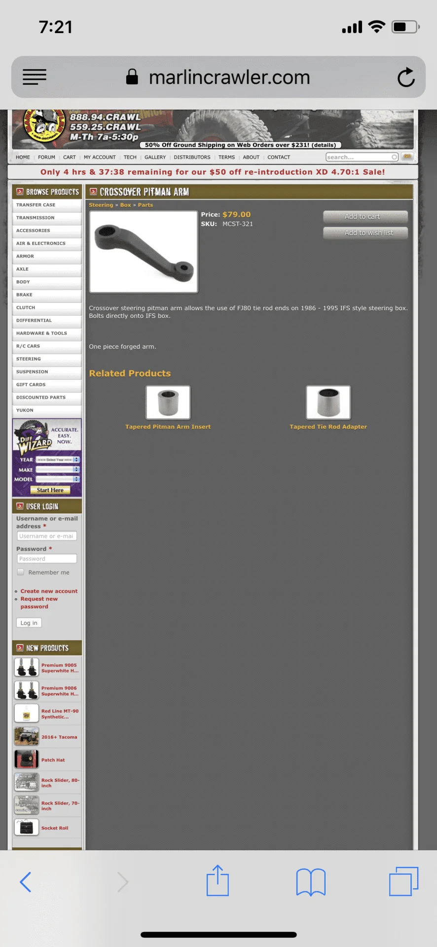

Hojack, wait a minute. You're going to put this 80 box on before or after you go SOA?

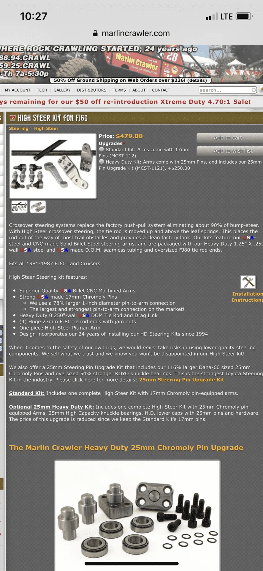

What TREs does Marlin Crawler use in their high steer arms?
That's the answer I was hoping you'd come up with. Forget all the one ton tie rod stuff, reamers and whatnot, it's not necessary. Buy the Marlin (or whomever) high steer setup with steering links for a FJ60. It will most likely, if not certainly, come with FJ80 tie rods. When you put the FJ80 steering box on your truck, with the stock pitman arm, everything will just bolt together.
Nope. Put that idea right in the dumpster. Too much to chew off.
Yeah there’s no high pinion third member that bolts into a 60 housing.
And do what @GLTHFJ60 said with the FJ80 ends. I didn’t realize the Marlin steering arms were setup for crossover steering.

I was going to order the Marlin Crawler FJ60 highsteer Kit.

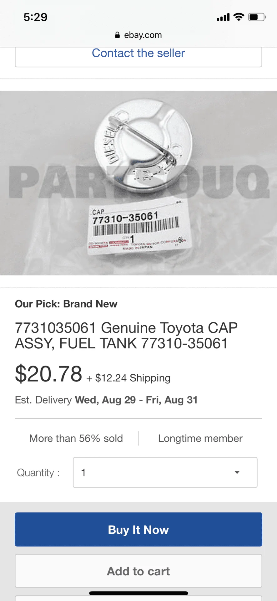

Looking at a diesel stamped fuel cap. Think it’d be a good idea or I could just by a sticker for inside on fuel door.
