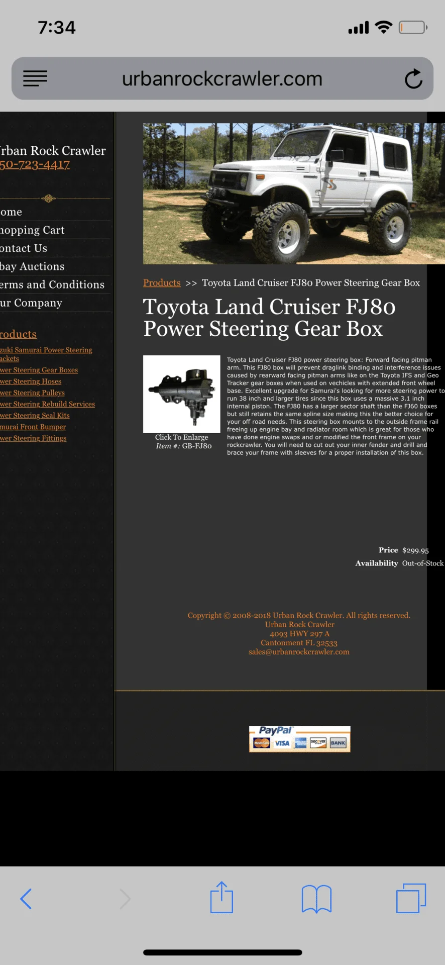

I posted a wanted on the classifieds. I found this company and they are in your state. $299 but they are sold out.

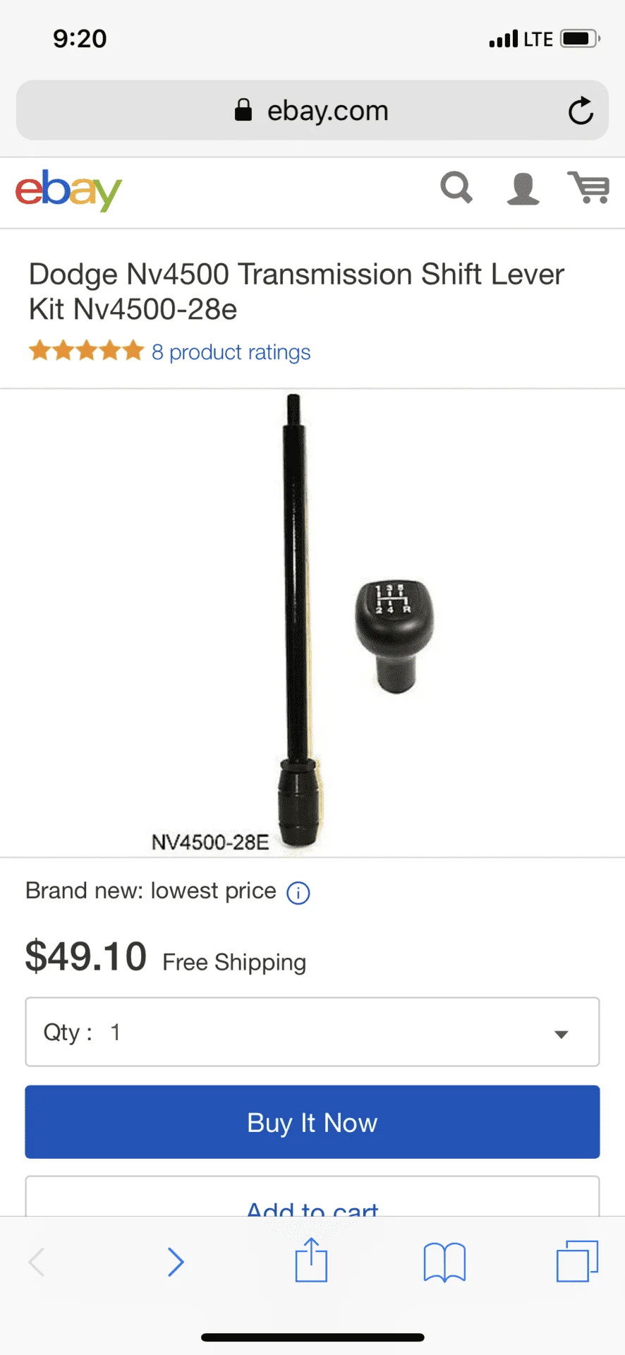

Ordered the 0 degree Ruff Stuff SOA kit yesterday and got 10% off thanks to Morgan. Ordered new NV4500 5 speed stick shifter this morning. That sure is exciting.
The degree kit you order doesn’t really matter in my opinion, the only difference is that plate that goes under the passenger side perch and I am not a fan of it. I didn’t use it in my conversion and slowed me to drop that spring perch 1/4-1/2” on the axle tube. If you want to use it you have to grind the hell out of it for it to fit.
