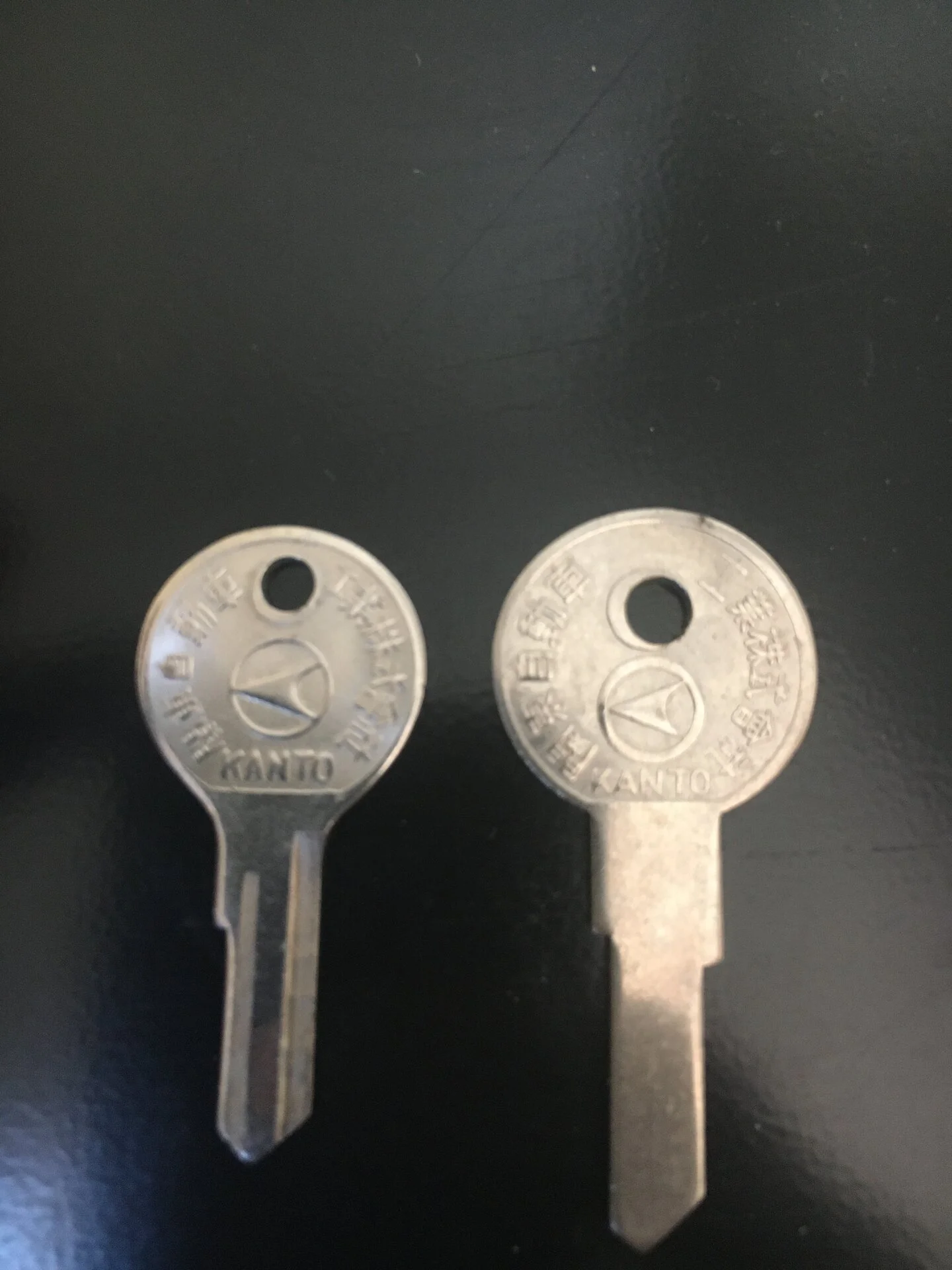

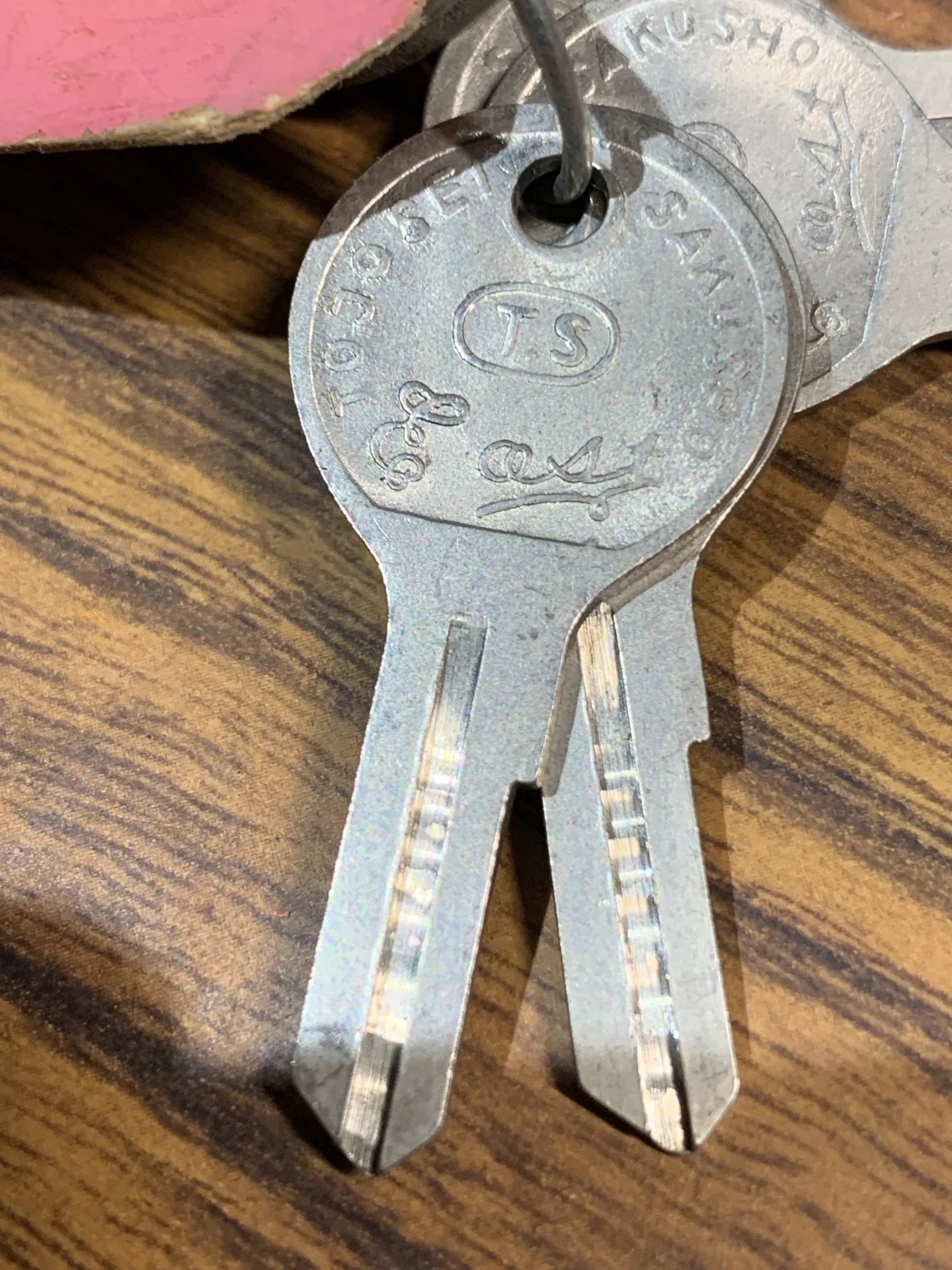

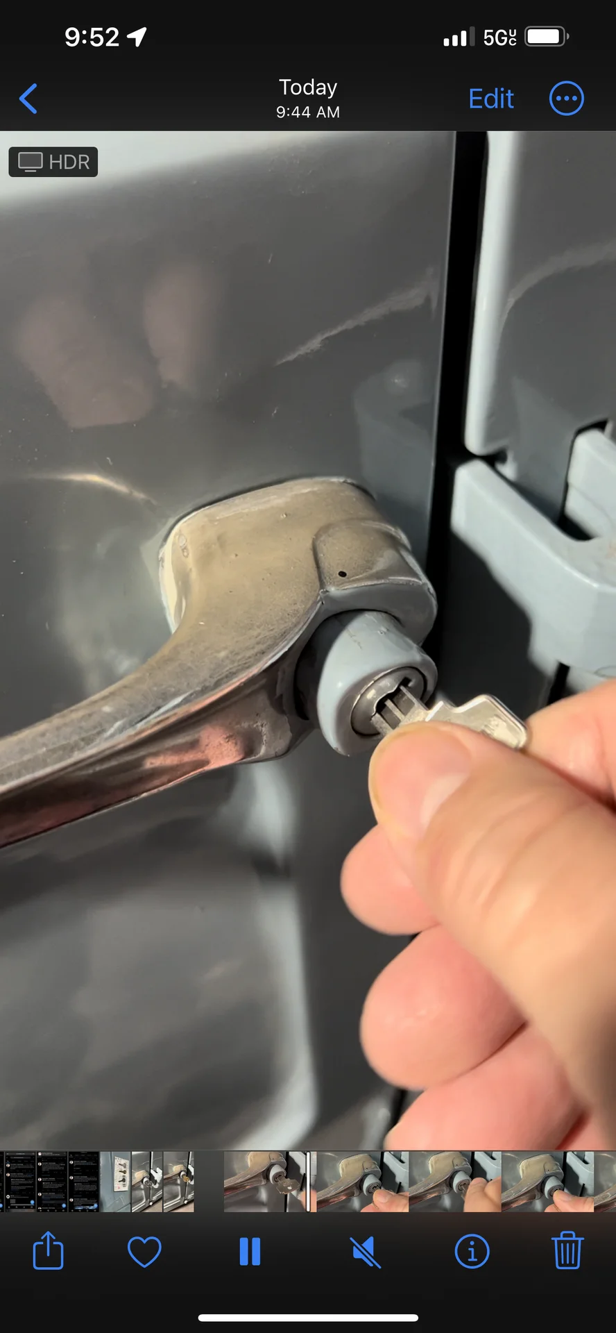

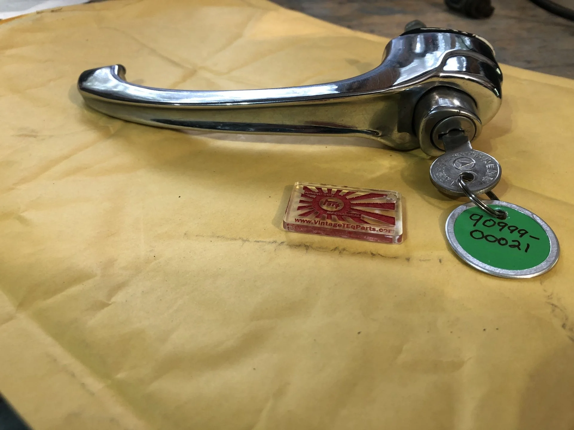

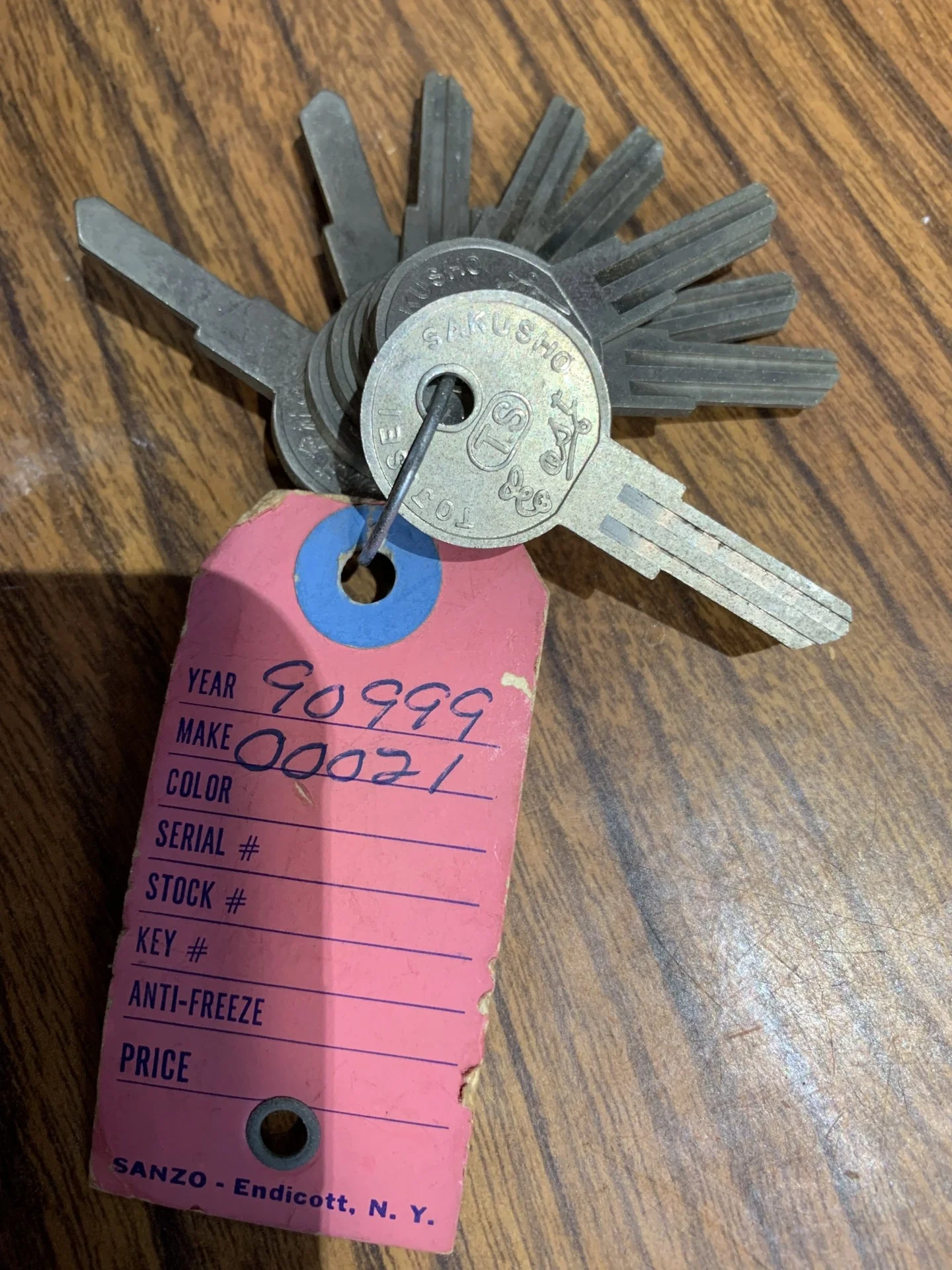

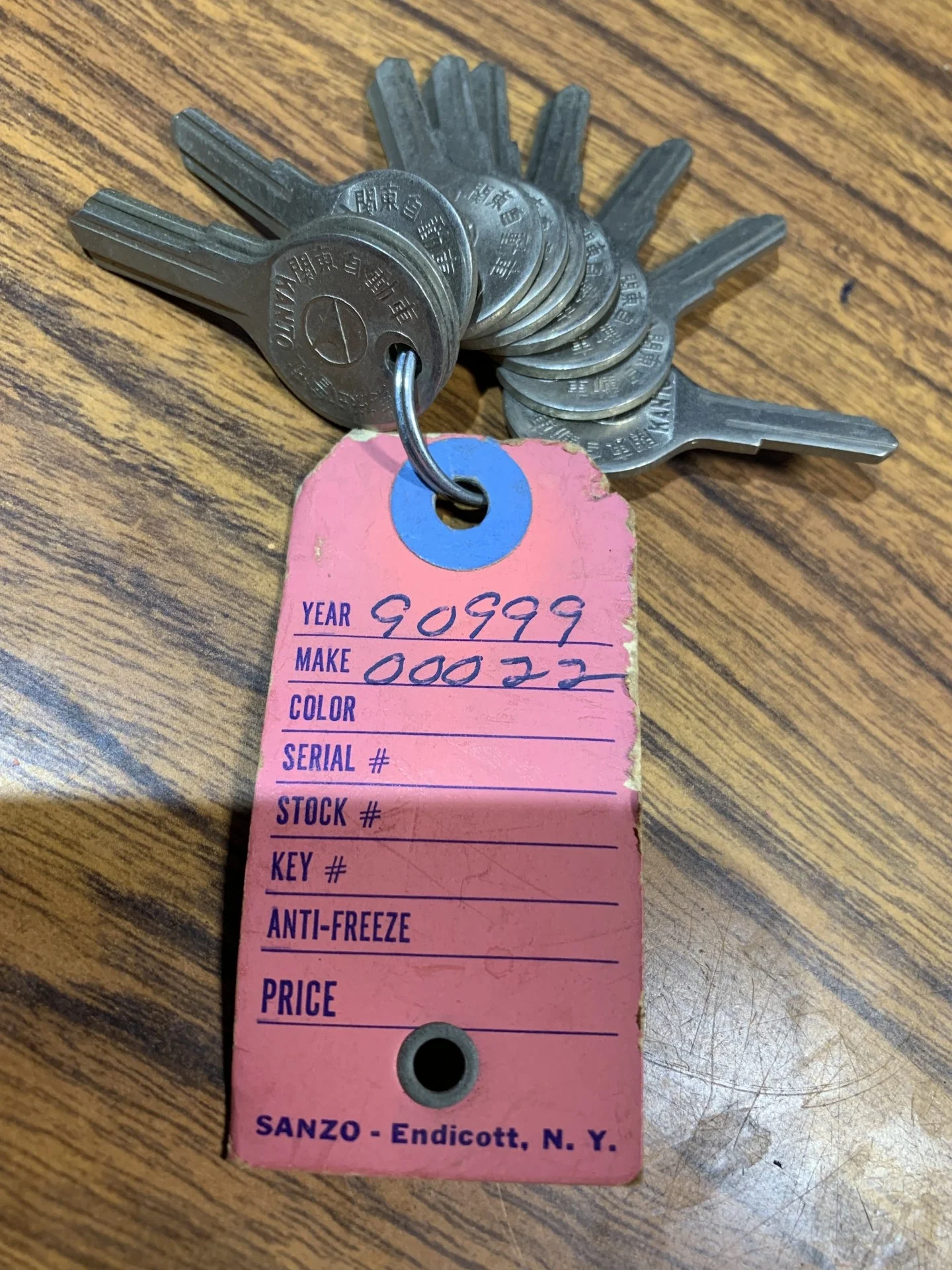

I have been experimenting with several different key blanks that would work on the LV since those blanks are NLA. The KANTO key blanks are completely different from the TOYOTA 1000-6000 series key blanks. I’m lucky to have an original KANTO LV uncut set (door, ignition) to base the blanks off of. I don’t currently own a LV but sent 3 key blanks I think will work to Jim aka @gonzopancho who has 2x LV’s. The pics are ones he sent me. Thank you Jim for your help!

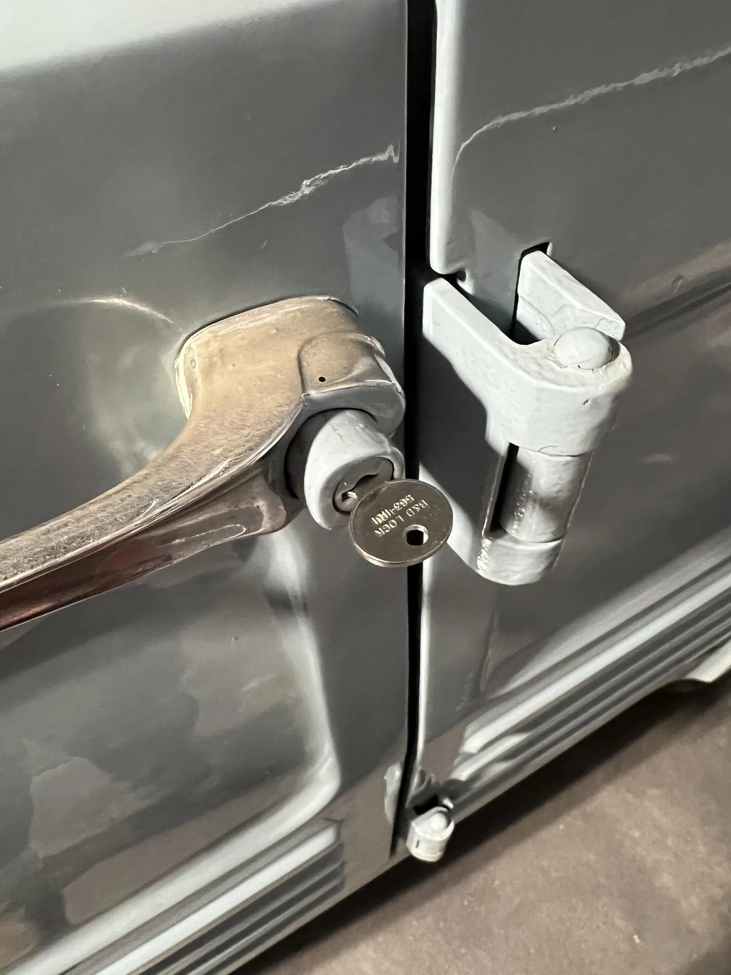

ILCO K1122D BN1 (was used pic 3 & 4) or Curtis BN1 or SILCA BN1 works for the door lock and the key blank turns in the lock as can be seen in the pics.
ILCO 62DH or SILCA UNI 1 (pic 2) goes in the door lock but doesn’t turn it. We’ll do some more investigating and report back.

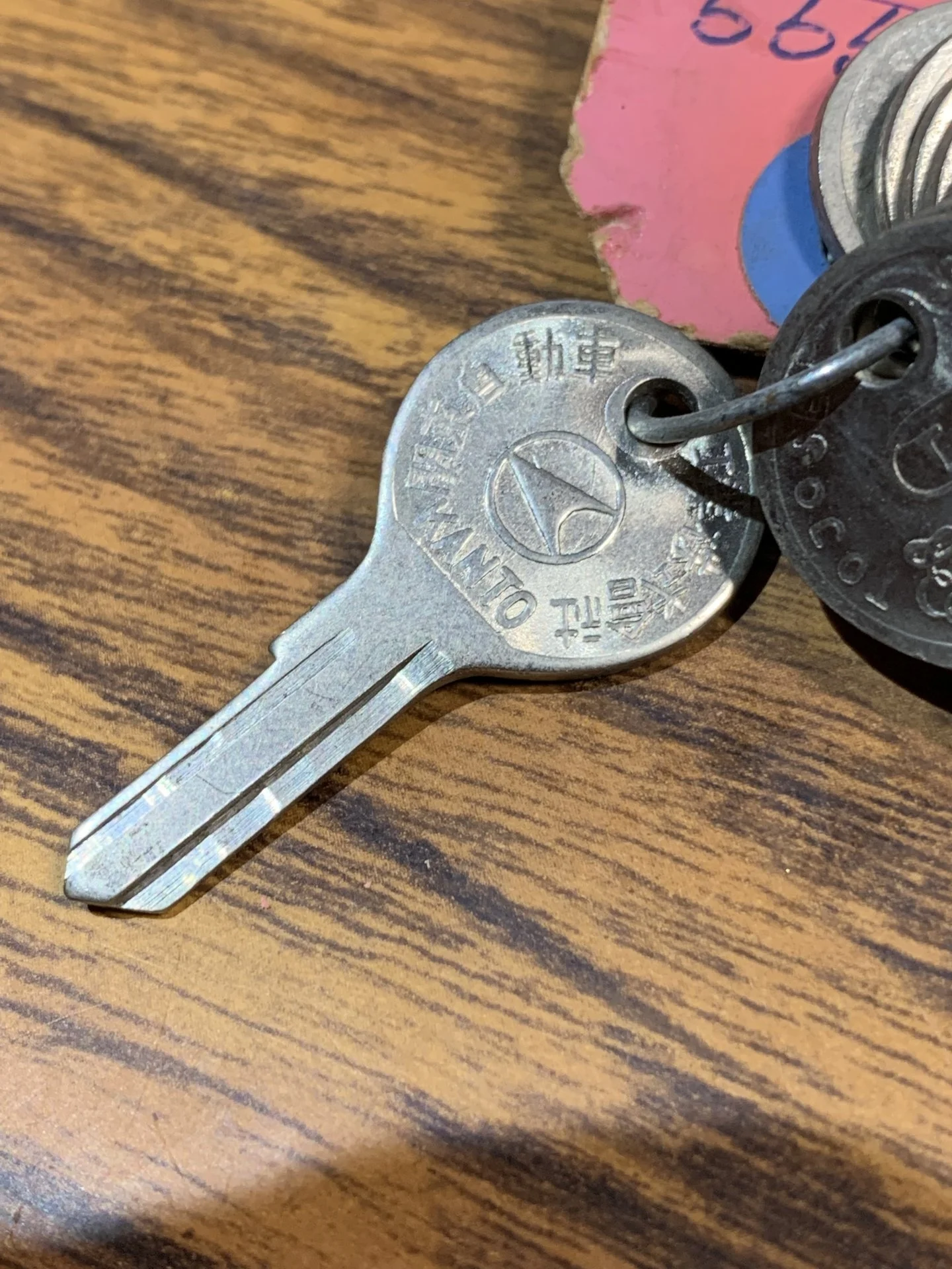

Please take a picture of the key blanks and post here!
I can confirm which key is which when my LV is back from spa treatment in a couple weeks. I think the gold one was door lock, smaller silver was the gas door and big key in the first two pics is ignition.

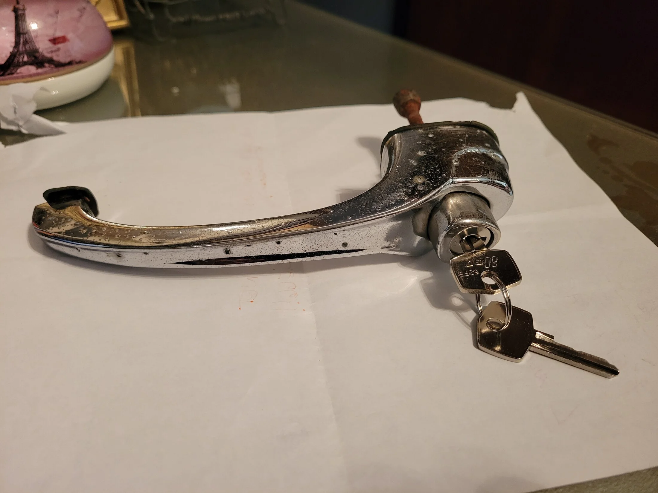

I was able to source a driver door handle in pretty good shape---NO KEY...but I went to the local locksmith in Folsom and they cut me a key. He said generally speaking, the early style door locks used simple key cuts. This simple key he cut seems to work fine....locks and unlocks with a simple 180 degree turn.
