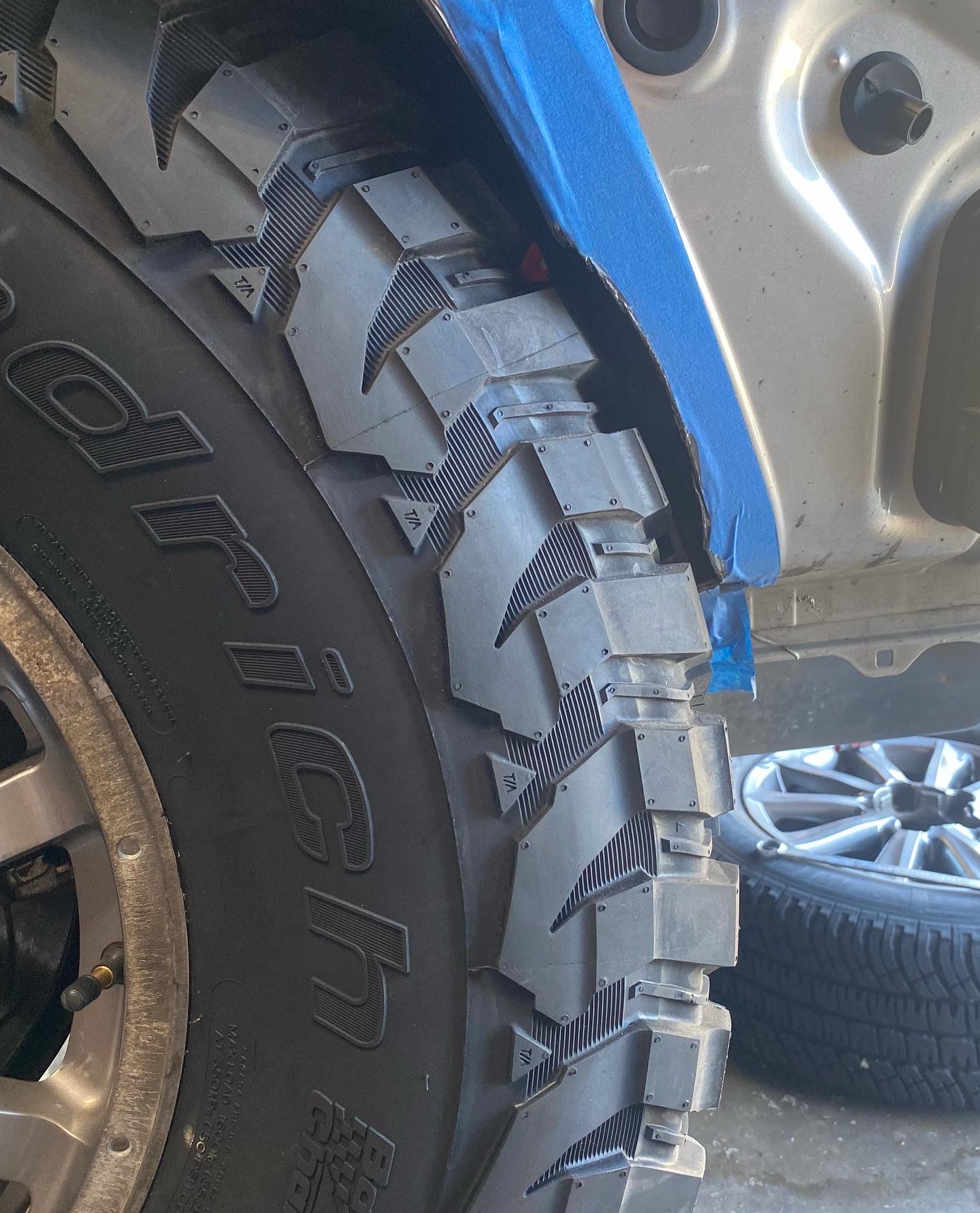

Here’s a shot of mine as I was cutting.

Very nice! Was this to clear the rear without extending the wheelbase?
Nope I actually had tons of room (relatively speaking) at the door. This was to clear at full bump. Was binding on both pinch welds in the rear
Makes sense as the tires get pushed aft with the sagitta of the trailing links. Even with 35s, I'm into the stock rear tupperware at the spot, especially when the other side is articulated downwards. Extending the wheelbase by an 1" would require this cut to be that much more aggressive.

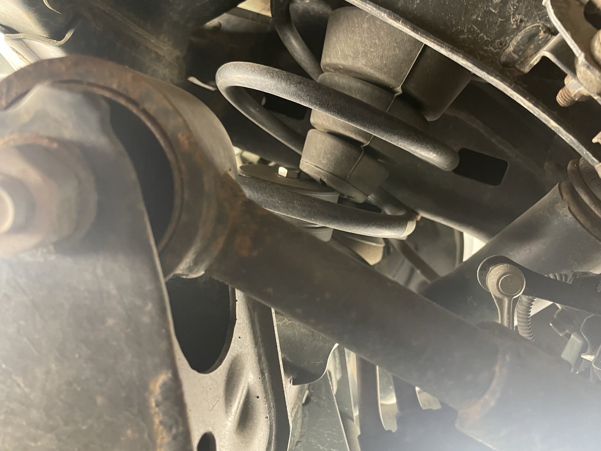

Check out the state of the rear bar too:

The gap between the jam nut and bar, and the rust seemingly weeping out of the threads makes me suspect that jam nut is loose... Maybe?
Yes, it was definitely loose and I had neglected my typical OCD on the truck since Ive moved but its tight now.
Just also busy atm and not really focused on mods/upgrades.
Pretty sure the rust was the culprit but who knows. It is going to be warrantied along with the arms and then my bar relo bracket will go in.
