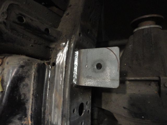

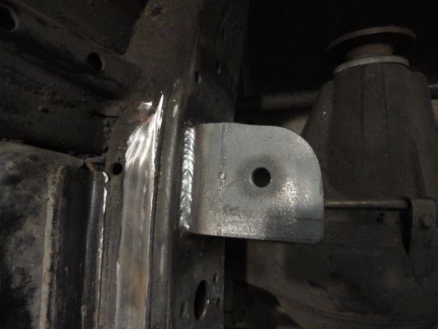

...finish welding and shaping the engine mount.
Love the attention to detail, great work!
Looks like there was a little rust hiding under the paint on the drivers side frame rail
Misspellings courtesy of autocorrect from my iPad using IH8MUD Forum
We'll be cleaning that up and painting it for sure while the drivetrain is out.

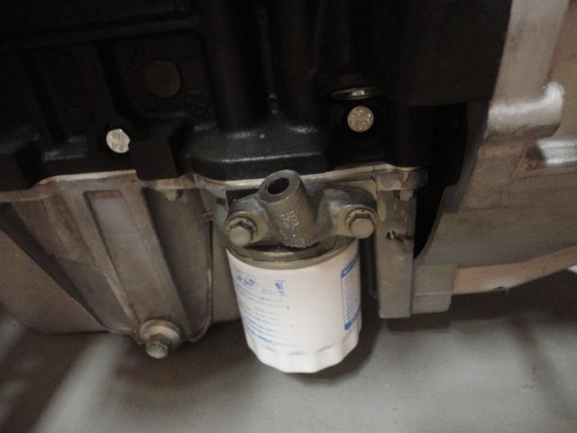

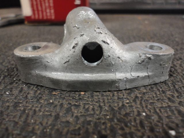

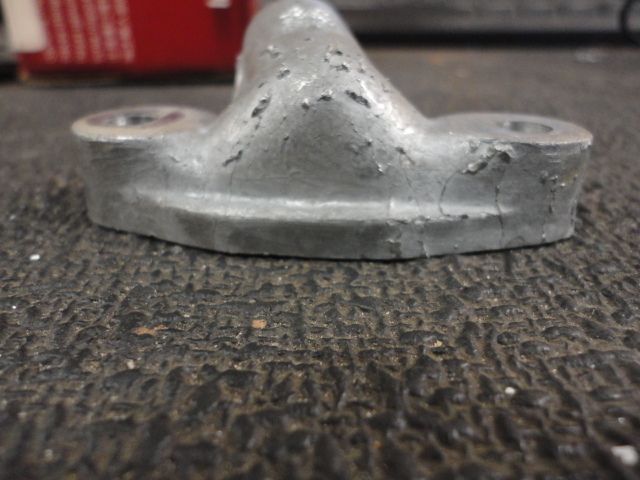

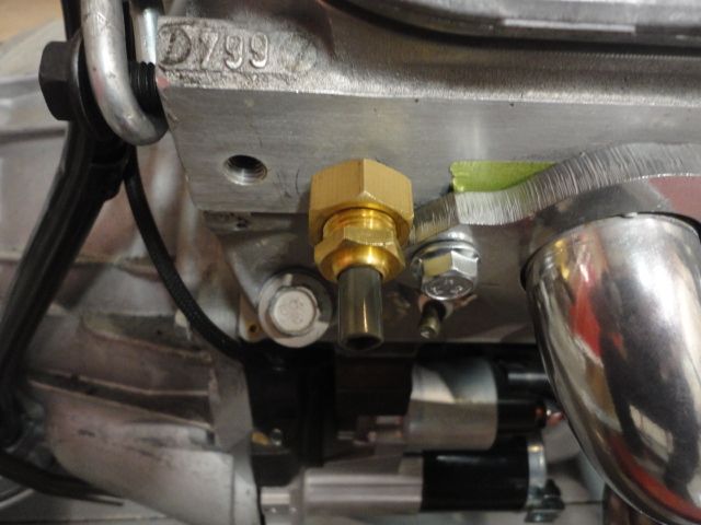

This convenient outlet for an oil pressure sender is just a tiny bit too large to be tapped for the 1FZ sending unit.

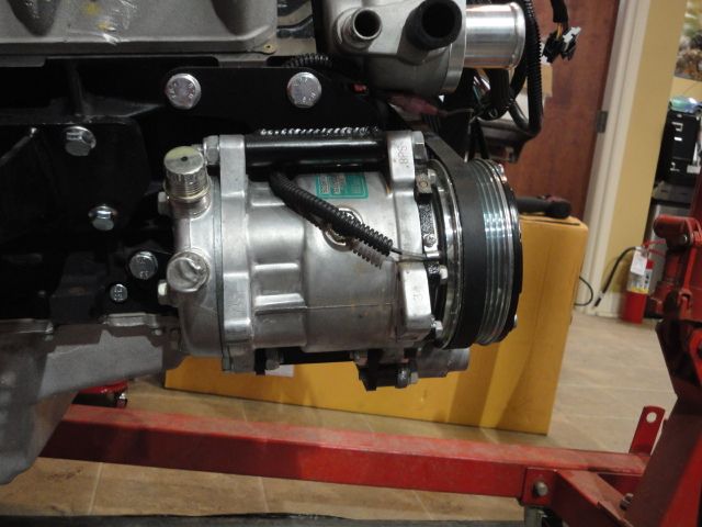

Here are some detailed pictures of the A/C bracket(by request). This is a bracket that comes with the Turnkey engine package. It's not something we built.

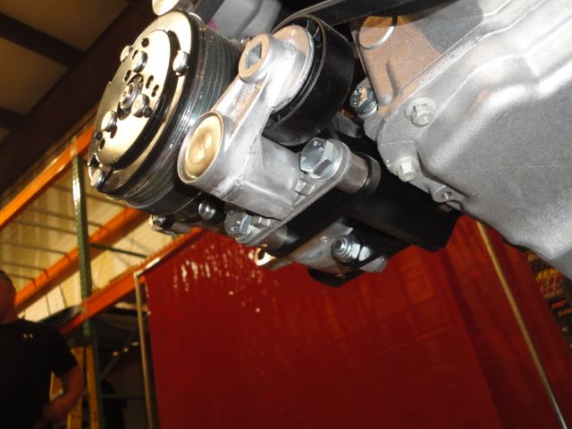

The engine cover on the left hand side is a little tight to the power steering pump cap.
A little bit of trimming keeps things looking clean and it makes removing the cap to check or add fluid much easier.
