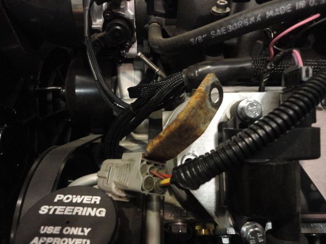

...more wiring cleanup to make everything look as 'factory' as possible.

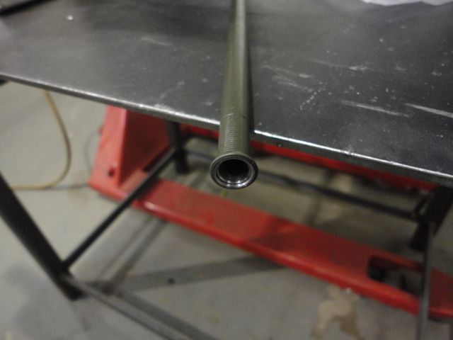

Wow, nice tubing work! I usually end up with a pile of practice bends laying all over my shop.
Thanks! Practice bends are important, but the little Robinair tubing bender we've got helps too. It's way nicer and easier to use than what's found in most parts stores. It's cheap too! It's under $30 from most online places, Amazon included.

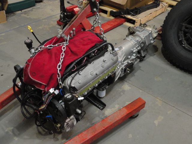

Did you cut the rear output shaft on the trans, or did you replace it?
If you cut it, can you explain how you did it?
Getting ready to do the task, and trying to avoid opening up the trans!
We cut the shaft. If you are starting with a 2wd 4l60 all you have to do is cut the existing shaft. If you have a 4wd 4l60 you will have to replace the rear output shaft which requires taking most of the transmission apart.
4.5" angle grinder with a cut off wheel. Just plug the rear of the trans to keep debris out. The cut is pretty forgiving, it doesn't have to be perfectly square. The cut is more important on location.
