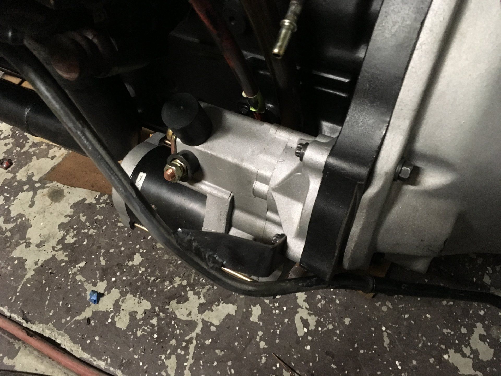

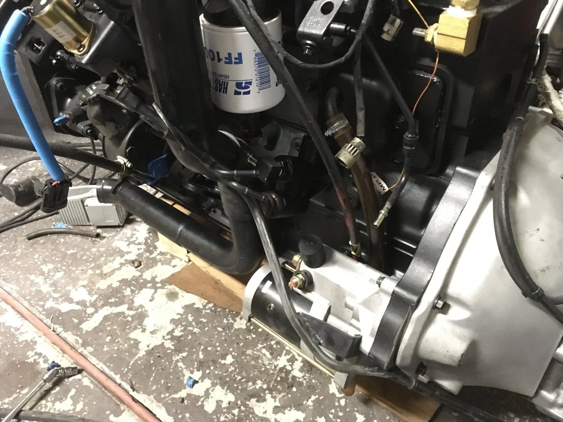

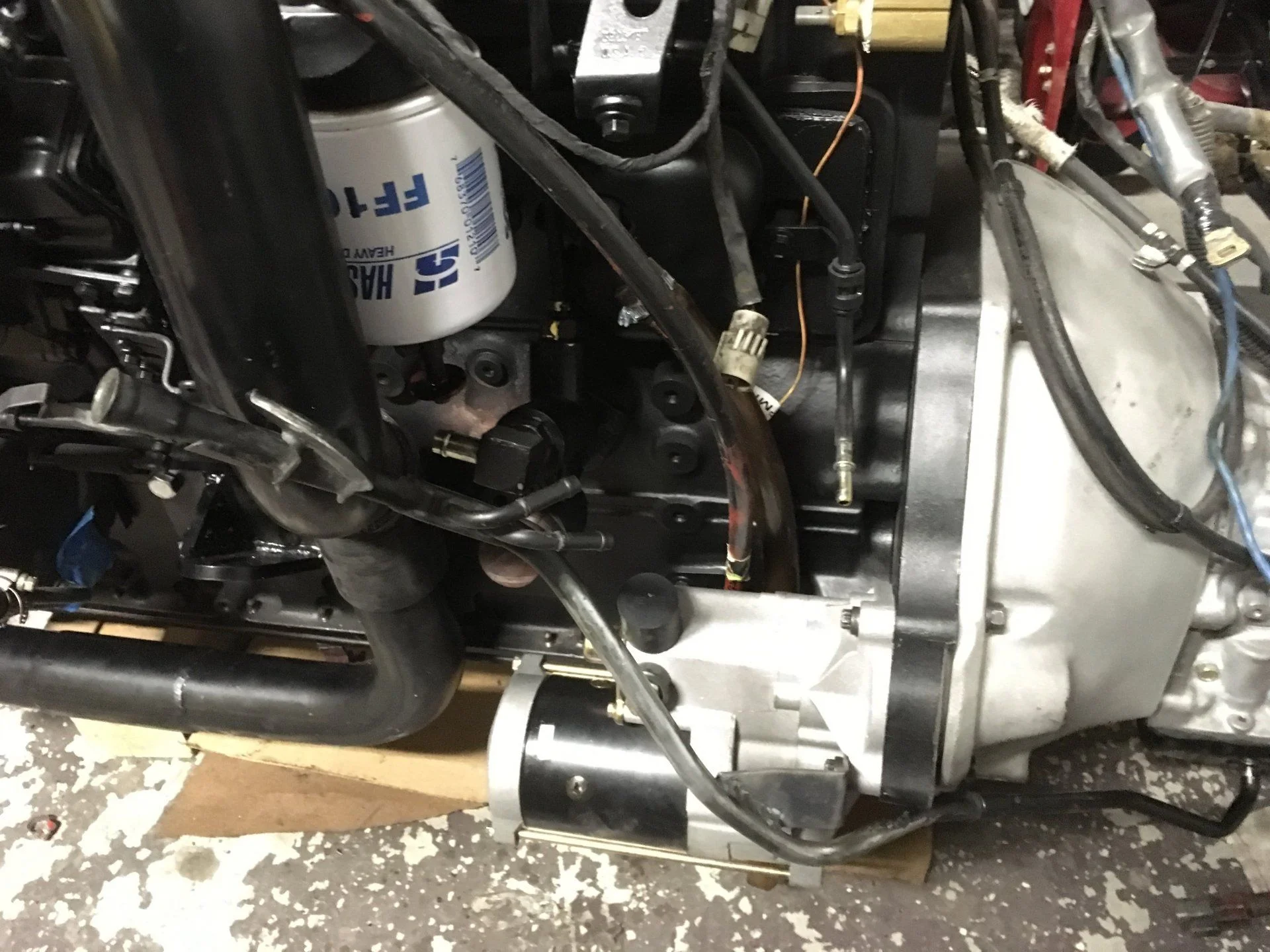

I cut off the factory bracket on the tranny dip stick tube, and fabricated a new bracket that uses the starter bolt. I bolted up the engine mount, and intercooler tubing so I could get it as close a possible. I plan to bend the top tab over and find a rubber cushion clamp that will fit on the intercooler down tube for the top attachment point, not really needed, just want to make sure they do not rub together. Just need to spay some paint on it.
Careful of your frame to starter clearance there not sure how much room you will have with that starter placement. I know which mine it's tight but I have a 2nd Gen starter and flywheel plate. Looking at yours though that Dip stick tube will be close.
It looks a little deceiving from the pictures, I think it will be okay. I also moved the brake lines that run along the side of the frame up to the top of the frame to make room for the starter.
According to the diesel adapter instructions you have to bolt the starter up after you put the engine in, and it should fit as long as you move those brake lines. Hopefully the dip stick tube will work out, but I guess I will have to see how it goes and deal with it later if it needs some adjustment.
