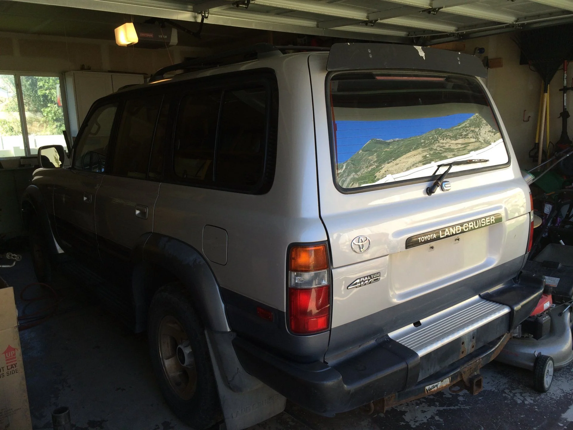

Thought I would start a thread for my build. I am doing a Cummins 6BT swap into my 1995 FZJ80 using the duiser conversion kit. Also doing a 3" suspension lift(using a combination of OME, slee components) with heavier springs to deal with the extra weight, an ARB bumper up front, and BFG LT315/75R16, All-Terrain T/A KO2 tires. Once it is up and running I plan on doing the 4x4 labs rear bumper with swing-out spare, warn winch up front, and custom rock sliders.
Here is the 95' FZJ80, I bought it with a blown engine, with the intent of doing the 6bt swap. It is in really good shape, and has the factory front and rear lockers. Needs a little love cosmetically but for the most part is in really good shape. Didn't think about taking a picture until I already had it pushed into the garage, so this is the best view you get I guess.

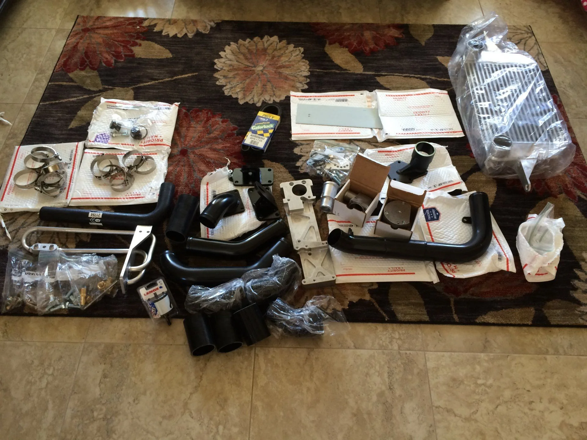

Accessory adapter installed and all the accessories installed. Didn't take any pictures, but the fan pulley housing was swapped with the one provided in the kit to relocate the fan, and I put a new bearing it while it was out. Also have the intake tube installed.
Installed the elbow with the heater hose outlet and the coolant temp sender.
Also installed the A/C cutout switch
