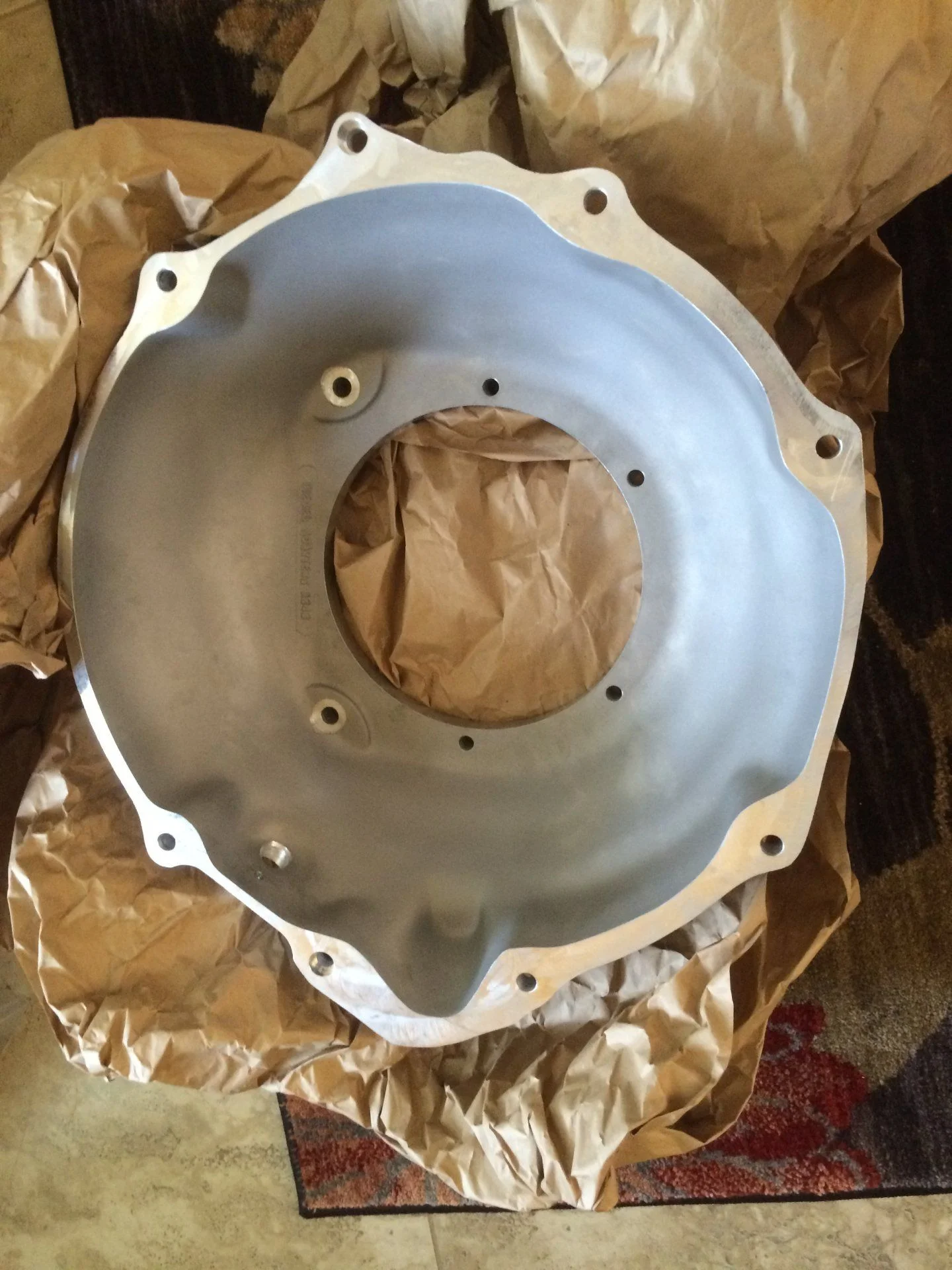

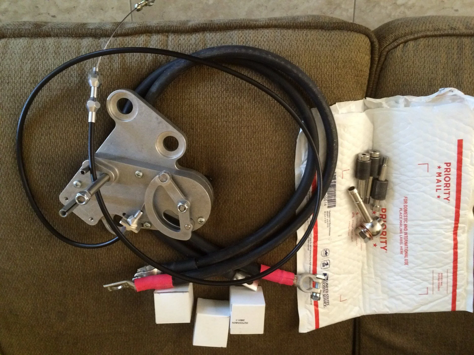

I am still waiting on the bell housing, all the throttle stuff, my harness, and a few other things. I ordered mine a little over a month ago.
