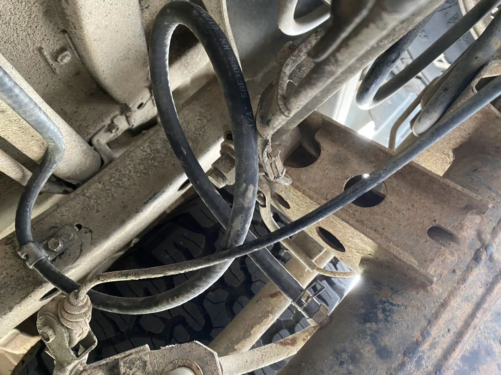

Little bits here and there getting done. I still have a mountain of parts to get through but that’s scheduled for May. In the meantime, I tried extending my breathers and was successful for the front and rear diff. As for the t-case and tranny? Yeah not so much. I had a helluva time finding them. I found numerous threads with some subjective photos that didn’t help me much and since I was in doubt, I shelved that plan for now. Here are some terrible pics for you without any frame of reference whatsoever.

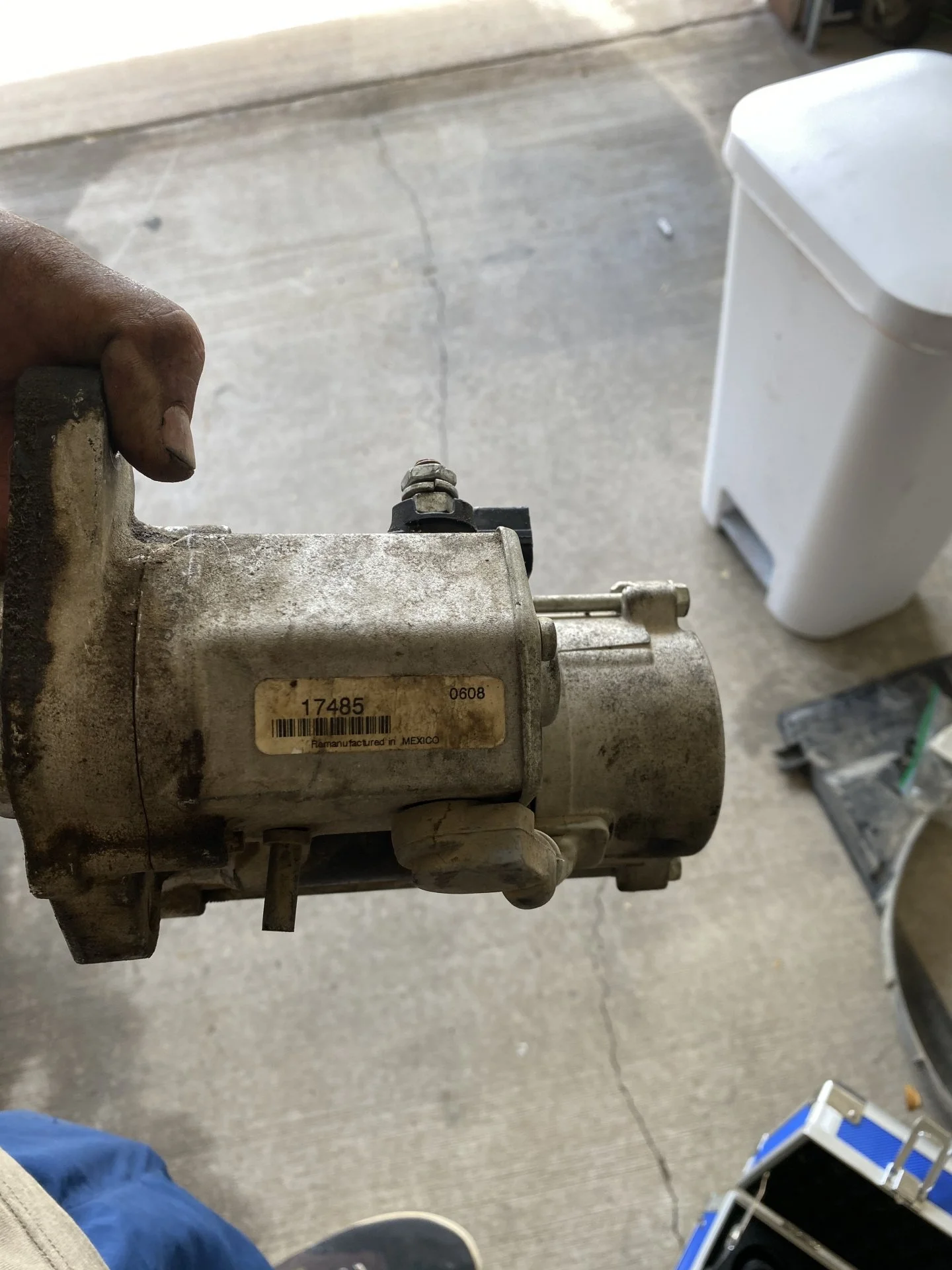

Before beginning the PHH, out came the Chinese fuel filter and Mexican starter (unlike some people, I’m not confused as to where mine was made and if I can flip it to offset my costs…it’s going in the trash).

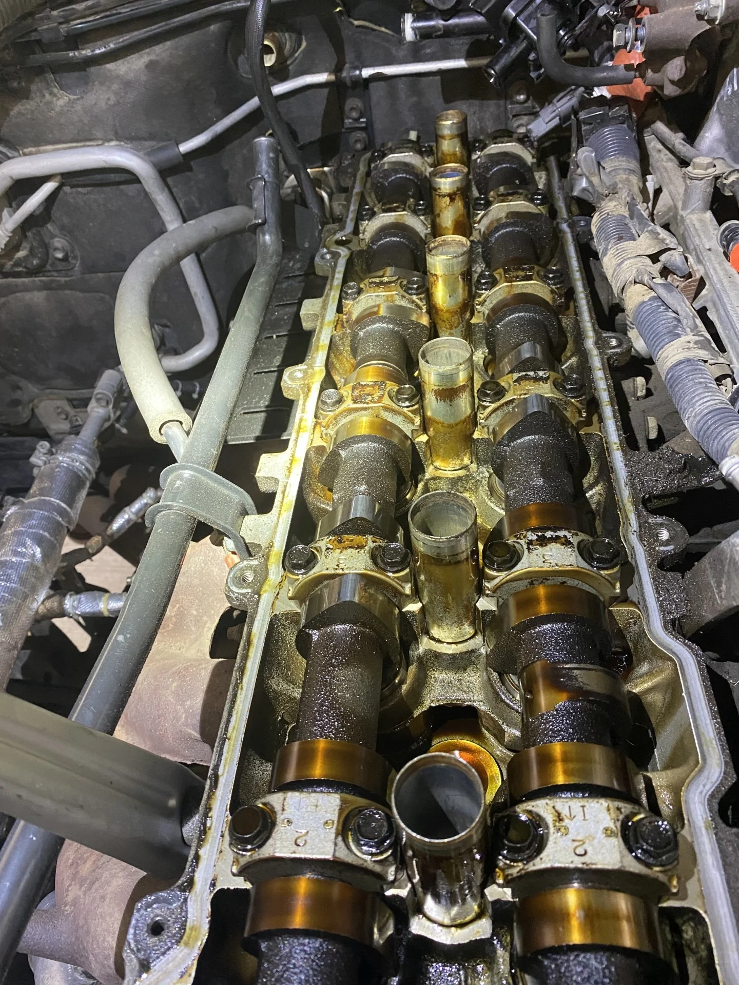

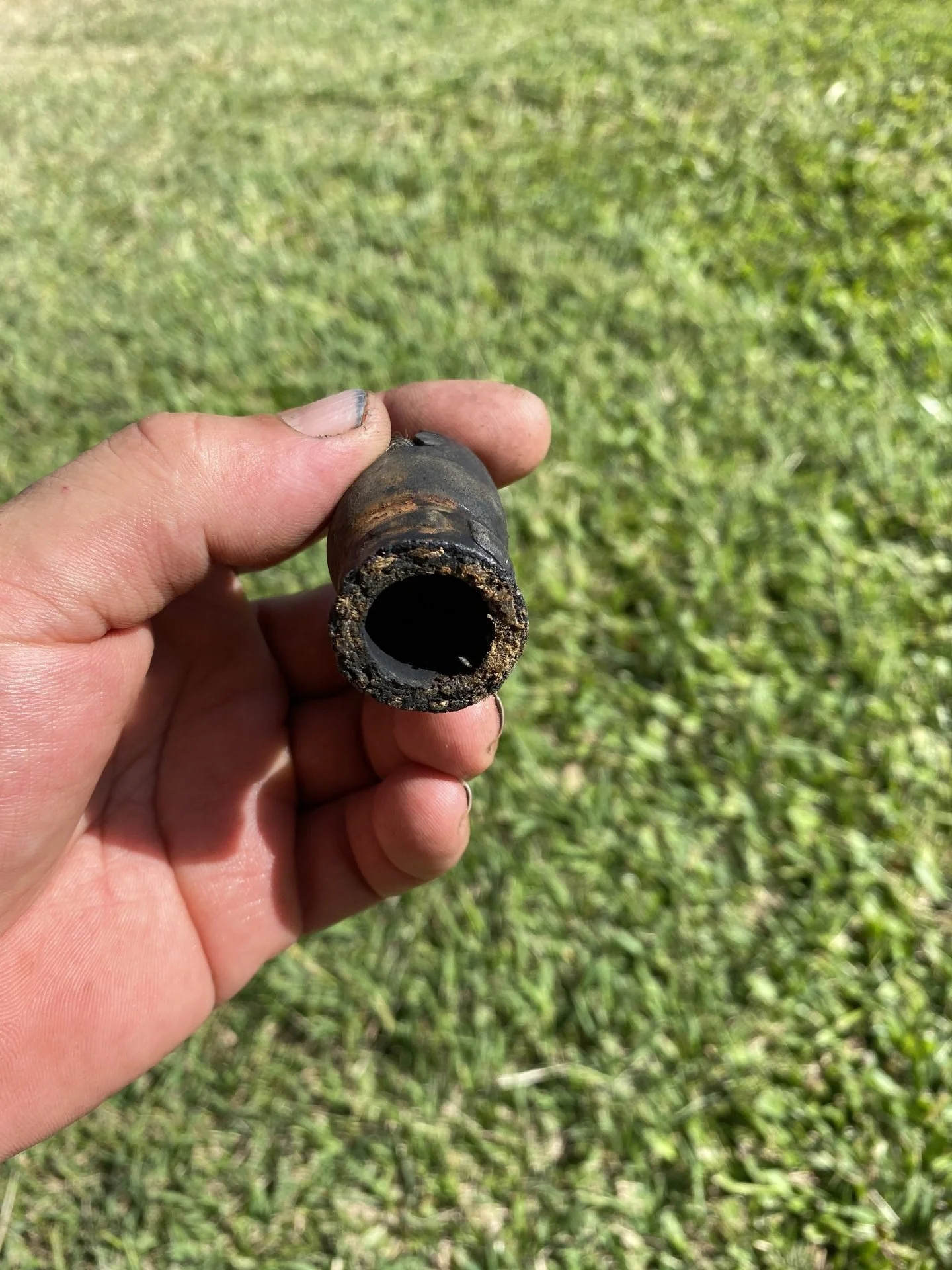

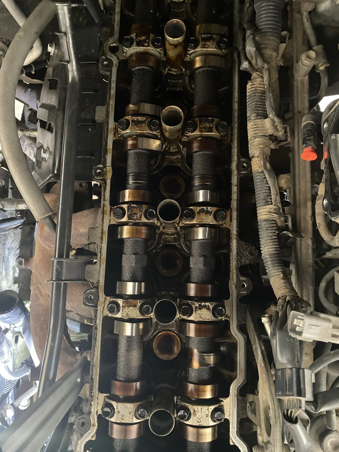

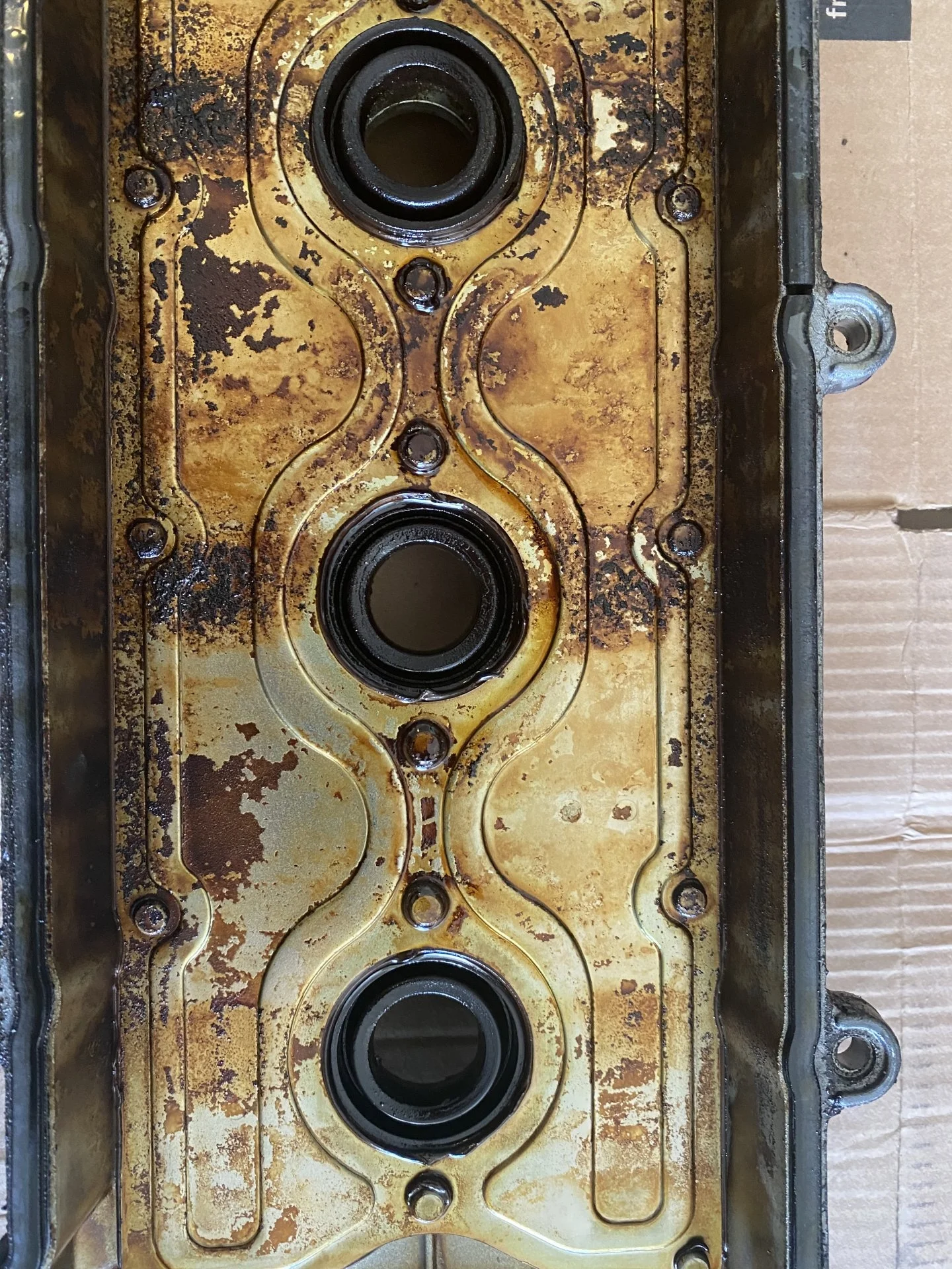

Okay, got the valve cover removed...how does this look? Doesn't look great to me but I have no damn clue what I'm looking at or for. There are deposits that I don't think should be there and I'm not sure what else. More research for me.
Edit* FWIW, I run Shell Rotella but only used it once since I bought it. The oil is only a few months old so when I'm done with this, I'm going to send a sample to Blackstone. Perhaps, I'll increase the oil change frequency too.
I might begin another thread about this but not after researching first.

Im not sure what looking at it all means either, but clean the valve cover (i would paint the outside because I paint everything), and clean the inside of the throttle body. All the hoses you can reach on the plenum/EGR replace if you haven't.
The top of the throttle body where the carbon is built up, where the hole is on the plenum, clean that area and where it leads. May help if you have the P0401 code.
If you can, remove the top plenum and completely clean and change hoses.
Copy on cleaning and replacing hoses, vac lines, etc. I'm going to stop for the day and let my body recover from the 12 hours of wrenching yesterday.
