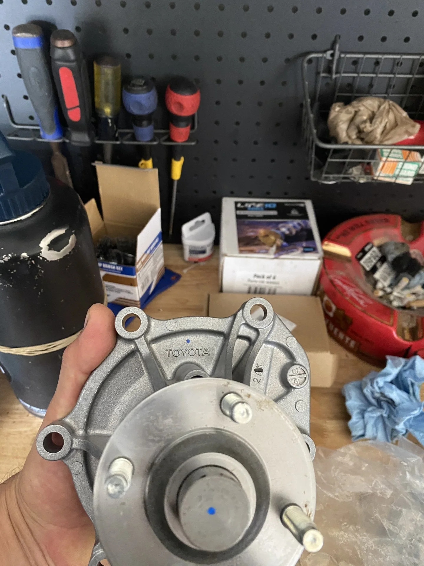

Tonight I decided to install all three belts and get after my radiator install. Well once I unboxed the radiator, some very glaring details stood out to me. I had no radiator supports. The radiator I removed from the rig was an AC Delco or something and looks like the PO may have removed the original bracketed to install this off-brand rad. So another set back and I only ended up installing my water pump instead.
While I’m awaiting parts, I have my brake lines soaking in PB Blaster so I can R2 those once my final brake line comes in. In other news, I got a couple oil cooler lines coming in from Dubai so I can install those with plenty of room since the rad is still out. I have the rest of the parts on order provided the Toyota dealership in the states can get them but it usually takes them 2-3 weeks to send me my s***. Oh well, my ETIC bumped once already so for now I’ll just keep cleaning and inspecting and pushing along with my brakes and suspension. Onto the pics from tonight:

Forget everything I wrote up there. I was wrong again. In my frustration I didn’t realize all the mounting hardware was compatible from my old rad to my new rad. I slept, woke up, talked to Chris (Slow95z) and just as I was talking to him I had clarity. He helped me out and is a great guy. I was about to drop $100 on new hardware based off poor parts illustrations and limited experience.

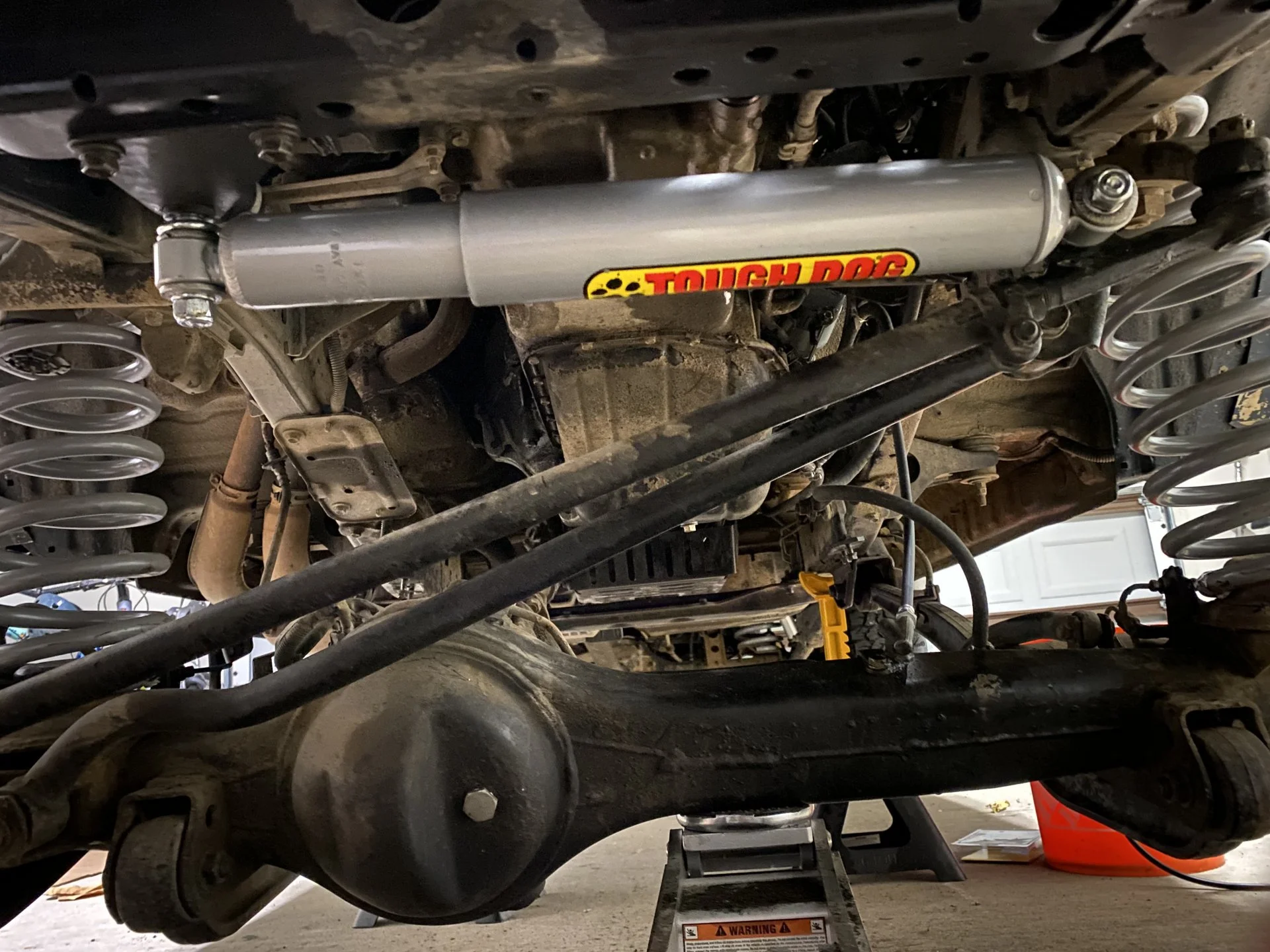

Took my 27yo steering damper off and replaced it tonight too.
