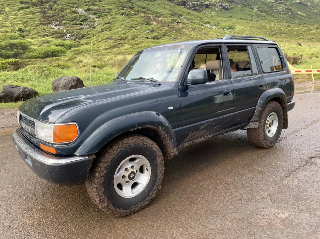

Thanks Jen, I’ll be checking those out too. This morning I took my family out on our second little adventure up to Kaena point. The cruiser did awesome. The rains started and everything turned slick and muddy and I learned when not to use my lockers...

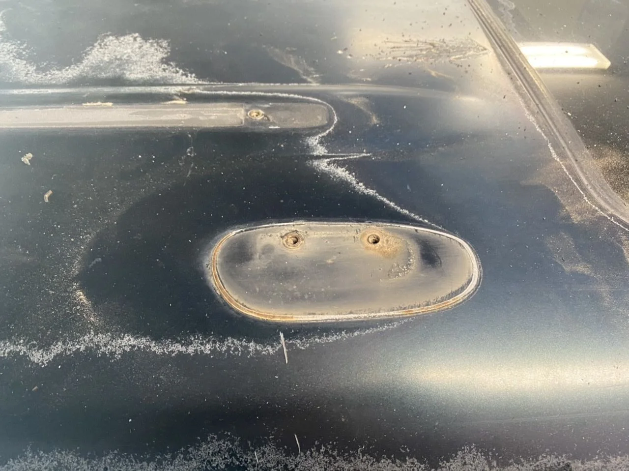

Okay...after reading several accounts of other people experiencing rust from inspecting their rear deflector/spoiler and roof rack, I decided to inspect mine. Some surface rust was suspected from the little I could see but I dove right into it. I most of the bolts came right out, the others that weren’t so cooperative, I brought out the sawzall and made short work of them. I followed the numerous threads here and got a some assistance from @SUMMIT CRUISERS btw, thanks!
I didn’t weld anything as of yet as I’m plotting a full repaint once I get back to the CONUS. For now, I simply took it down to bare metal, removed the rust, laid rust prevention down and sealed everything up using JB Steel Stik. It worked well enough but I’m not 100% satisfied with it. Again, this is temporary until I retire next year. In the end, my cruiser is better protected and the roof looked better than before. I now have to let the base and clear continue drying before I get after some wet sanding and buffing.
That is awesome. I’m afraid to dig in further to my ribs. Way to go! I’m inspired!
Thanks man! The ribs were fine, some surface rust but nothing major. I treated all the holes the same (sts). I love getting new parts in...but that means I also have to get to work! Shout out to @NLXTACY because that dude is the man who helps out military and first responders. When I run into him on the trail someday, I have some stogies specially set aside for him. And me of course😉
