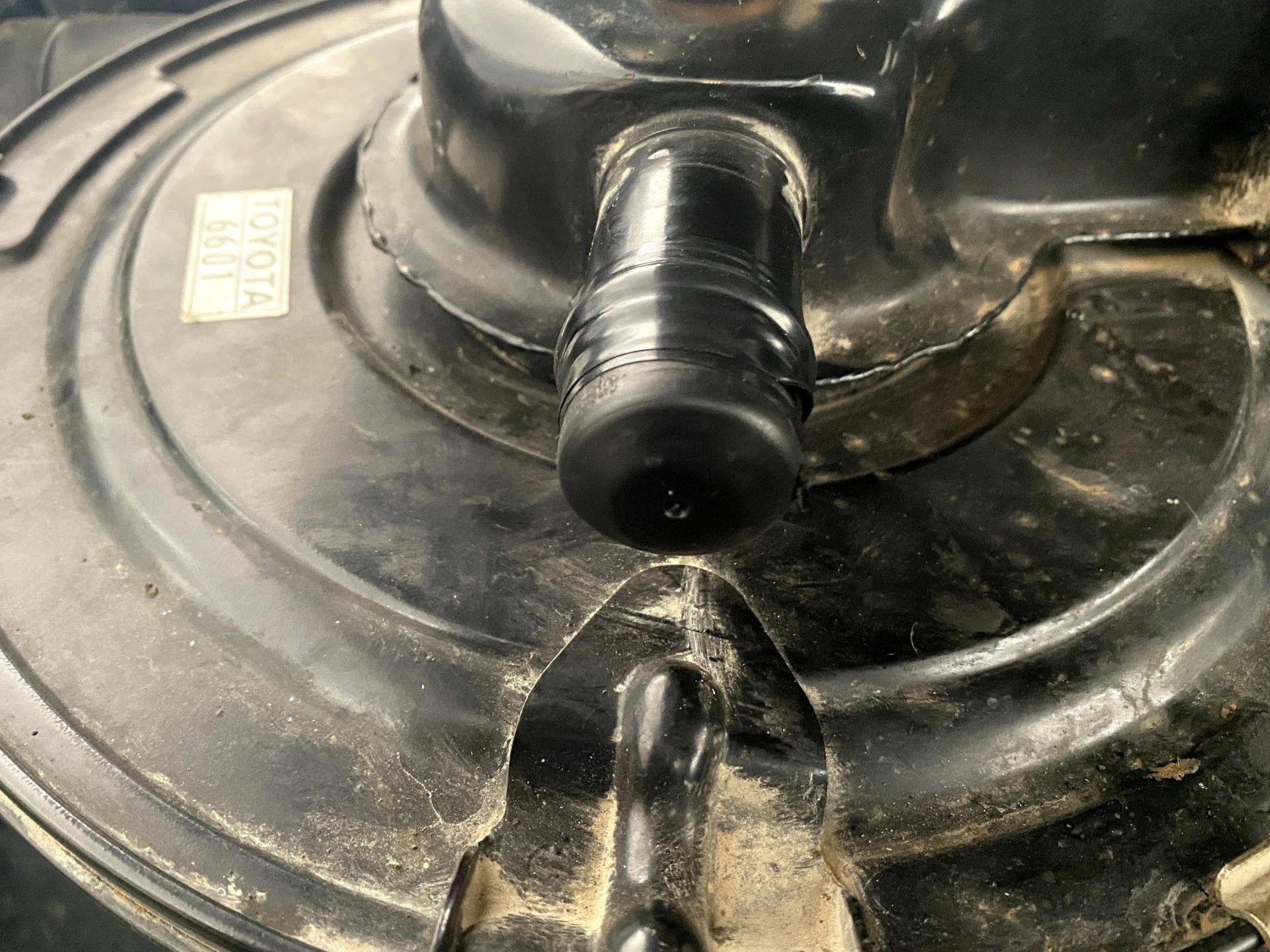

Forgot to show this little gimmick I pulled out of the intake tube whilst performing the PAIR delete:
Needless to say, I feel confident my fuel economy has now tanked 🤣
“First $100 gets it...”
It's designed to add thrust if you ever drive underwater. Why would you ever get rid of it??

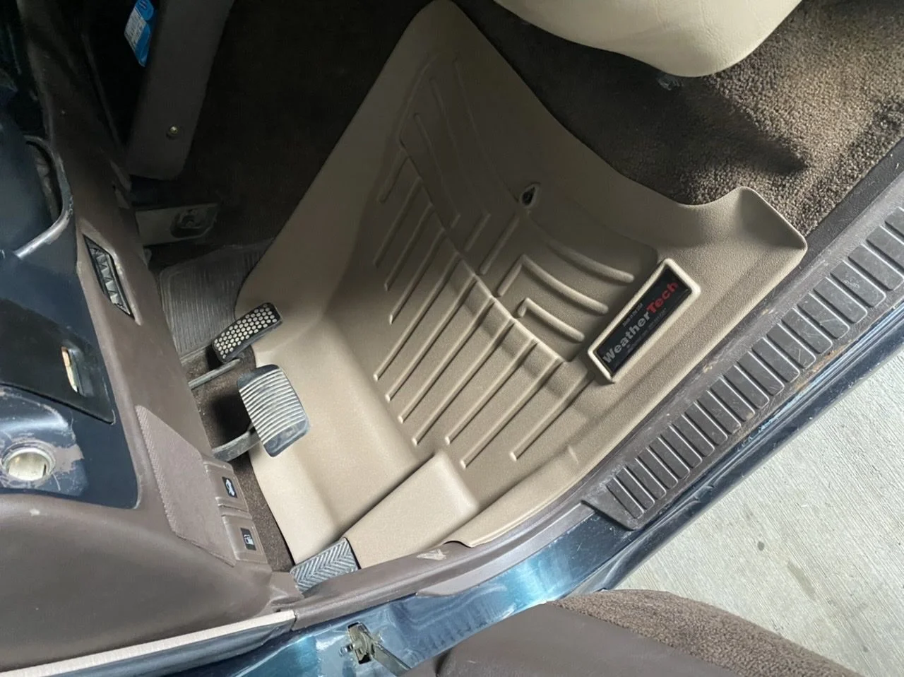

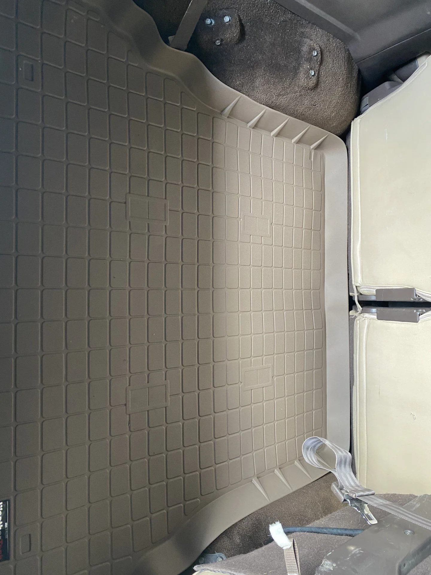

In other news, these finally came in. Seems like lately USPS and FEDEX are consistently blowing their ETICs with delivery expectations.
Those look good! Need to order myself a set of those.
Thanks, they're great. I've always had Weathertechs in every vehicle I've owned and these can't be beaten in terms of fit, form, and finish. I like them better than Huskeys which I believe are their main competitor. Aside from the great utility, the aft cargo carpet is thrashed so it covers that up...you know ignorance being bliss.
In the first photo is that a 12 v outlet? I have a gaping wound in that spot that nEd’s the same treatment.
Yes, but I ripped the wiring out from behind it in my haste to get rid of the rats nest from my previous posts. There were so many splices within splices, it was splice inception. Hard pass.

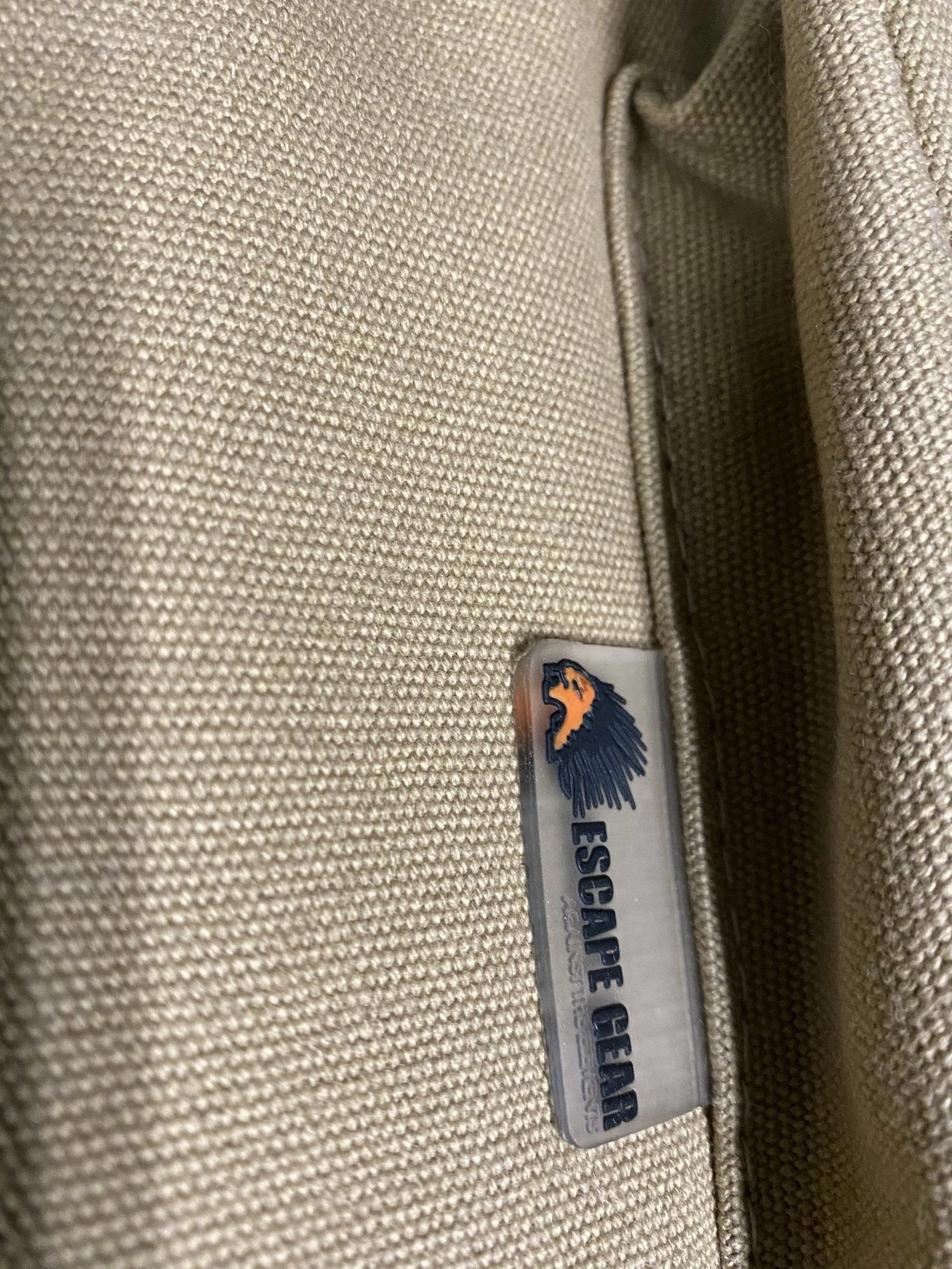

After a few outings and having the Hawaiian sun beat down on my rig, I wanted to protect my dash a little better. After all, my dash is in great shape and I want to keep it that way. I’ve always read good things about Escape Gear and went looking. I bought directly through their website and they were extremely friendly and customer service oriented. They verified my dash style 94 vs newer and told me it’d be a bit longer to receive my mat as they’re made to order and Covid has delayed their Ops. I was good with that upfront policy. I ordered on 9 Mar and it arrived today, 30 Mar. It is exceptional quality and I really like the added features to hold maps and some tools or whatever you desire. Not bad for $100 to my door.
I decided not to use the Velcro stickie and instead will see how the mat stays put while driving. It seems heavy enough to not move but I’ll ops check it this weekend on one of our small adventures. Without further adieu:
Edited for stupid spelling syntax: I wish I needed a dash mat in my climate. I need moss killer here. Im stoked that it only took a few weeks to get that custom bling to your door. I think they make some nice seat covers too.
I’d argue this dash mat has more utility than simply protecting your dash. I think you need one😉.
They make awesome seat covers! I plan to get a set in the future but first I’m collecting bits and pieces to prep for my full paint next year.
