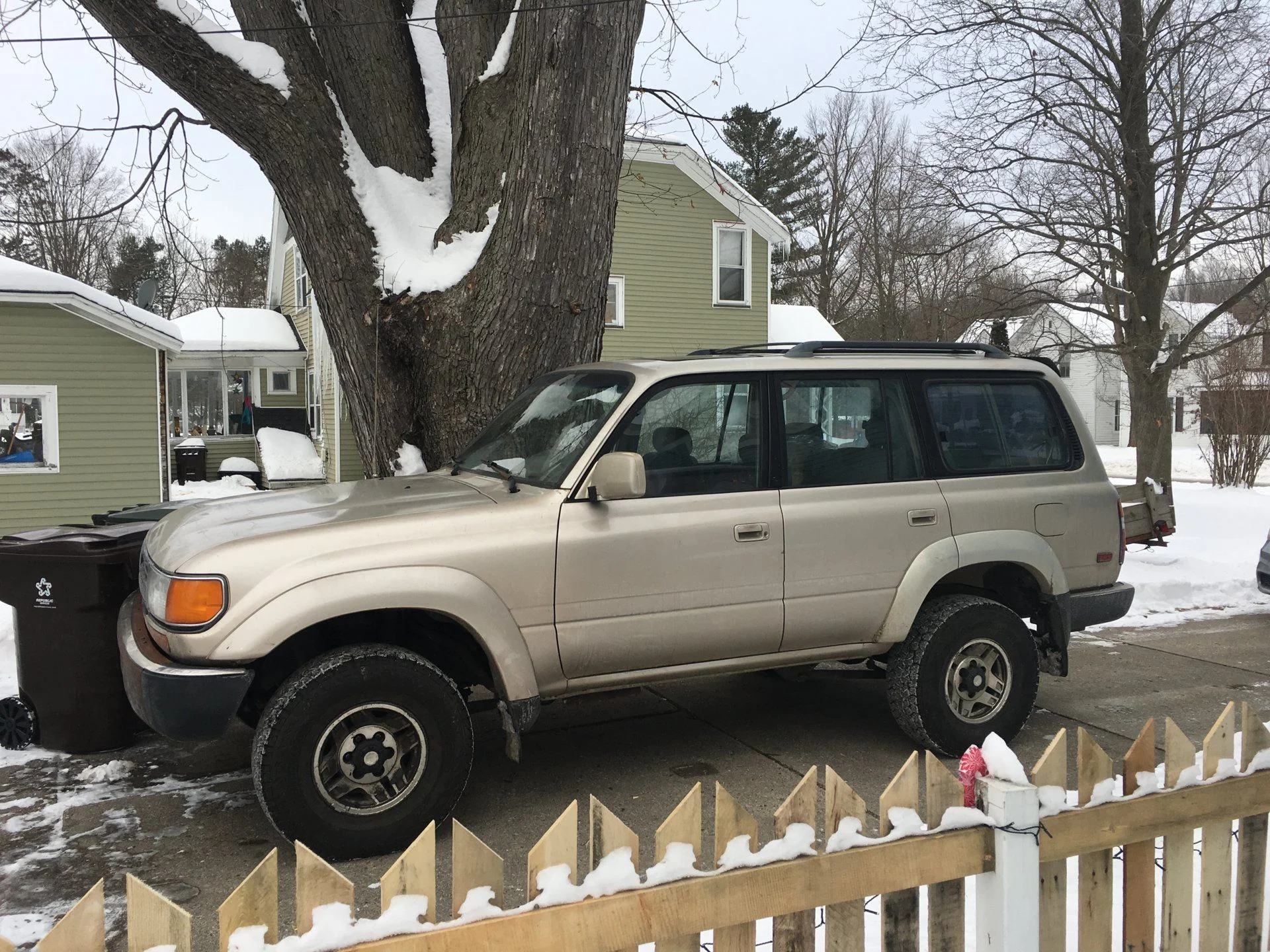

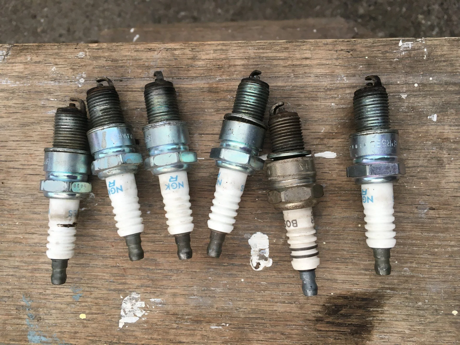

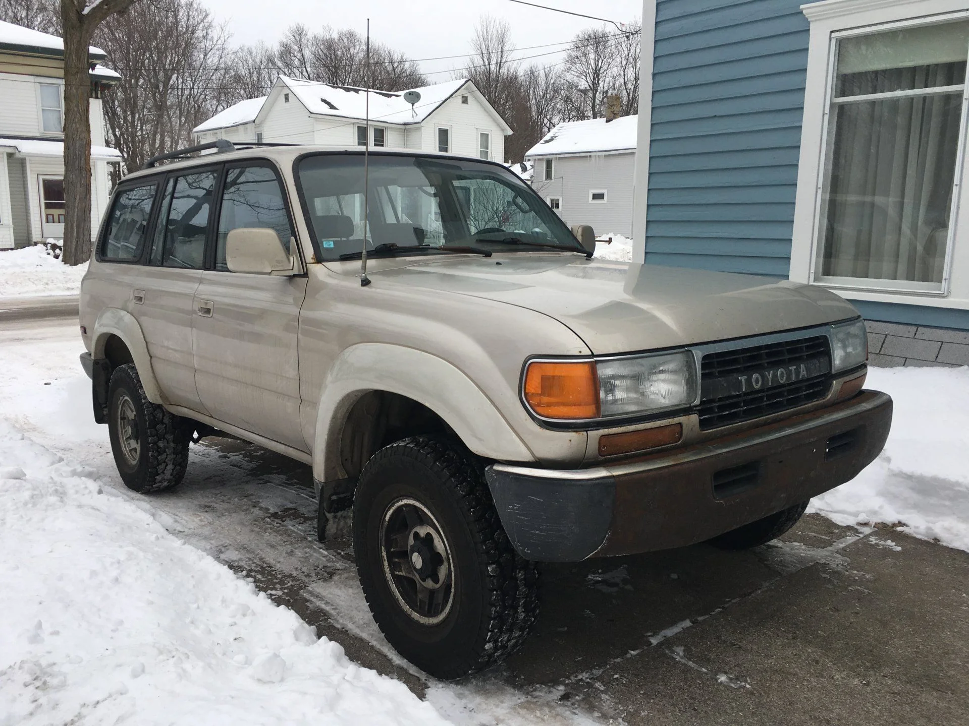

So I got a FJ80 a few months ago, Ended up paying $1200 for it, She needed maintenance galore But relatively Rust Free for MI, So I bought it. To get it up to snuff, I spent 300 (Plugs, oil, Desmoge the 3fe, Rust Converter, Etc...) and another 280 on a new radiator, since that blew up a month after purchase, (about to return the old one cause I found out it is the same exact one I bought from Orylies).

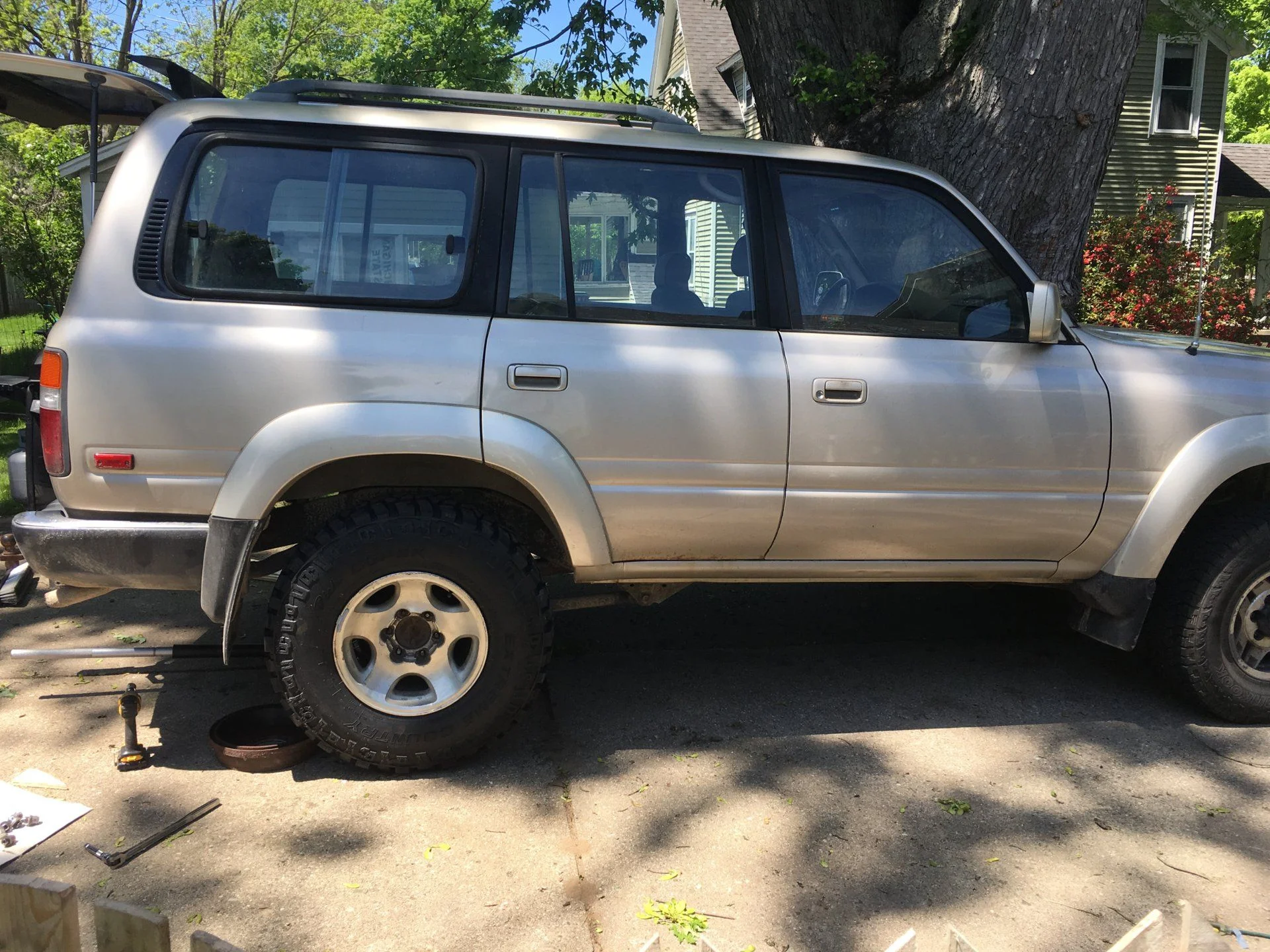

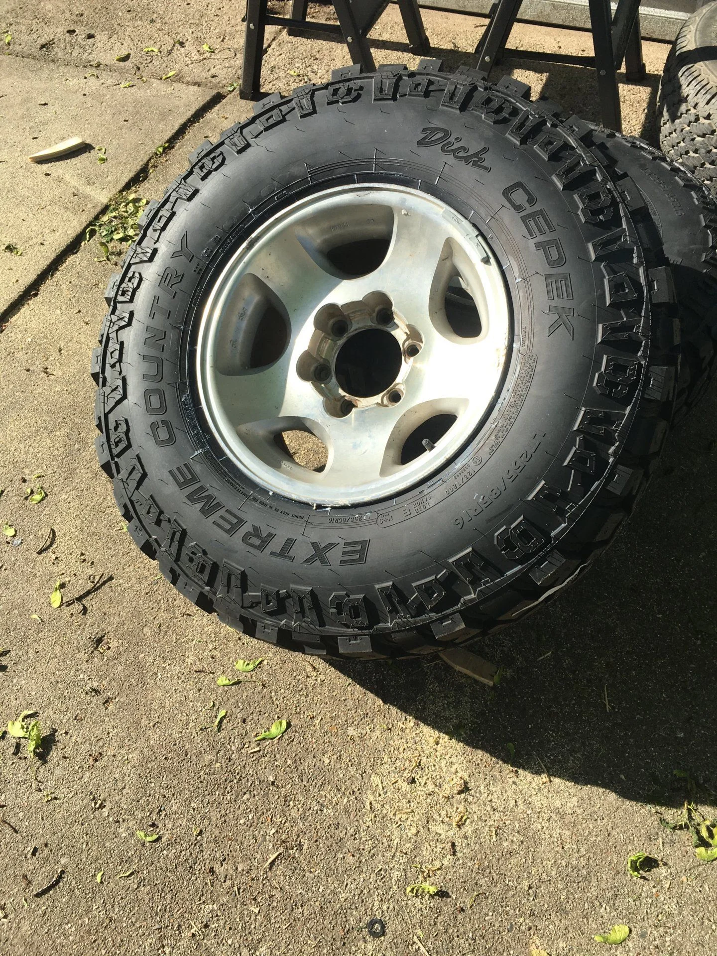

In march I Found a killer deal on Dick Ceperek 255 85 16s, for a whooping $625, But they were on back order, so I got them yesterday. Since i was on 31 x 15s, I did have to find some 16s. Luckily Craigslist found me a guy that was parting out a 80 LC. I went and bought the drivers seat back, Passenger seat bottom, and middle seat to replace my torn ones in LC\ and they were the Exact same color, I also got some 16s, This all set me back $120. Lot of steam cleaning later she looks good. While I was at it I pulled the carpets because they were disgusting and even after power washing them, there were still some stains I wasn't too sure on.
The Goal with Goliath, every overland vehicle needs a solid name, Is to be able to have a overland weekend warrior with the yearly weekish long trip! I will say I am not new to overlanding but my 99 4runner was already built, and then got sold because I wanted my dad 77 Celica. This LC will be built on a budget. Wife approved $3500 For total build (Once I hit that I may get more for other upgrades... 4bt, 6bt... we will see) But my main goal is going on Adventures... the offroad adventures were very much missed once the 4Runner went, we saw so many back roads that many never see, Tiny towns that are almost gost towns and so on. Adventure is out there, even for us 8-5ers that only get the long weekend trip with the Occasional long trip!
Here are some pics when I got her.

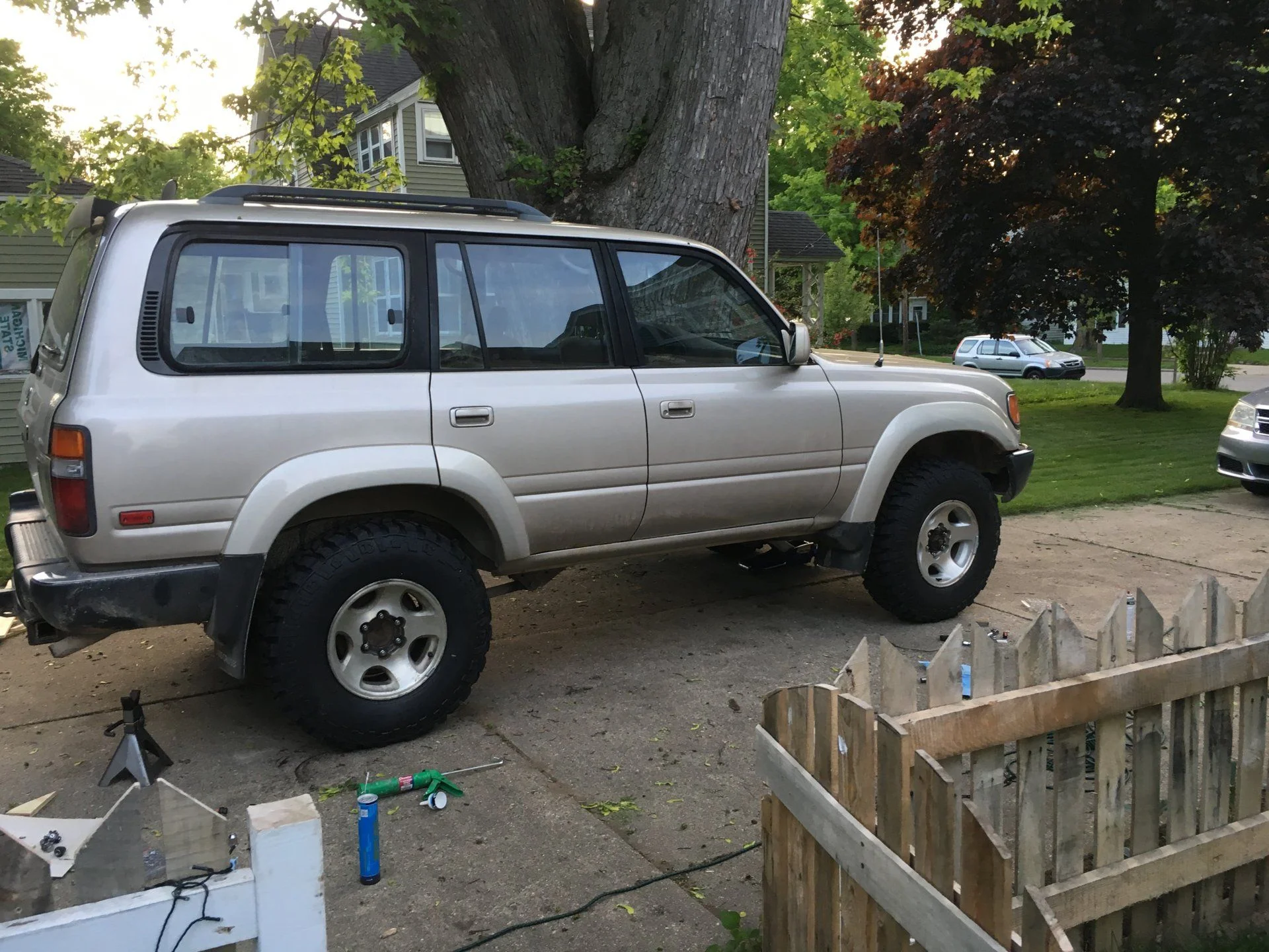

Game for the kids, Can you tell me which one of these things is not like the other....

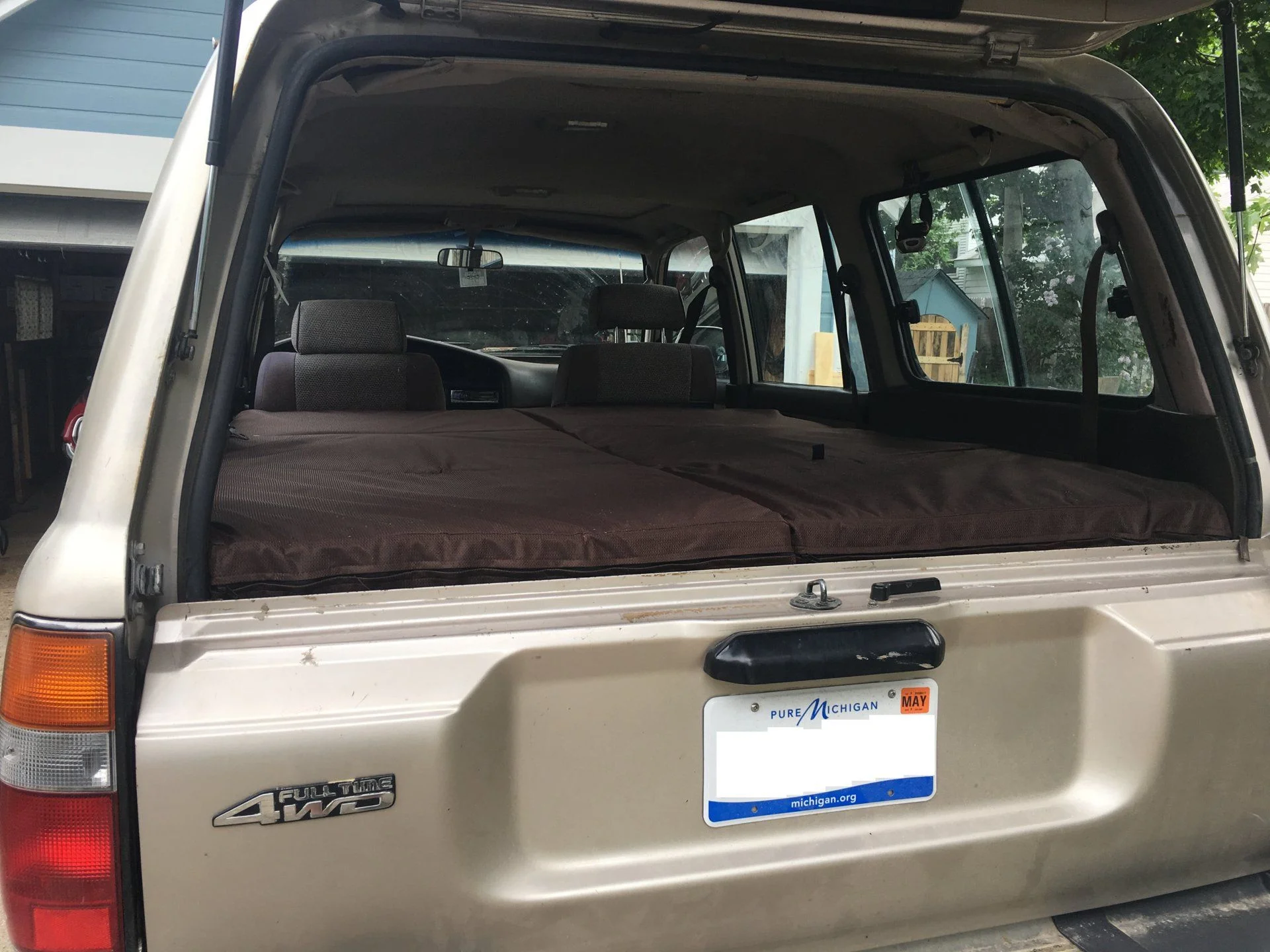

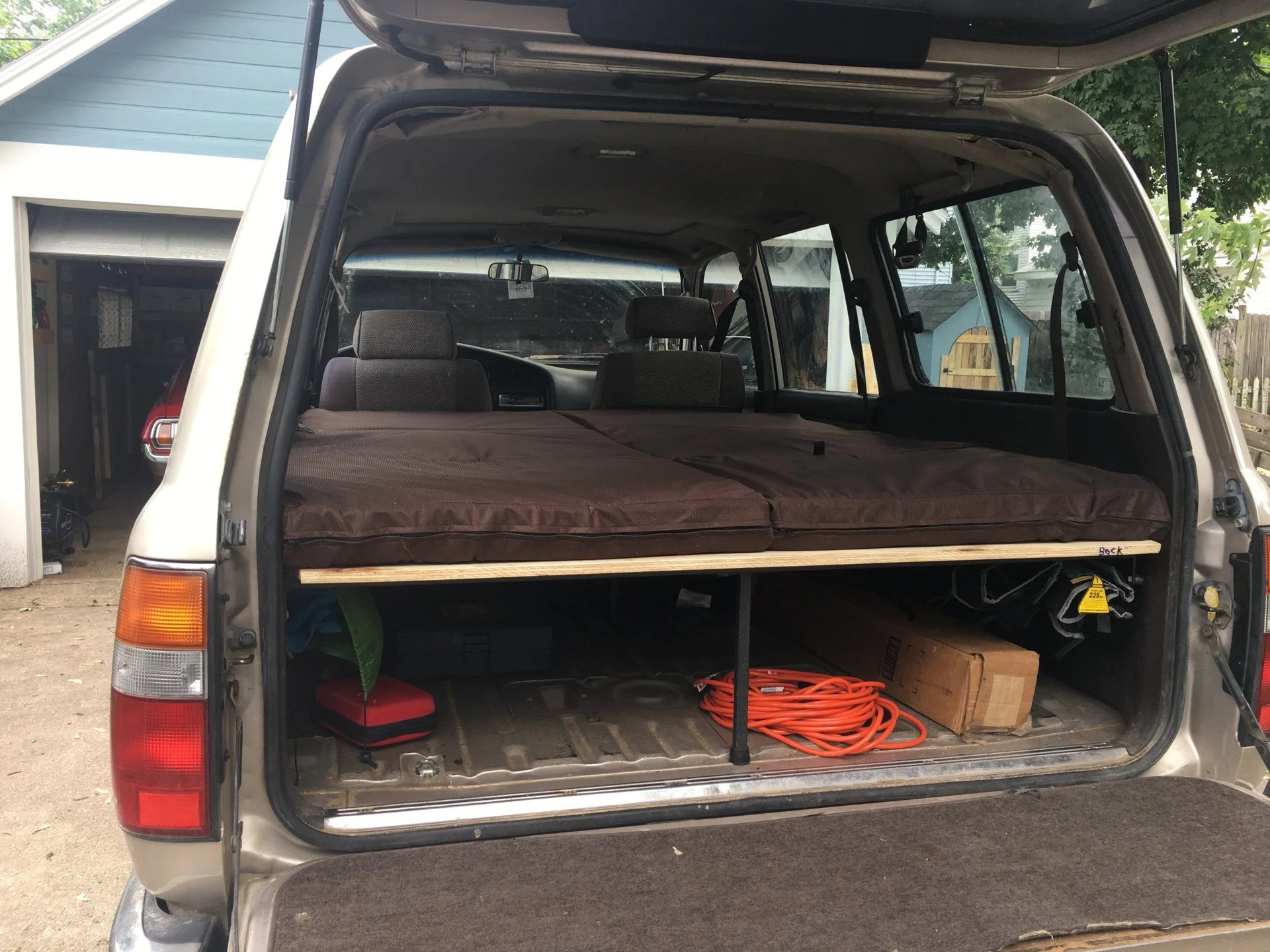

Going camping this memorial weekend, Soooo Obviously I need a sleeping platform, Metal, wood Screews and of course Mattress and two heavy duty Totes, Set me back another $190 Ill add pics of this in a bit. I followed mmuthart Guide,
Sleeping Platform Without Drawers - Here's What I Came Up With
Wife bought me a Mig135 for my birthday the Sleeping Platform frame was easy to build, Bumper and slider are in the works...(Side note, you find a women that buys you tools and does thing you like to do like camping and carshows, Merry her)

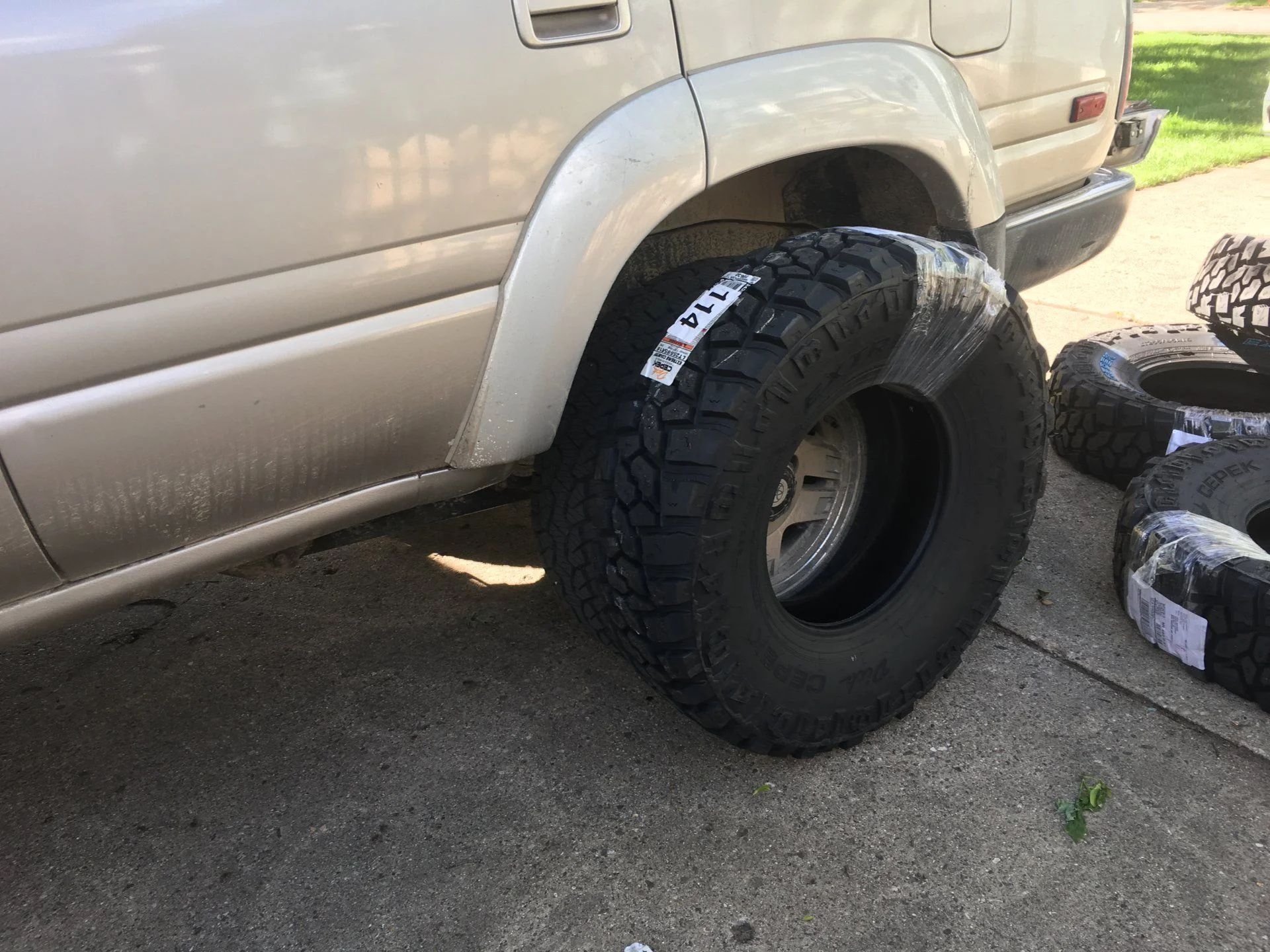

Also here are the Pizza cutter 33s! Found out the hard way that 15 in lugs dont fit the 16s...
Anyone know what Lugs I need for stock 80 16s?!?!
Just cruise down to your local tire shop.. I have discount and les schwab here they usually have a variety of lugs in stock and not to expensive. I’m sure they have something that will fit.
Good Idea, Yeah trying to keep her cheap so figured online ordering but if I can get it local that is even better! Goal is under 3500 Total...(that will probably grow once i hit that but lets see what I can do until then). Ill be selling the 15s with Good tires to recoup some cost for future projects on her
New tires installed!!! Went for a drive and the check engine light came on... Not sure if anyone has seen that. The CEL code is 21 which is o2 sensor1, I changed out the one by the frame rail 2 months ago, can’t remember which sensor is 1 and which is 2...
Anyways here is the new tire pic!!!

So before I left I fixed the CEL... it was the rubber intake hose decided to crack a bit more when I was messing with trans adjustment. Luckly I pulled the one off my $120 parts grab 80. So swapped it out and re cleaned the Throttle Body. We did take the old beast camping. I was pleasantly surprised... I got 12 MPG HWY with hills! LOL. And this was its maiden voyage 250 miles total and didnt come home thinking well crap I need to fix everything... as usual I got excited about camping and forgot the pics. No worries it was just to a KOA my father in laws cousin owns... since its the only type of glamping my sister in law will do. BUT we got to try out the new sleeping platform and it was in Norther Michigan so I found a seasonal road to play on.
Anyway here is Sleeping platform, Cushion fit perfectly but I wish the foam was a Tad bit more dense, Comfortable enough... then again our mattress at home is a purple and that thing is Awesome.
