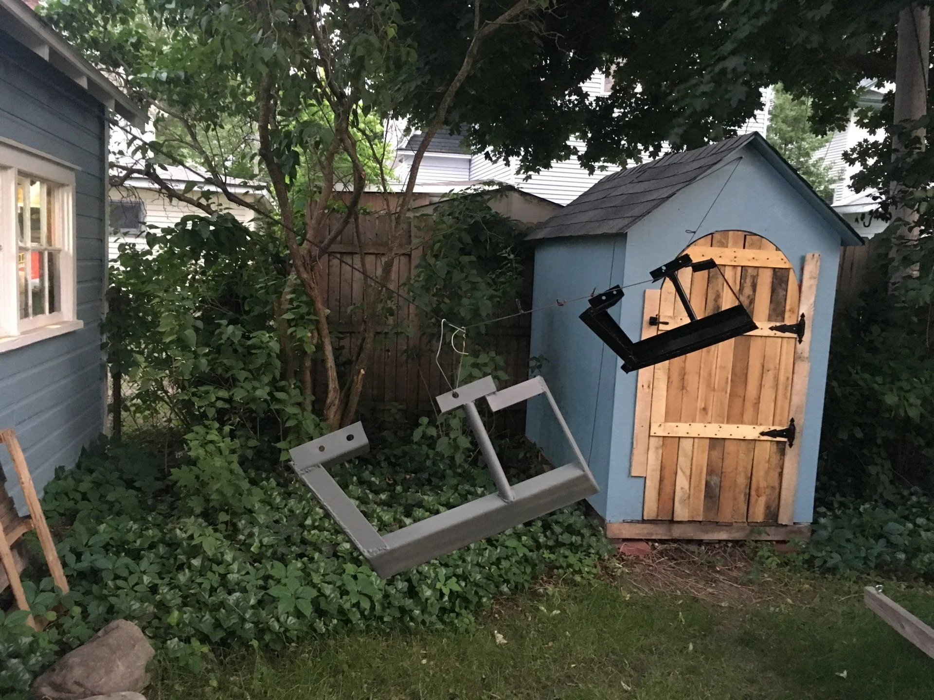

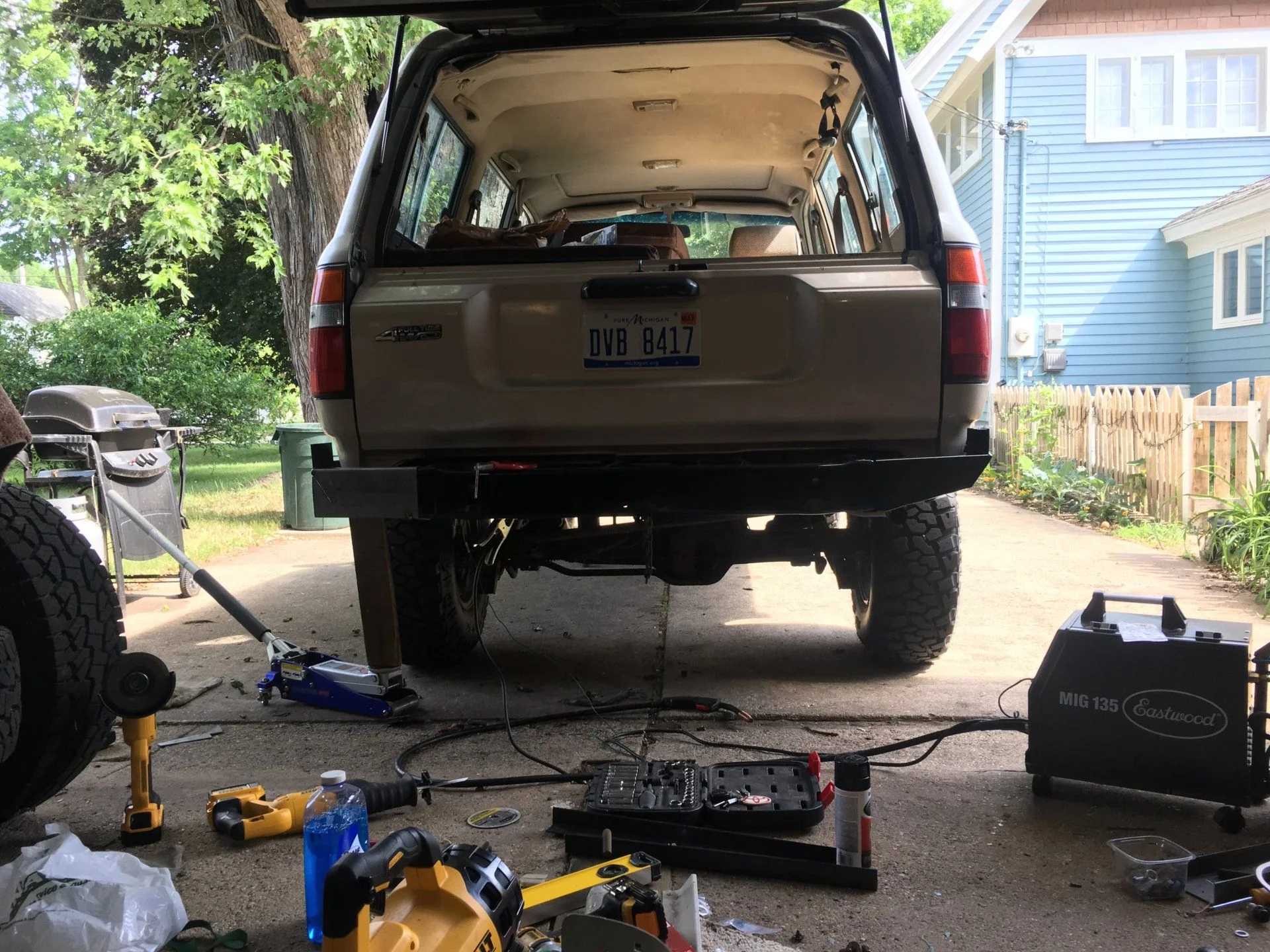

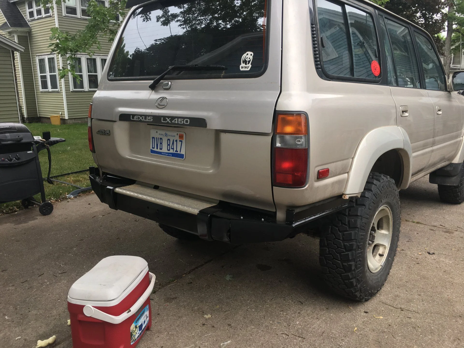

So been playing with the new welder making rear bumper corners.. I know the welds aren beautiful but they are strong! I do plan on making a swing out with Heim joints. But for right now i just have the corners.
I have also done some more boring stuff like replaced the steering box and other maintenance. Pulled factory roof rack, some interior stuff and so on. But nothing too exciting.

Wow.....how do you make them pieces float in the air like that? You must be a dang magician! Lol
