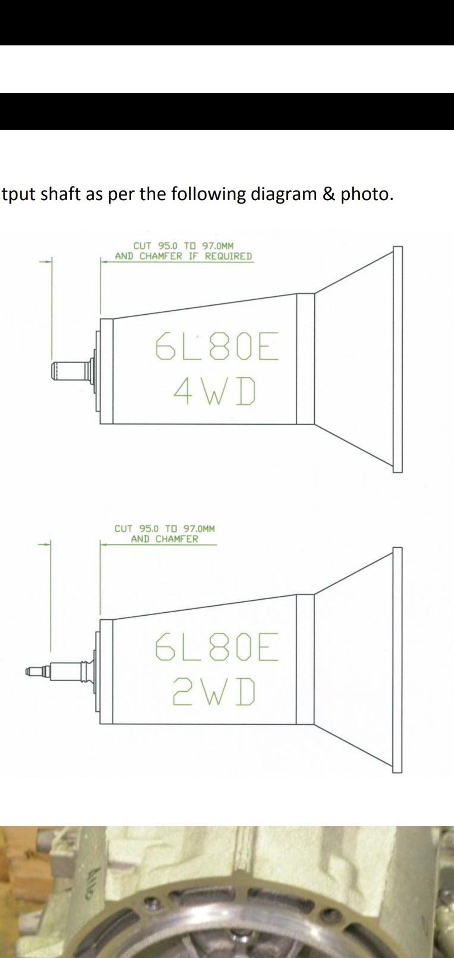

I'm getting a 2WD output shaft swapped into a 4WD 4L65 transmission and plan to use the Advance Adapters kit. The 2WD output shaft has to be cut, but the diagrams measure from the face of the transmission with the shaft installed. Since I'm swapping shafts, does anybody know the final length so I could cut it before install and could maybe do a nicer job then an angle grinder hack?

Email Marks4wd or AA for the measurements. They should provide you with instructions with a diagram like this (for the 6l80e)
Yea, there's a diagram like that available on AA, but it shows the stickout from the back of the first part of the adapter, not the overall length of the shaft or how much to cut off the end. Emailed AA and they said that diagram is all they have.
