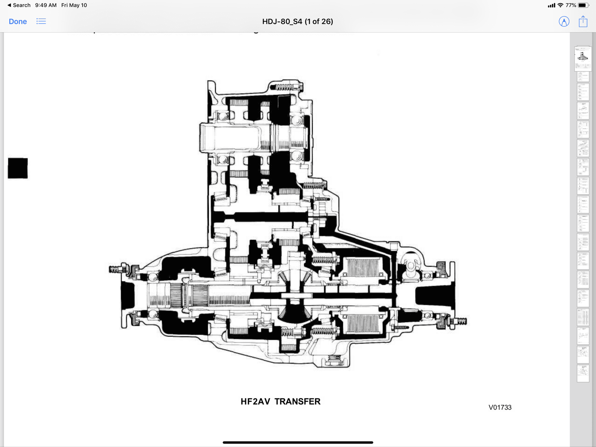

Marks has an adapter for the 6l80. If you get the correct adapter, it should align with your crossmember.
Not for the HF2AV.
This is the adapter I used to mate my ‘93’s Tcase to the 6L80 P/N slightly different, cause I didn’t need something that was otherwise provided with the adapter (can’t remember now). Call Marks. I think they helped me figure things out. Been a few years, but the “V” on the N.A. models stands for something that does not make a difference as far as an adapter

Adapter housing mates to the tcase and trans fine. The mount for the high/low lever requires adapter plate (for later year lc’s with the hf2av). Input shaft is about 3/8 inch too short (not that it matters). Provided motor mounts are useless. I had to bash the fire wall in spots to make the engine fit and I still was not at my original cross member mount spots. If I could have found an offset tcase that directly mated with the 6l80e, I probably would have gone that route.
93s came with one or the other (hf2av or hf2a).
Like @TonyP said the “V” is the viscous coupler. When not locked it’s limited slip.
