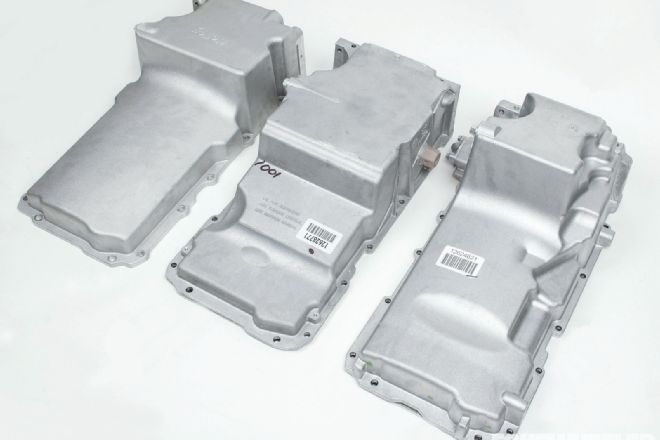

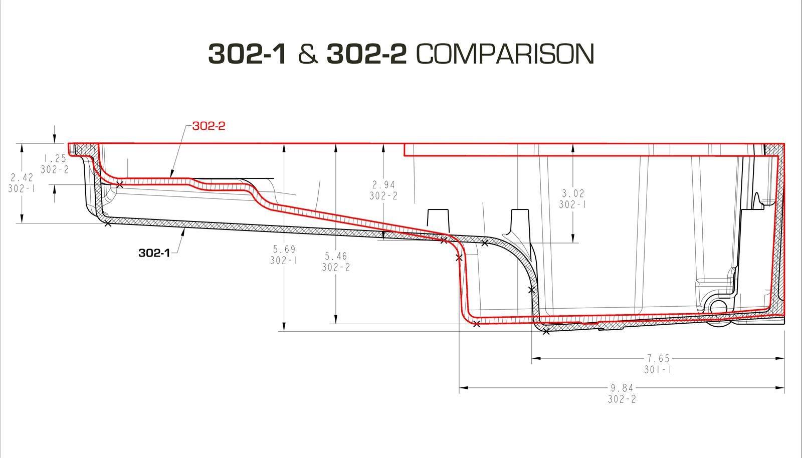

Got a pic of where? Holley has some pans with different profiles compared to the GM pan.
Holley Pans
1996176
GM F-body pan
1996177

It looks to me like that Holley 302-1 pan might help you - the deep part is about 4" shorter then the GM pan.
The h3 pan won't work ? It has more clearance than the fbody pan
The H3 sump may may be "shorter" front to back, but it hangs lower to make up for it.
Its also notched more on the diff side i have both pans on two different ls swapped 60s i know this is 80s tho can take pics of both for comparison i even notched the one with the camaro pan.

It looks to me like that Holley 301-1 pan might help you - the deep part is about 4" shorter then the GM pan.
