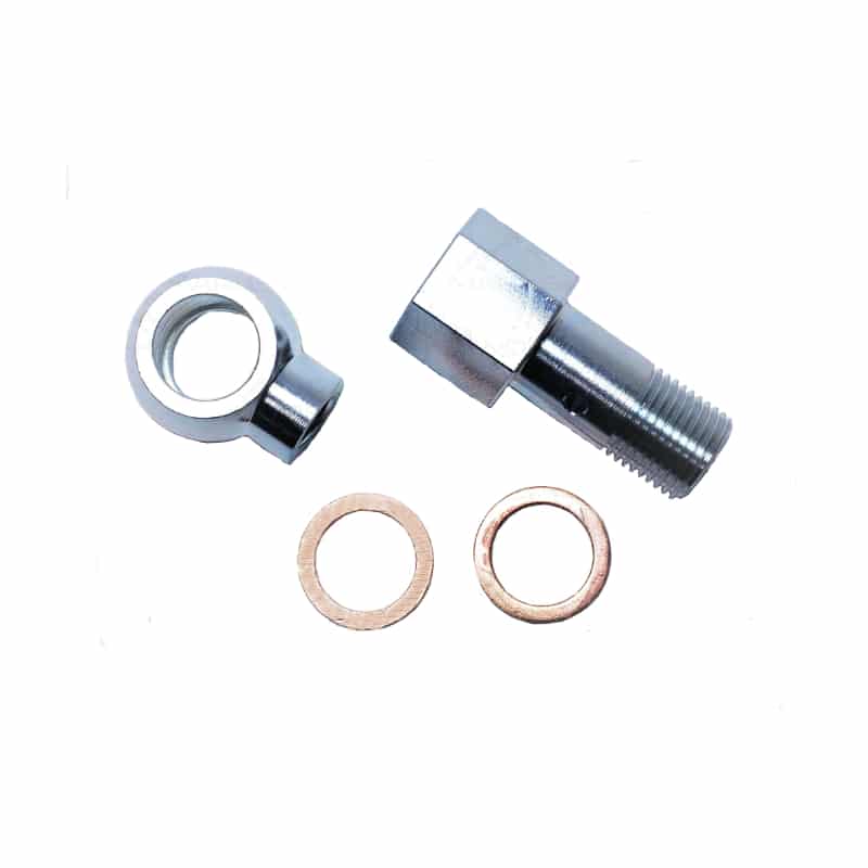

I grabbed the temp sensor from Matt last year. I’ve read conflicting things about whether you need the stock LS sensor or not. Someone on here had a similar setup using both the LS and the LC sensor but it used a bango bolt setup. Out of Australia I believe. I’m sure the shipping would be atrocious.
You’ve got two cylinder heads, so put the LS sensor in one side and the LC sensor in the other. I’m running a third sensor for an aftermarket temp gauge since the stock one is kind of worthless. Drilled and tapped into the water pump for that one.
You must be talking about this:
