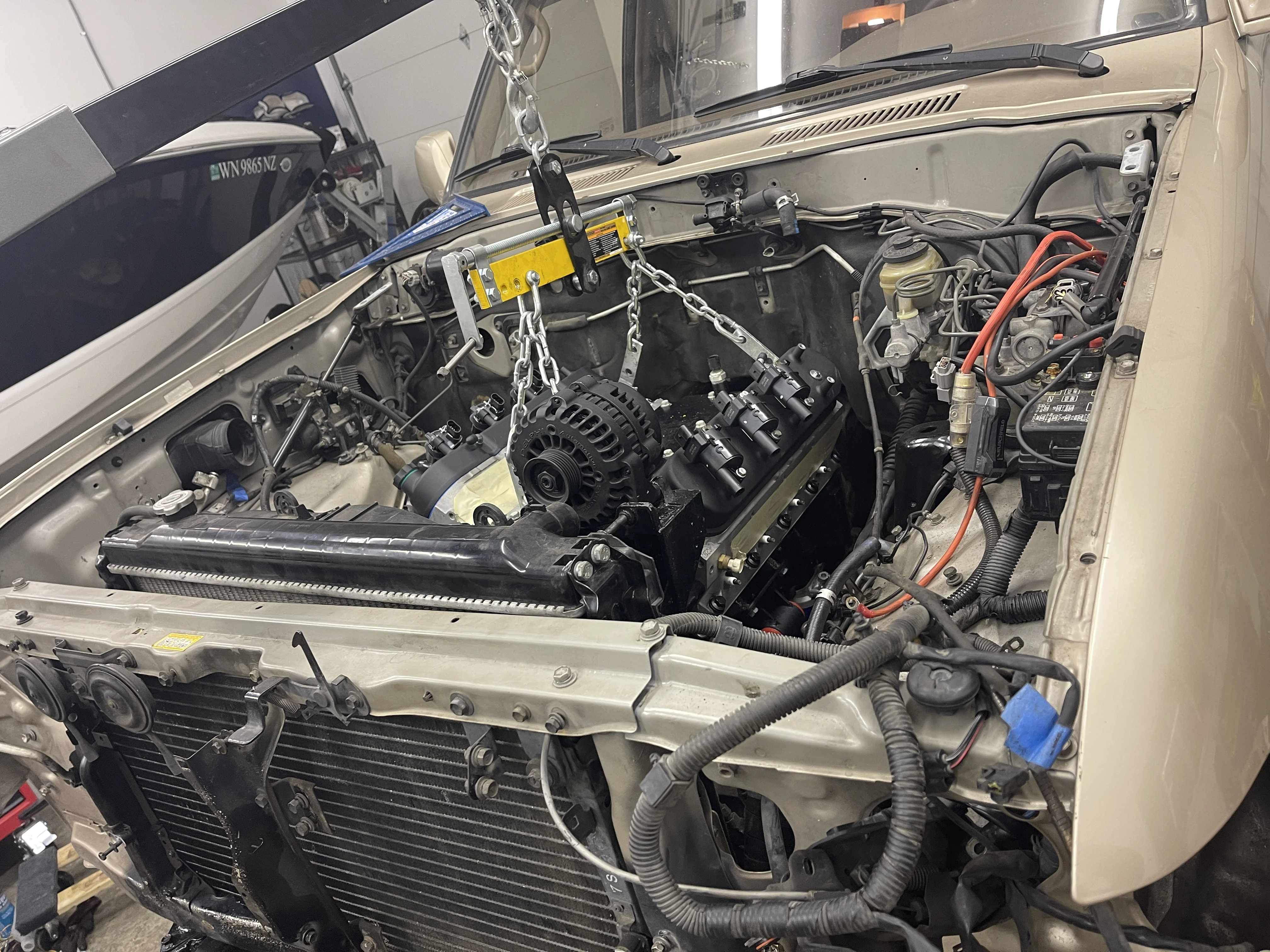

Engine Placement.... My current status. LS 6.0 with 6L90 Marks Adapter on the original cross member. The 6L90 tranny does require a few extra steps since the spline count has to be changed. (Thanks to Mosser Engineering...quite affordable.). The 6L90 is 3CM longer than a 6L80. So far, I didn't have to persuade the fire wall since the engine is 3CM forward so far. We tossed on the PS Pump and alternator and the AC compressor. Just curious at this point. How are you guys measuring and placing your engines? RN we are virtually lined up with the front cross member. Though I am curious if I should shift it a little. Each side of the engine is 10-10.25" back from the front cross member. Looking at the drop at full compression...we are 4.25-4.5" from the oilpan tapping the track rod. (Camaro Oil Pan)
For engine mounts, originally I have the Marks, but I had already cut off the stock mounts and so we are fabbing up mounts rn. Also...for clearance under the hood, my alternator has 1" of clearance. we aren't tacked in...thought I would ask as we are still toying with where we will place it.

How much clearance do you have between the front accessory drive and the radiator?
Also, how much did you have Moser trim off the 6l90e output shaft when it was resplined?

I have the radiator pulled off right now and the engine back out again. With a 6L90 you most likely will not have to persuade the firewall but it will be tight upfront. I plan to go with dual e fans to hopefully same some room.
For Mosser. I had them respline and cut to 96MM. Measure from the transmission per the instructions.
