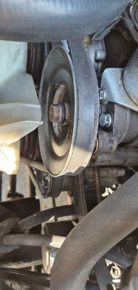

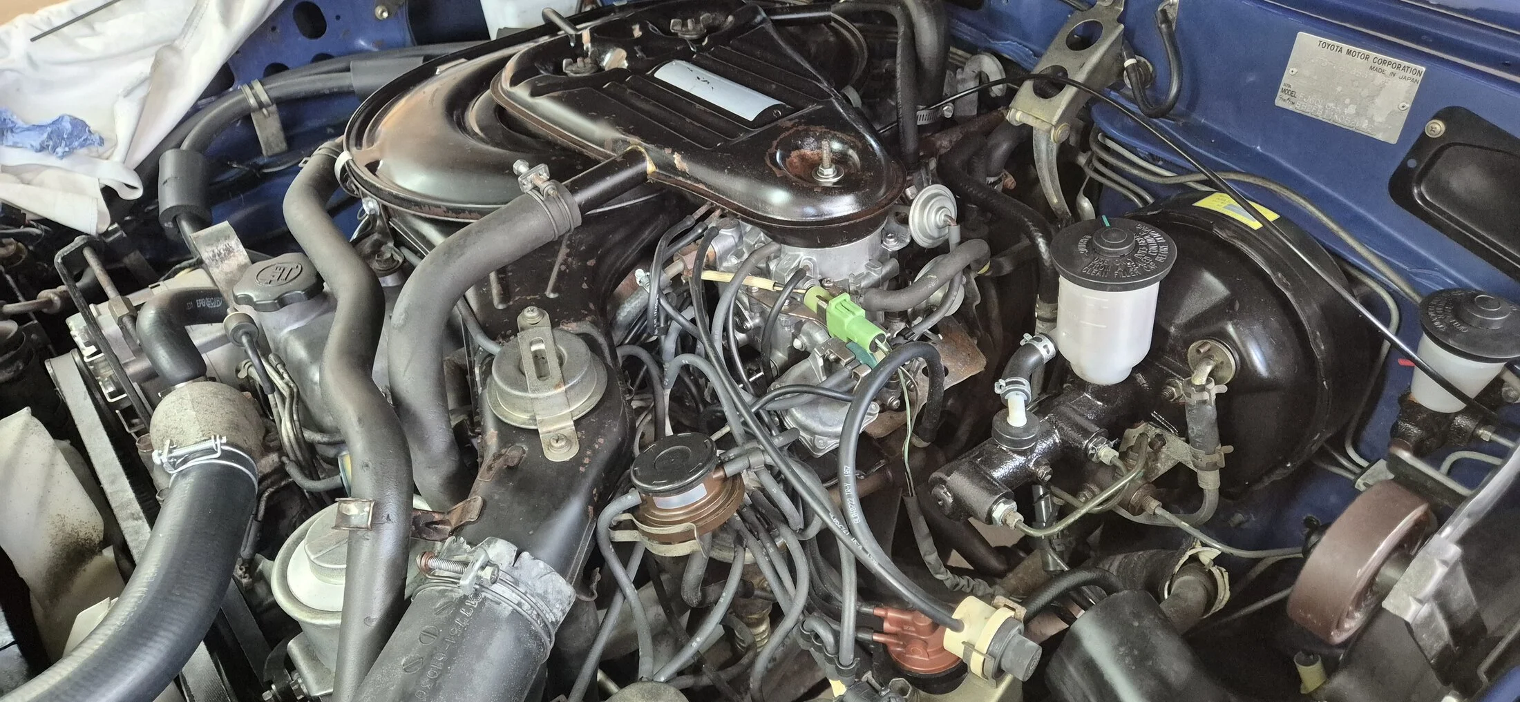

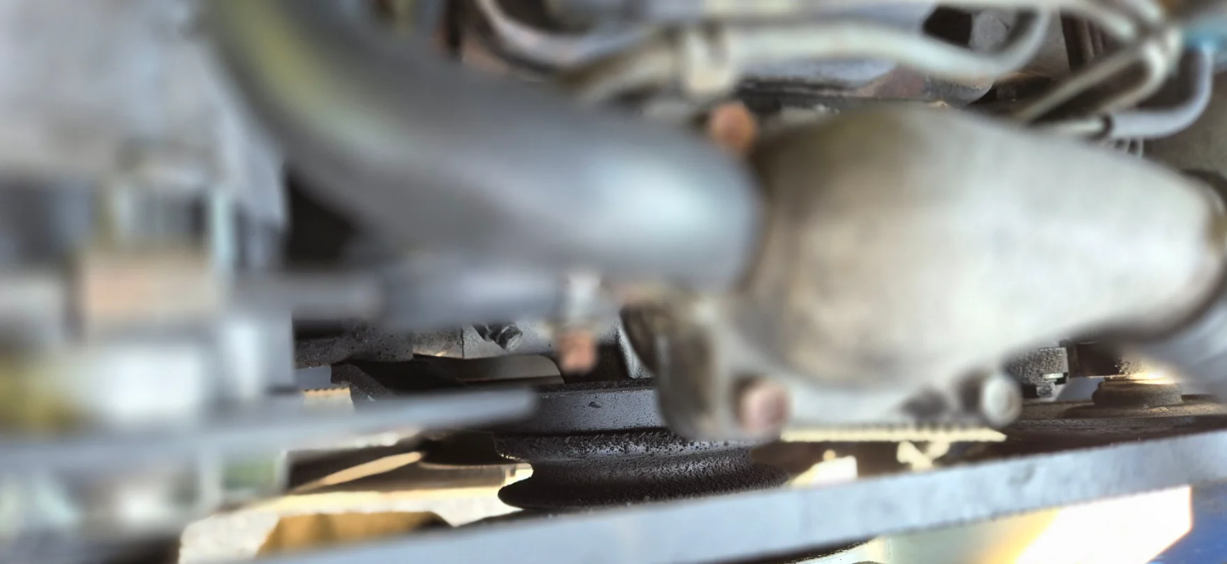

The not so good...yesterday I noticed a) the AC doesn't blow cold b) the PS stops working intermittently c) a slight water drip and d) a large amount of belt 'dust' has accumulated pretty much all over the engine bay. Not really what I was expecting after having spent so much time and moolah. I'm fine wrenching a bit on her but would have preferred more than one day before I had to start doing so. I checked the PS/alternator belt and it feels decently tight. And she seems to be charging fine.
Some pics:

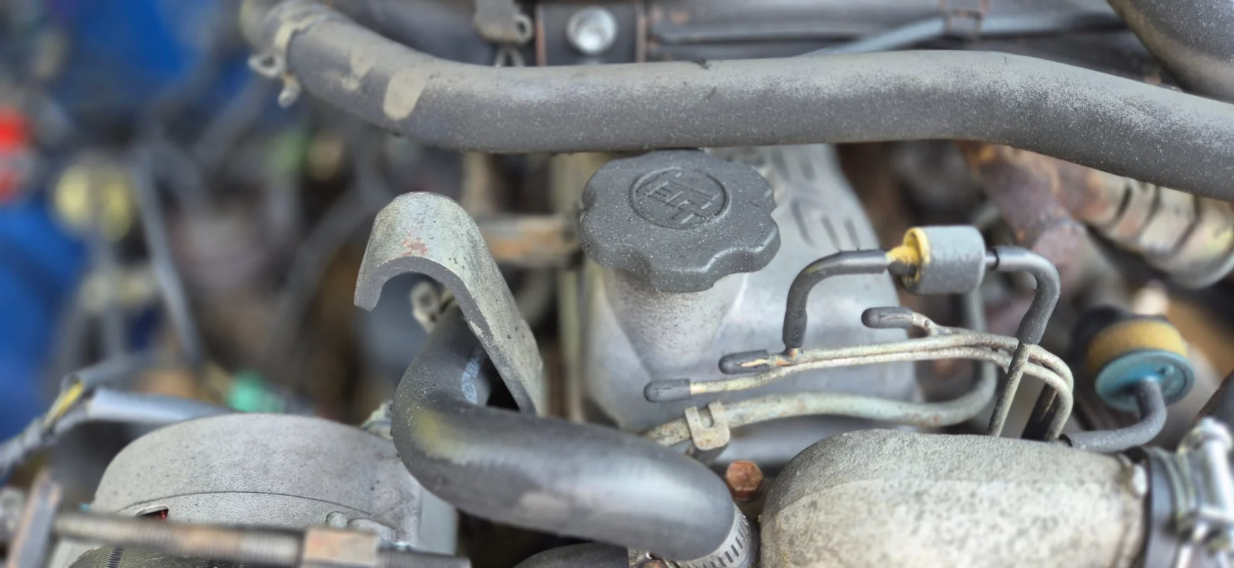

It's the pulley/belt below the PS pulley that's flapping loose and I think the source of the belt 'dust'.
Since the PS belt seems fairly tight and the alternator seems to be charging fine, I'm afraid that might mean more bad news, that the PS pump itself might be on its last legs. :/
Thoughts?
Below the PS pump is the smog pump, you should be able to adjust the tension on it via the long threaded bolt attached to the bracket. If the pulley isn't turning it's possible the smog pump is seized or beginning to, which is unfortunately common.
On intermittent PS, are you sure the system is bled of all air and correct fluid level?
Thanks for jumping in. So, yeah, figured it was the smog pump (it's been de-smogged) and am not sure if Danny left the (loose) belt on to fool the German TUV inspectors or if it was tight and has loosened since the greater amount of driving she's done here in Germany. I looked at some earlier pics and I can see a small amount of belt dust only on the fan blades. So, am wondering if the blet can be removed all together since it's passed initial TUV inspection. I just got finished tightening it to a normal tension but if it's not needed and/or on the way to Seizeville, that might not be prudent, either.
I guess the other option is to leave it as is and just accept the eingine bay being filled with dust, lol.
I also did check the PS pump level (glad we're on the same page) and it's at the 'hot' level, even though the truck is cold. I wonder if some bleeding is in order?

So, I loosened the smog/water pump belt back to where it's now only slightly tighter than when I started this process but in my eye/mind it seems too loose. But the belt screeching is gone. The fan and water pump, etc. seem to be working as expected but I'm concerned the belt will continue ejecting dust until it will eventually fail. I was always taught belts should be a certain tension and this one seems way too loose in my mind.
Belt squeal is generally from slipping on a pulley, and my bet is your smog pump is starting to seize. With the proper tension the belt is slipping on a pump that is reluctant to spin. It looks like all your smog equipment and associated vacuum lines are still present. Are you sure you're "De-smogged"?
I'd also check the other belts for proper tension, I had a similar squeal at similar RPM when cold on the water pump belt, a few turns to tighten the tension cured it.
So, it was de-smogged a long time ago and Danny actually added some vacuum lines to decrease the likelihood of the TUV guys thinking it was de-smogged, so and since you were unsure if it was, I guess it worked? ;)
All the other belts seem to be properly tensioned.
And, since I re-loosened the initial belt, the squeal is gone but that means the belt dust will continue. Sooooo... hmm.
