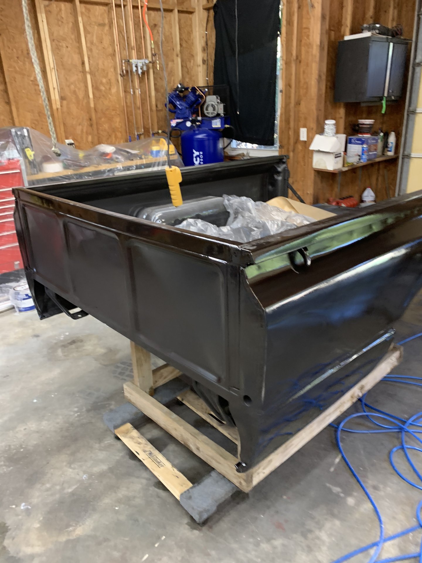

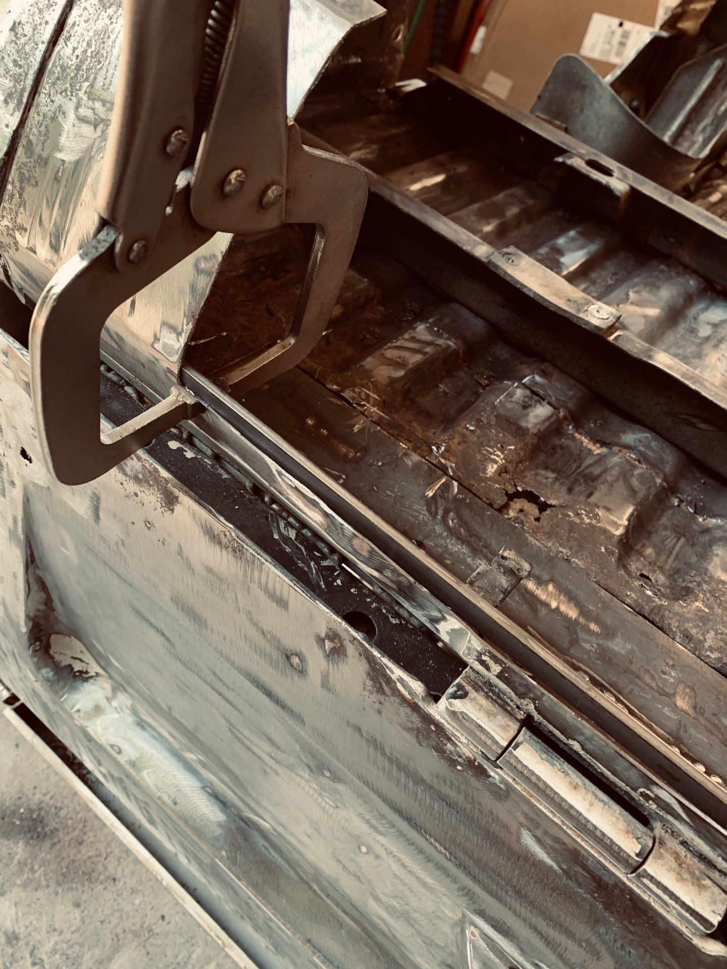

More work on the bed yesterday.
The body line inset is completely rusted. I attempted to bend a piece of 14 gauge and go past the body line. I couldn’t quite get the bend tight enough so I decided to cut out the length of the inset.
I was able to weld in a inch piece inside the body line and clean it up pretty good to keep the body line
shaved the driver side marker and went ahead and cut out the same area in the back of the bed as well
finished up the corners I started a few days ago. They were pretty bad so I am happy with the result.

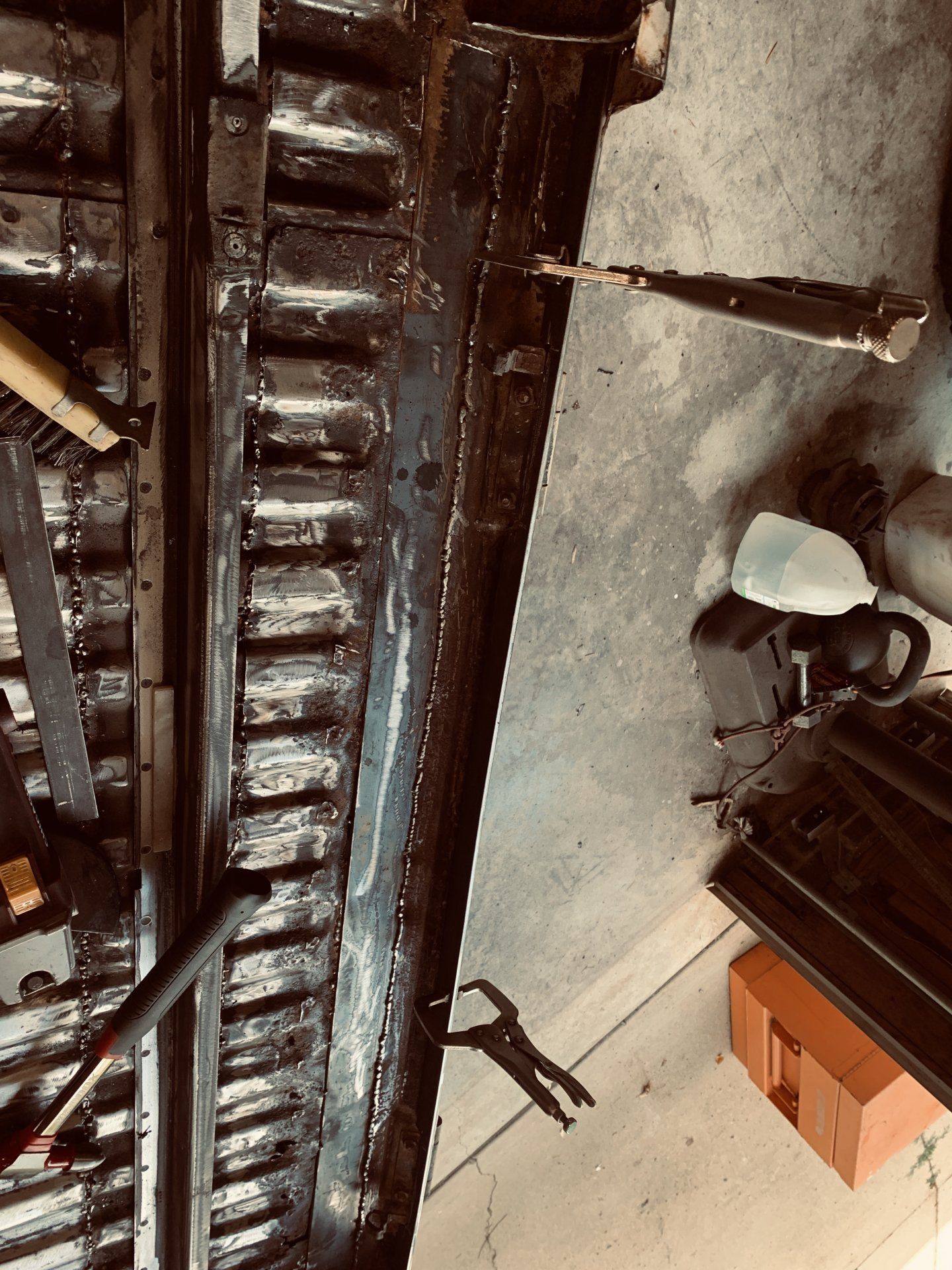

Today’s progress. When I built the bumper I roughly plasma cut the bottom of the bed where the license plate use to be. I went ahead and cleaned up the cut.
Hard to tell but I went ahead and reinforced the bottom of the tailgate. With how little sheatmetal was left in that area I didn’t want the tailgate to rip off the bed floor.
I already had 3/16 x3” plate that I added when I cut out the bed floor that was pretty rotted out. I went ahead and finished welded it from the
I also went ahead and added 1”x 3/16 flat stock to strengthen and straighten the area where the tailgate used to be.
I think I have one more day worth of work on the bottom of the bed and I should be able to POR 15 it. But first I want to do some metal prep with ospho.
then I will flip the bed and finish up a few more things like the tailgate.

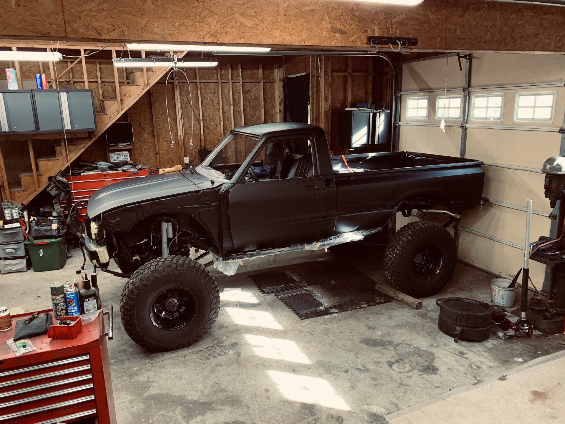

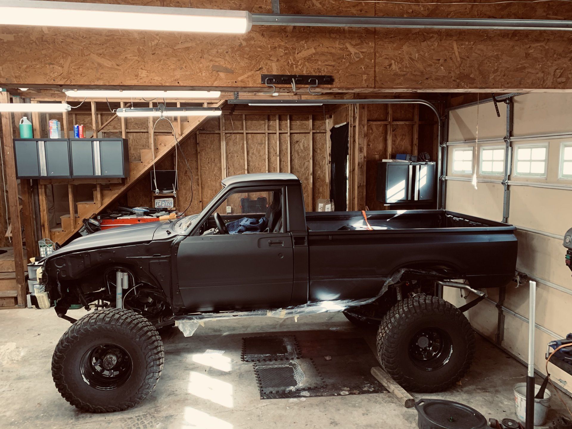

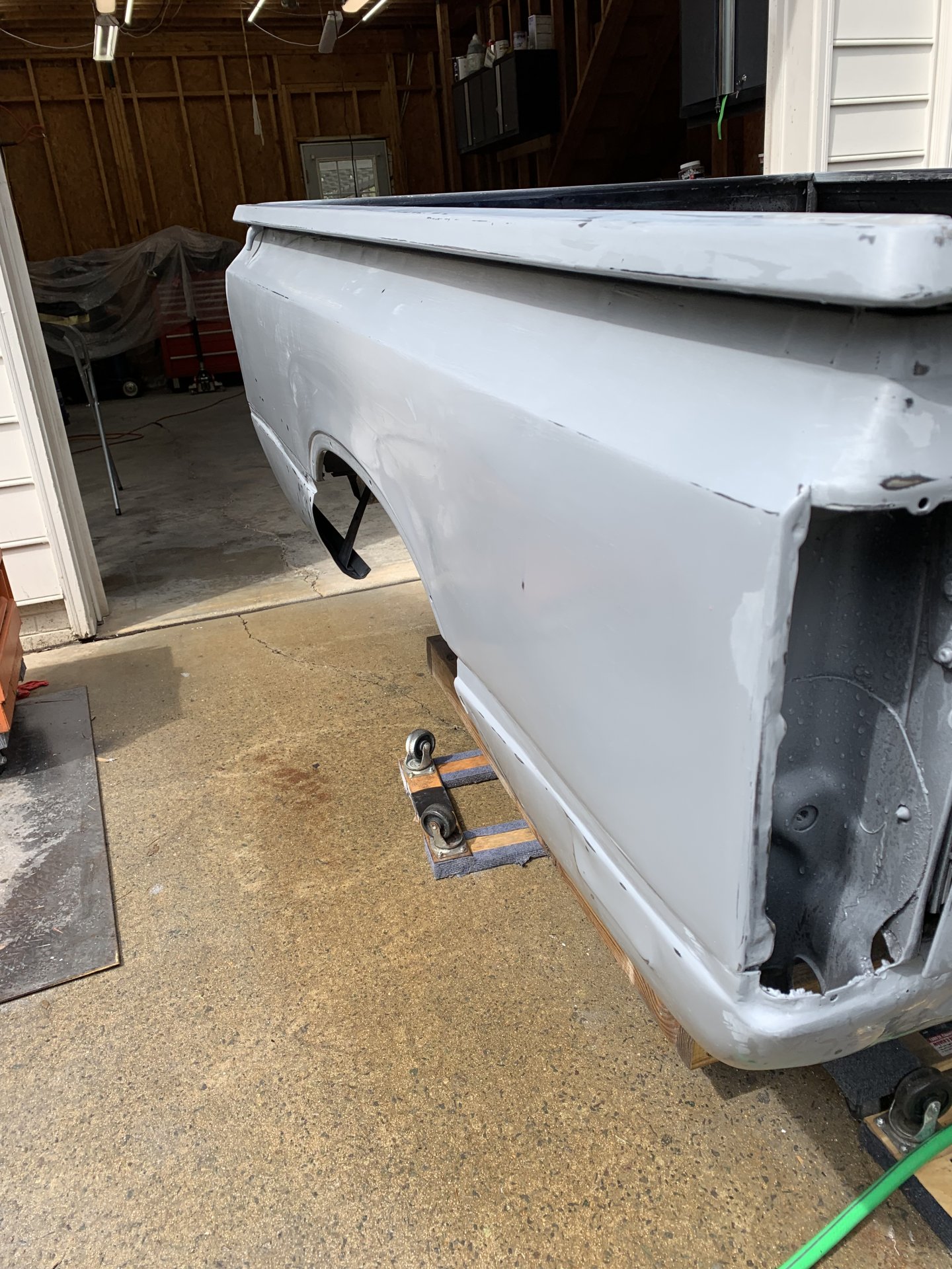

Seating in the garage just begging for some body work. Now that the epoxy primer is dried out I can see that most of the truck is pretty straight. The major areas will be the bed sides where I did most of the metal patching to remove rusty areas.
[/QUOTE]
it looks like an RC car.
Some body work progress. Been doing 1 to 2 hours at night but had ran out of 40 and 60 sand paper so progress was very slow going until I got some more in today. My homie came by today and gave me a hand.

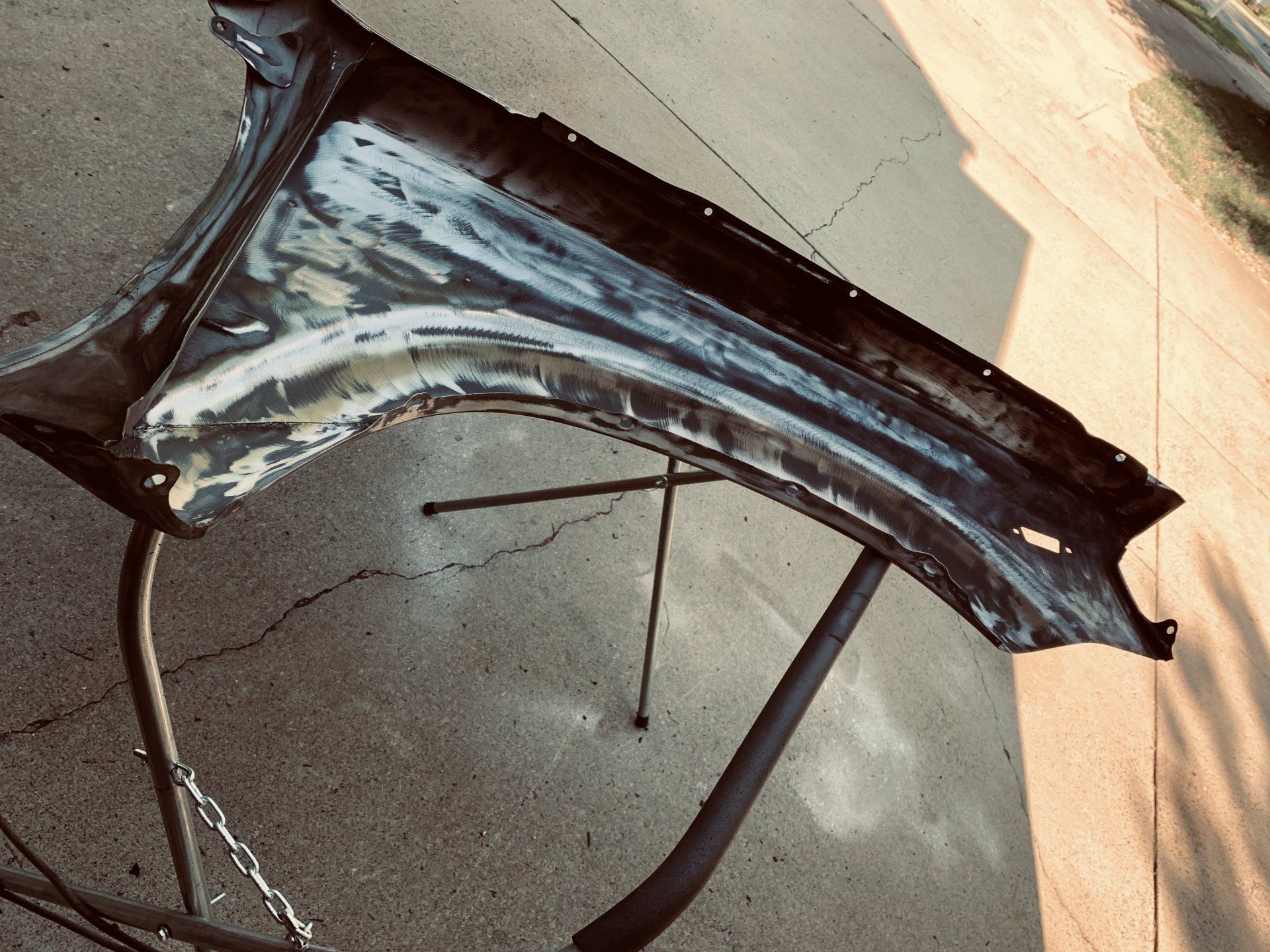

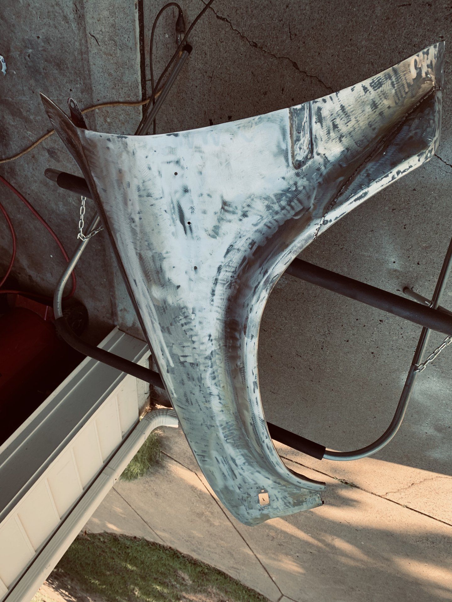

Here are some body work progress shots of the work I completed this week.
Note to add now that I have a better welder and my welding skills have improved I did spend a portion of the time fixing or improving some previous repairs.

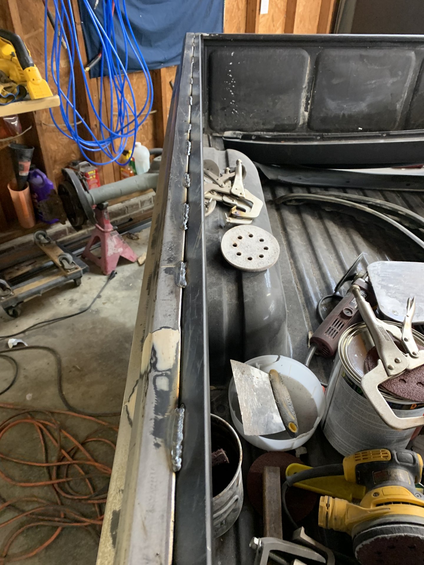

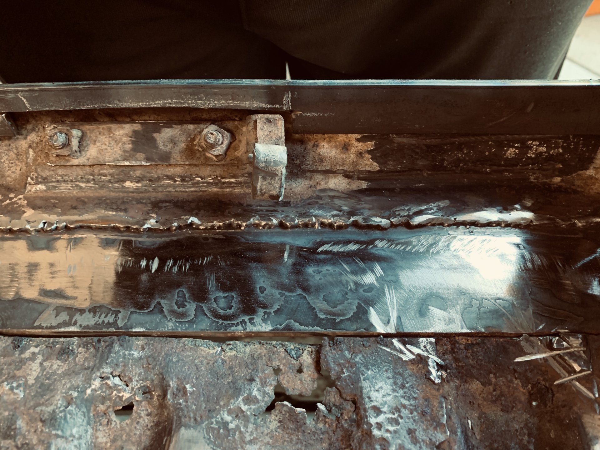

The bed rails are too thin on this style bed so I added to them with 1 inch tubing. This will make it easy to use the standard aluminum clamps to attach the camper I want to install on the bed.

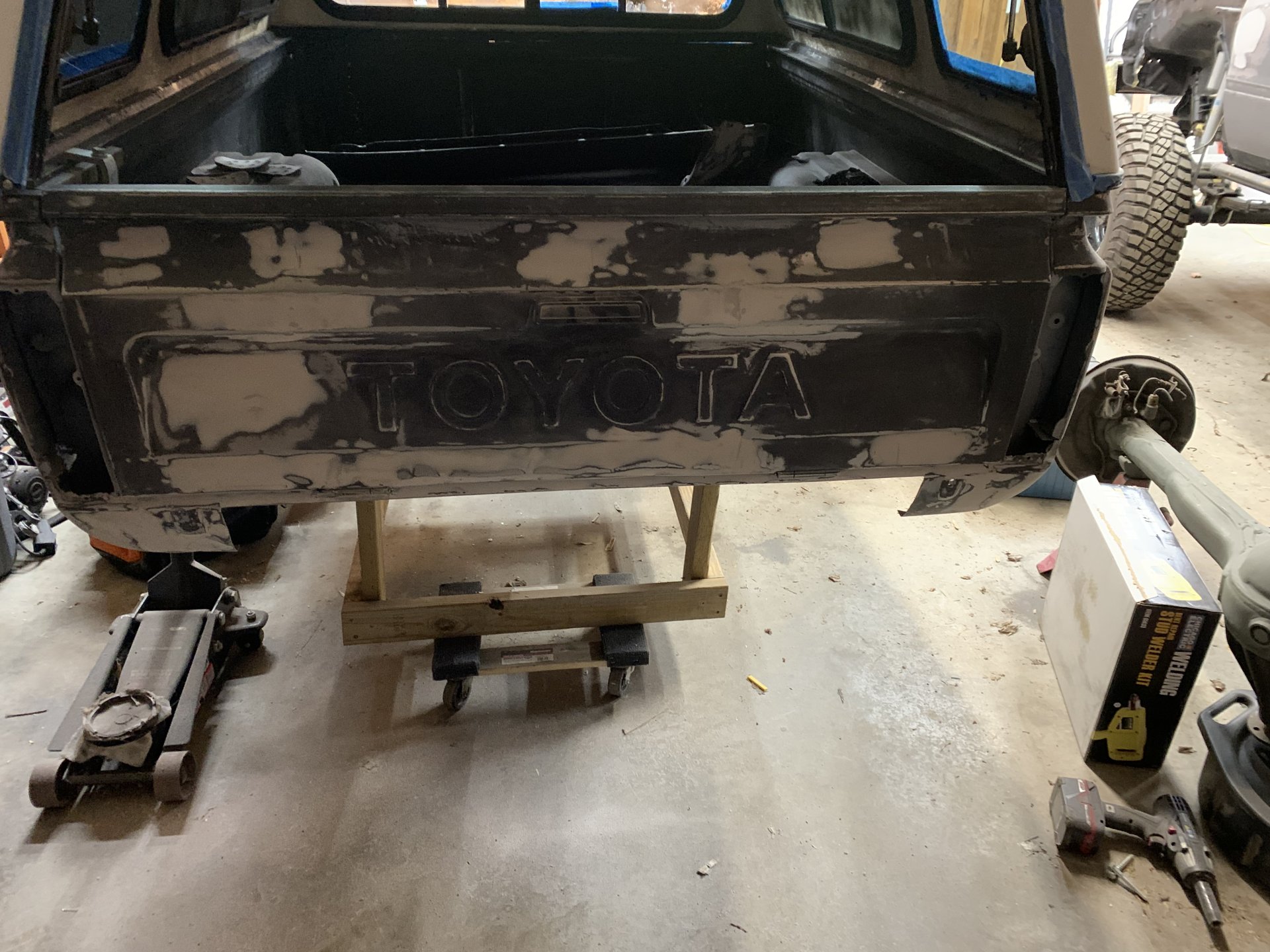

I spent a whole day messing with the tailgate. After I inspected I was never very happy with the reload I did to it so went back and redid it again but better. It still is t perfect but it is as good as it is going to get considering the shape of it when I started.

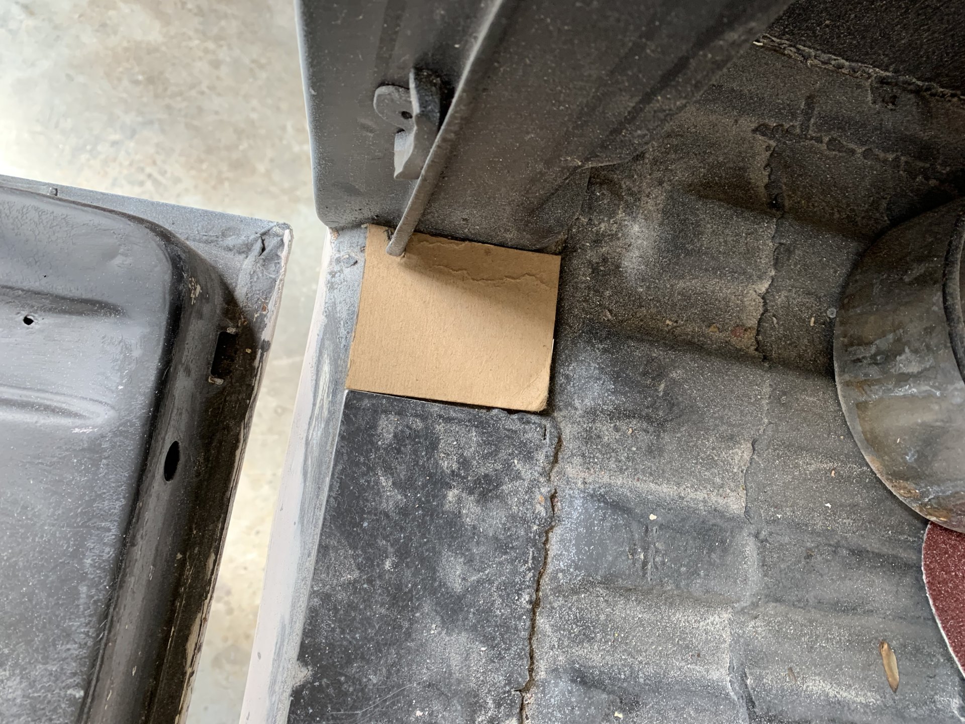

Completing some of the previous rust repairs I finished up the bed reinforcement with 3/16 plate patches (I cut out the original rusty bed floor in this whole area.

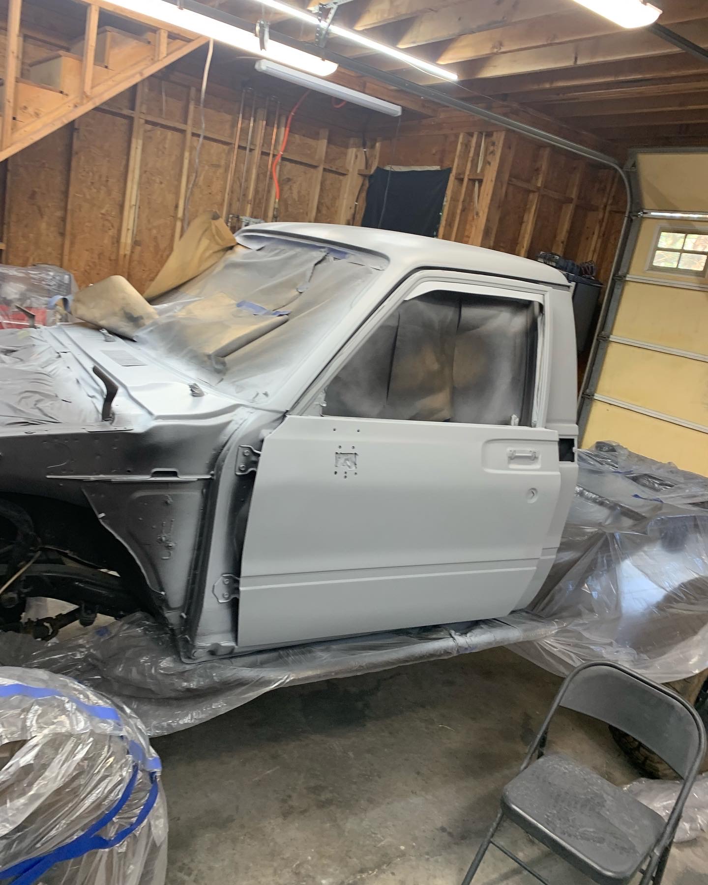

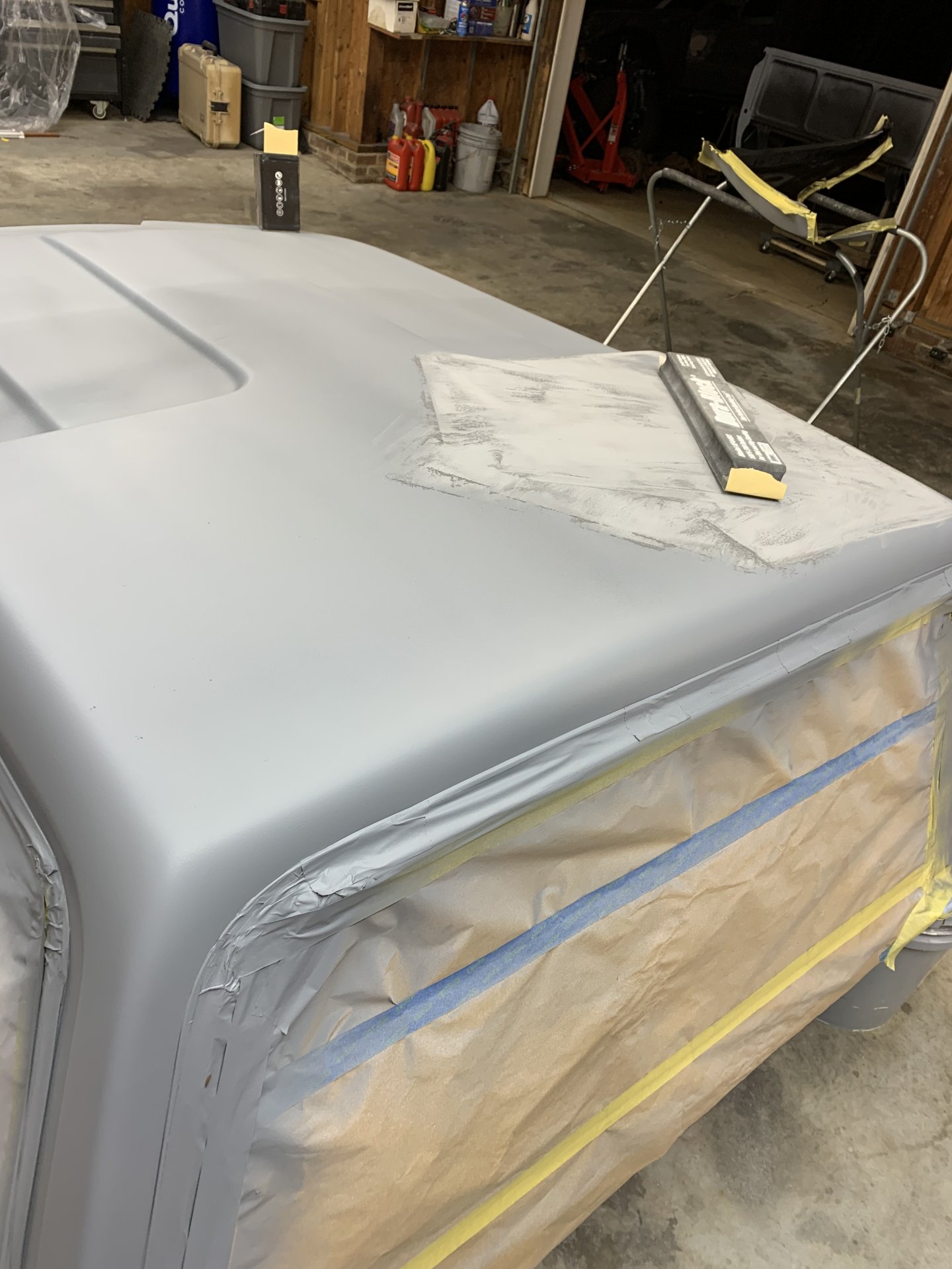

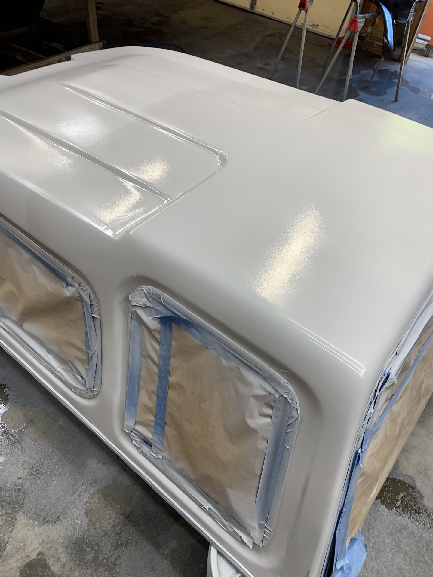

After going over the body work one last time I applied another coat of epoxy primer sealer to the bed and fenders and high build primer to the camper shell
After the epoxy primer I applied the high build primer to the camper, bed and fenders and began sanding. Started block sanding with 320 grit.
then I guide coated the panel and finished the parts with 400 grit

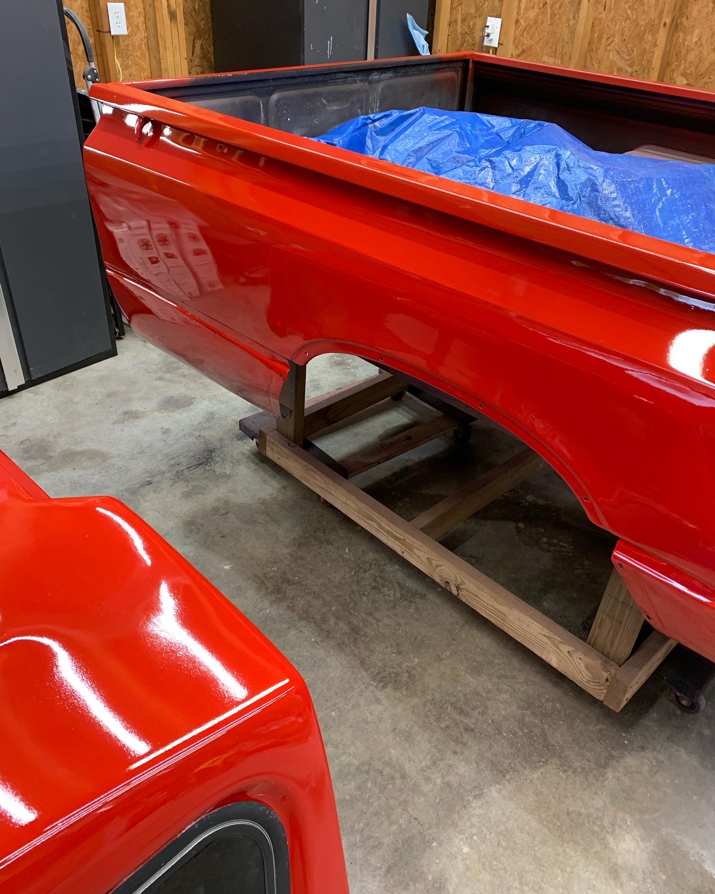

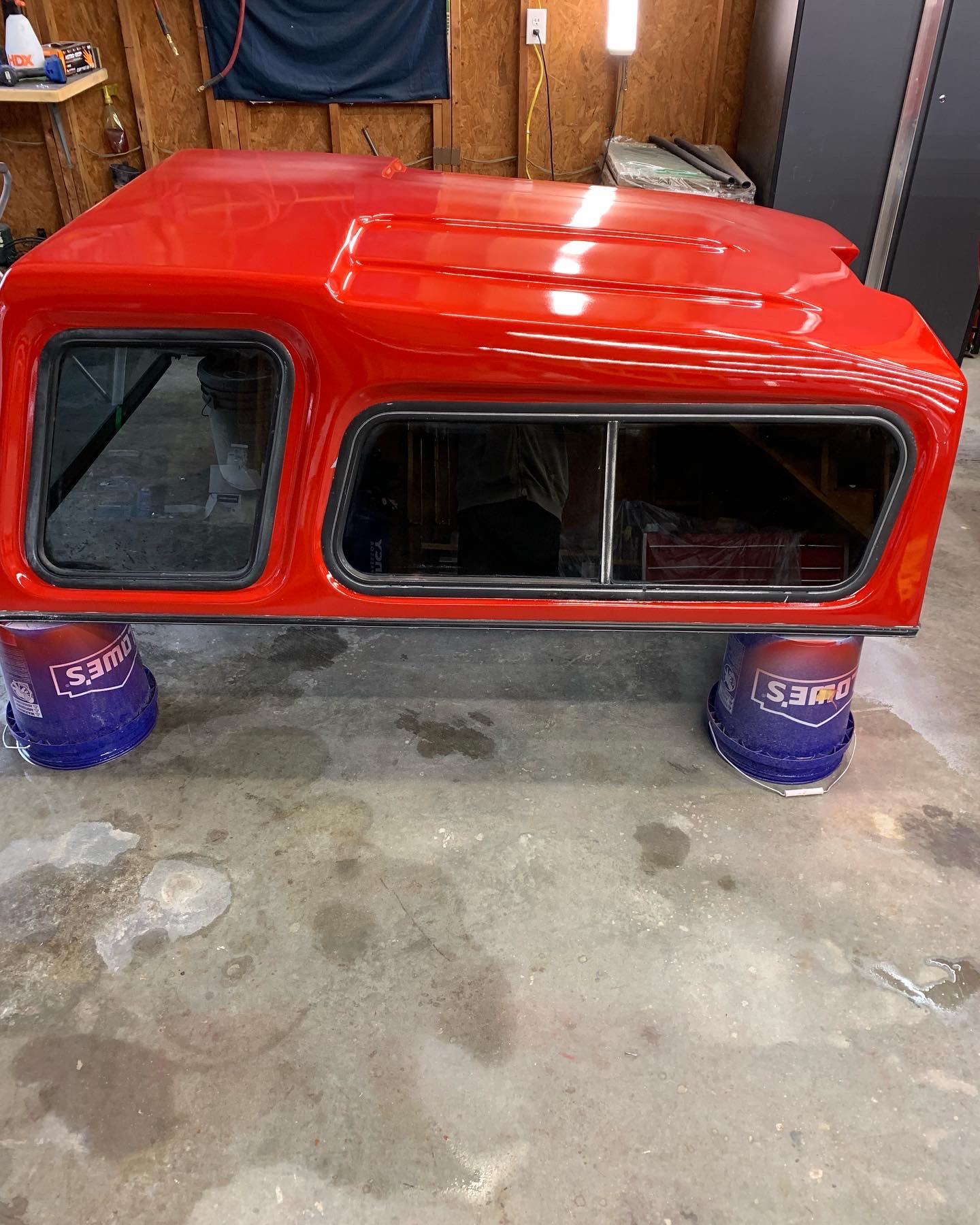

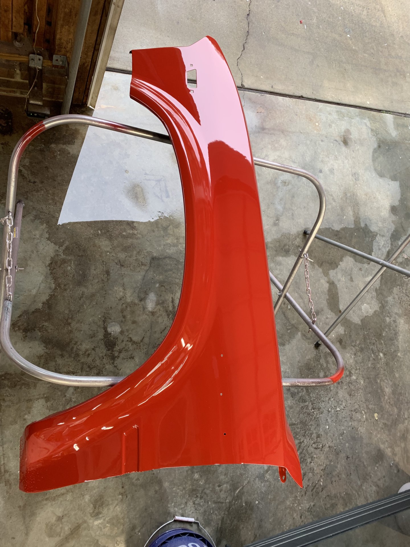

Finally I got the panels painted. I went with an fj40 freeborn red paint code.
I sprayed 2 coats of base coat and 2 coats of clear.
I am very happy with how it turned out.
