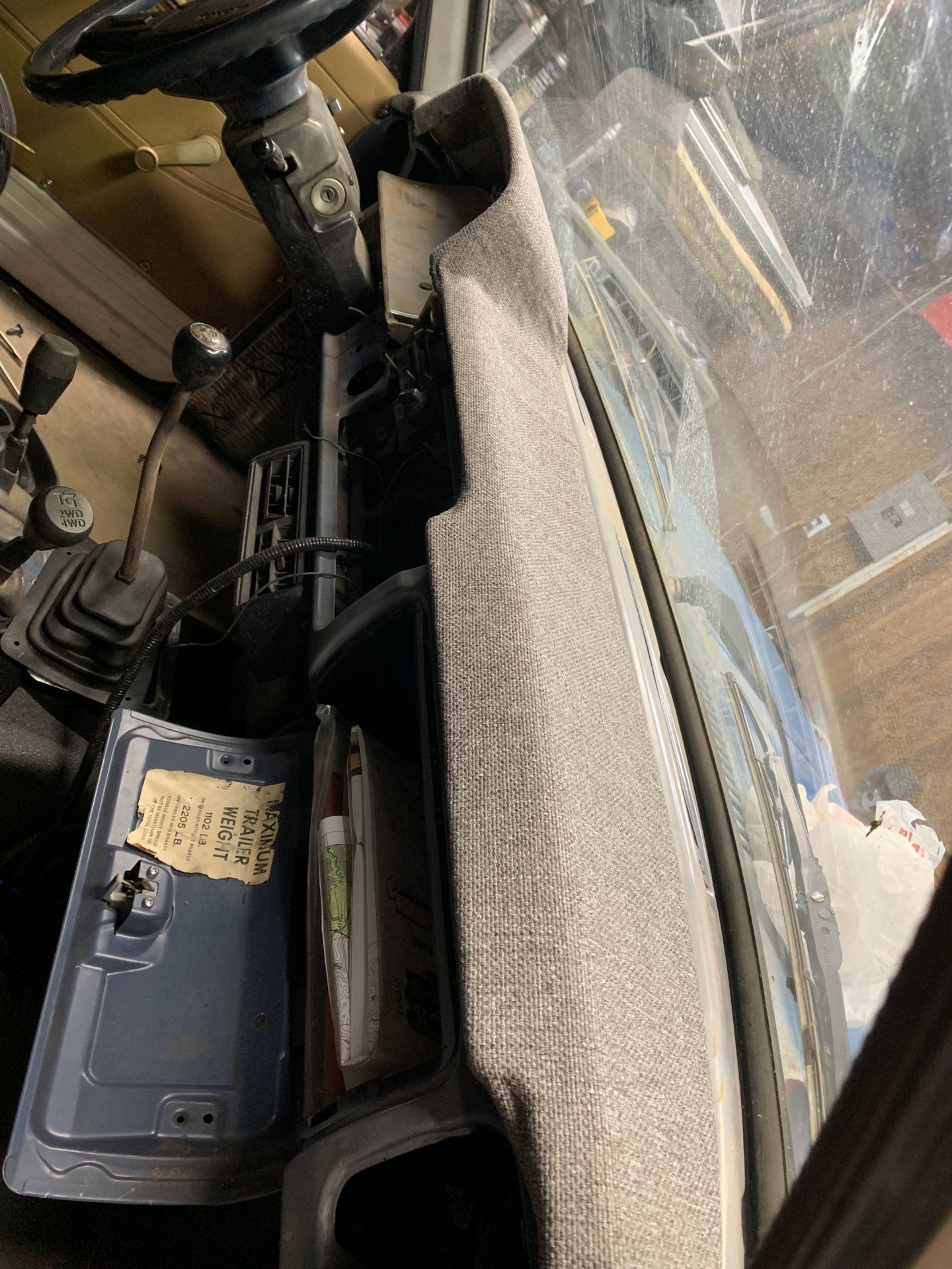

Dashpad was reinforced with liquid nails then grinded down then wrapped in grey material

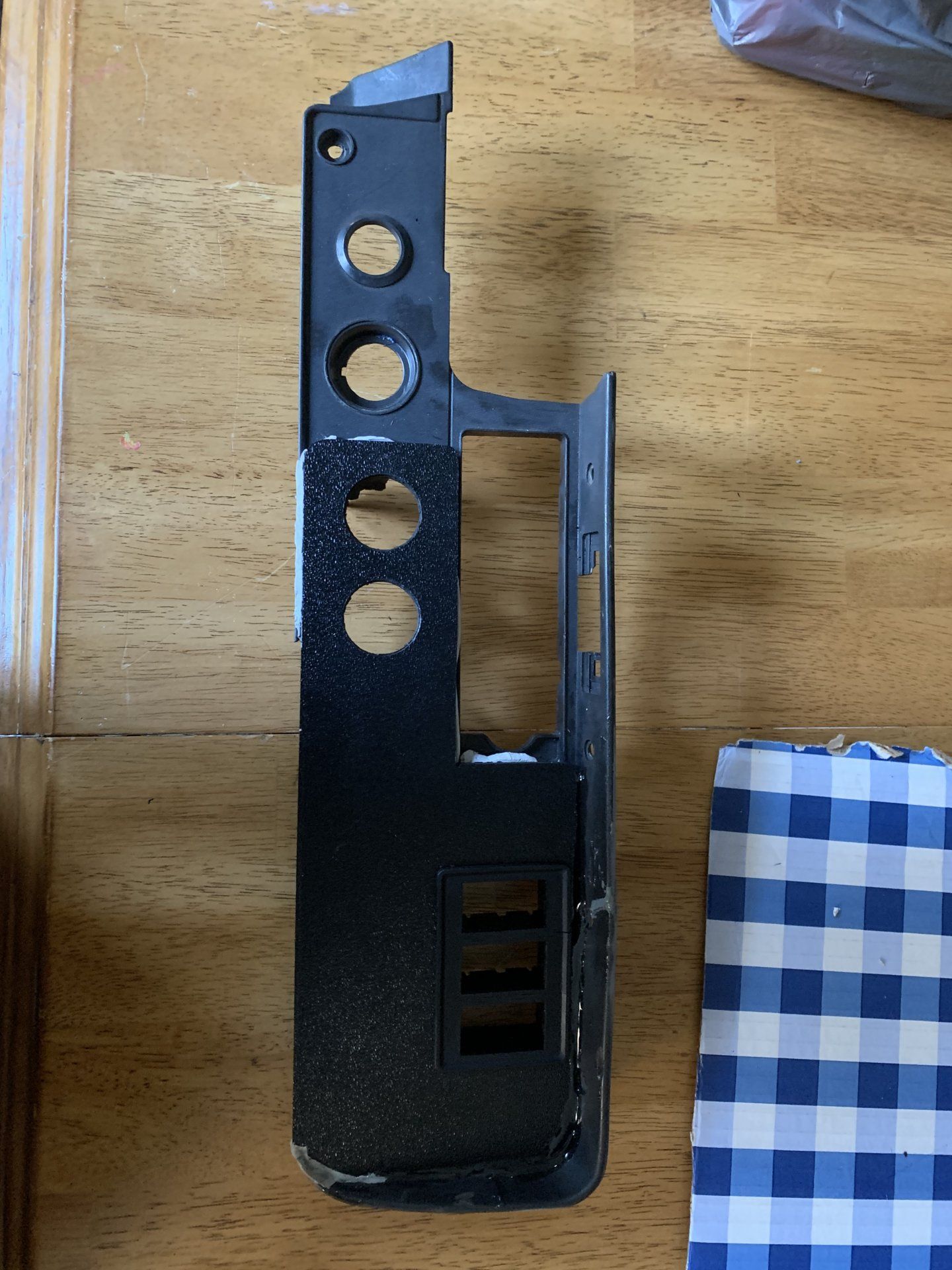

Middle dash piece was cleaned fixed up broken pieces with jb weld

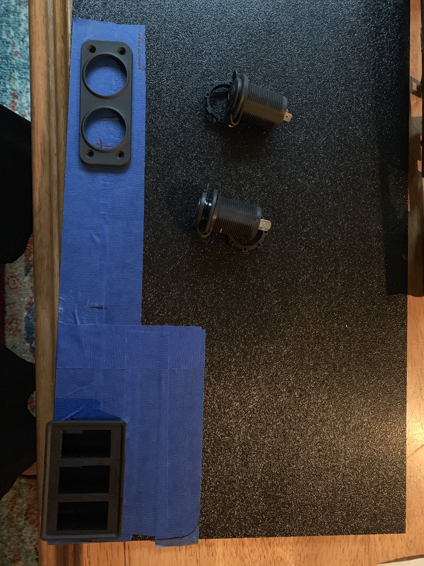

Measured out a fill piece out of abs board. With 2 12volt outlets and three switches for my arb lockers front and rear and air compressor.

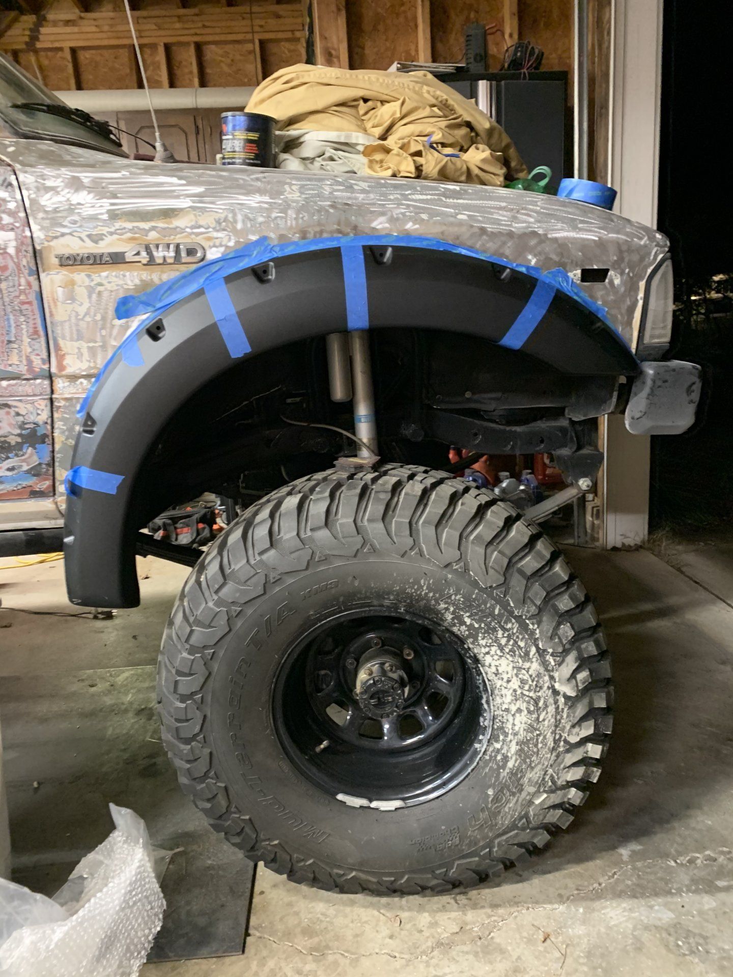

Cleaning the garage I found these brand new fender flares my buddy gave me for my f250. I tried them on the mini and surprisingly they fit the fender wells almost exactly. I am thinking I am going to cut them and section them to size and bolt them on the truck.
With the new axle housings I have, my tires stick out quite a bit. Nobody makes anything for this truck anymore so this will be a cheap solution. To top it off. I think they look great and will make the truck look a little different and in my opinion better
I’d attempt to mount them with double-sided foam (3m) tape and tension before drilling holes in the fenders.

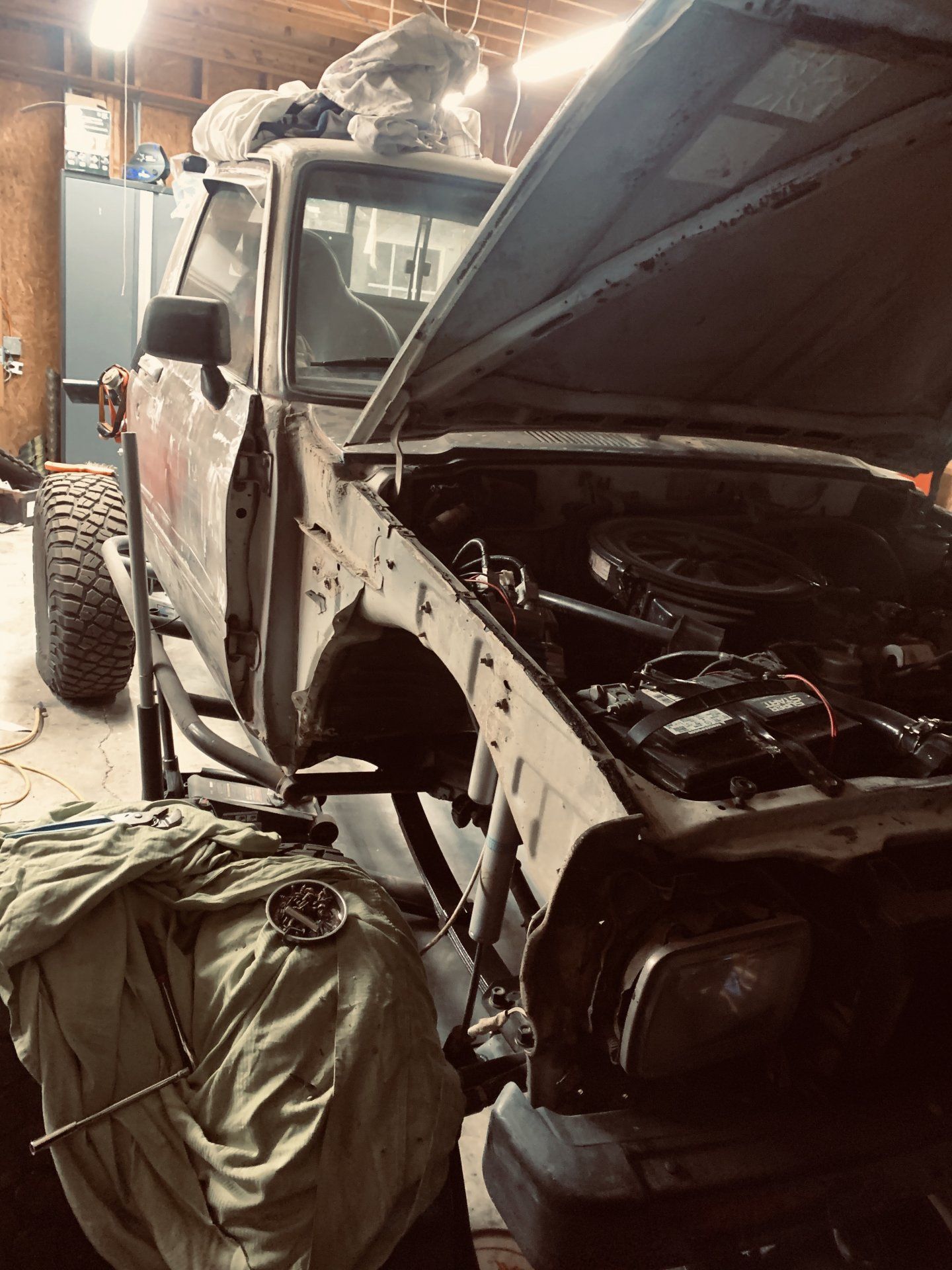

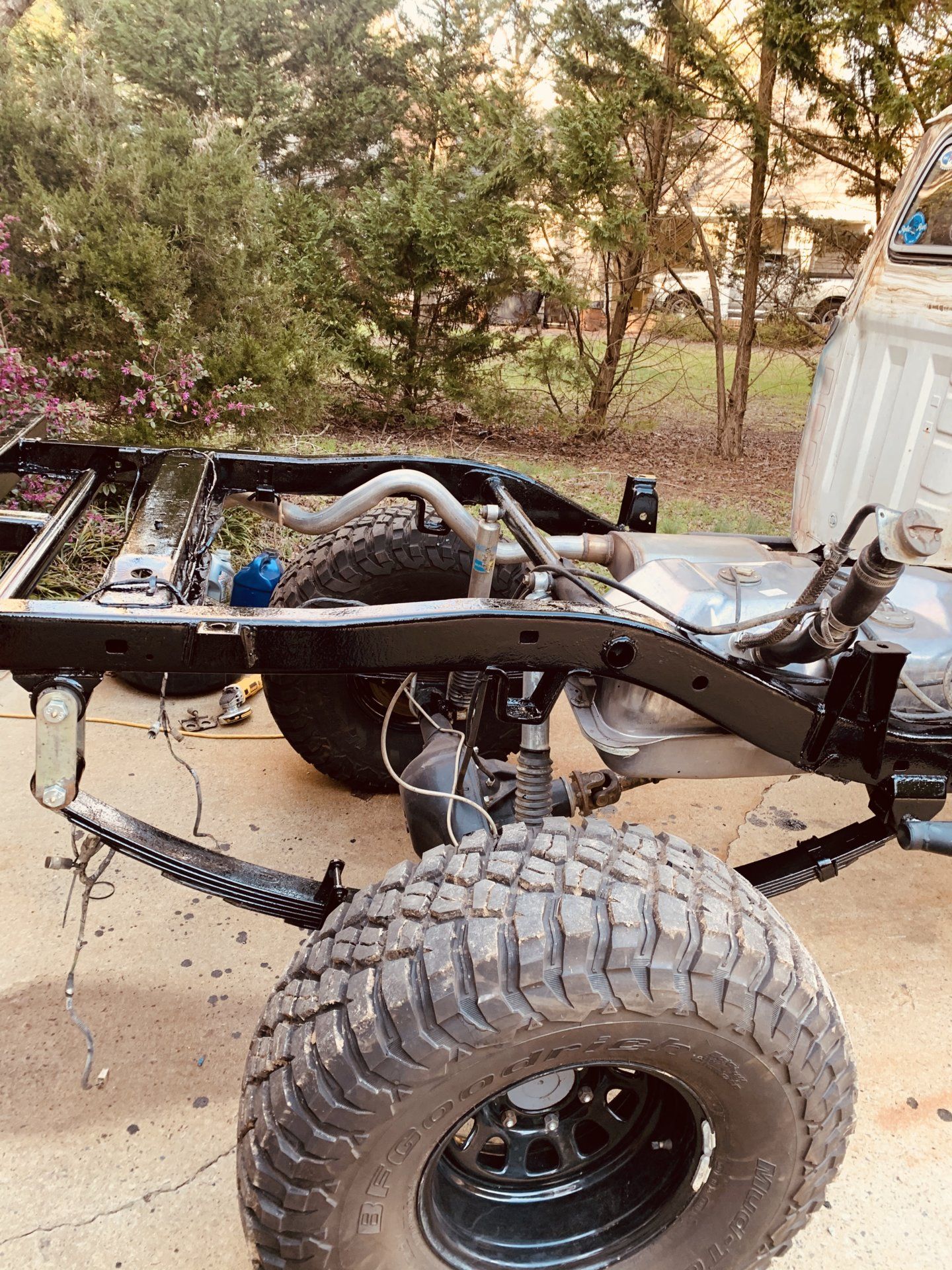

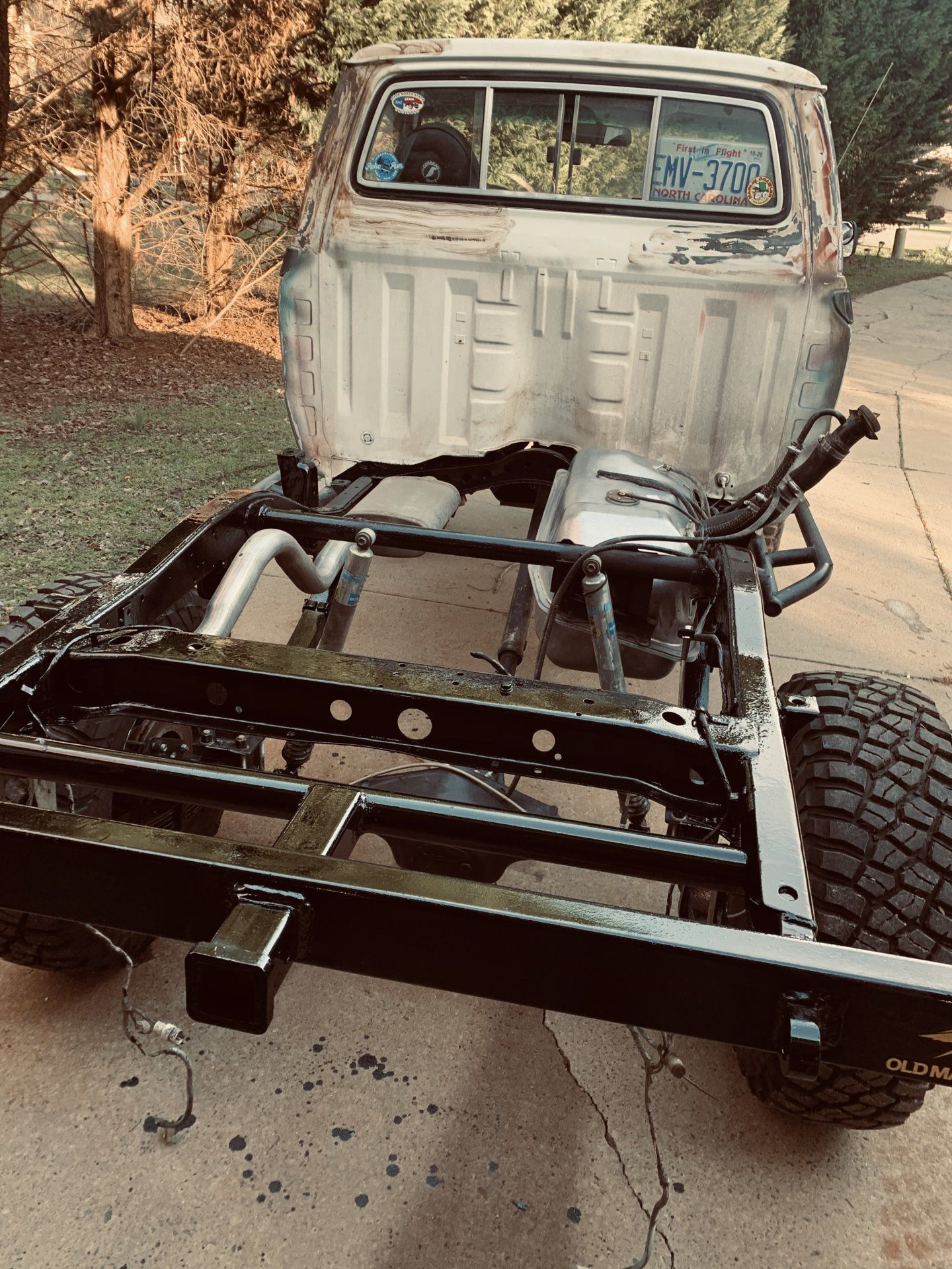

Finally got a chance to spend some time in the garage. Got a few things done to the truck to get it ready for wheeling season. Chased down a bad ground and a blown fuse to fix the tail lights. POR 15ed the rear half of the frame. Fixed the passenger bracket to the rear disc brakes. Finally figured out the adjustment on the parking brake and it finally works. Cleaned the muddy engine compartment from the last wheeling trip.
Did some much needed upgrades today before it heads to the body shop.
LED H4 bulbs in the headlights. This was a very nice upgrade to the s***ty light bulbs that came with the housings I bought over a year ago.
also, finally found the Toyota wheel adaptor to be able to install a smaller thicker wheel. This should make it more comfortable to drive since the off-road seats are a little on the high side.

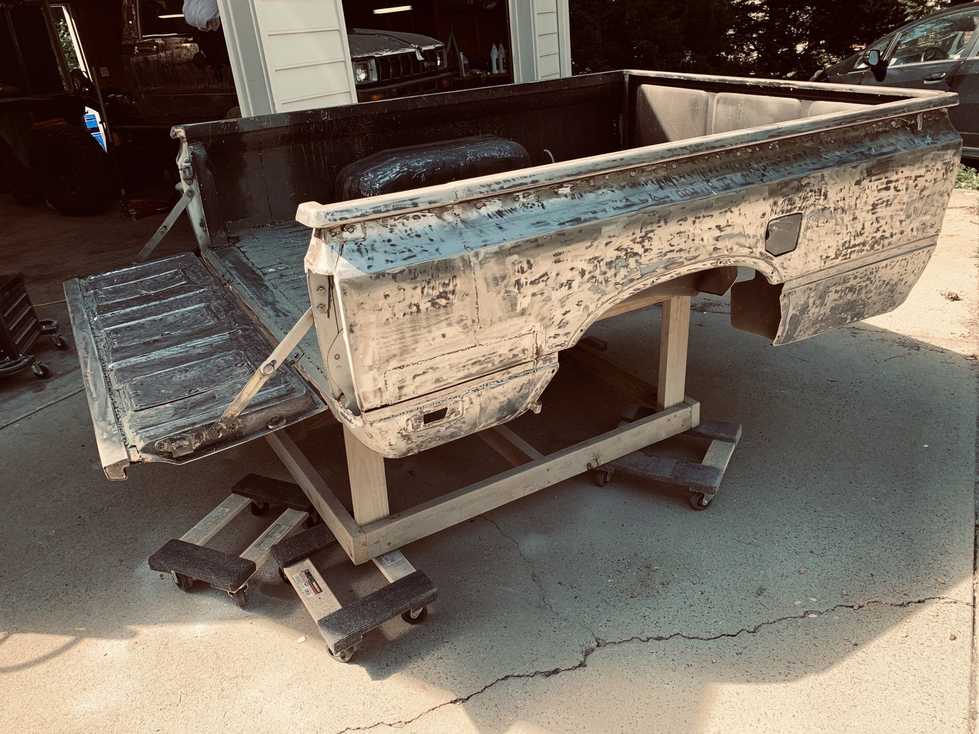

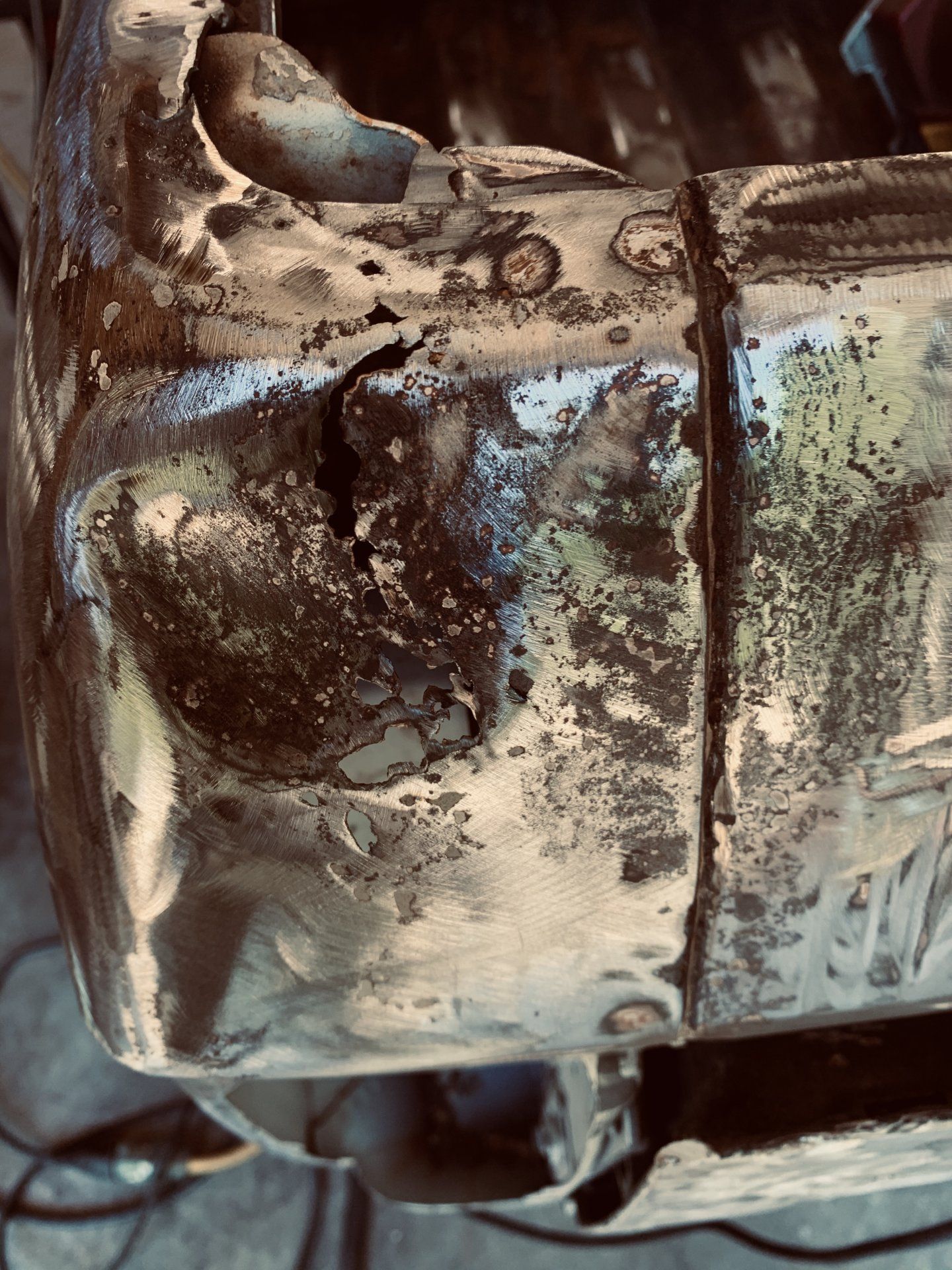

This is some of my progress on the bed. Stripped the bed liner stripped all the paint and body filler. Cutting major rust out first then moving on to hammer and dolly to straighten out the panels to minimize the amount of body filler after. The bottom and top of the bed floor will be painted with POR 15 to prevent more rust. The inside of the bed will be raptor lined and color matched to the body.

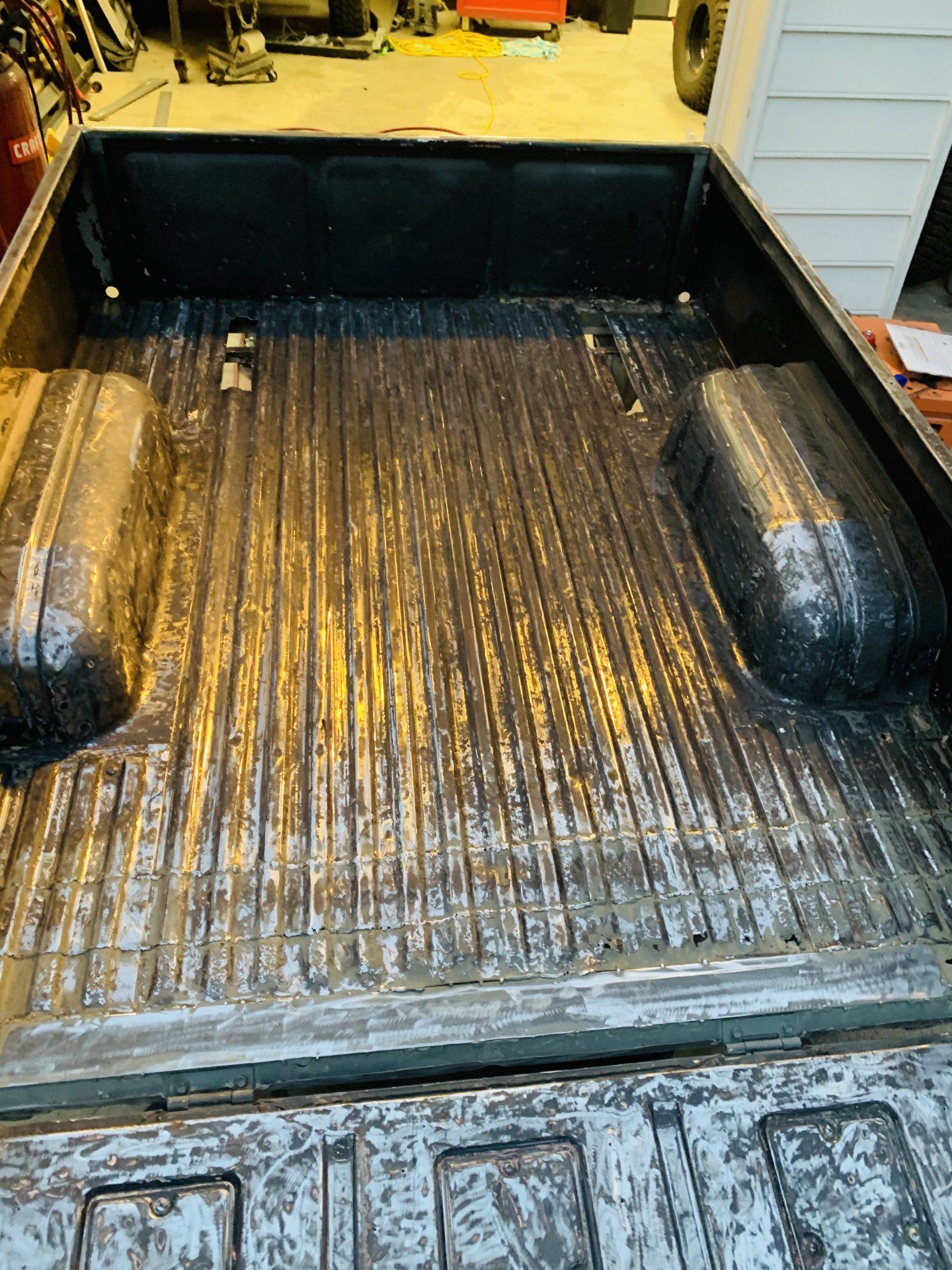

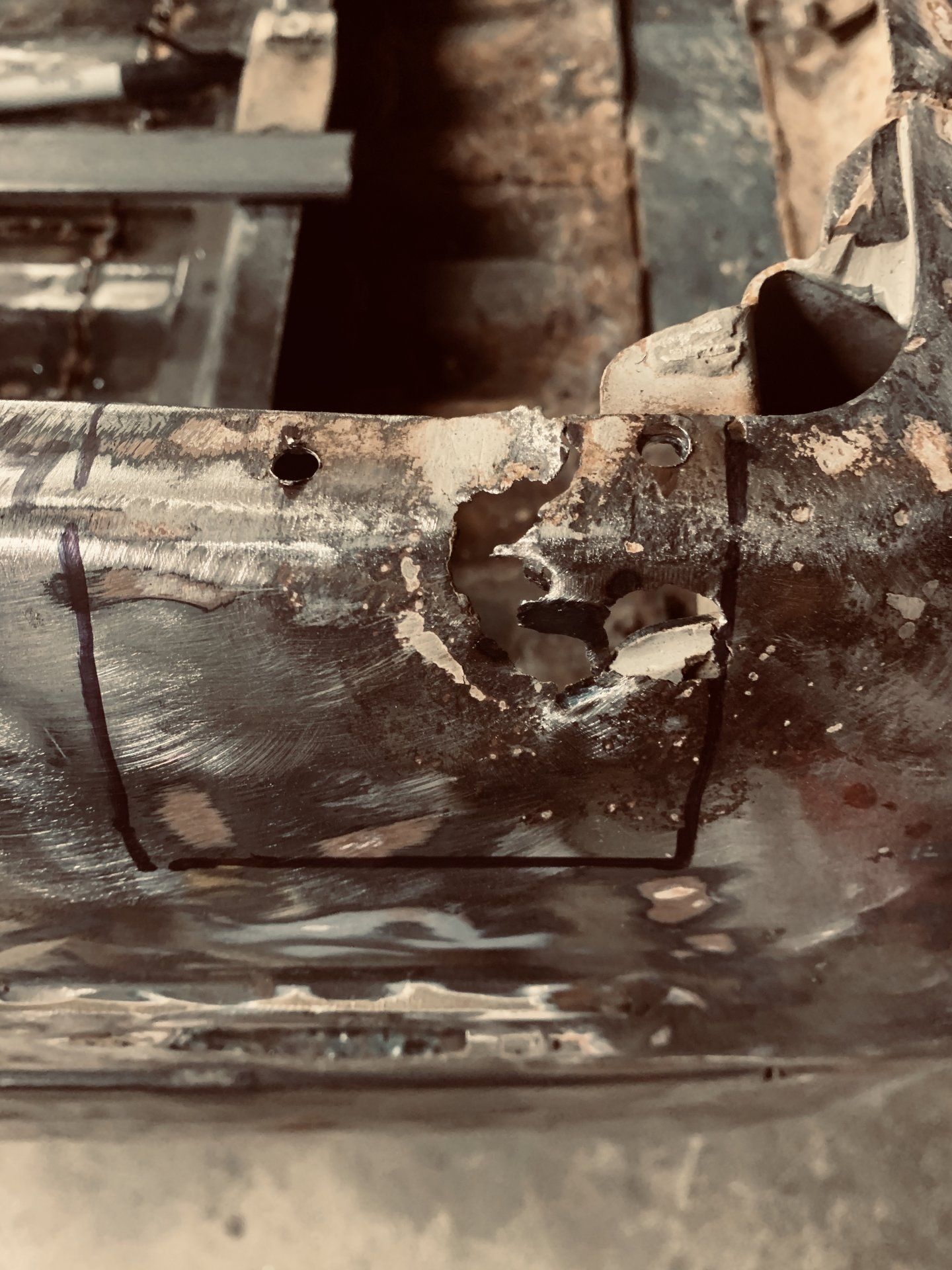

Did some more metal work on the bed. Removed any areas that were showing signs of rust. Mostly in the bed floor and along the body line on both passenger and driver side.

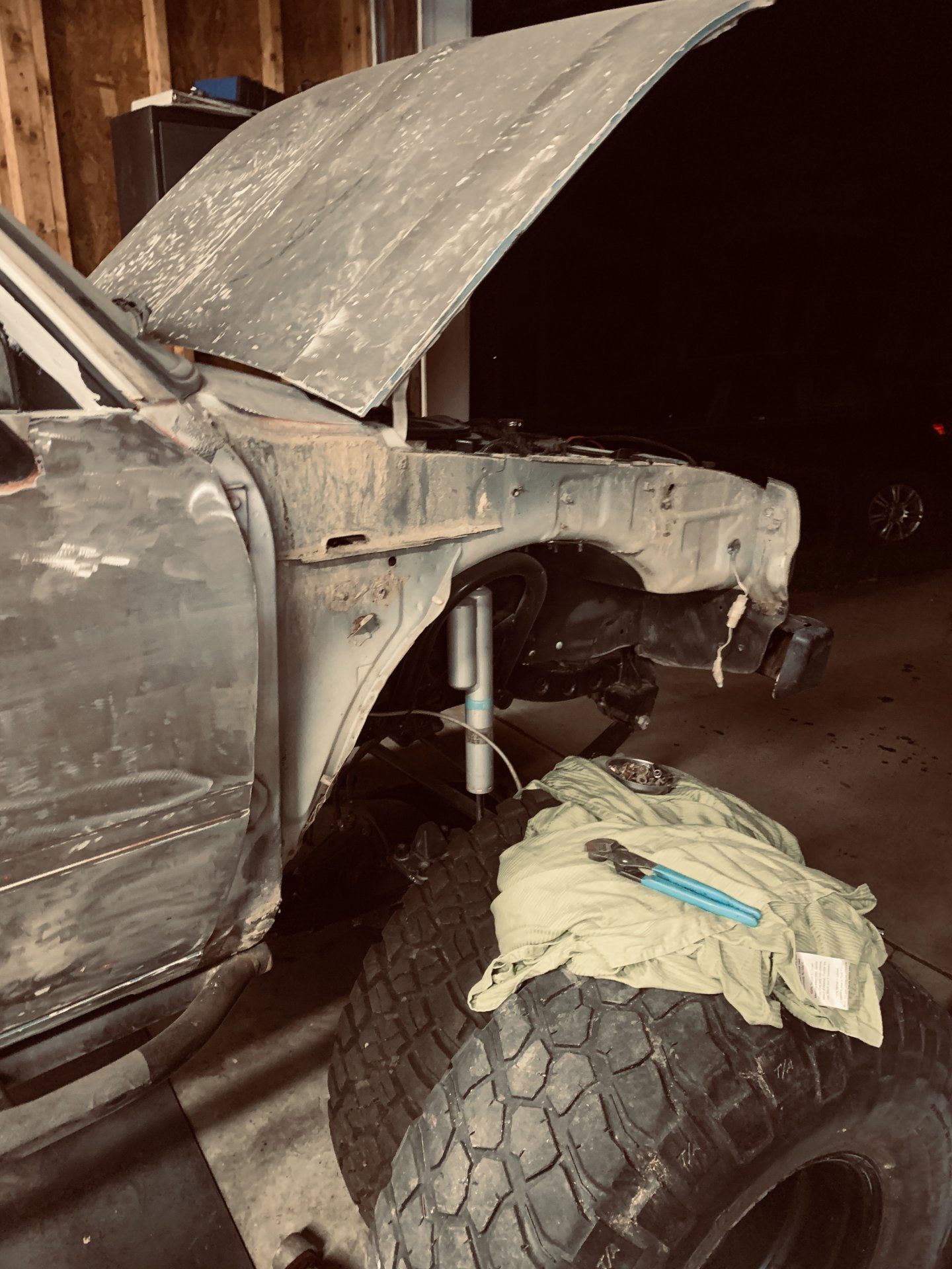

Pulled the fenders, they are mostly good. Going to add a small lip where I cut them in the front just because I think it would stiffen it up and make it look a little nicer.
going tocover the antenna hole since I don’t need the antenna.
Going to POR 15 the inside of the fenders and the part of the body behind the fenders tomorrow

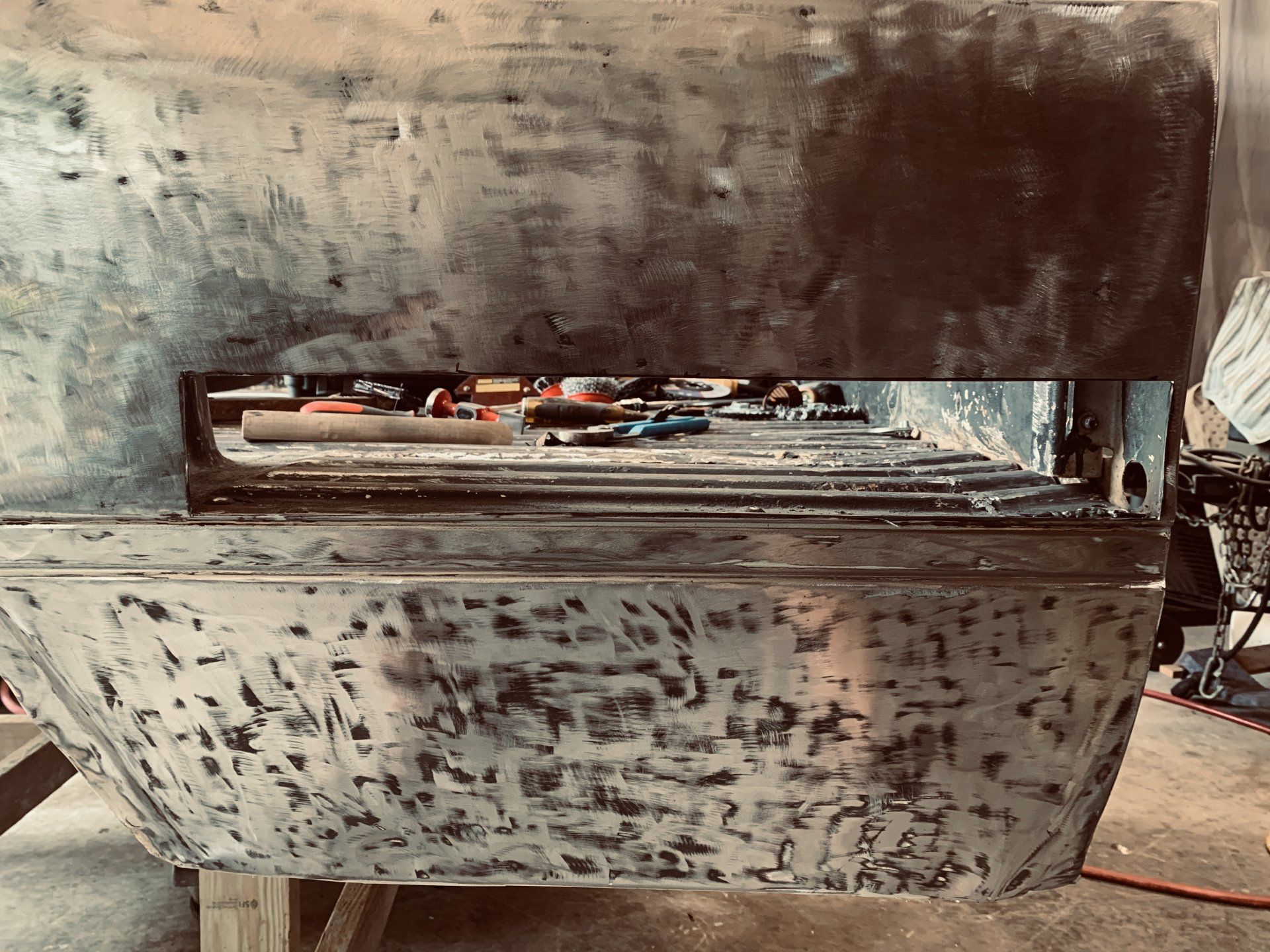

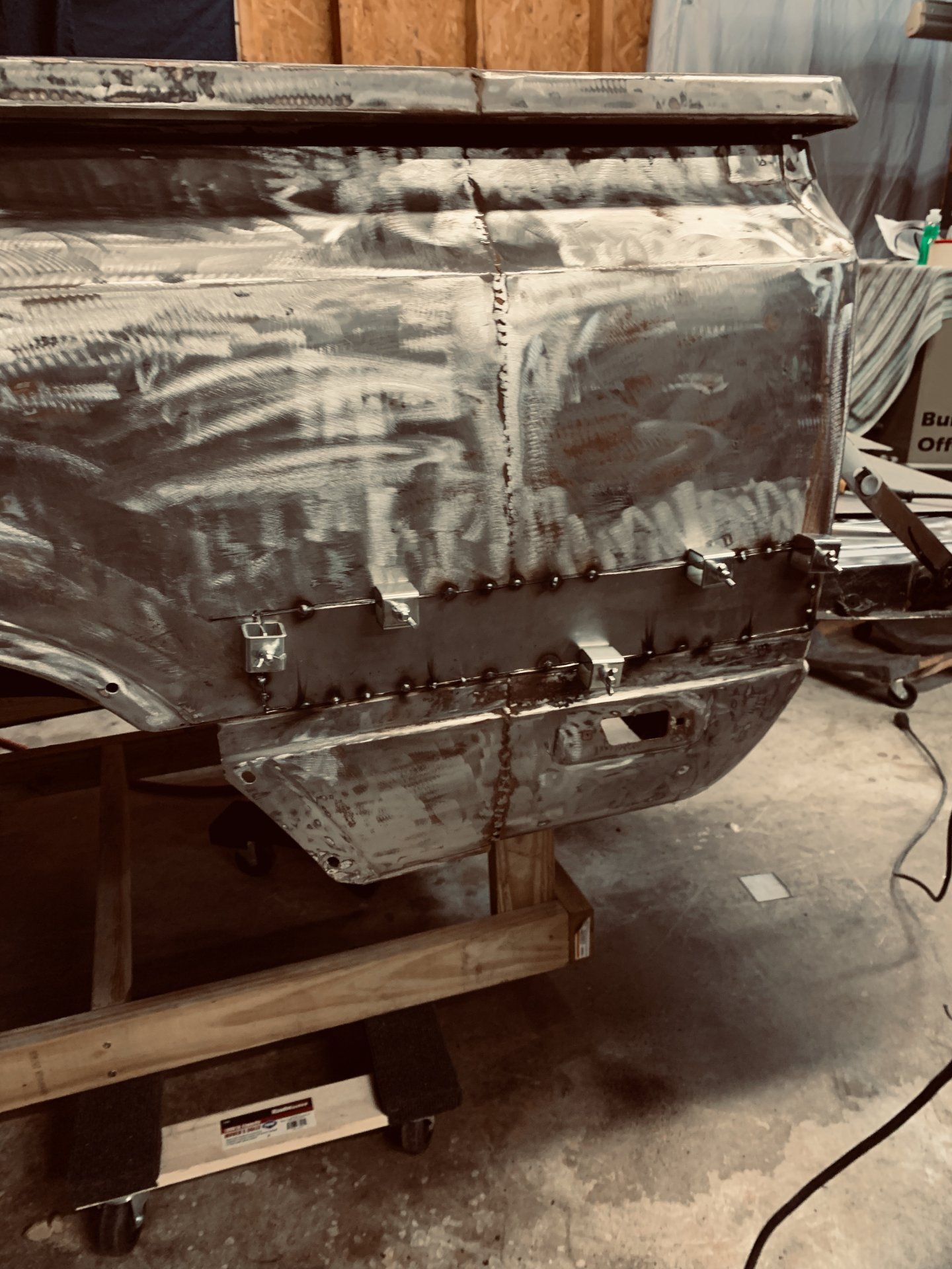

More rust repair on the bottom half of the bed.
also added 1 inch 3/16 flat stock to the bottom lip to stiffen the bed sides. I also added kickers to help support the bed sides. Now the bed sides don’t move at all.
Also began stripping the bottom of the bed. Still needs a little more but it’s mostly done. Once completely stripped I am going to POR 15 the whole bottom of the floor board. Then I will do the same to the top side. Hopefully this encapsulates the bed floor and prevents any more rust.

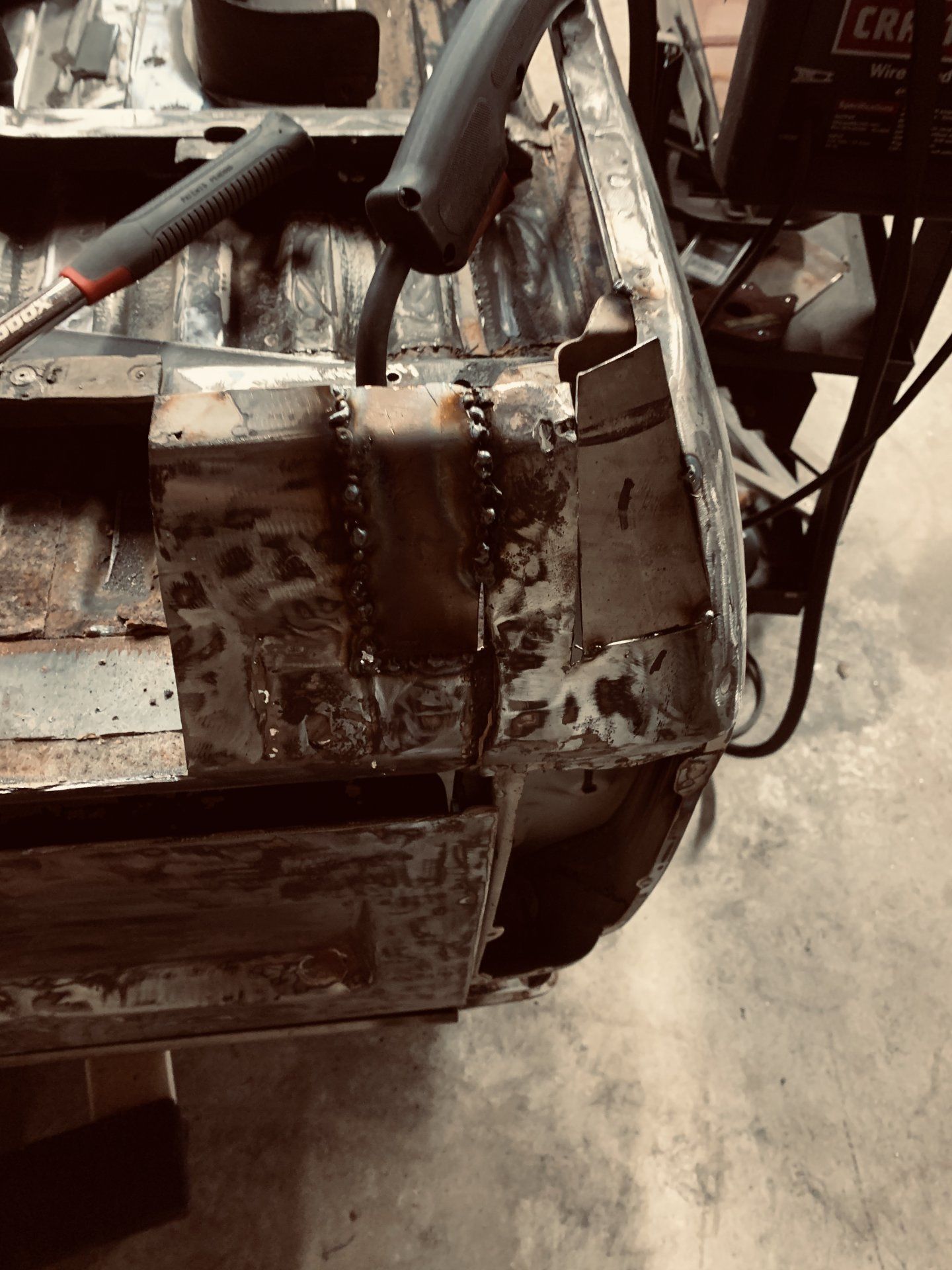

More rust repair. Cutting out rusty parts of the bed as well as shaving the quarter lights. I’m going to go with smaller aftermarket ones.
I had to bend the replacement pieces to match the contour of the bed corners. It was a lot easier than expected.
