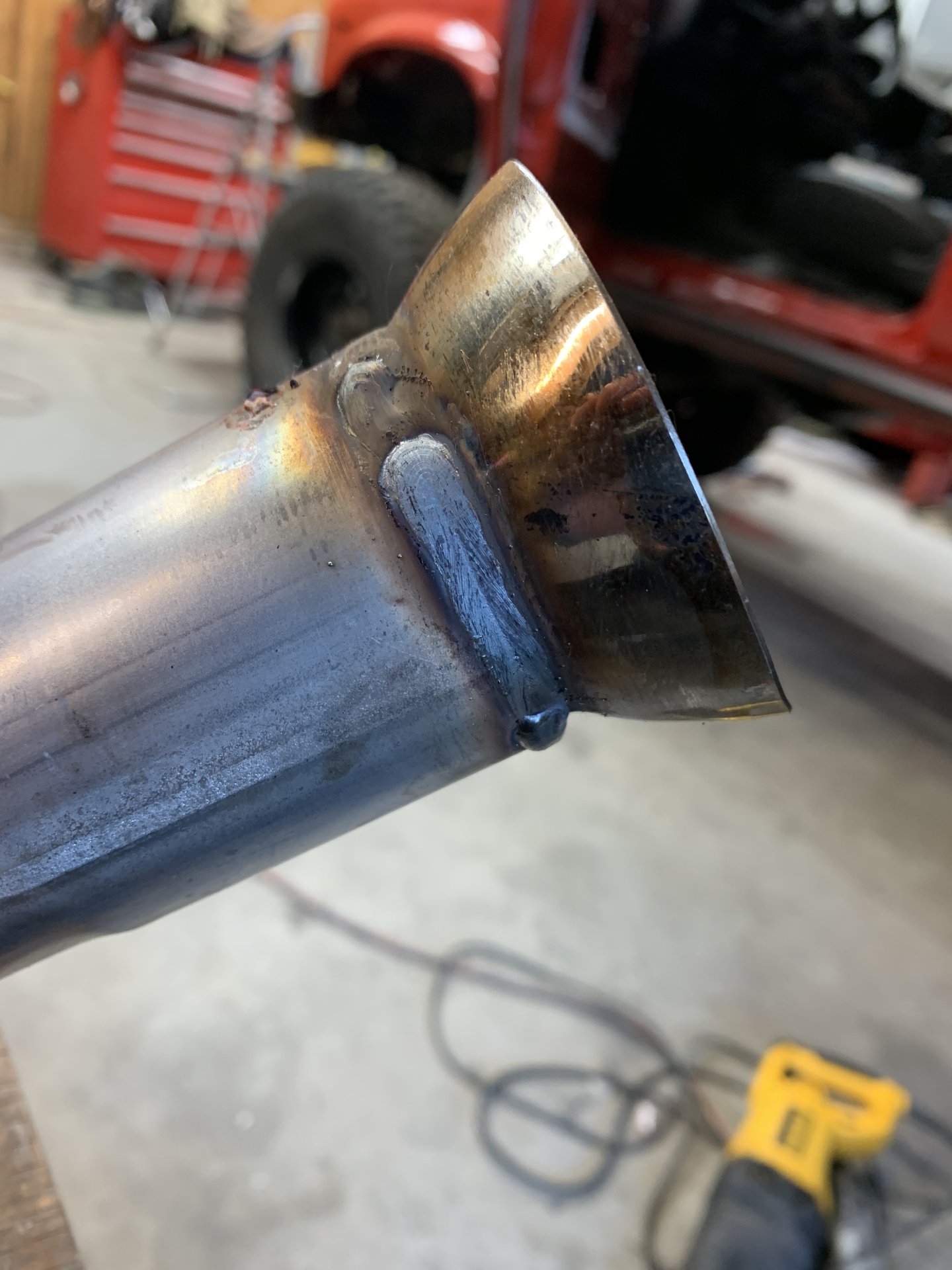

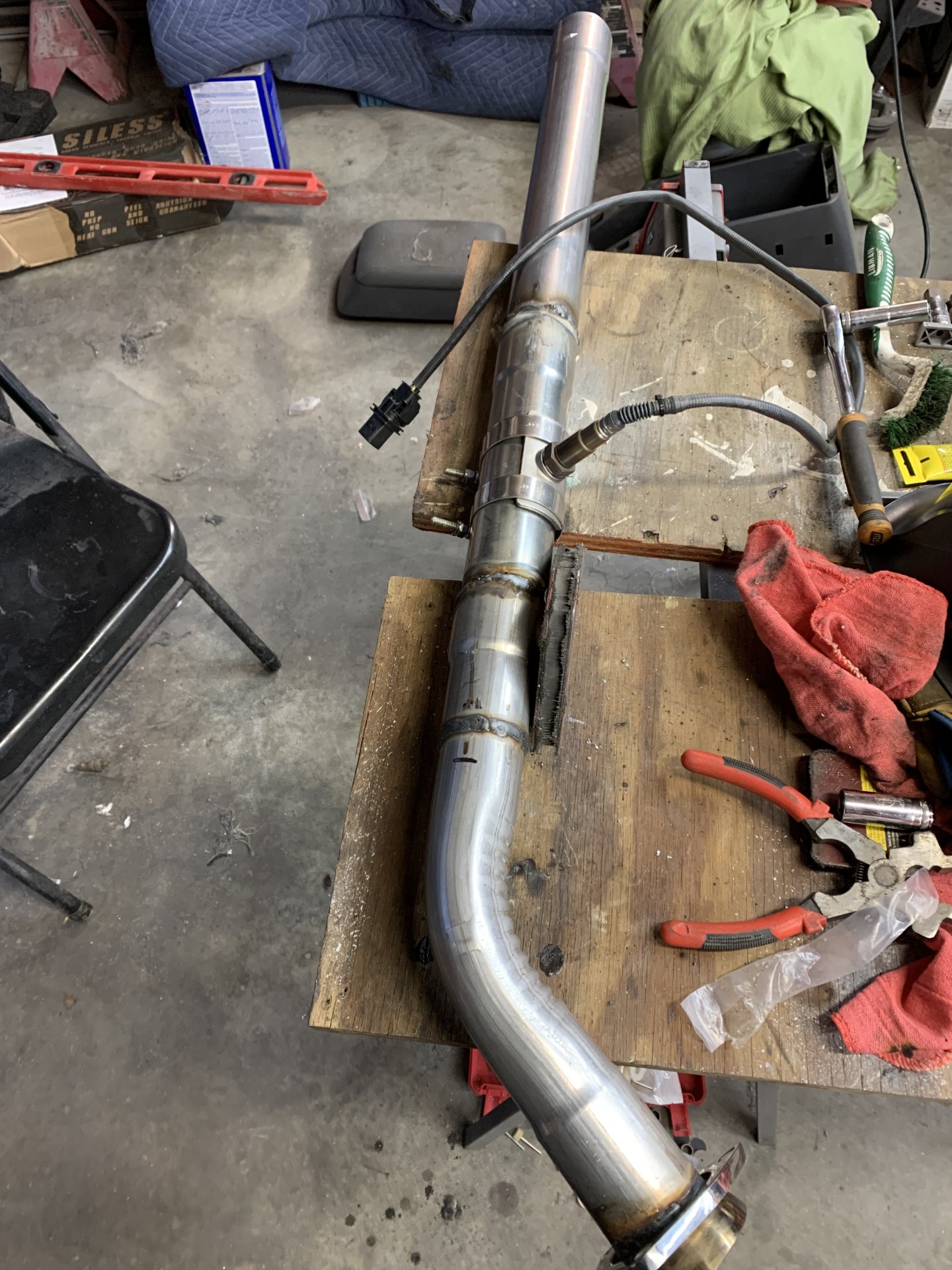

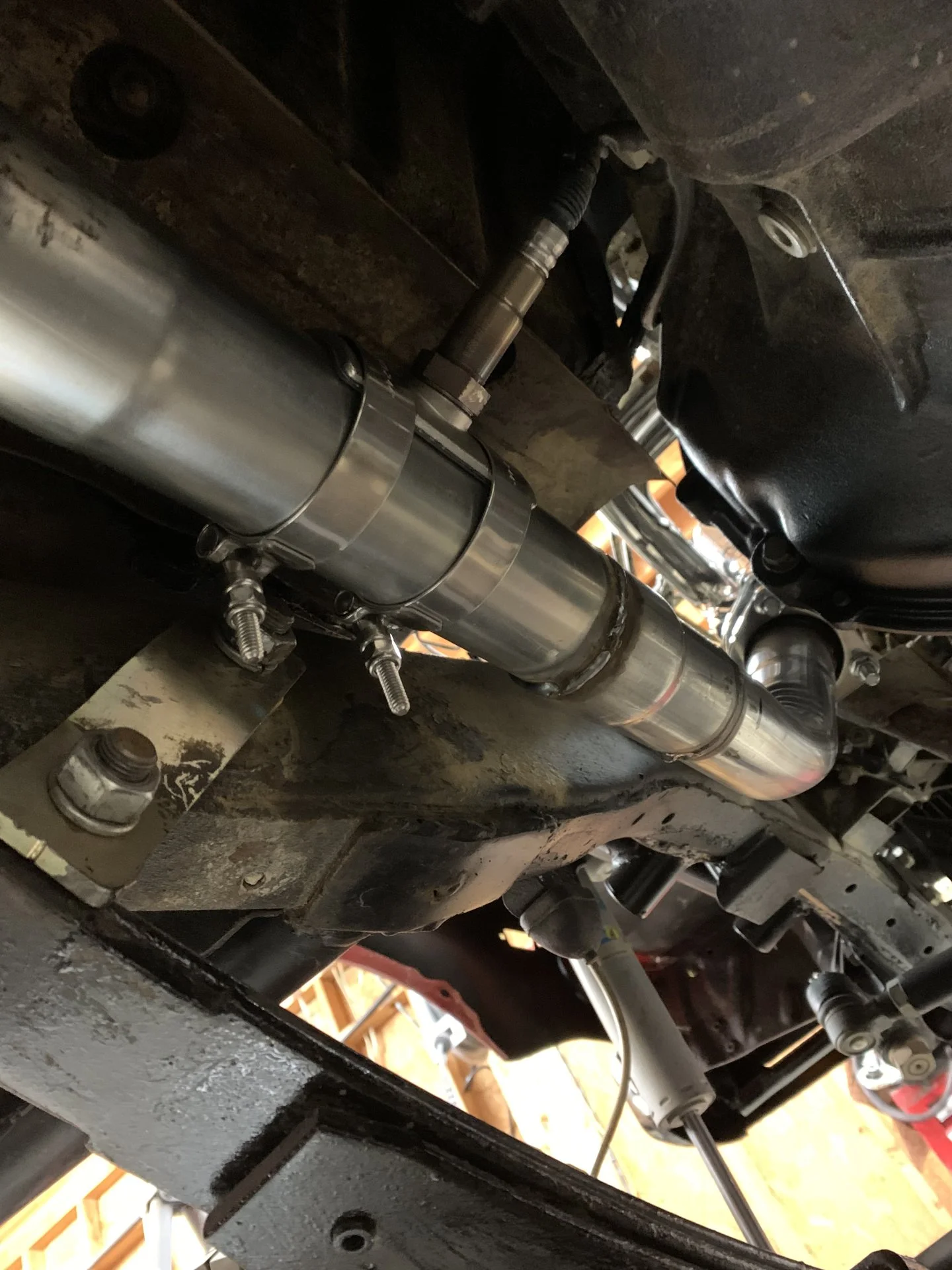

I took out the stock exhaust manifold and down pipes.
Welded up about 3 feet to connect the exhaust back up to the new shorty headers.
Also installed the needed 02 sensor for the new efi

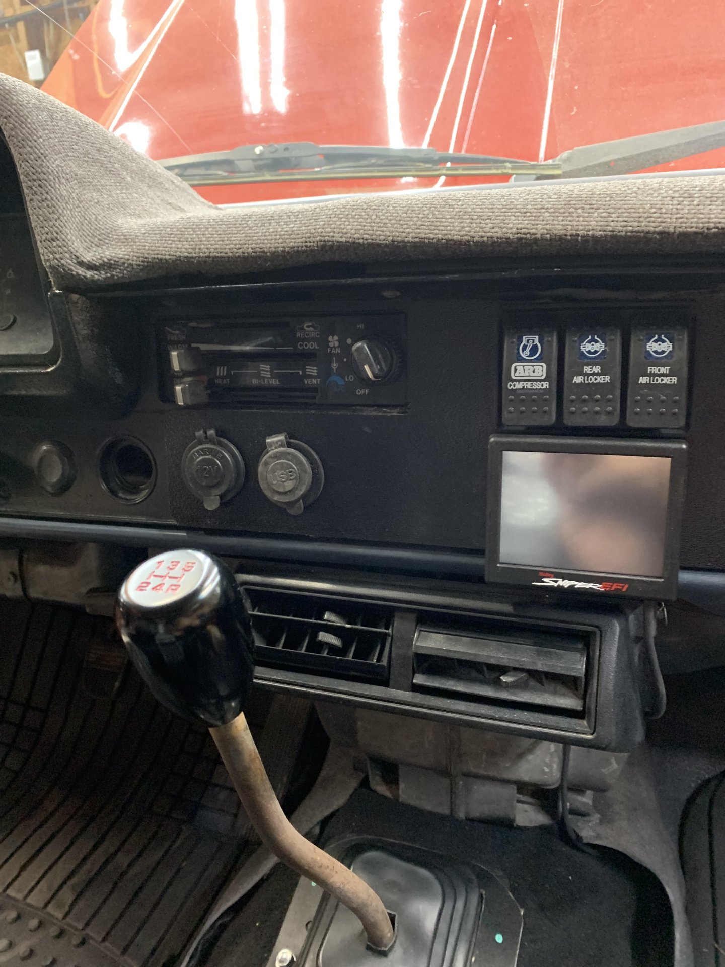

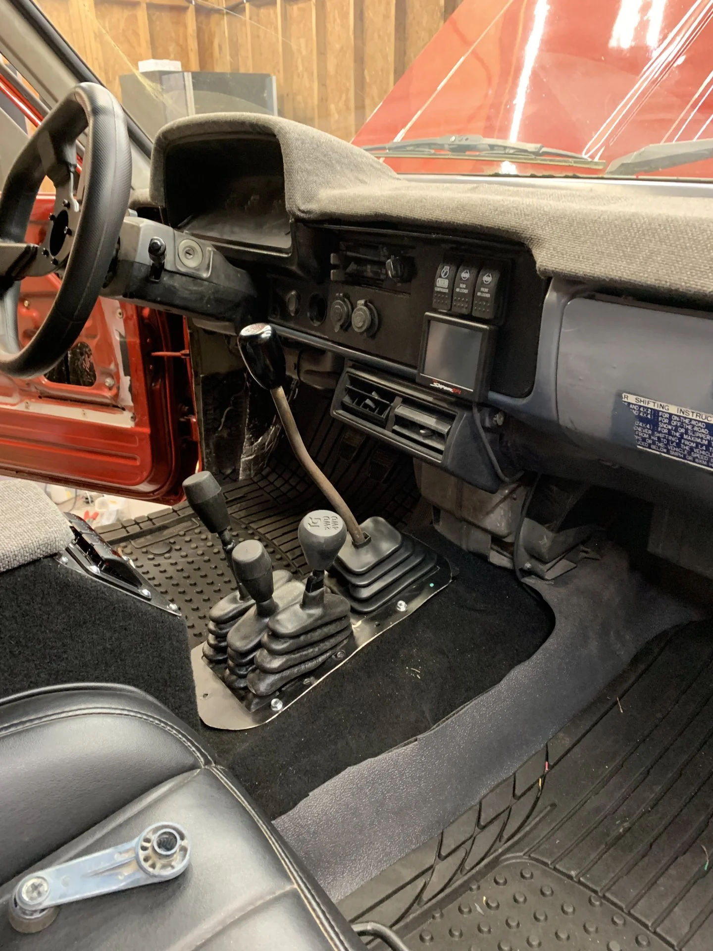

Interior is finally back together for the first time in like 5 years.

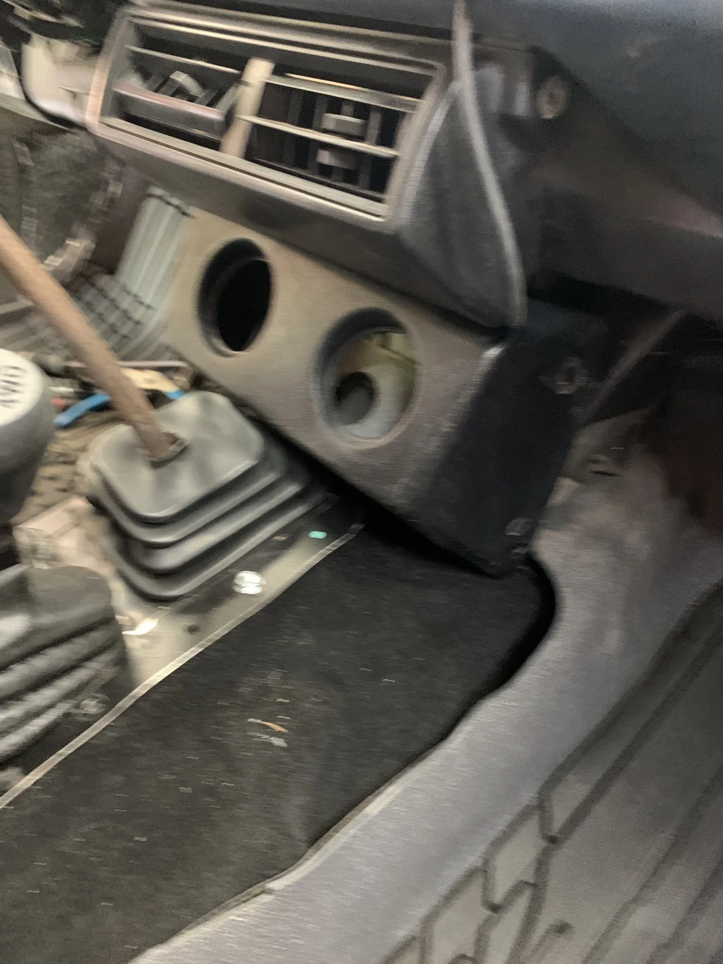

I made the center dash piece out of plastic.

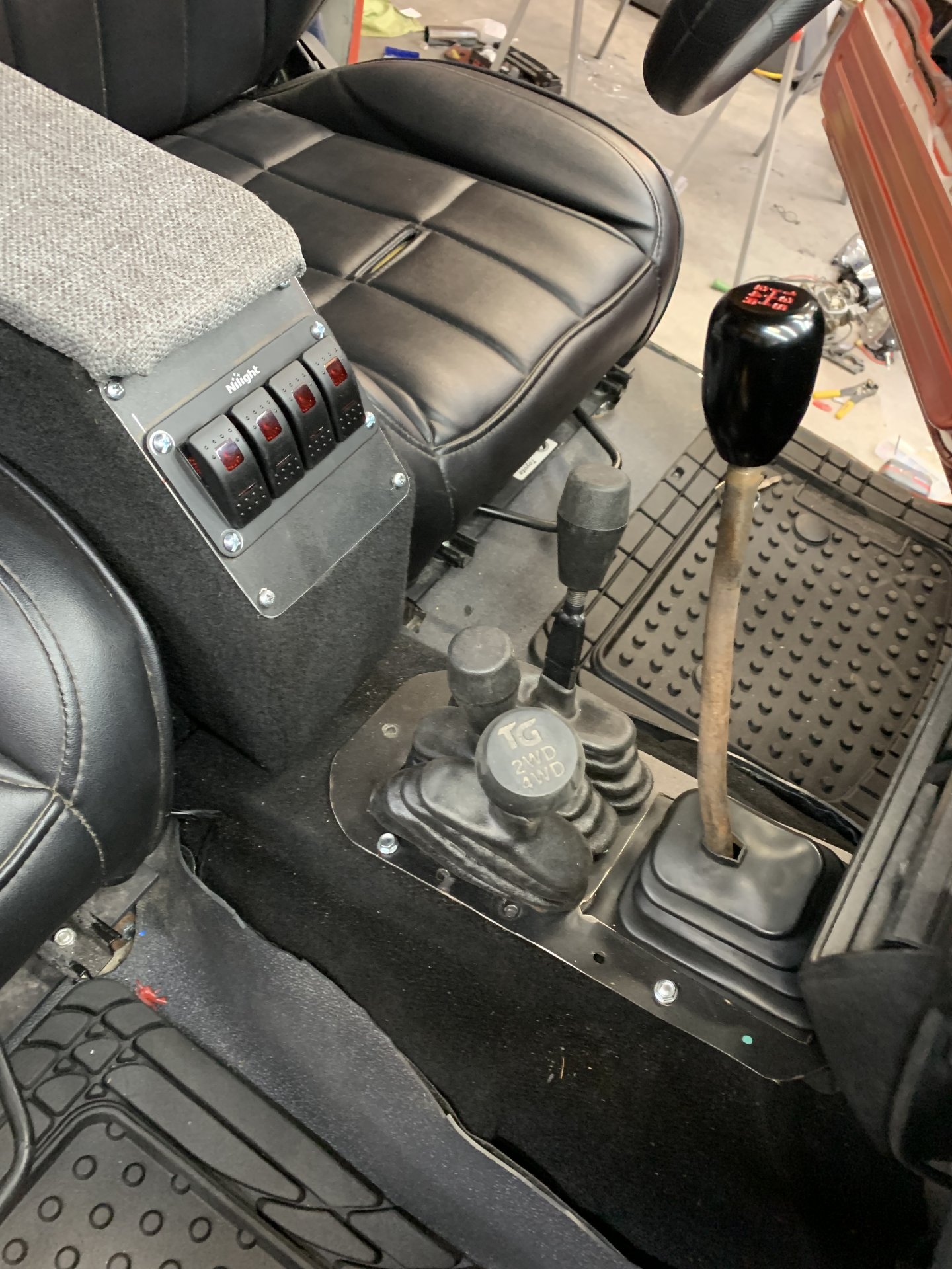

I put the new off-road lights on one of the four swiches in the new center console. I plan to add night lights and some driving lights but won’t worry about that for now.

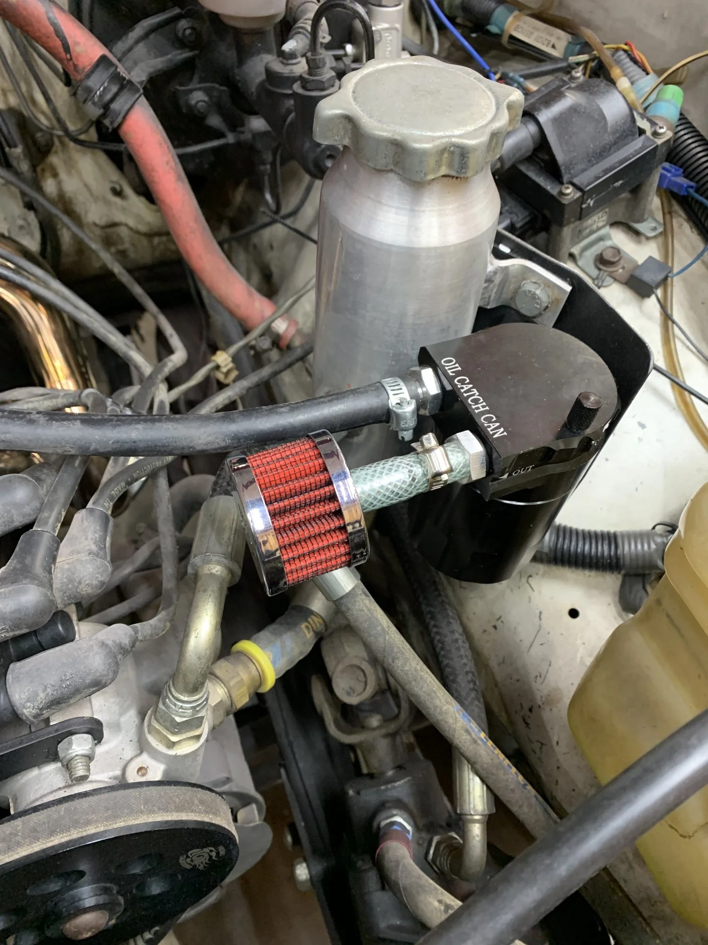

I didn’t want to remove the pcv valve and I didn’t want to just put a breather in place of it so this was my solution. Not sure it is the right answer but I rather have it and not need it than need it and not have it. I just to go pick up a 90 degree elbow to better run the hose from the pcv valve to the catch can.

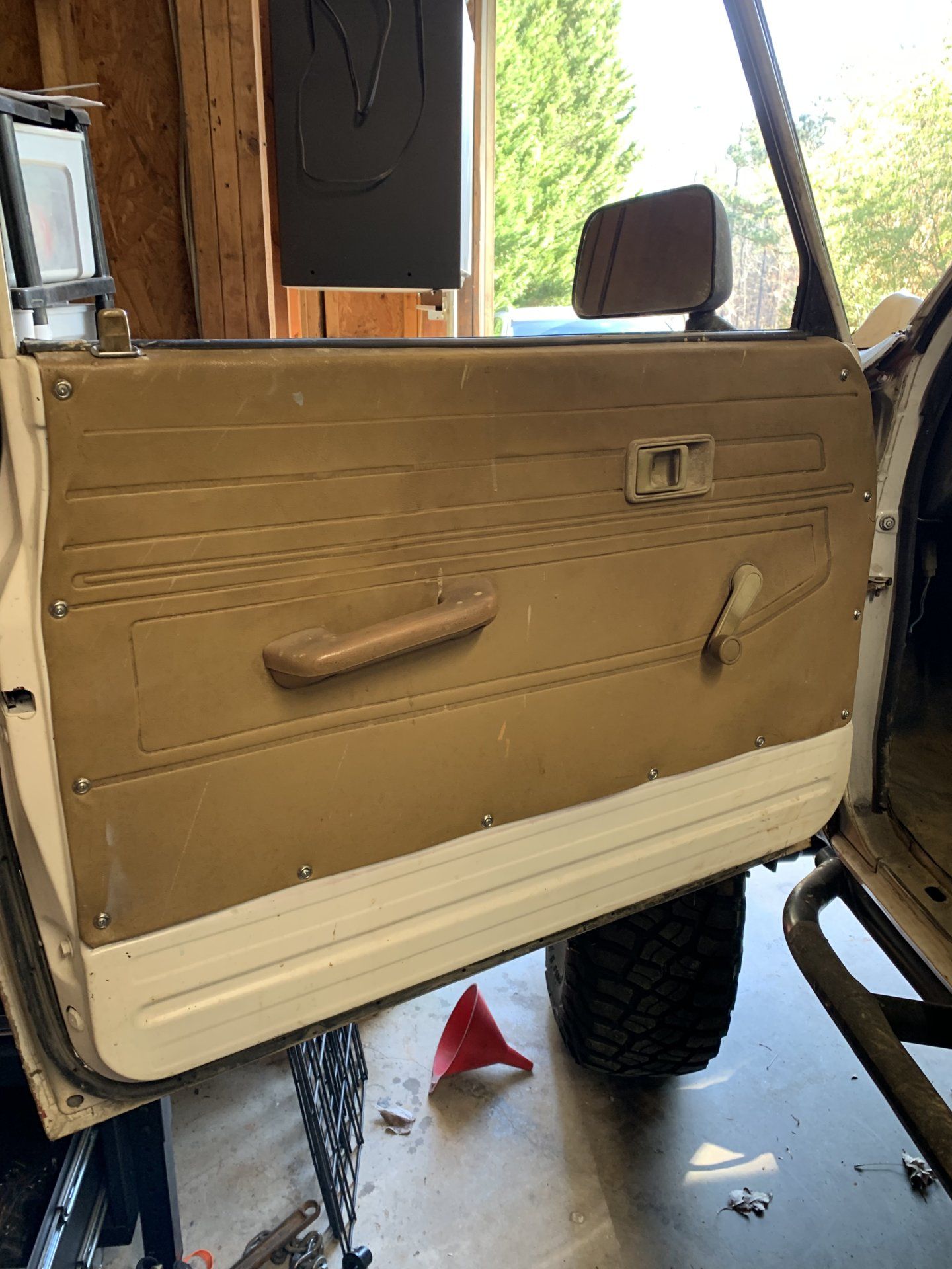

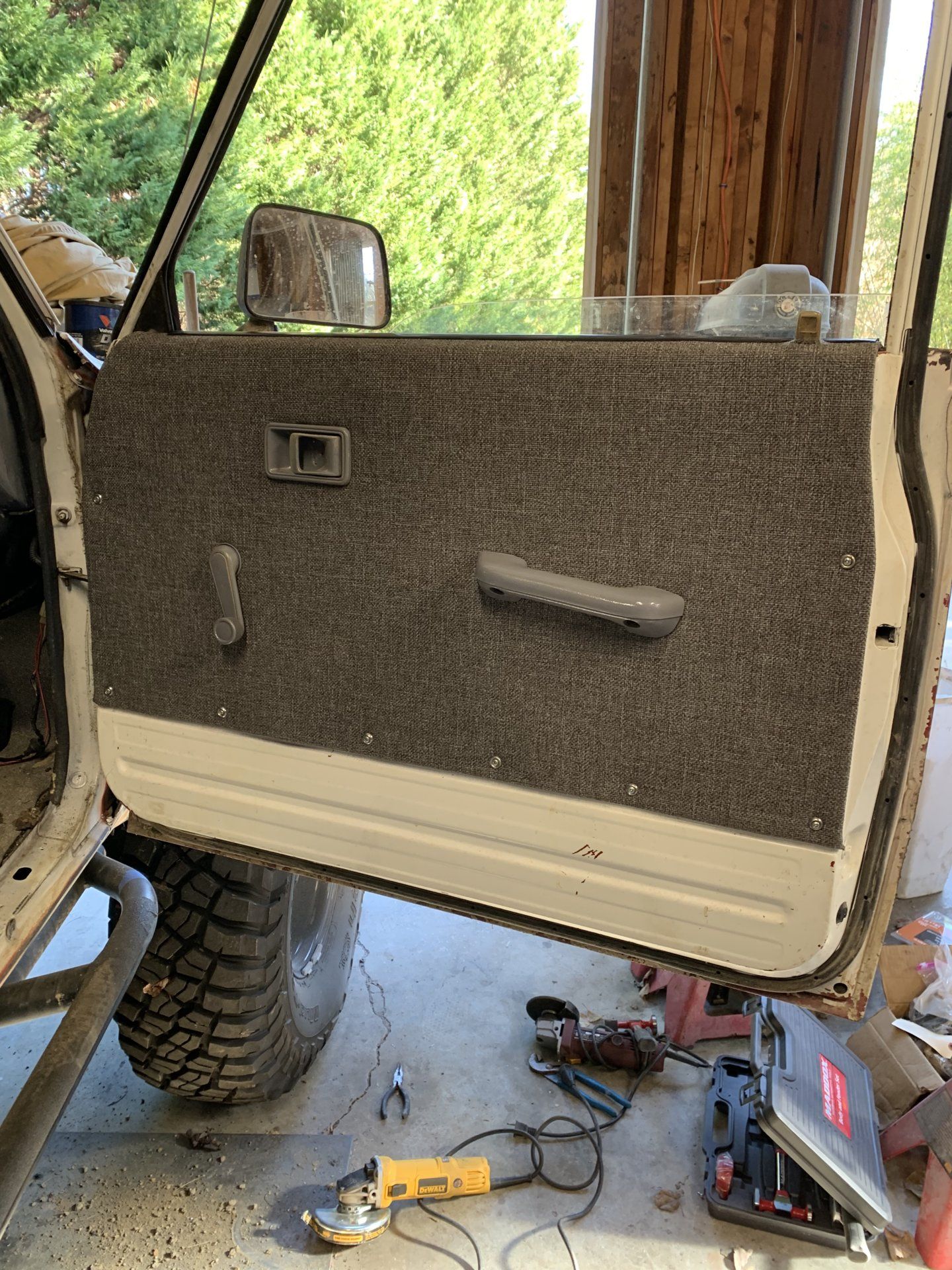

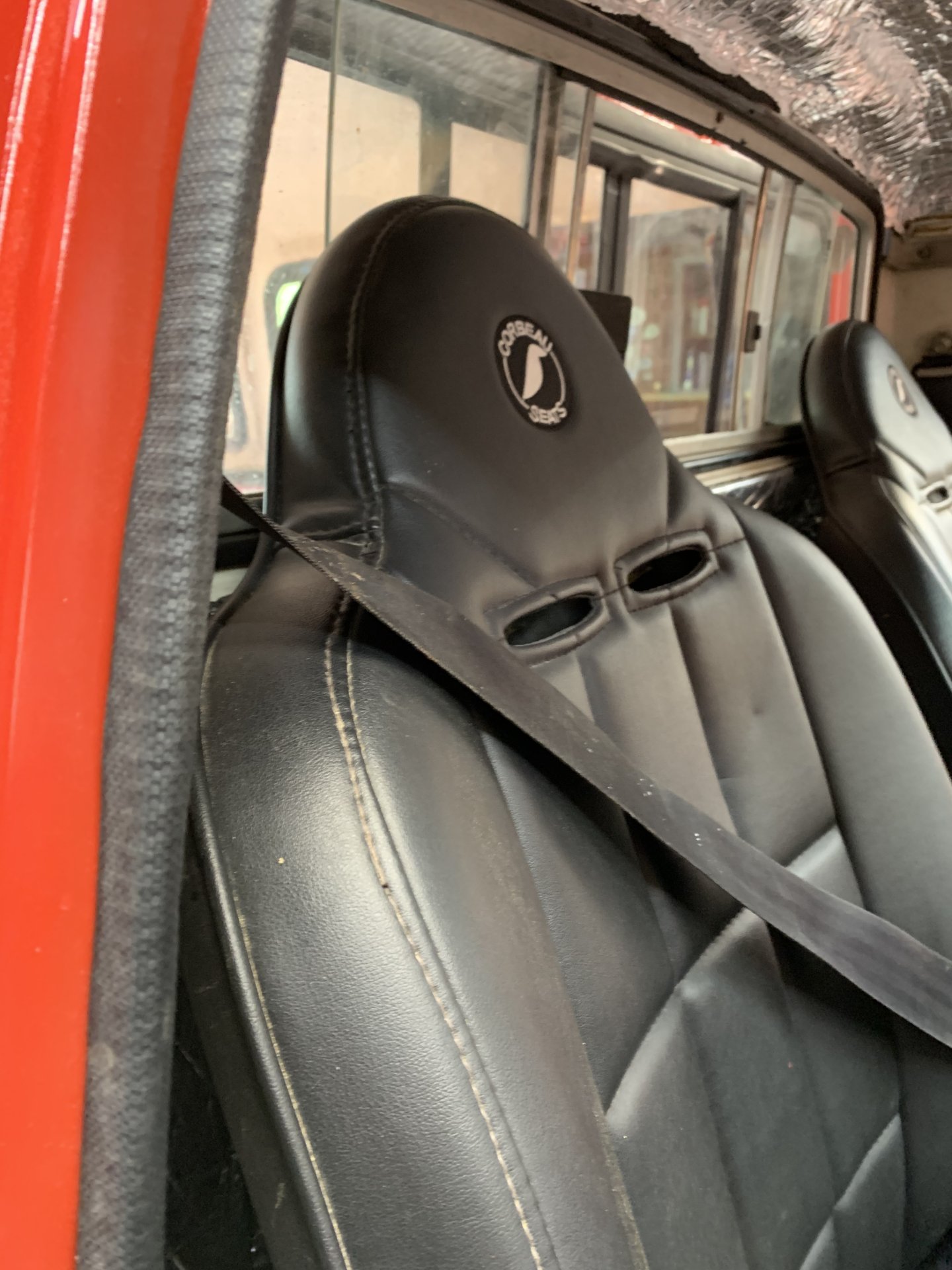

Finishing touches on the interior. I have a spare cab in the back for when my other mini crawler gets too busted up. I went and looked and sure enough it had black and gray interior so I stoled the black door trim and black seat belts. As well as a black gauge cluster which I will use in the future with some better gauges to keep better tabs on the engine.

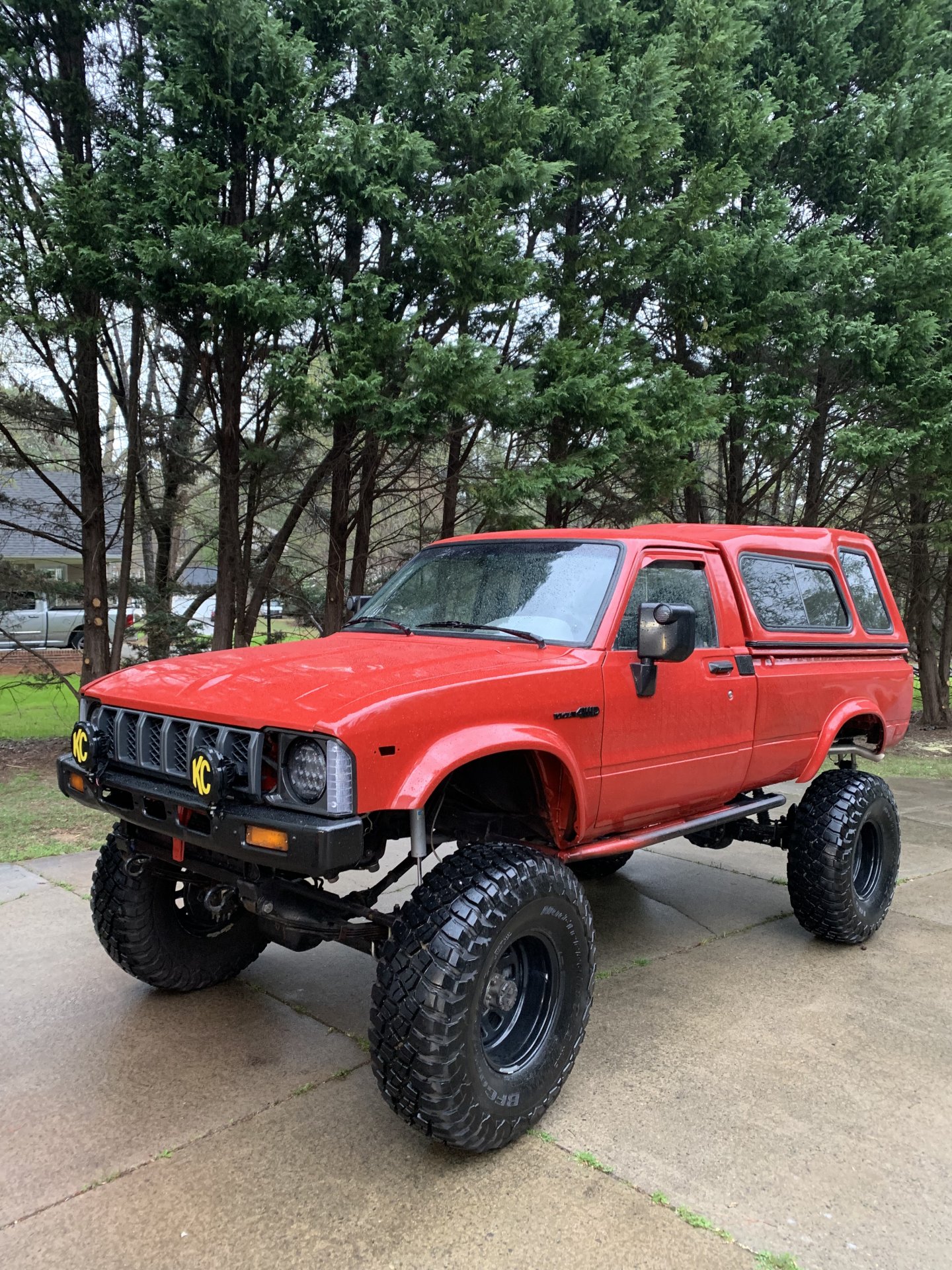

Pulled the truck out of the garage and have been driving the truck around near my house to let the sniper Efi learn. Had to do some adjustments and had to chase down an oil leak from the fuel pump block off plate and coolant leak from the water plate under the intake manifold which is still not quite fixed but I’m hoping my repair tonight fixed it and I can drive it to the Carolina relic run in the morning.

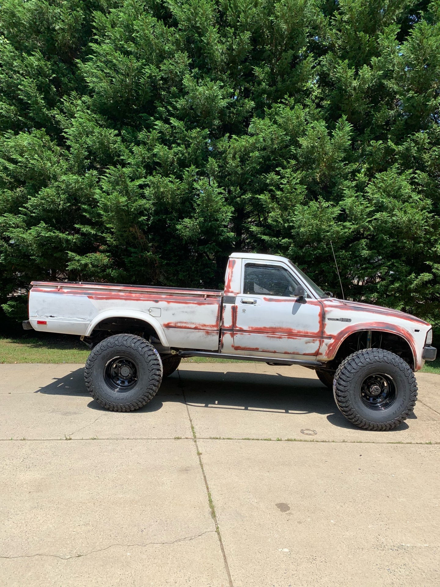

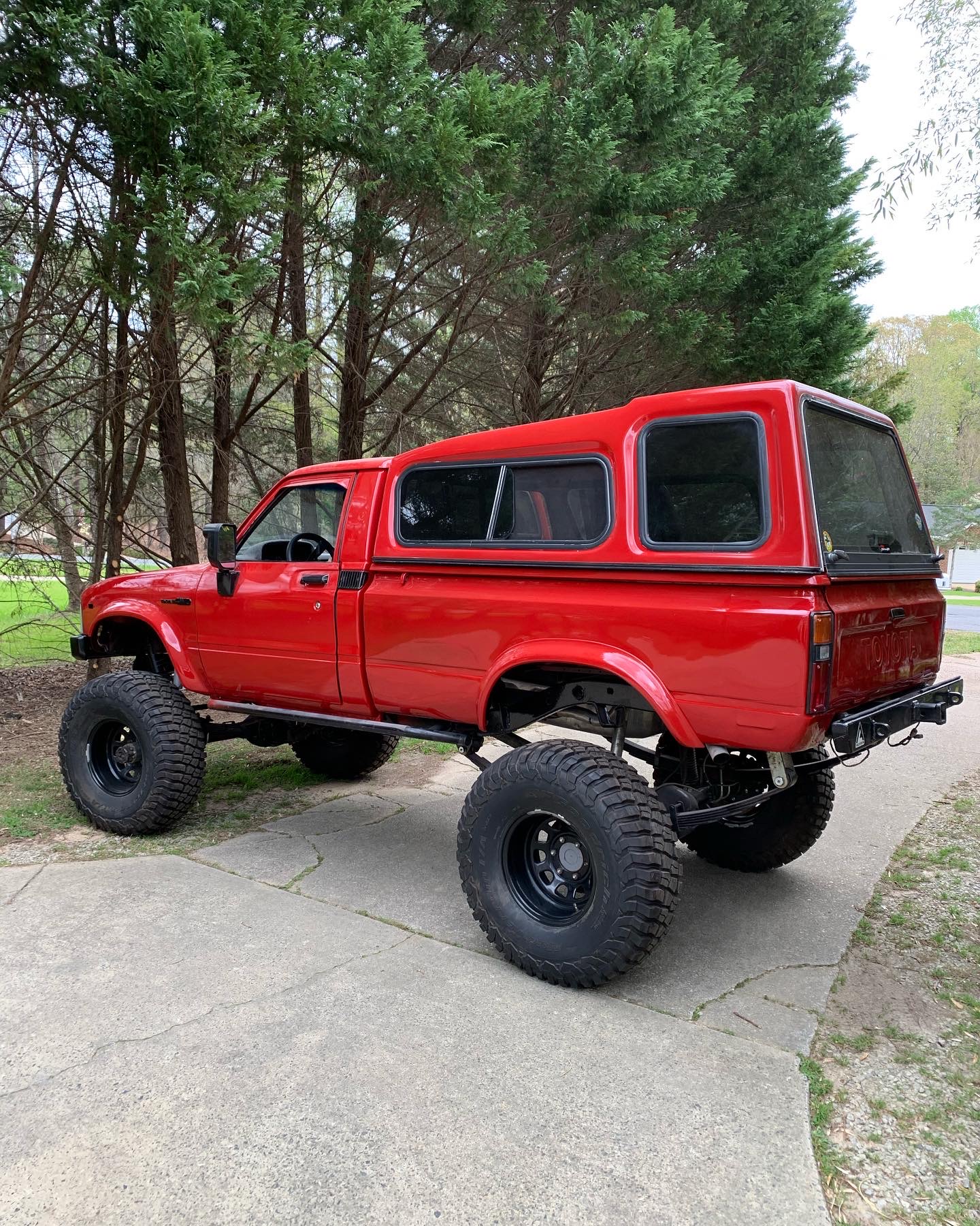

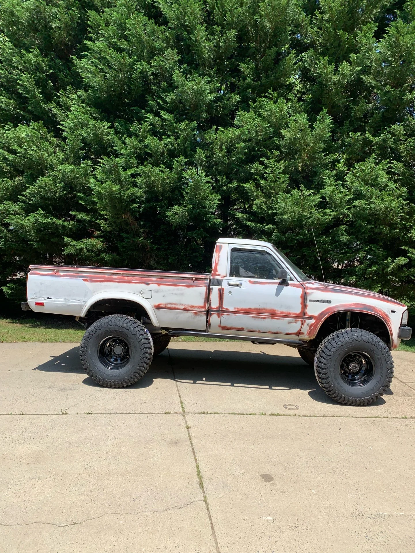

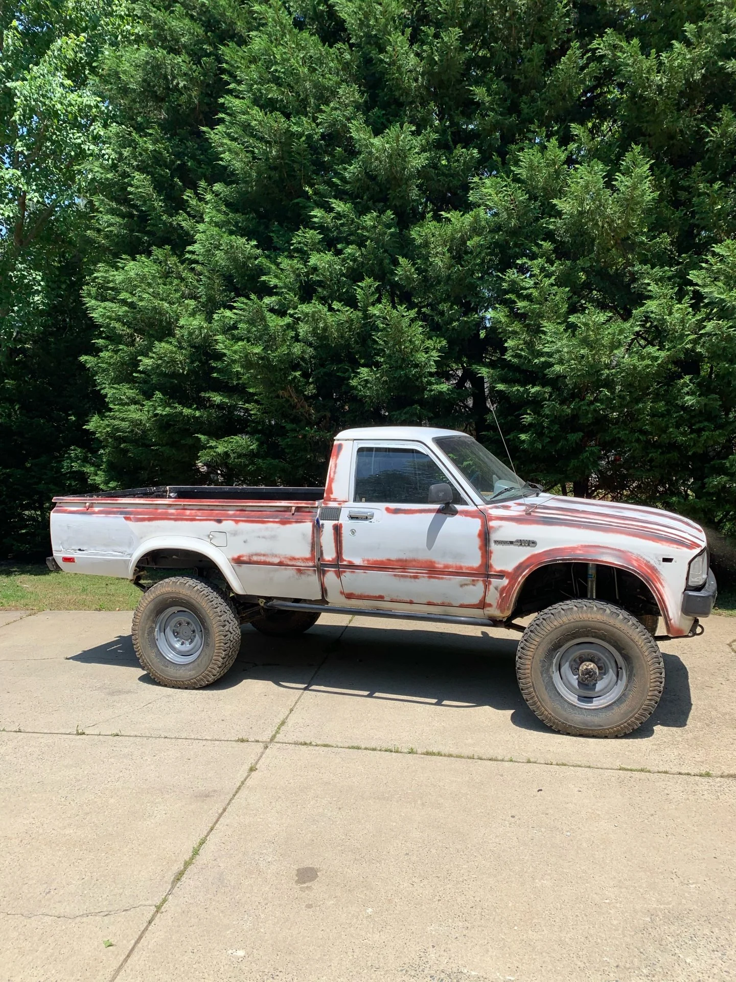

This is how the truck looks now. You can see it is very tall. At least to me it is.
This is the old man emu 2/2.5 inch lift with 33 tires
Old man emu lift 2/2.5 inch lift on 35s. The tires rubbed real bad and had to hack off the fenders and bend the corners of the body. In the photo you can kind of see that the lift needs to be slightly taller for the 35s.
Anybody running 4 inch lift suspension lift with 35s and confirm if they fit without rubbing?
