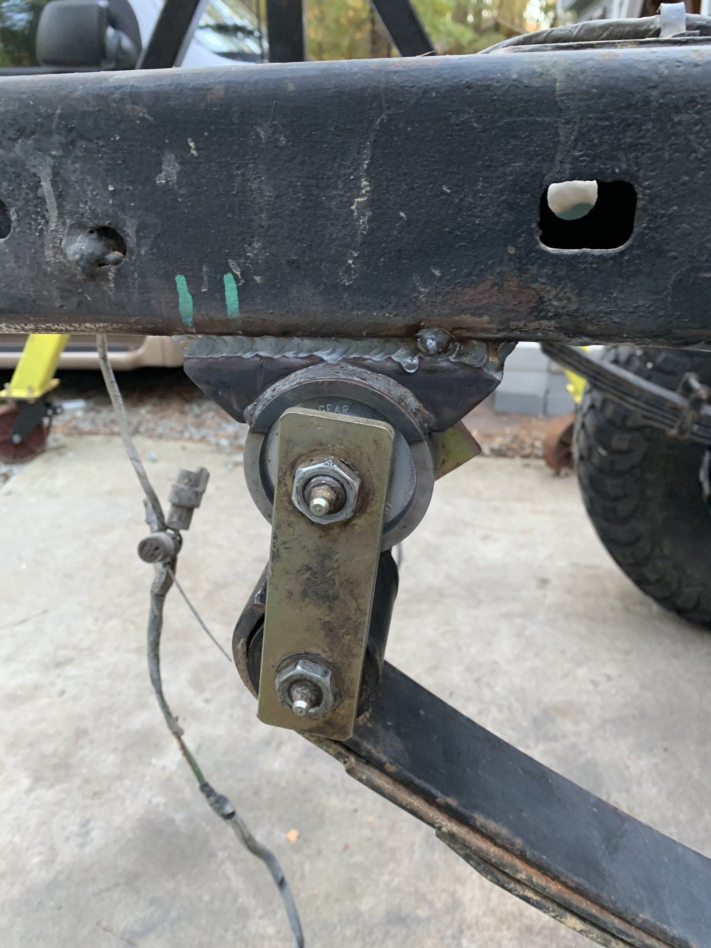

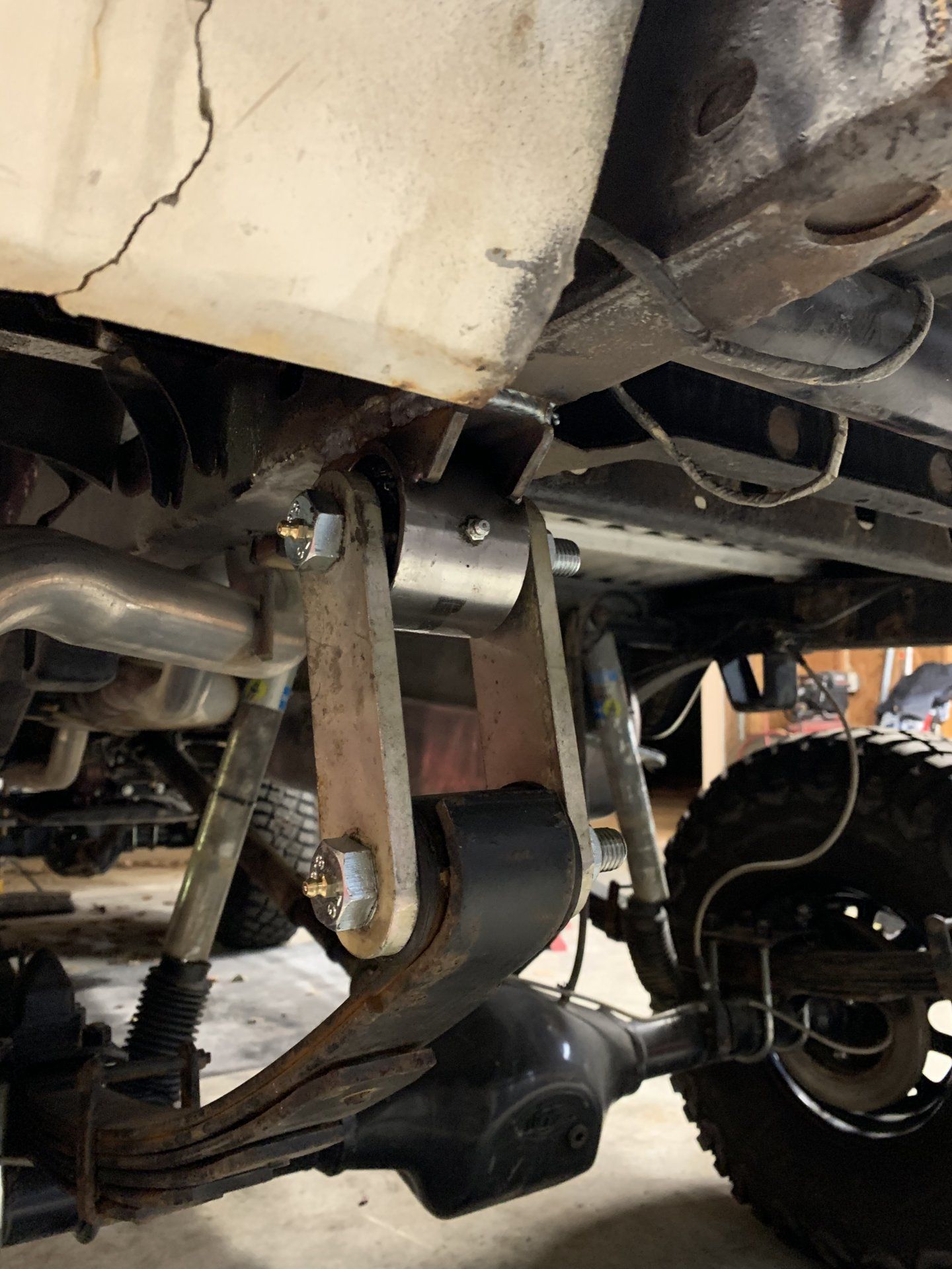

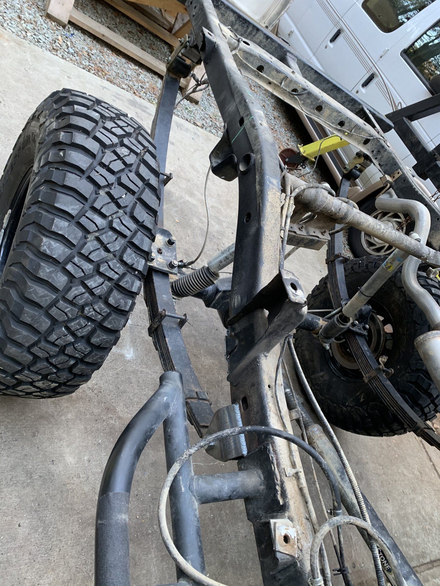

Finally finished installing the rear springs. New heavy duty hangers and creeper joints in the rear. Just waiting for a few bolts to replace the OME SHACKLES with longer ones.
The truck is tall but wanted to keep the front tires out of the cab when flexed.

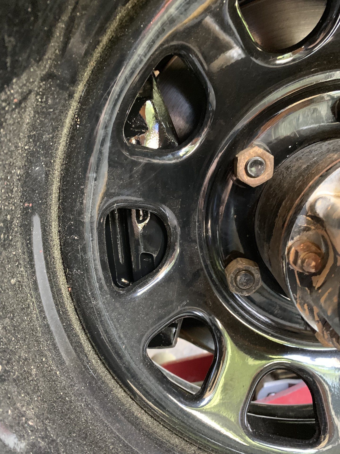

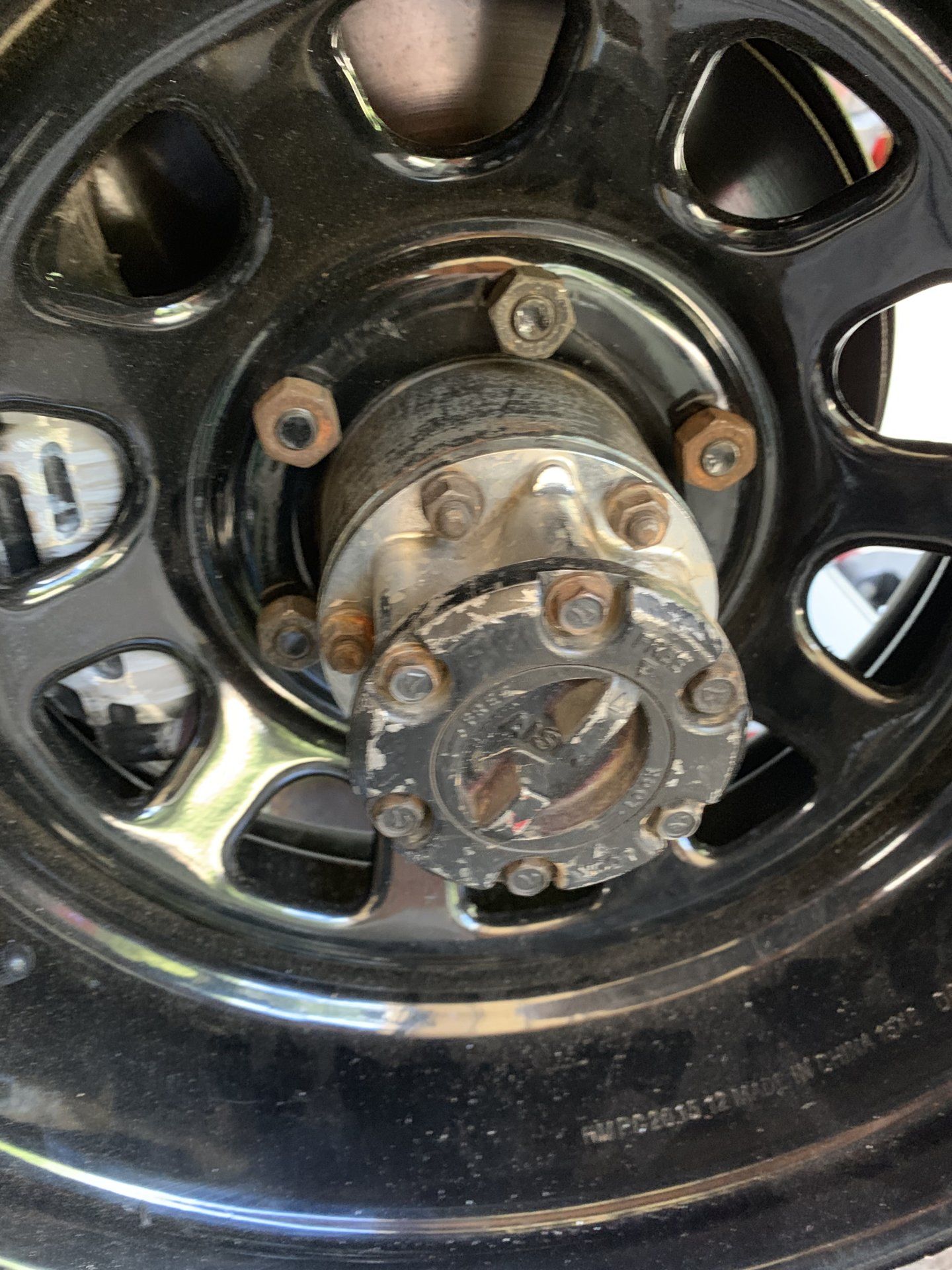

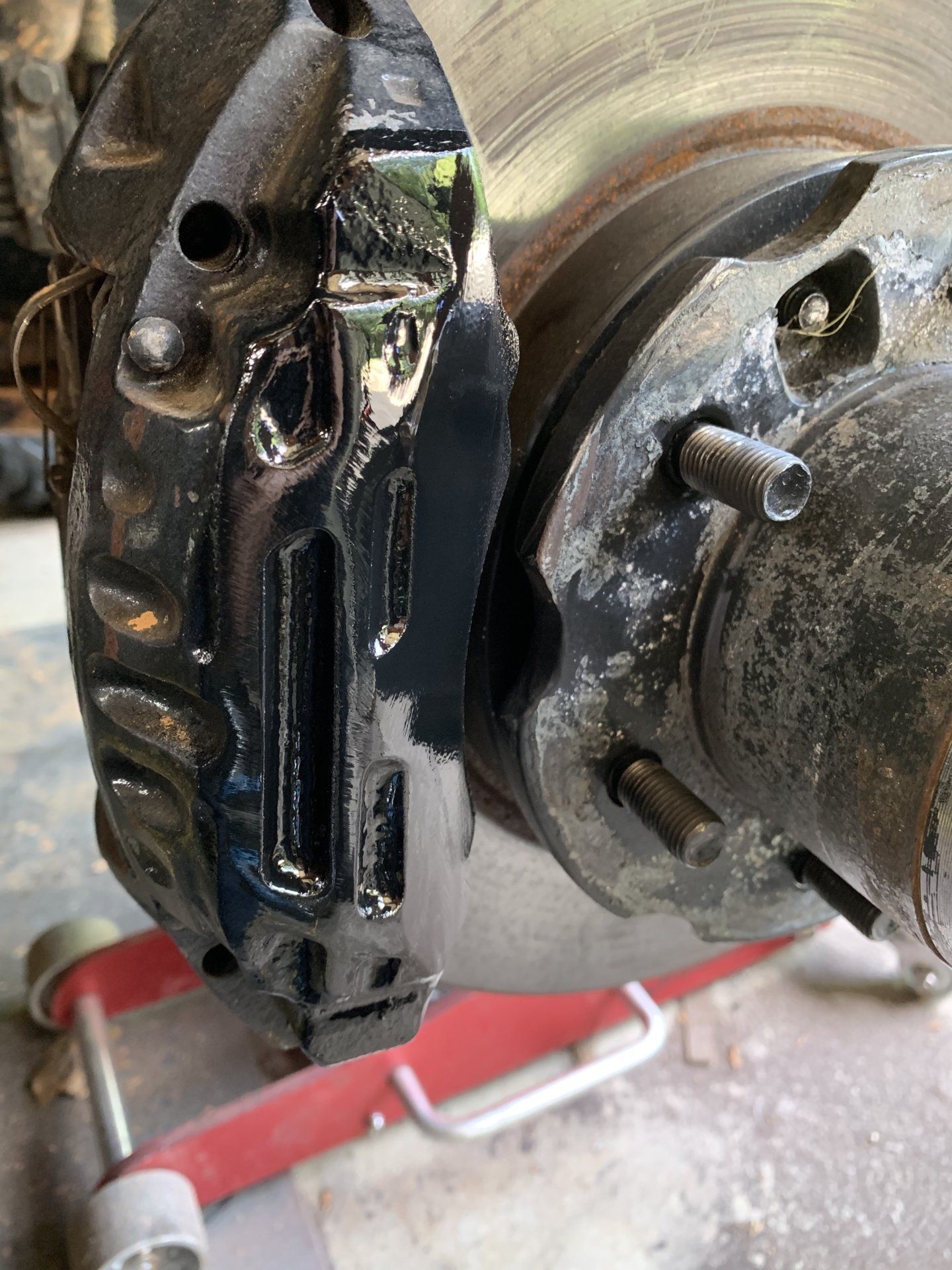

Wow that's a lot of caliper interference. What's the offset of the wheels? Did you consider the bolt-on type of spacers?
It wasn’t as bad as it looks. I just took off a little more off the calipers to be on the safe side. I think the calipers will be fine.
My homie, who is teaching me how to weld burned them on for me.
@GLTHFJ60 check out his bad ass 60 “moonshine”

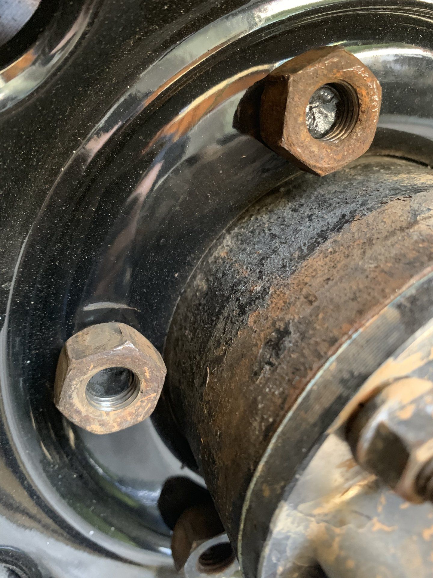

OK, just the amount of thread engagement on those lug nuts looked terrifying. Are those standard 3.75" backspaced wheels?
QUOTE="msahr, post: 12707743, member: 2646"]
[/QUOTE]
Yeah. I agree. The spacers pulled the rim way out and I didn’t have full engagement with the lug nuts. I looked into replacing my studs but 6 x 24 @ $18.00 per stud was a little steep. I didnt drive it like that. I didnt like the way it looked and didn’t want the rim to sheer the studs off.
I asked around and was told that shaving the calipers and remove the spacer would be fine.
I have wheeled it and driven about 200 miles on it and have not noticed any issues.
I don’t know what the backspacing is on the rims. I won them in a raffle at an event and didn’t measure them before I mounted them on.

Also managed to finally get the rear suspension done. The shackle angle is not great but I planned ahead for the extra weight I will have in the bed. I calculated it will be around 300 pounds with tools, spare tire, a cooler, camping gear, tools and recovery gear. Hopefully that should correct the shackle angle.
