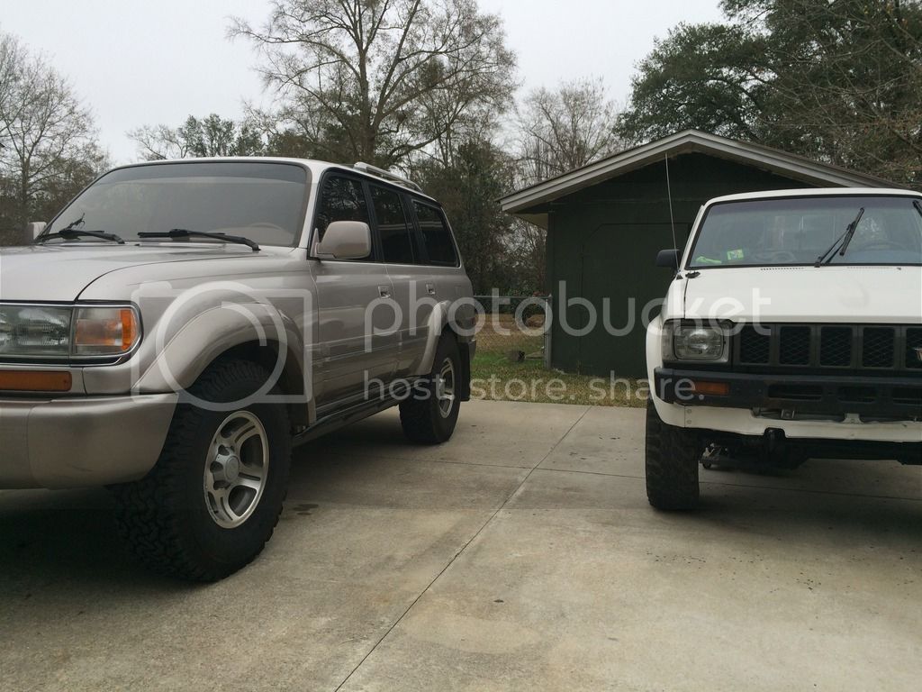

My son and some friends in URE at LOGANS RUN 2014
parked in the backyard after getting home
while doing maintenance on her decided to see how 35s would look

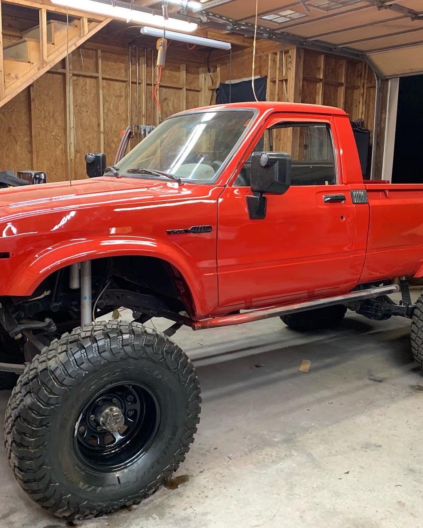

**JULY2022 UPDATE**
After many years of working in Thai sand truck. This is how it currently looks
The truck is further along. Before leaving I was able to get some rust removed. The truck was painted. The whole frame was cleaned off and prepped and rustproofed.
Future plans
EXTERIOR
finish rust repair- small piece on the floor board and a few small sections in the floor of the bed
old school vinyl decals
INTERIOR
The interior is currently gutted-
going to reupholster original bench seat in tan vinyl
redo blue the door covers with tan color vinyl
change the color of the blue dash to tan
replace carpet with new carpet to include extra padding to help with noise and heat
sound proof doors, floor boards, and ceiling
add stereo
DRIVETRAIN
replace current tires with 33x10.5x15 BFG Mud tires
rebuild front and rear axles
add lunch box lockers
would also love to add some cool metal bumpers front and rear and some sliders
