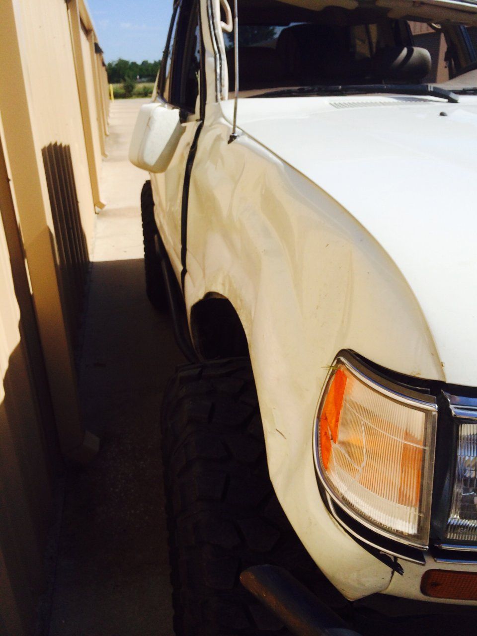

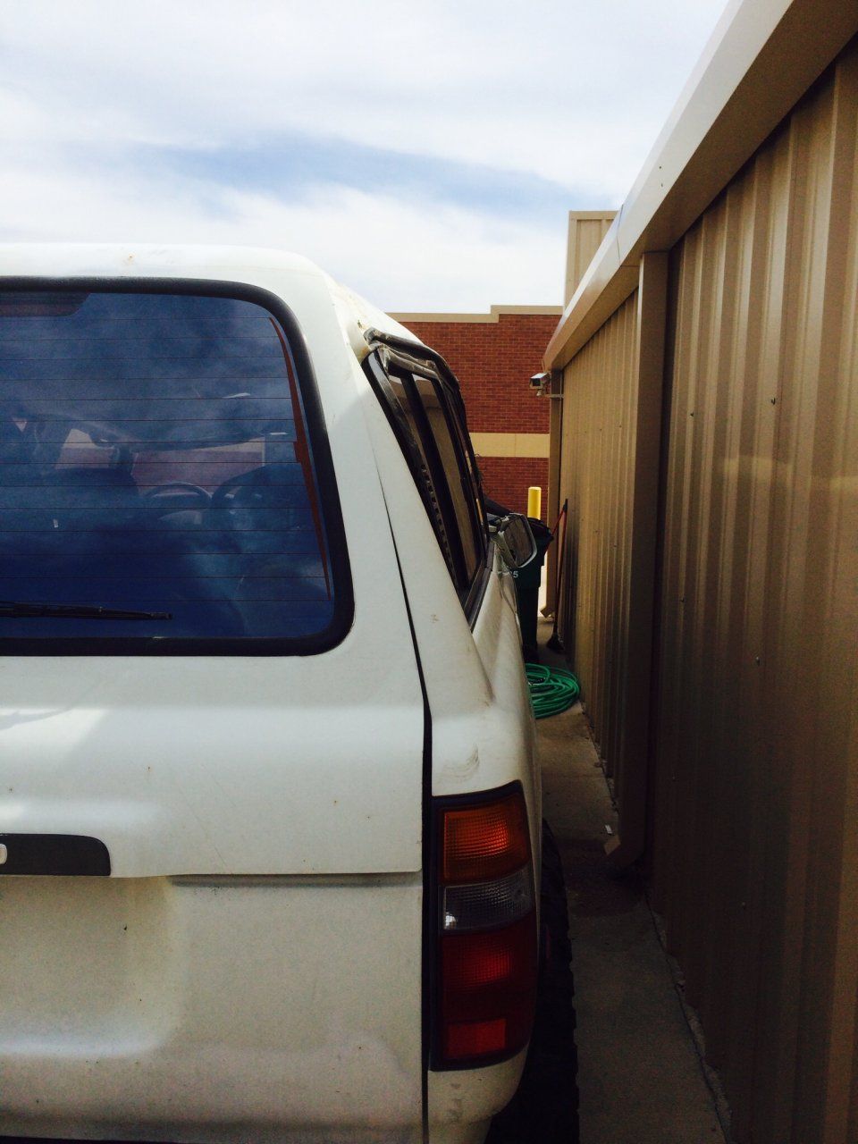

Besides the DA front fender and hood, the body is trashed and wouldn't consider it for a viable build base, evidenced by the fact no door, save the drivers, will open....and it won't close.
She took a beating.

Dam good thing you walked away ok. Any idea how many times it rolled?
Landed on the drivers side and slid is what the cops said.
I don't understand how some of the damage occurred, if that's the case.
