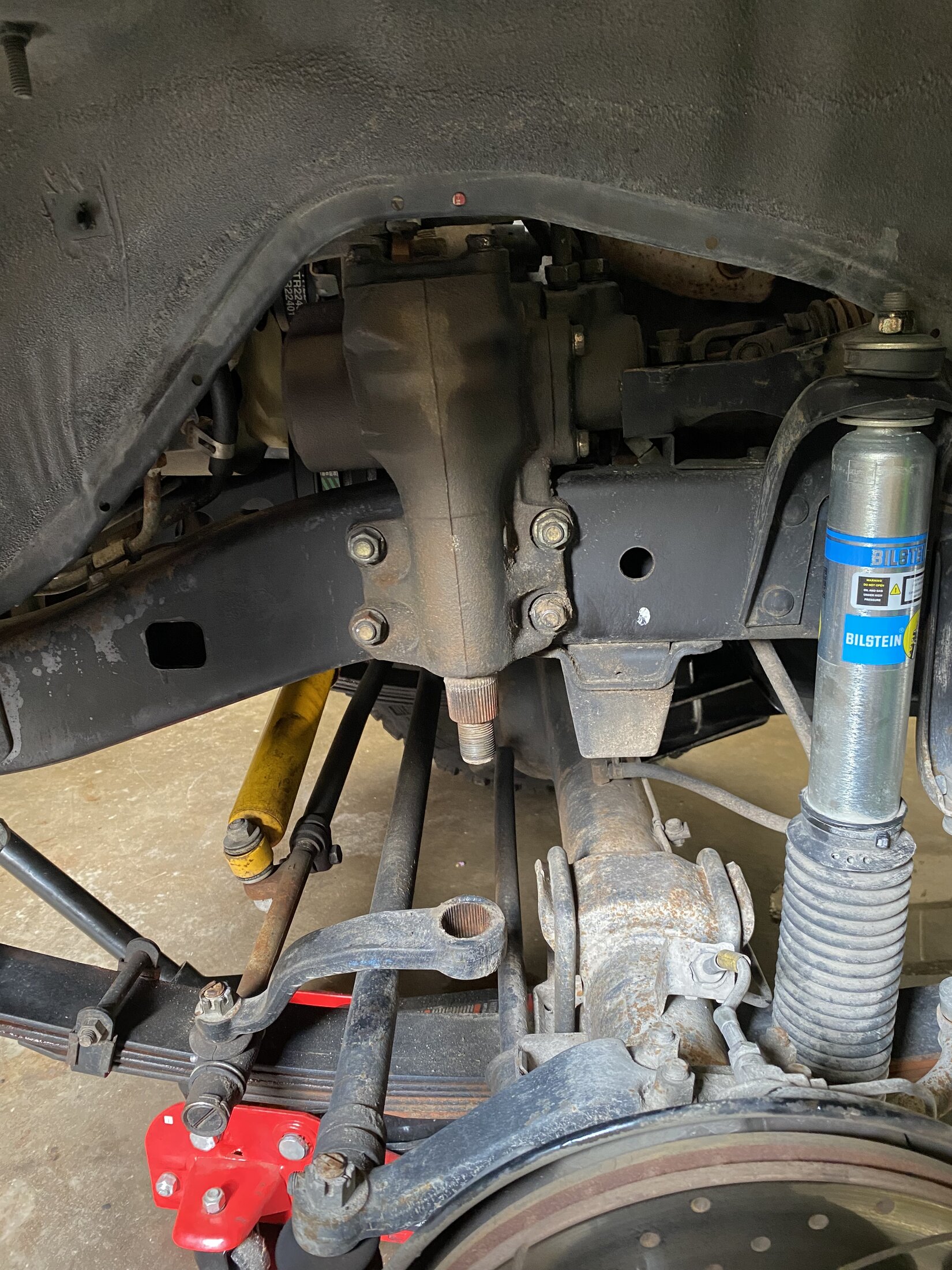

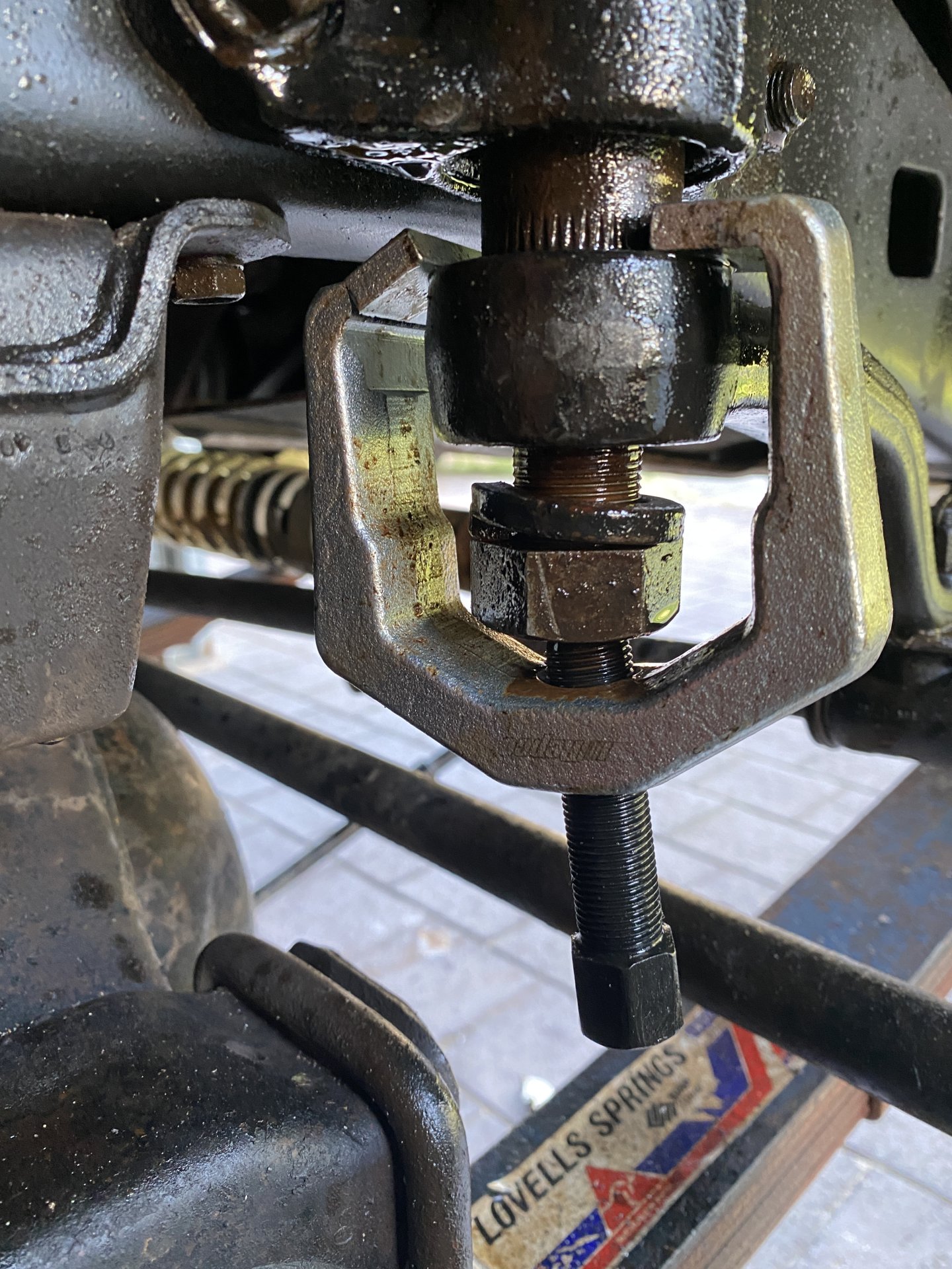

Well, that was a bit of a disaster / waste of a few hours….

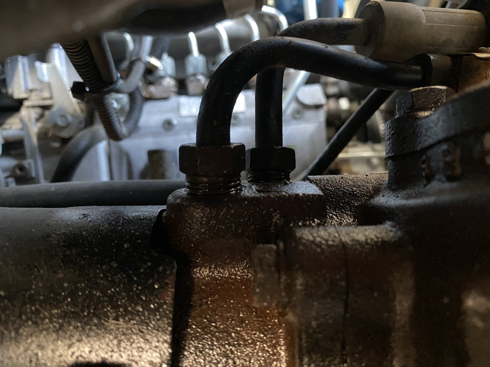

I snapped the pitman arm puller, couldn’t get the hydraulic lines out the top of the 60’s box (kept starting to round over). And couldnt get the drag link separated from the other end of the pitman arm….
Bolted it all back together….
I had to cut my shaft off the 60 box and destroy it. It broke two snap on pullers.

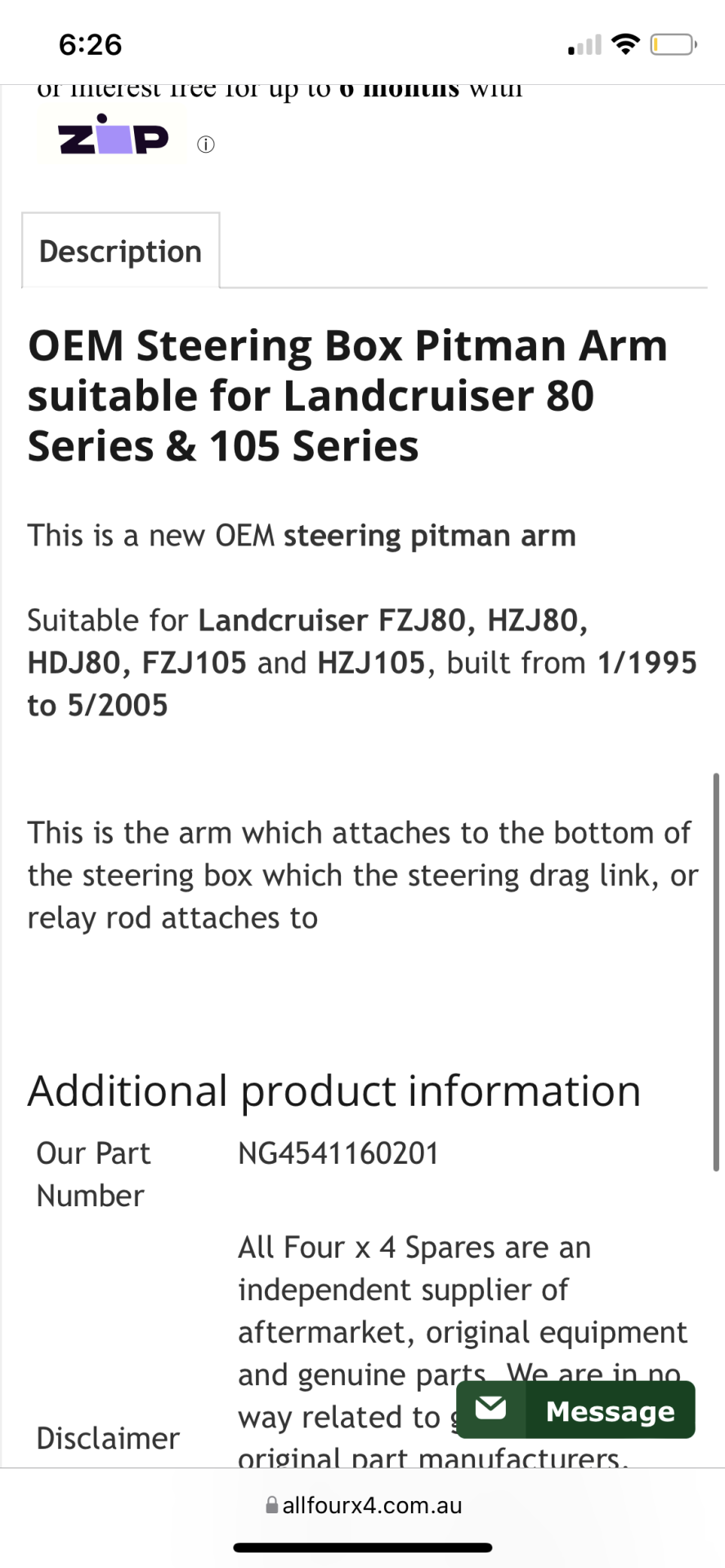

In searching online I found the 80 / 105 pitman arms fit each other (see pics)
I thought if that was the case, my 60 would work too…

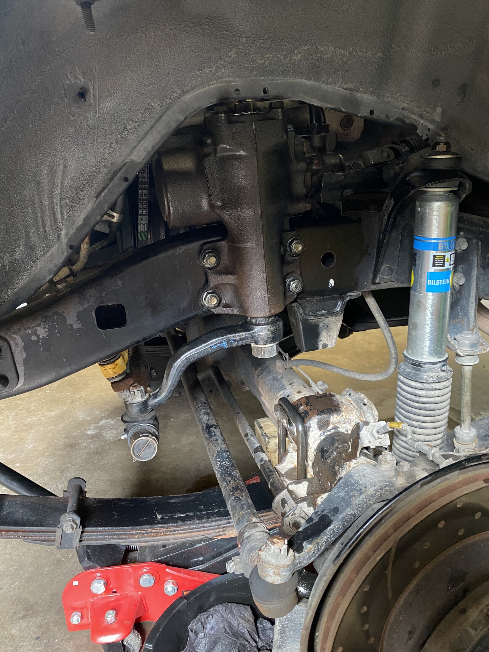

The pitman arm in the pics is what came with the new steering box, but I think I need one with the drop or the steering stabiliser will be too high and hit the guard under the radiator…
Confused what to do now!
When I put the 105 sector shaft in my 80 box to go on my 60, I had to use a 105 pitman arm to match the 105 sector shaft.
Remember that the reason why the 105 sector shaft is an upgrade, it is larger at the end to prevent the splines from twisting above the pitman arm.
I don't know why those listings say it works, but the 105 sector shaft is larger at the end where the pitman arm attaches. That's the whole point of using it.

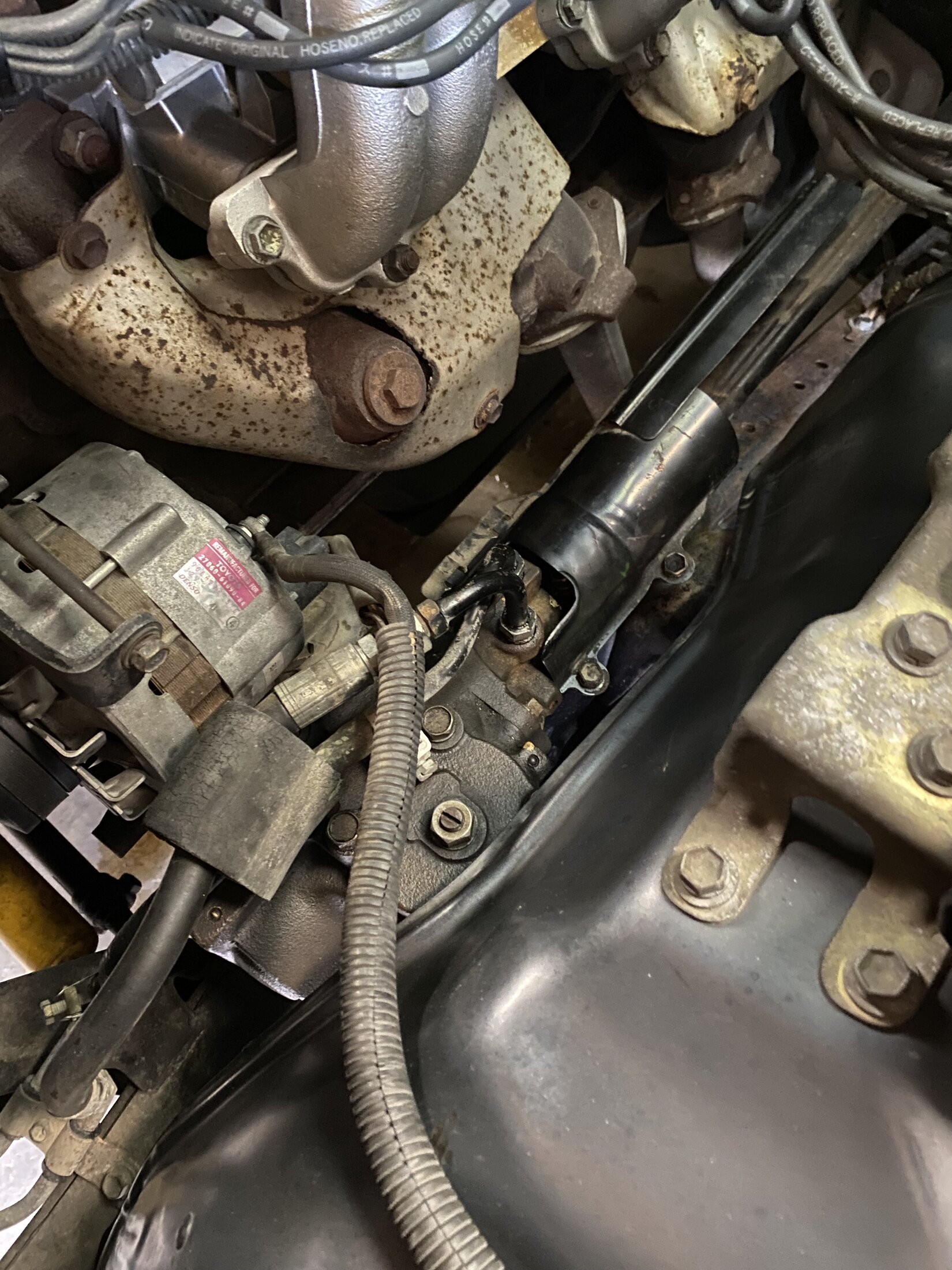

Hey there! All 80 boxes are the same. Only modification I had to do to my 62 was cut some metal off that splash shield thing that goes around the steering shaft. Original power steering lines threaded right in!

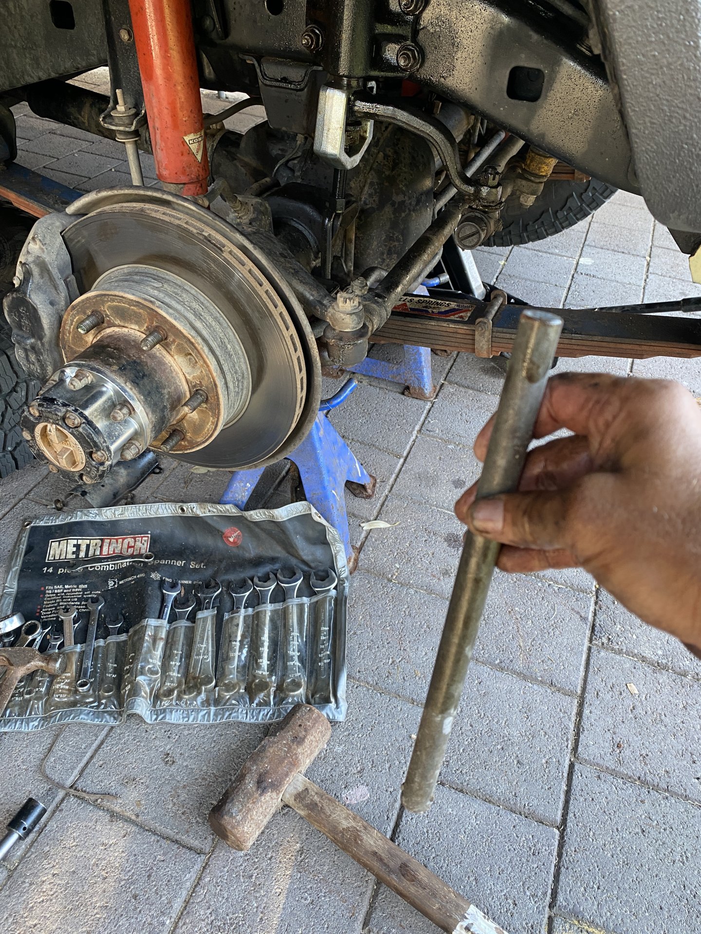

For the pitman arm (had to remove two), I used a cheap two jaw pitman arm puller, put a little heat on the outer ring of the arm. I kept some tension using the puller and hit with 2-pound hammer repeatedly toward the tie rod end of the arm to loosen it up. The vibration helped move the arm, I’d then tighten again on the puller until it broke free.

Wasn’t bad at all, probably about 2 hours of work for me the other day.
Work on taking the pitman off first and it’s all easy from there. Hitting the bend in the arm while using tension with the puller vibrated it loose nicely.
I kept my wheels set straight before pulling the old box and made sure the used box was centered up. I think I counted 4.5 turns lock to lock, so 2.25 to get back to center.
