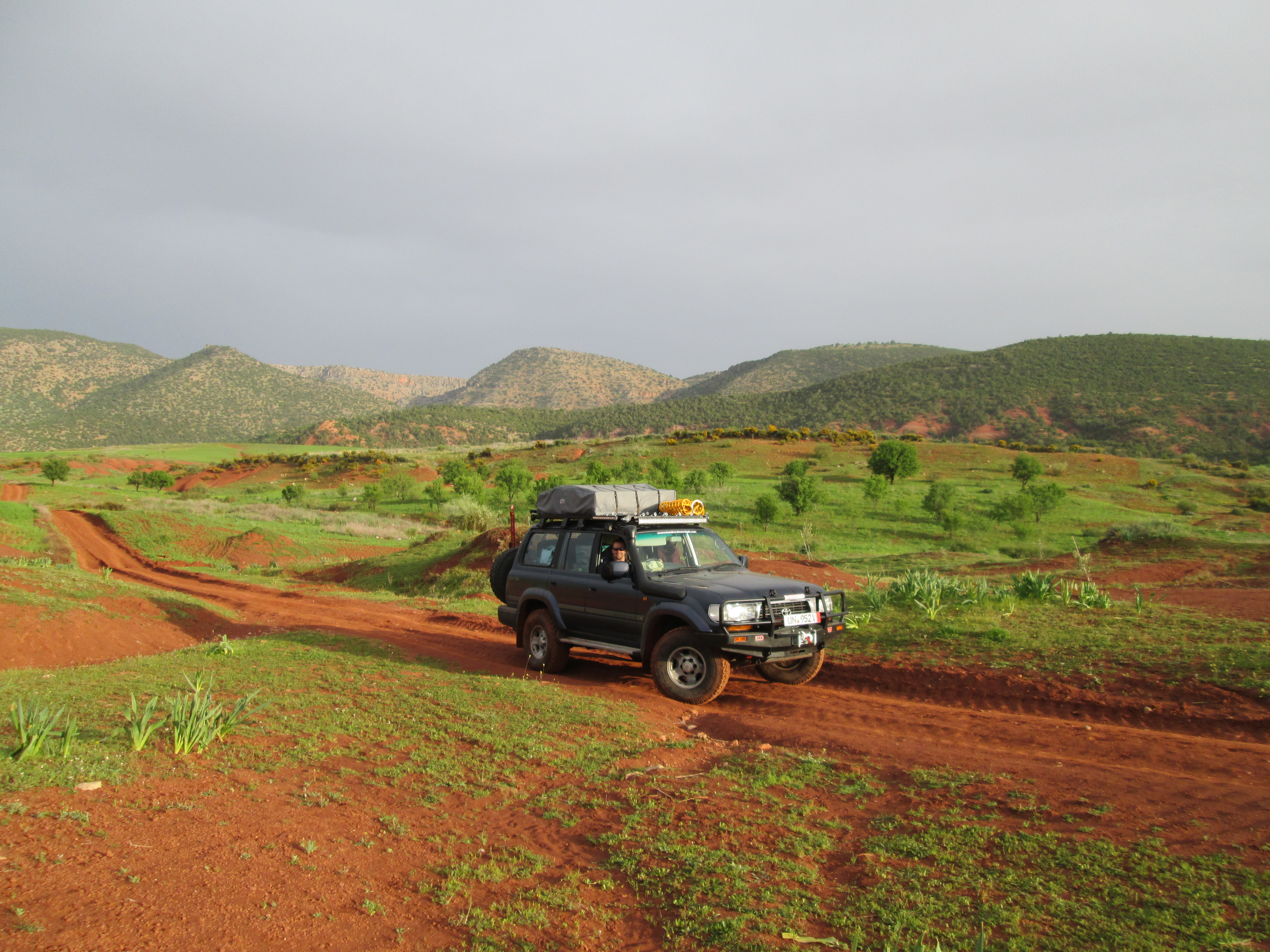

For those who participated in this group buy. I owe you all a huge thank you. The trip to Africa is on the way, and I could not be happier to see it all come together.
The 80 Series is driven by Chris Brennan. Who is a very close friend of my brother (George) and I. Chris and George fought side by side in Iraq and Afghanistan, I am grateful for Chris, protecting my family and freedom.
I must make a honorable mention...Shane at LabRak...
Shane (AATLAS1X) busted his balls to get his modular rack ready for Chris's 80. Despite the very short time frame, I did not think either company was going to make it in time for Chris's departure. However Shane (LabRak) pulled off the greatest roof rack, and ELS (George and I) designed a lighting system for Chris. Shane and I talked almost everyday and kept each other updated and on each others toes.
LabRak's Modular Roof Racks and the Expedition Lighting Systems LED Lights will be tested over the next year in Africa. The LabRak will carry all the aids, and the ELS lights will provide the lighting to give out the aids.

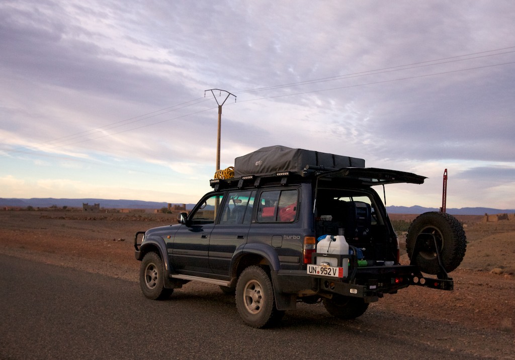

ELS Single Row Light Bars in Merzouga, Morocco being tested in the sand dunes.
Safari-Expeditions

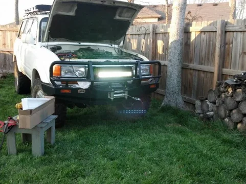

Started out to change the headlight relay to see if it fixed my NO headlight problem, it didn't so I will have to trouble-shoot that one later, but I decided to work on the LED bar install.
I will post better pictures of the modifications to the Rigid mount later, but I was surprised that even if the bar had fit the mount, the mount didn't fit the ARB and would have needed modification anyway.
Nuff of that, here it is rough'd in and hard wired direct to the battery just to see it work.
Just the first of a list of To-Do's to get ready for GSMTR next month.... man it snuck up on me.

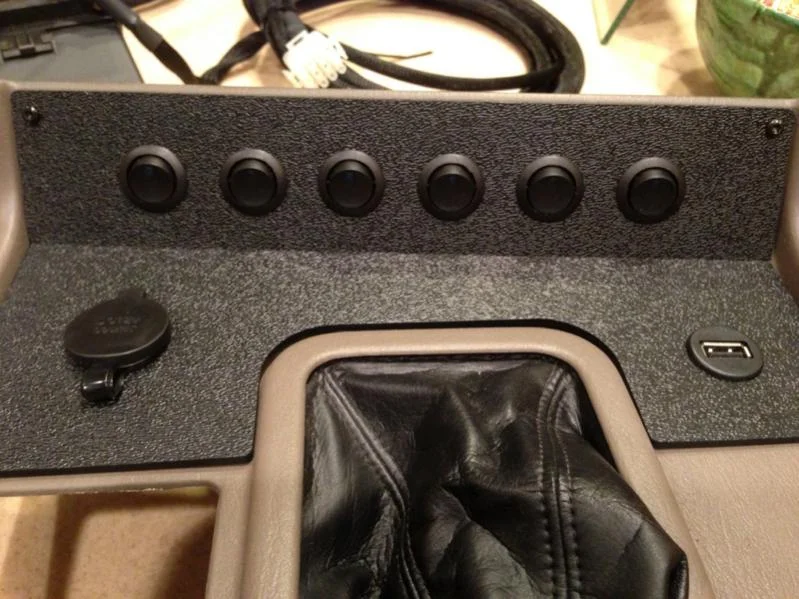

So I thought I'd post as few photo's of my LED light project to date..After purchasing the lights from Nick I went in search of someone to build a relay box and switch plate that would be plug and play.. I found Concours Specialties and the owner Greg.. who put together a relay box and built a switch plate that mounted to my front console..
The relay box has a 6ft wire bundle for the roof lights and a 15ft bundle with a connector that plugs into the switch plate ... The only thing I had to do was run a positive and negative wire from my second battery to the relay box which will mount next to the rear drawer slides.. Install the console and cut a whole in the roof... The roof wires will run through waterproof gland and I'm using weatherpack connectors for final connection to the roof rack lights..
Wiring the roof rack was not an easy task but I believe once the rack is back on the truck the area that I ran the wires would be free from any branches that might hit the rack.. I had a chance to test the lights ,switch plate and relay box and it works as promised .. Plug and play ....
I have run the wires from the engine compartment through the grommet on the drivers side fire wall and hopefully Sunday I'll pull my front and middle row seats and get this project finished
Lou

This switch panel is great! I maybe contacting Greg at Concours Specialties.
that looks super slick, question for you, is there ample room behind the stock console to mount switches? I am trying to decide whether to have a custom made panel done up or simply cut a hole in the stock console but I have never removed that console and am wondering if there is interference behind it with other components?

...yes

As you can see the wiring on the back sticks out more than an inch and it just fits
