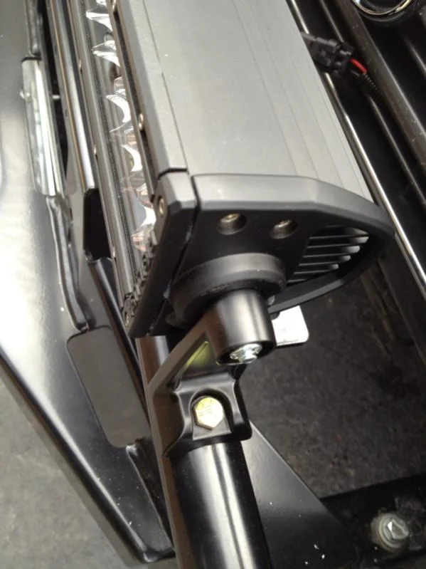

I have a 20" Rigid mounted on an ARB and the mounts aren't even close to the tabs.. Why not just mount it on the tube and keep everything square... You start bending the mount you'll have a hard time getting the bolt into the light ... if i understand what your doing.
Why not use the tube mounts ....or as i did just drill through the ARB

This is the mount that I ordered. The bottom has several slots and if one of them doesn't line up, I can drill holes to fit the ARB light tabs. Based on my previous measurements, I think it will bolt onto the outer-most set of slots. The ends are what will have to bend out to fit the width of the ELS Bar.

This is the mount that I ordered. The bottom has several slots and if one of them doesn't line up, I can drill holes to fit the ARB light tabs. The ends are what will have to bend out to fit the width of the ELS Bar.
Gotcha... now I understand.... If you cut one in half you wouldn't half to bend it .....not sure how that would effect integrity to hold everything down tight but its an option if bending doesn't work
