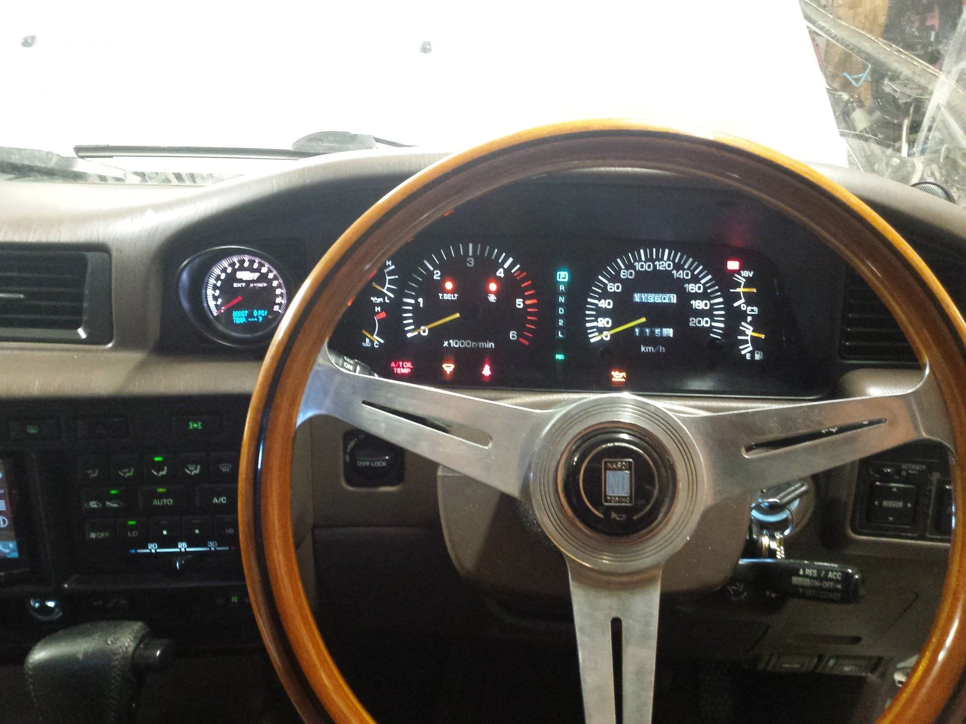

Here's the setup in my cruiser. I really like the ISSOPRO gauges and the mounting location is actually pretty easy to reference.
I run a PLX DM200 in my Evo. I like that setup as well, but more for the multi gauge digital readout. The analog dial face options on my unit are a little slow and not smooth. But, I like that I can have all my gauges in one.
That is where I used to have mine and found it too far out of eyeball range to really keep an eye on while driving :/

I have my EGT gauge mounted on top of my steering column. This is currently the spot I like most, but I wouldn't want more than one gauge there or it starts blocking too much of the cluster.
