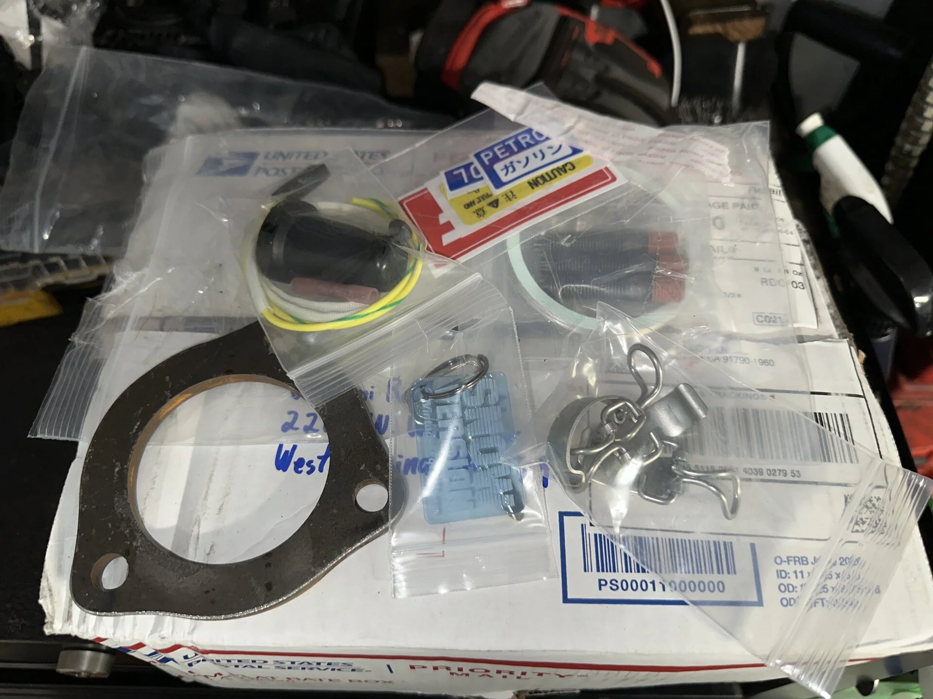

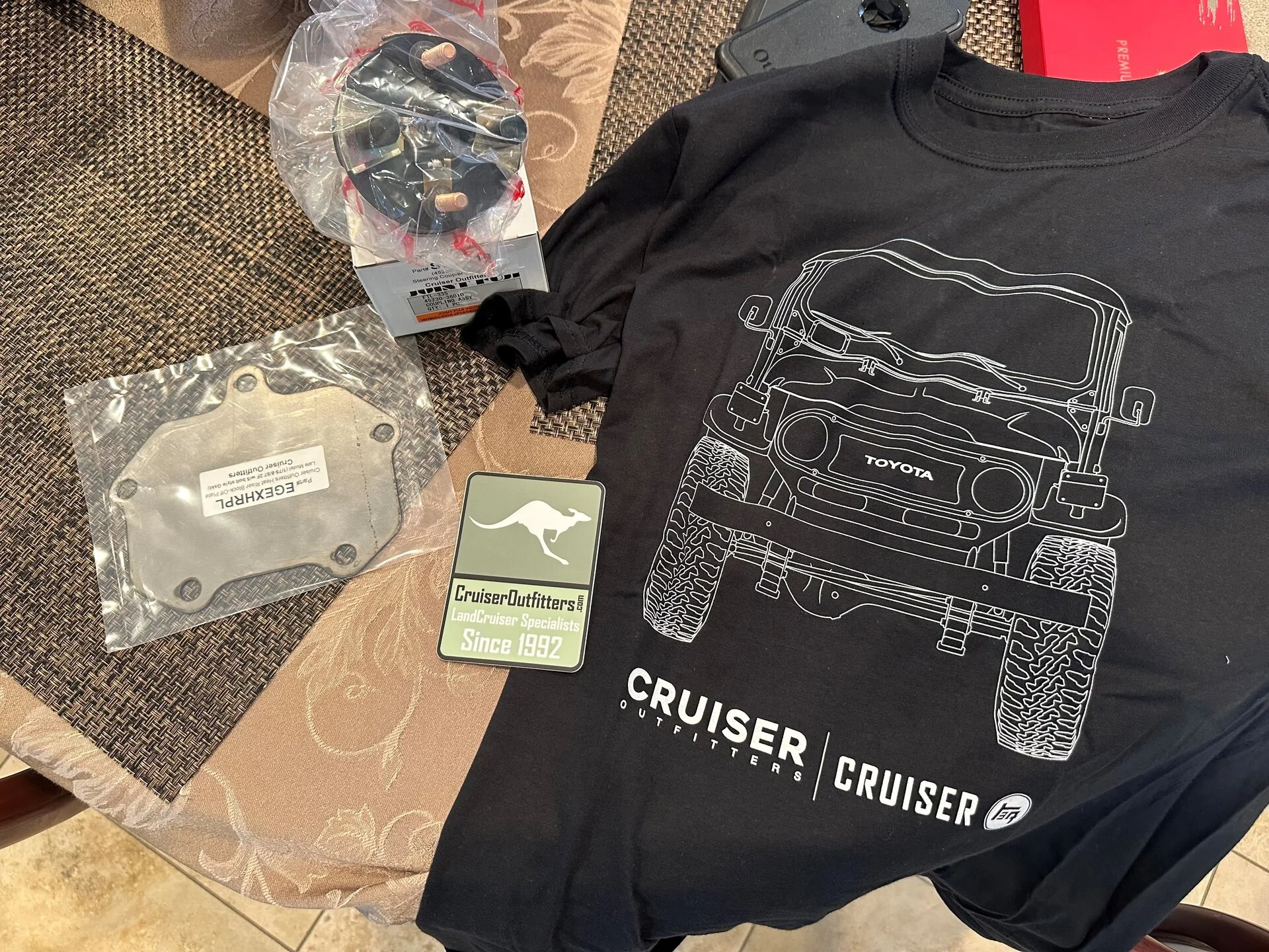

Aaaaand the first order of parts for this deal start rolling in. @cruiseroutfit Heat riser block off plate to prevent the intake manifold crack plus a couple other things to make shipping worth it ;)

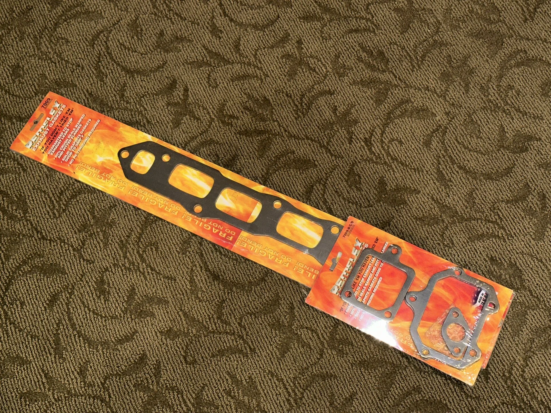

Remflex gasket set and an order of other bits from @ToyotaMatt should come in next.

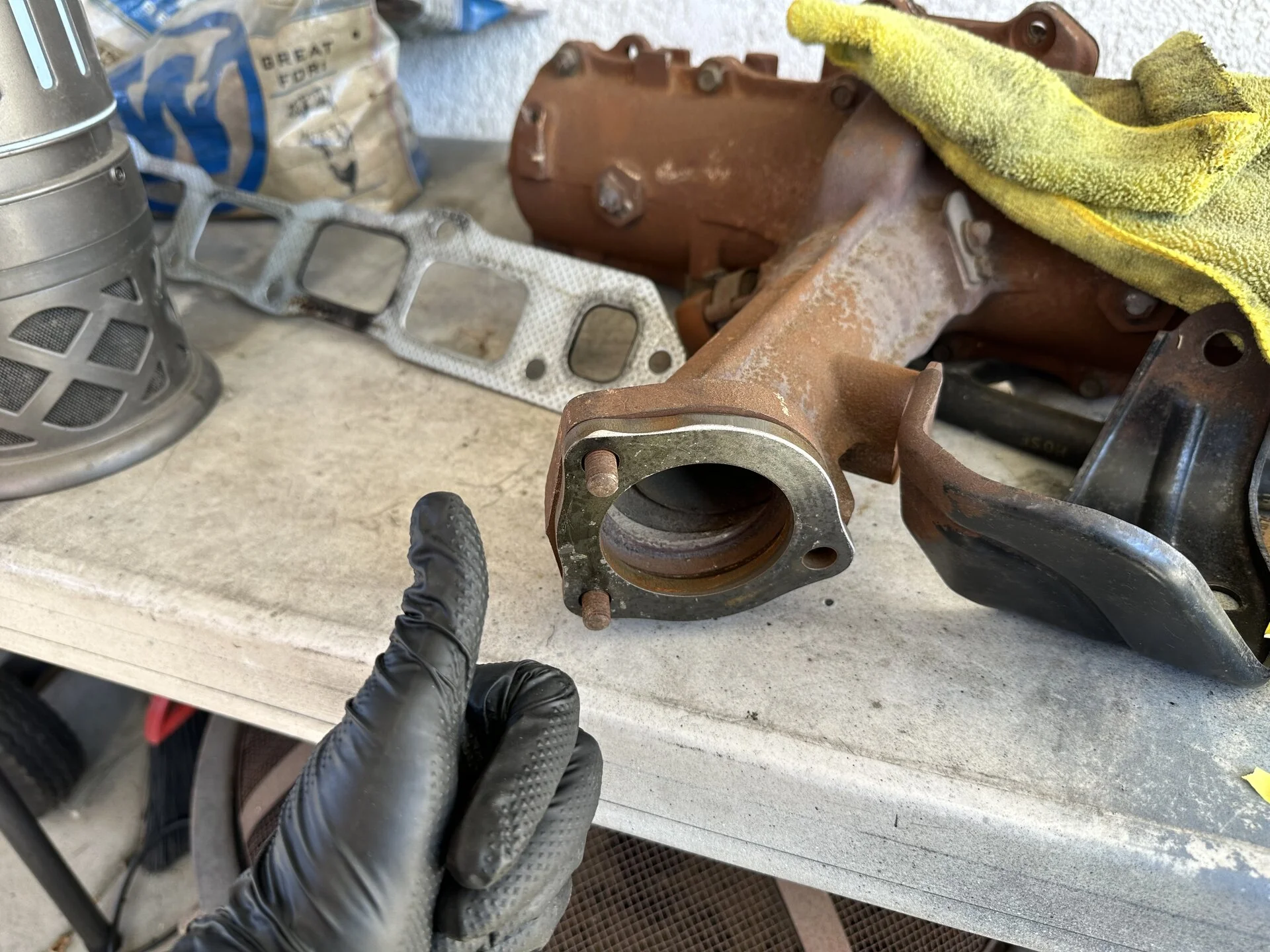

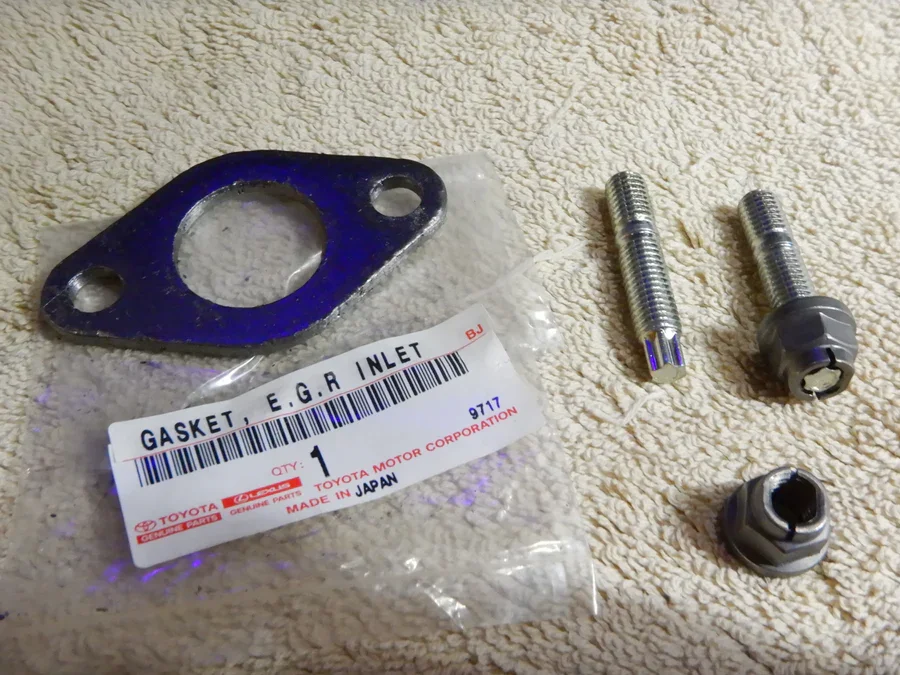

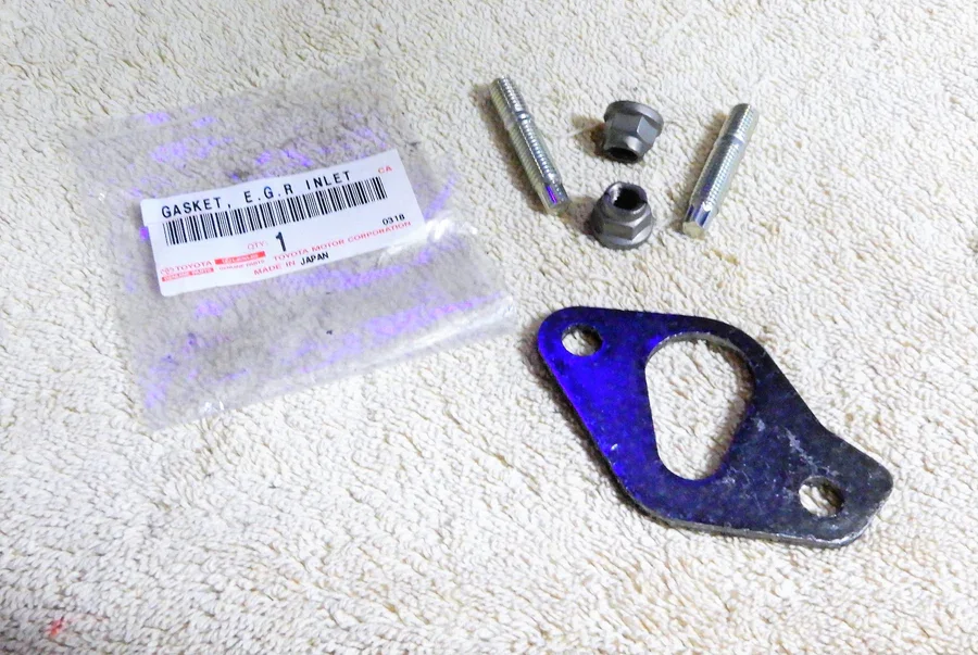

Amazon shipped this remflex gasket set in an obnoxiously large 6ft box lol. Anyone need the older style heat riser gaskets?
the last 2

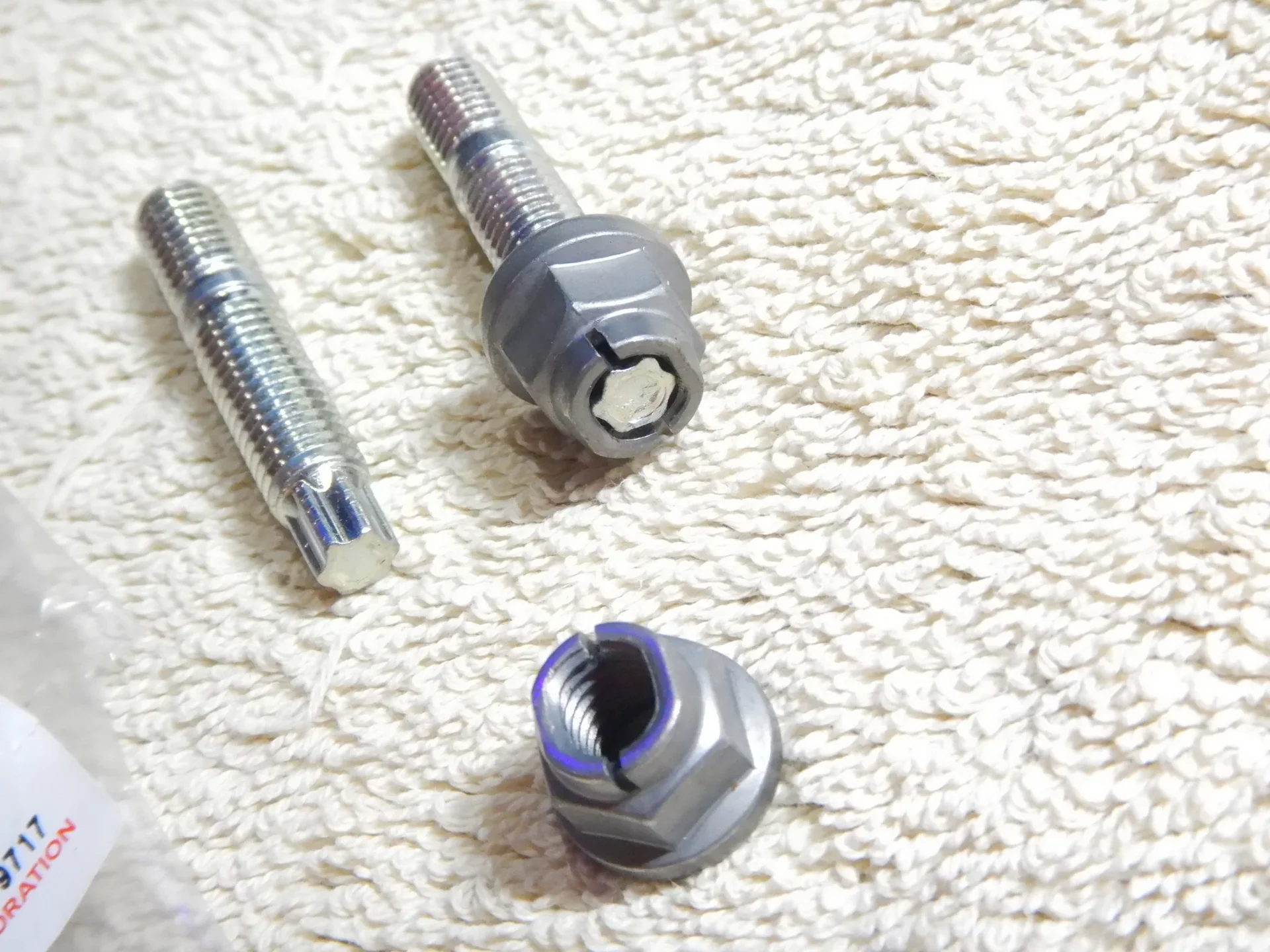

( separate occasions many weeks apart ) i purchased the 2F TOYOTA GENUINE Parts Exhaust Manifold Gasket from my local dealer here in town ..
- it was indeed a REM-FLEX ( STYLE - TYPE ) media ......
- the first time i noticed a shift in TOYOTA Genuine Parts direction 2F related , of any hint of this to come REM-FLEX Technology , in a OEM TOYOTA Part was these 2 rascal's below ...:wrench::wrench::wrench::wrench::wrench:
- the REM-FLEX brand of TOYOTA offerings , including LAND CRUISER anything models , was brought on the Land Cruiser scene i recall clearly by
👑 His Excellency 👑 : The late Marv Spector / Spector OFF Road ... 🍻
- the first one i ever installed i purchased from SOR .....
- i have Never wavered from this New wonderful Goodness called REMFLEX ............i have never had a issue or call back ever .......
- i always have also applied the Modern use of Modern JIS OEM Japan Spec. Fastener Technology too , ..
- i firmly believe , my own personal and professional shop-installed by the FSM Step by Steps long term product and performance service life results thus far are indeed related without any doubt whatsoever .....

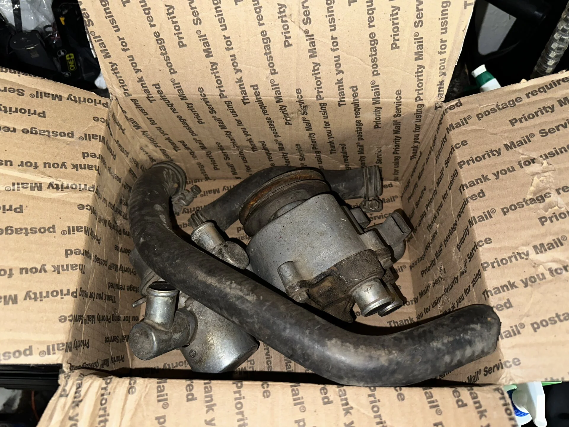

You'll be just fine once you get the smog bits on, just make sure the air pump is functioning because the exhaust needs strong air pushing into the exhaust to clean up the emissions reading. You'll see it when you get the smog readout.
Also to save yourself a lot of headache, get some stock sized tires on the rear to change your gearing back to stock, that helps a lot as well.
I used to full desmog then resmog every two years with my 60, its a simple process once you understand it. Just be sure to use nickel antiseize on everything.
That's desmog commitment! The pump was pulled off within the first year so it should be healthy.

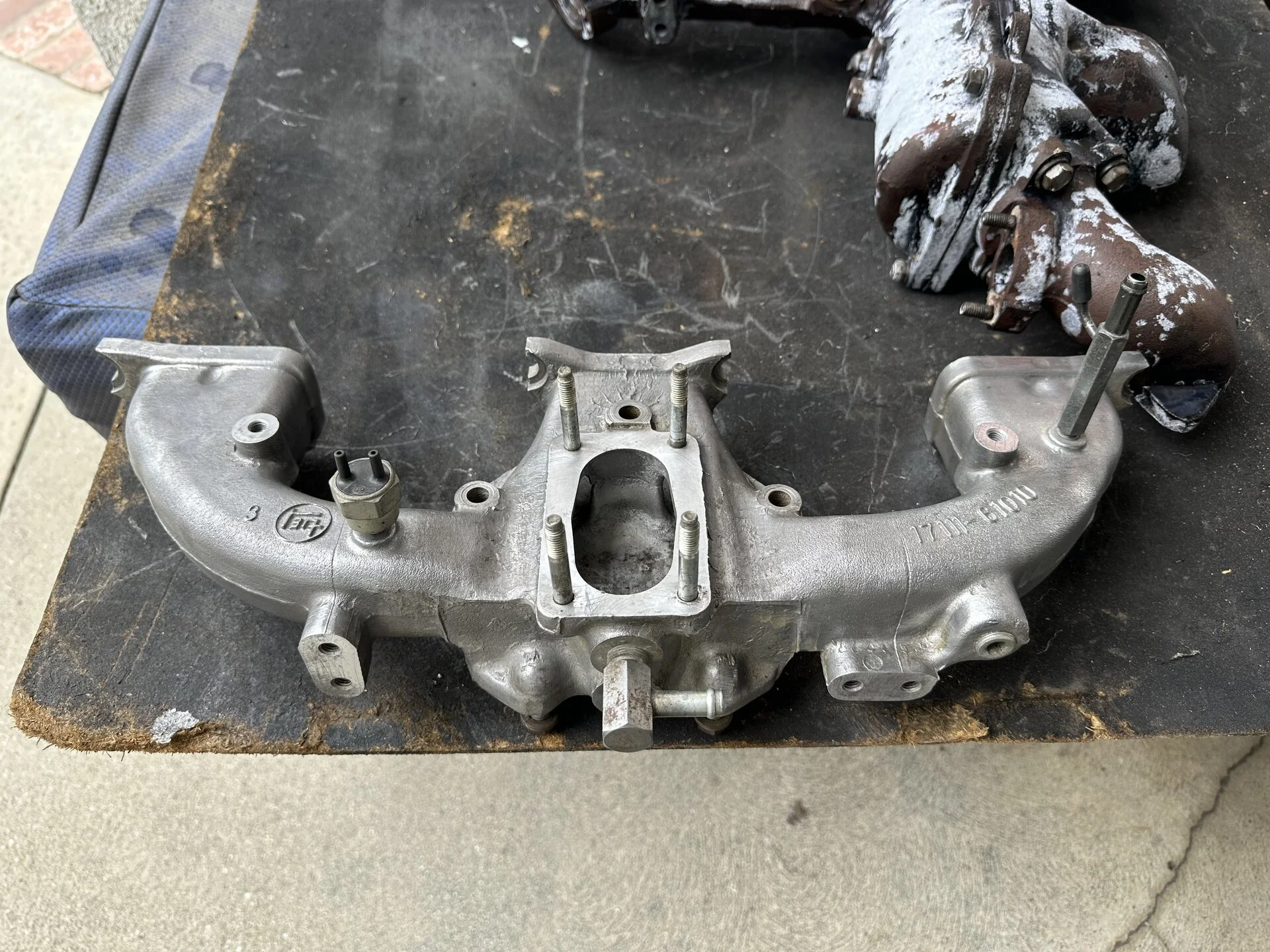

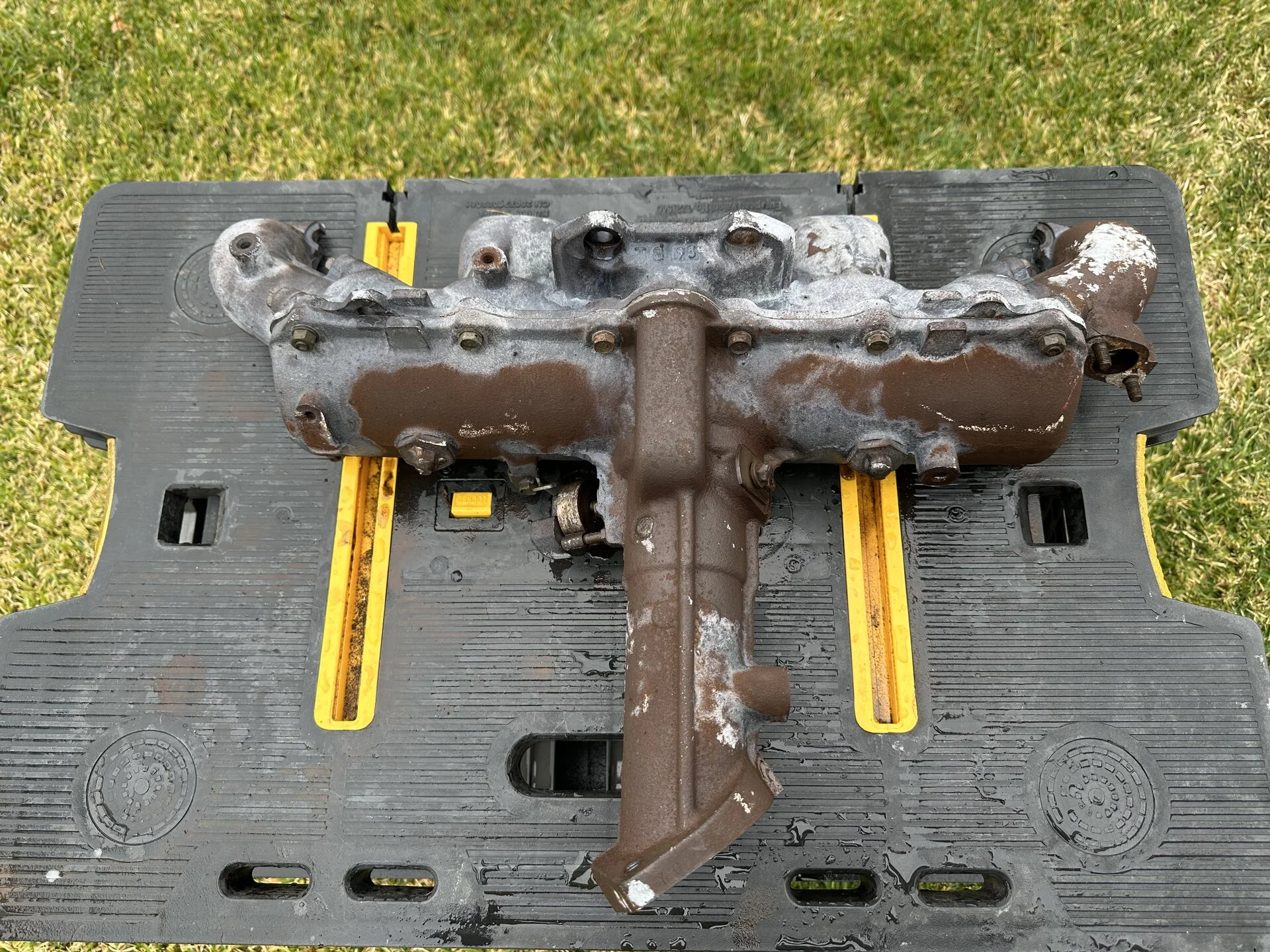

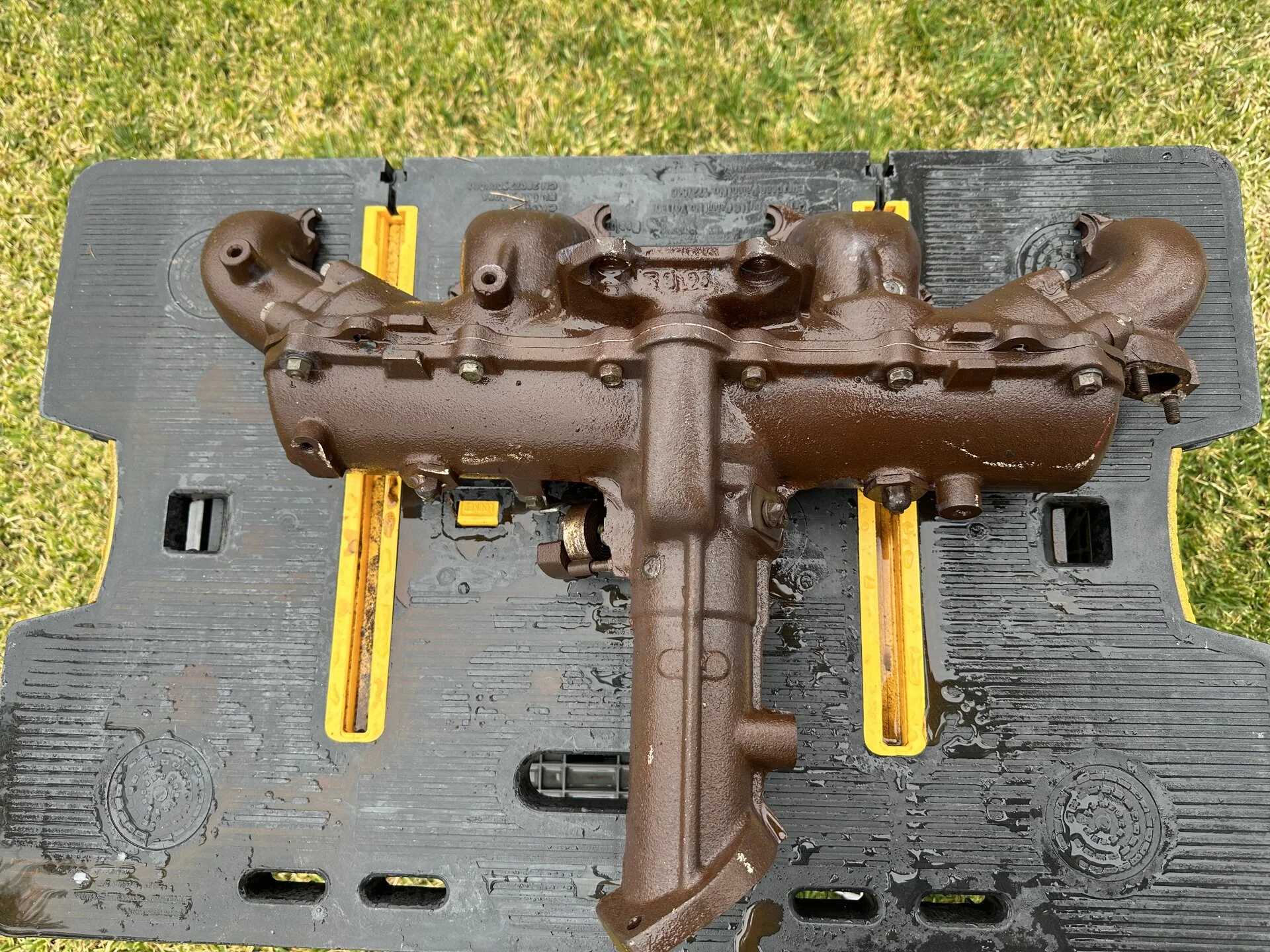

Right now I'm waiting on some eastwood cast manifold coating to come in, and I need to refinish a few brackets with steelit.

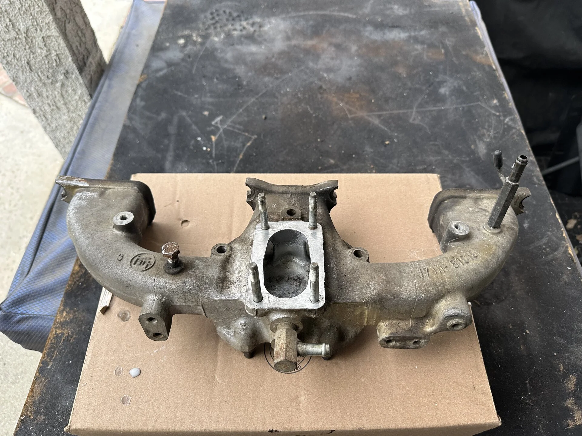

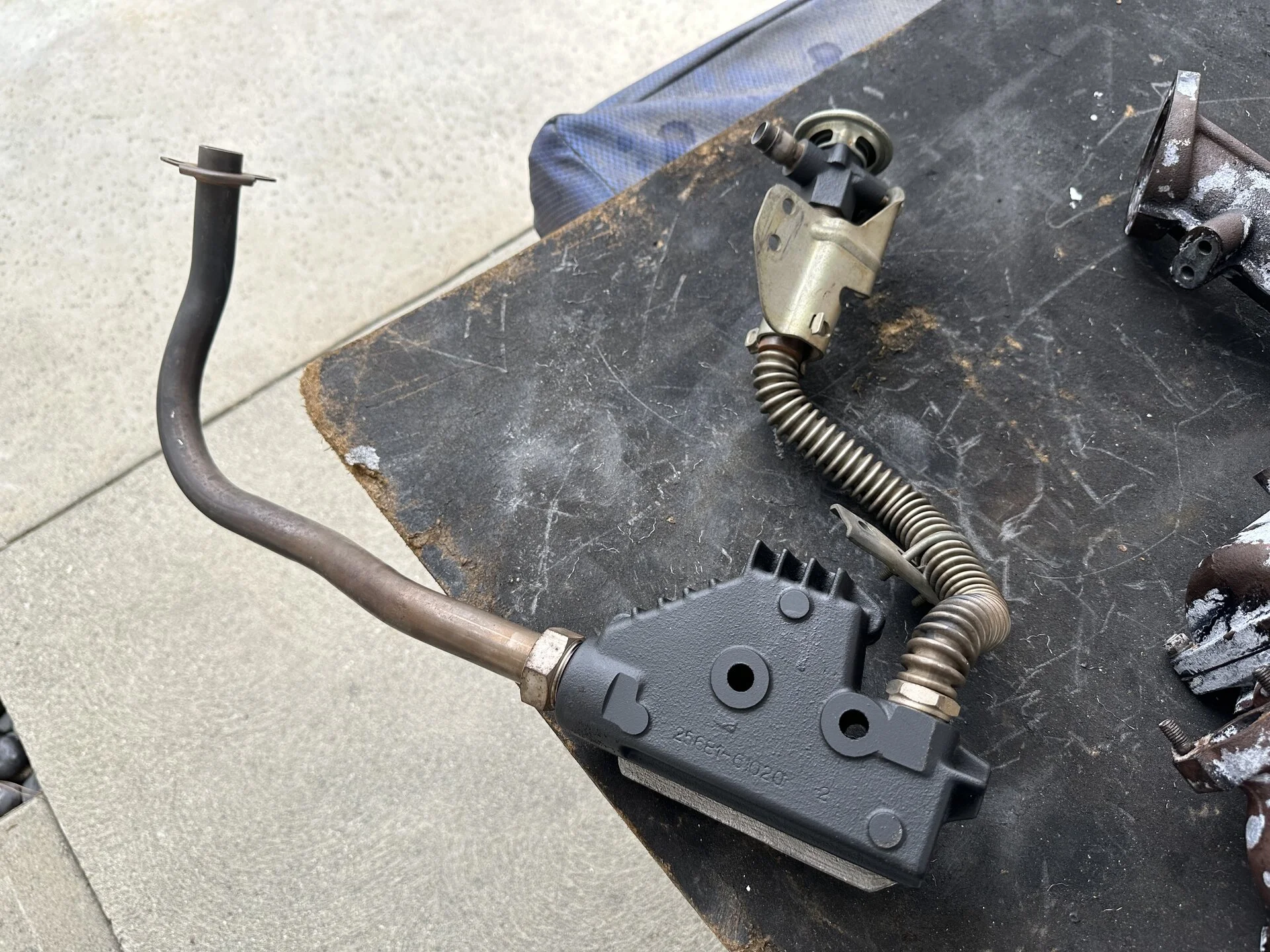

Got quite a bit of time consuming work done today. Started treating the exhaust manifold with krud kutter (3 coats so far). Wire brushed the intake manifold and detailed the rusty bits on the egr with rust reformer.
