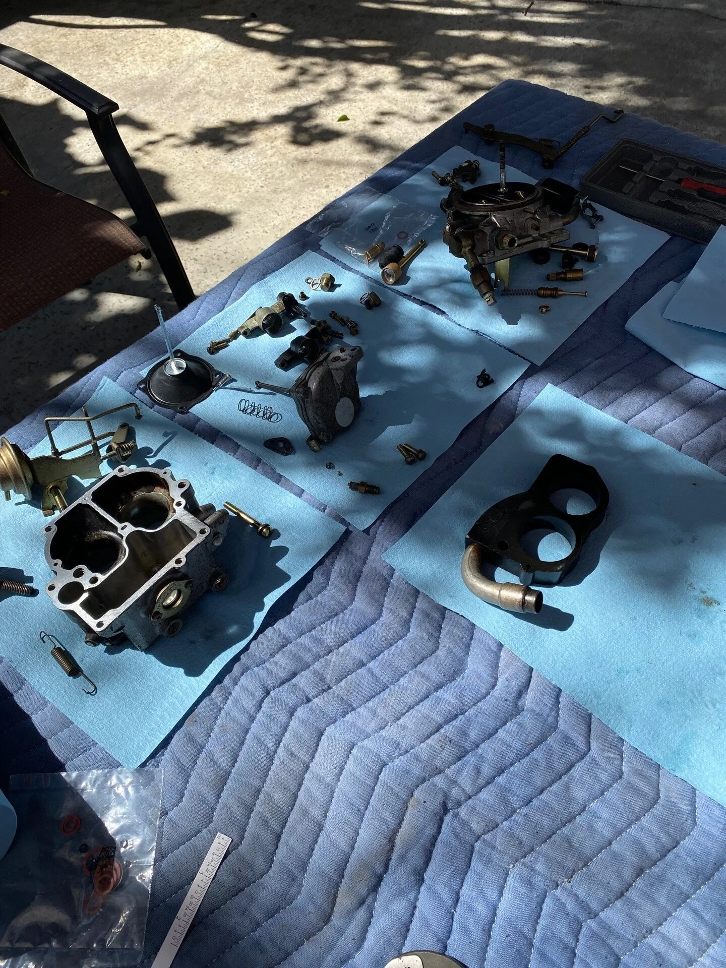

The block was frozen due to sitting in place since 97, so we had to take the head off and free up the block. We then ordered any gasket/seal/grommet/hose from the pushrod cover up, spark plugs, wires, distributor cap & rotor, fuel pump, water pump, thermostat and battery. After I got the head back on we rebuilt the carb and did a quick cold valve adjustment to fire it up, set the ignition timing, and perform a hot valve adjustment. I am more skilled than an average diy'er but don't do any mechanical work for a living. It was great bonding time working on the FJ40 with him and he even said the FJ40 never ran as good as it did after we got it running!

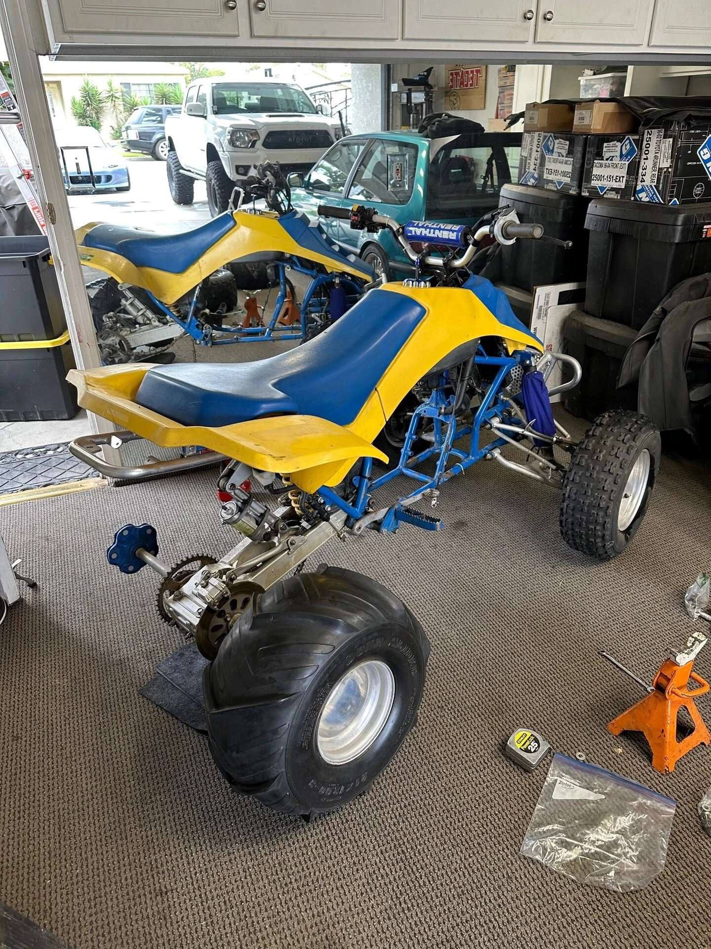

Do I spot an ap2? And I also have a tacoma 👌
My long lost brother lol 😄 Yes, that is my 05 AP2 and 91 Civic Si next to it. I am also restoring an 87 LT250R to take to the dunes once it's all ready 👍 Lots of projects little time!
