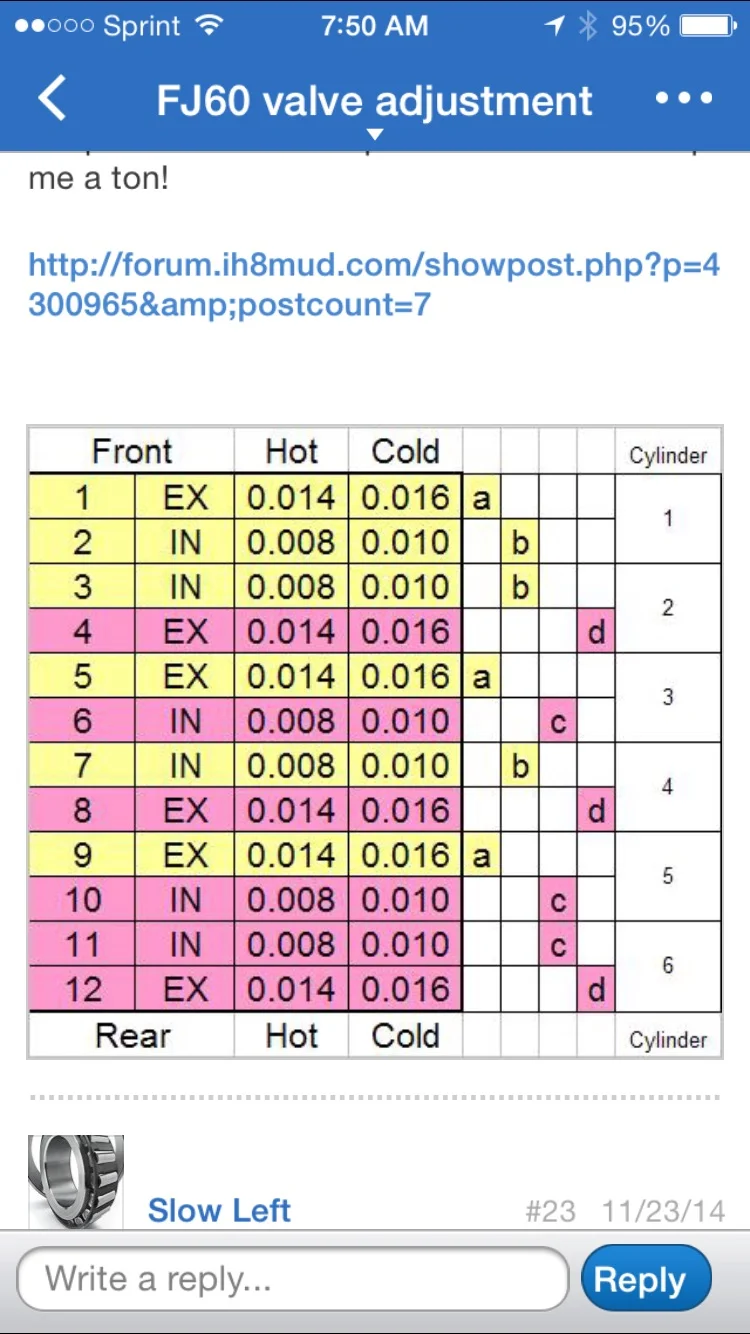

The numbers are for setting valve lash. These are solid lifter engines. I have a chart that can help you simplify this - you set #1 @ TDC, set 6 intake and exhaust valves, then bump it over 180 and set the remaining 6...

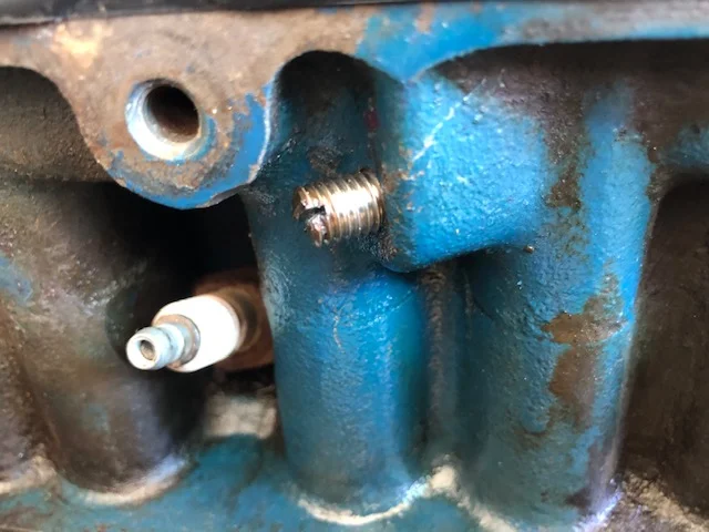

If you are waiting for the carb, you might want to source a set screw w/ an allen head, vs. the slotted plug currently. I guess you could always drill and extract yours, but since you are waiting...
I’ve always used this chart to set my valves cold. Started using this for my 60 but used it on my 40 and 45 with good success. I have no desire to adjust valves leaning over a furnace or even worse with the engine running.View attachment 2960522
Hopefully this is self-evident. If not, ask questions!

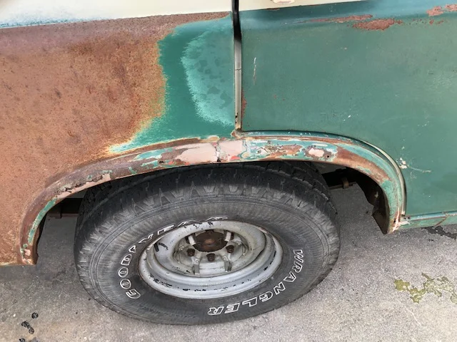

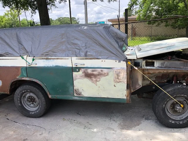

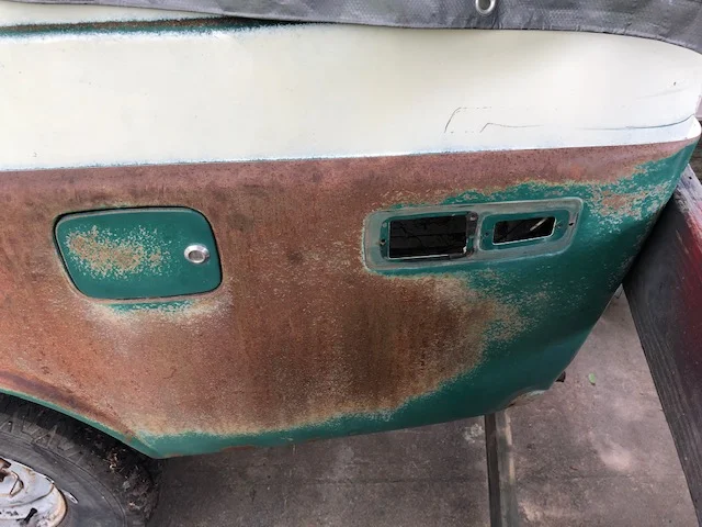

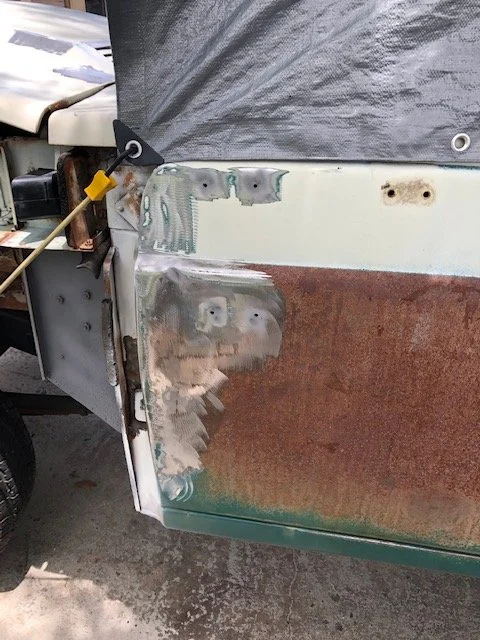

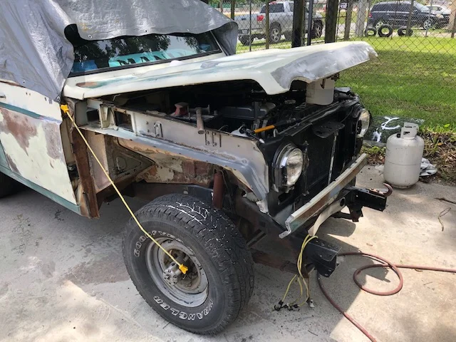

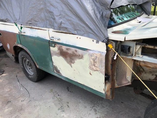

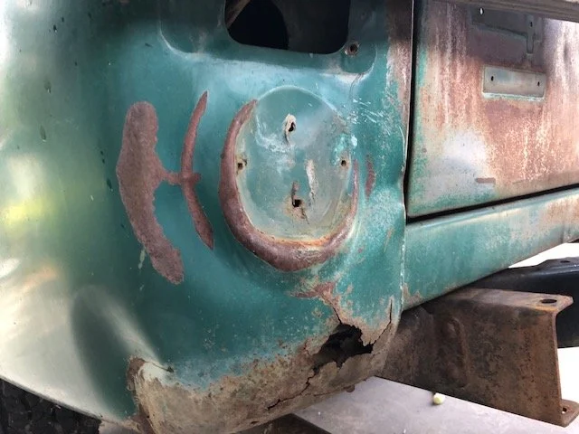

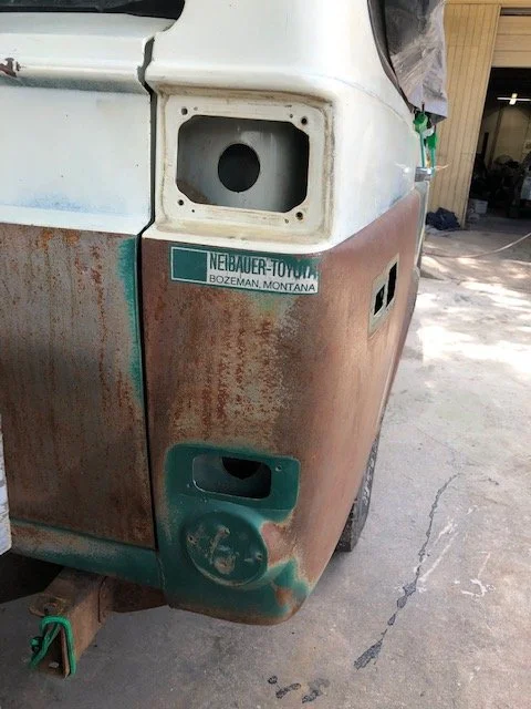

Thanks... Interesting (to me) detail, in response to metal working skills, this guy is amazing.. He does a ton of insurance work of course.. He cuts off rear ends, quarter panels, front clips, and goes to the 'junkyards' around here and removes the mirror part himself, brings it back to the shop, and I'm in amazement at how he does it... A definite honed and dialed in skill set... his metal work is exceptional and the best part of what he does.. The green/white took an impact to the left rear at the bumper corner, low speed, but still left some damage (I'll get some pics) and of course it suffered some rust intrusion over the years as well, so I offered to find a replacement panel... he quickly said not needed he could do it... and my bet is it'll be a mirror reflection of the other corner! He's that good.. I've got a set of the new front floor panels offered by Remy1974 and we're going to replace the front left driver's floor only... as he did on the red/white... so yeah, I've been watching/learning from him but from my seat he's been doing it for 50 years.... he's cutting out any perforated rust, replacing w metal... I'm very fortunate to be his neighbor.... Just 411, he's moving to Atlanta in about a year... so I'll be losing that... but if anyone is within consideration distance he's VERY $$$$ reasonable...
He's a one man band, owns all of his equipment, and does restos as a passion, insurance work for a living... I'm a huge fan obviously.. grins
