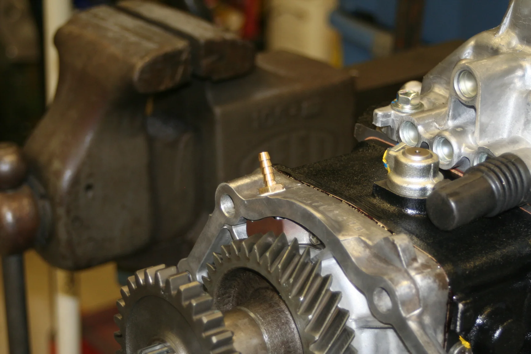

The transfer case has a vent cap, felt around on the tranny top plate, if it's there my hands didn't find it.. I've got an extra top plate somewhere in the garage and I'm checking where it's located...
Through the shifter....
Pablo, I was going off my split case and 5 speed, not sure now about the older stuff.
I did come across a photo of the Downey 3 speed floor shifter that was in my parts wagon with a vent on top.
