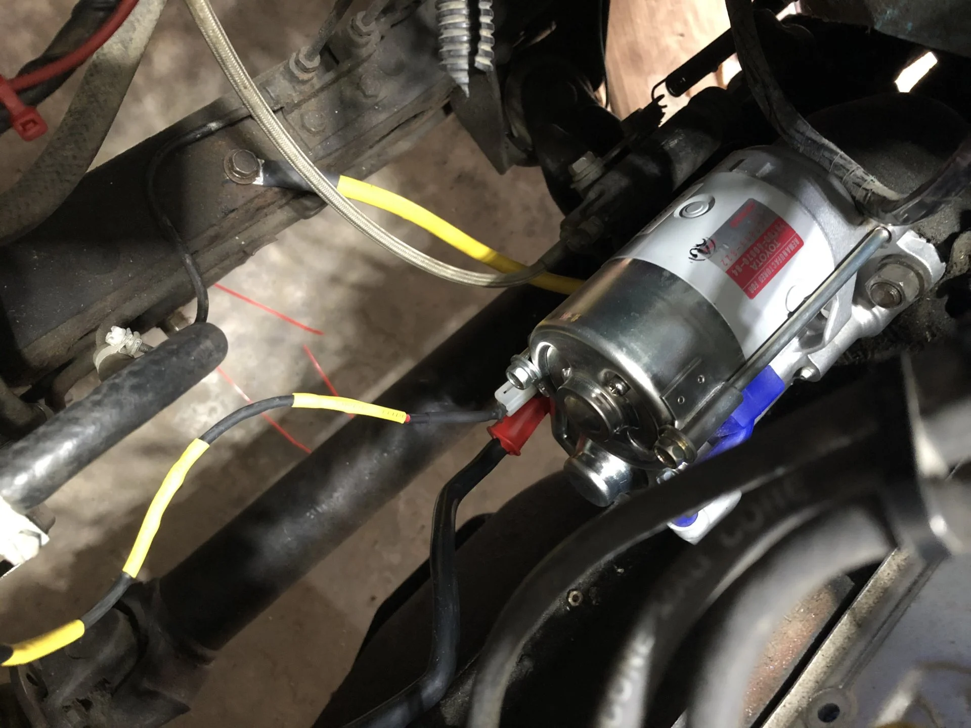

This is the connection I used from the FAQ:
It’s not common for an engine bay to be clean enough to see the starter bolt.

Called up a favor down at the diesel shop. Ended up with an interstate. 150$ out the door. Friends and family discount was in effect. Temporarily wired everything up according the FAQ. Sacrificed a chicken and mounted the cockpit.
5-6 pumps on the go fast pedal and hit the launch button. Booooom it cranked, coughed and sputtered. A little tug on the choke, hit the key, one more hesitant sputter and the Mule fired up like an F-35. Kinda sounded like one in the confines of my smallish garage.
