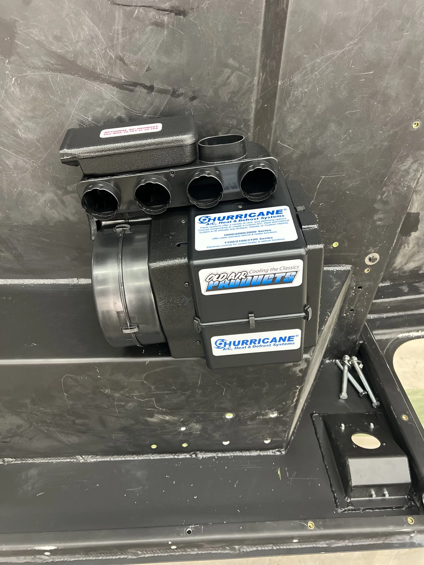

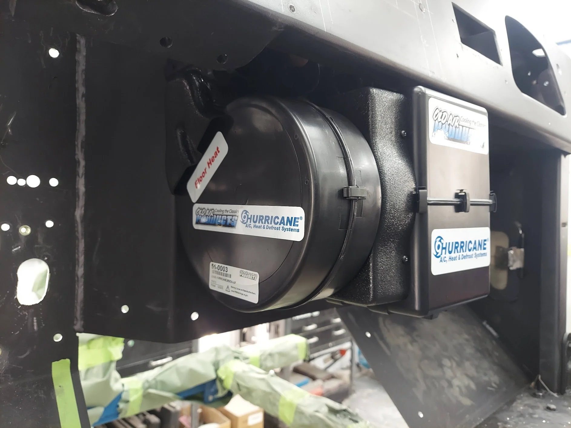

This unit mounts in the same location as your OE front heater. Pic shows the mock-up case used for locating your mounting points. So it’s not located in the passenger footwell area.
Which vehicle is that for? I see they don't offer Toyota on their site. I'm assuming they are pretty much all the same.
The only thing that is Toyota specific in the Vintage kit are the engine bay components, Vintage Air sells the Toyota specific condenser and compressor bracketry. And for those with a cowl vent, you have to modify the Vintage Air evap or remove the dash tab anyways.
So, what you're saying is that all Old Air boxes are the same size? I'm not a fan of Vintage air. Didnt know about this setup until now. I like that the box is pretty close to the size of the OG heater.
They have a ton of different options- some under body and compact etc…. The Difference between the 3100 and 2100 series is where the lines come out of the unit.

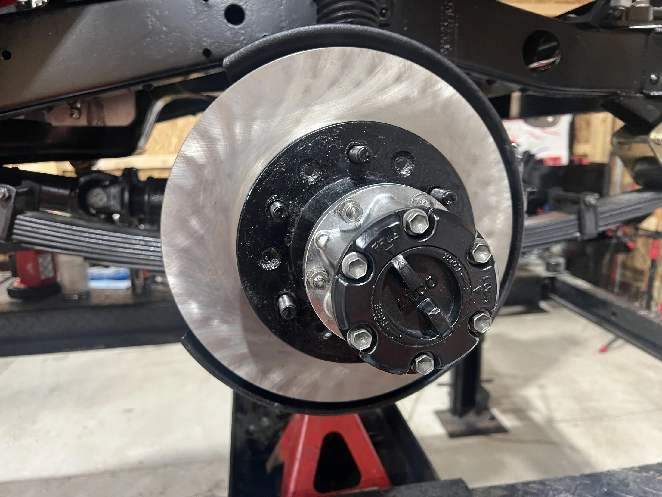

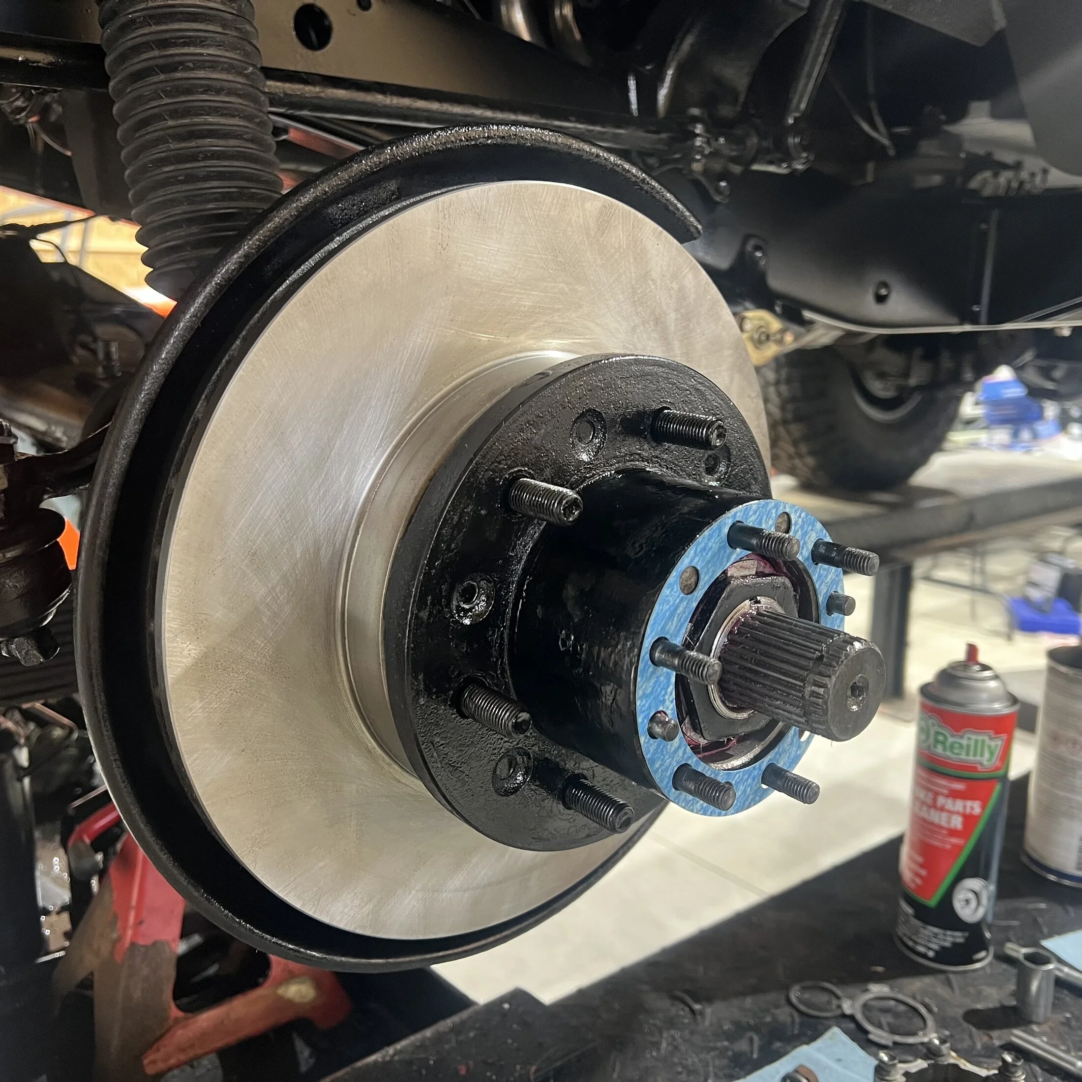

Mech shop/RCLC doing yeoman’s work. Ultrasonic cleaning rooting out the last pockets of resistance and new rotors topping off the knuckle rebuild. Victory lap ensues.. @Jdc1

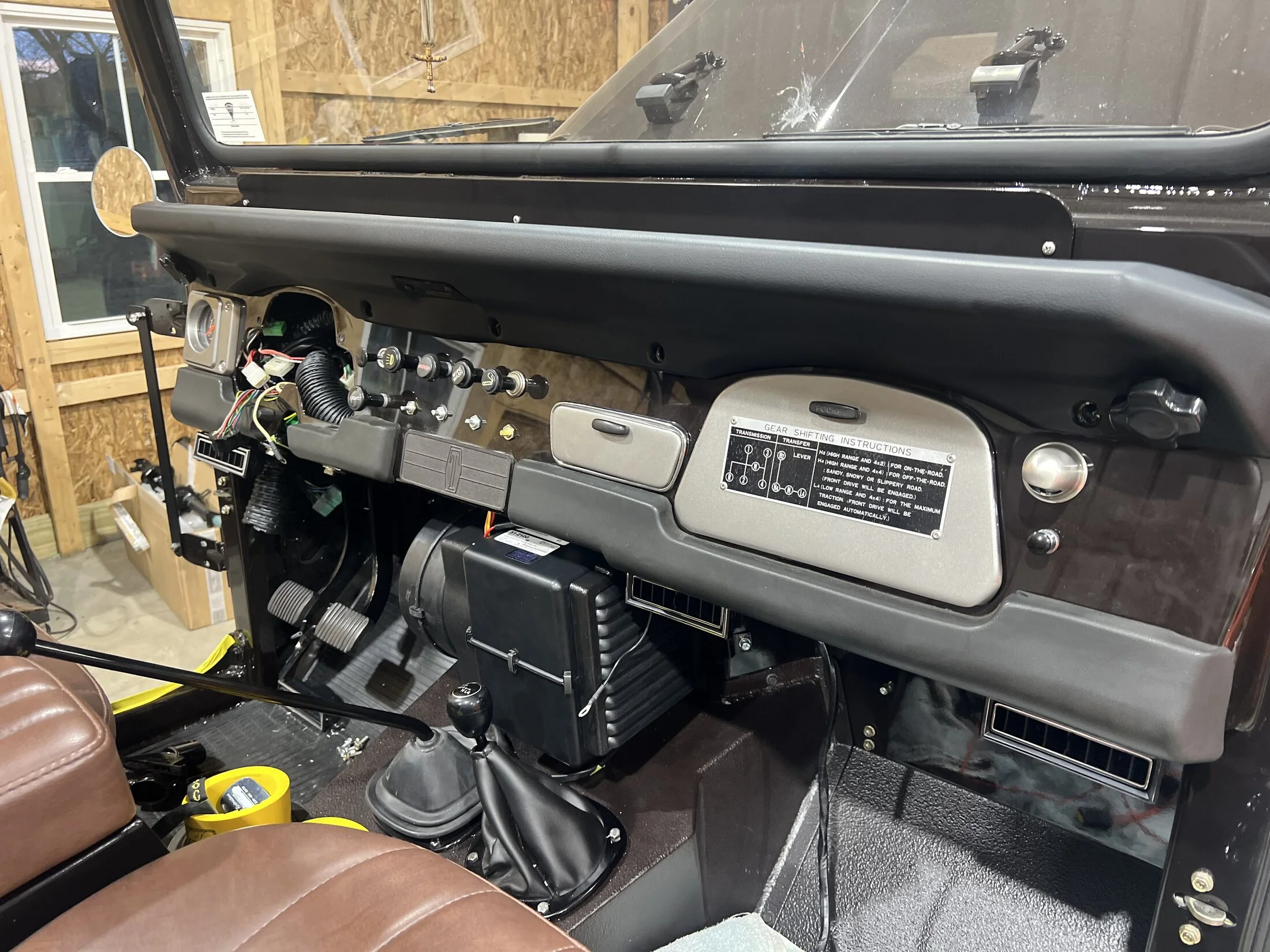

Follow up on the OA installation. Disclaimer: work in progress.
Better vis on the Hurricane. You can see how the unit protrudes a wee bit from the dash. Three vents in place. Fourth vent will go just to the left of the OA unit. IMHO, this setup allows for a better concentration on the driver and passenger side, as opposed to the traditional “centric” setup. 2 cents worth of opinion. YMMV.

I have a dumb/ crazy idea.
Idea- cut up an old heater box to go around the O.A unit? Not that I hate how the unit looks, I just wonder if it can be done. 🤔
Anything can be done- I thought about that and my opinion is that might add more bulk and draw more attention. Once the rig is on all 4 on the ground it should be back of mind after awhile.
I wondered that as wel as far as adding bulk. I agree that once everything is done it won’t stick out as much.
Looking Forward to final install
