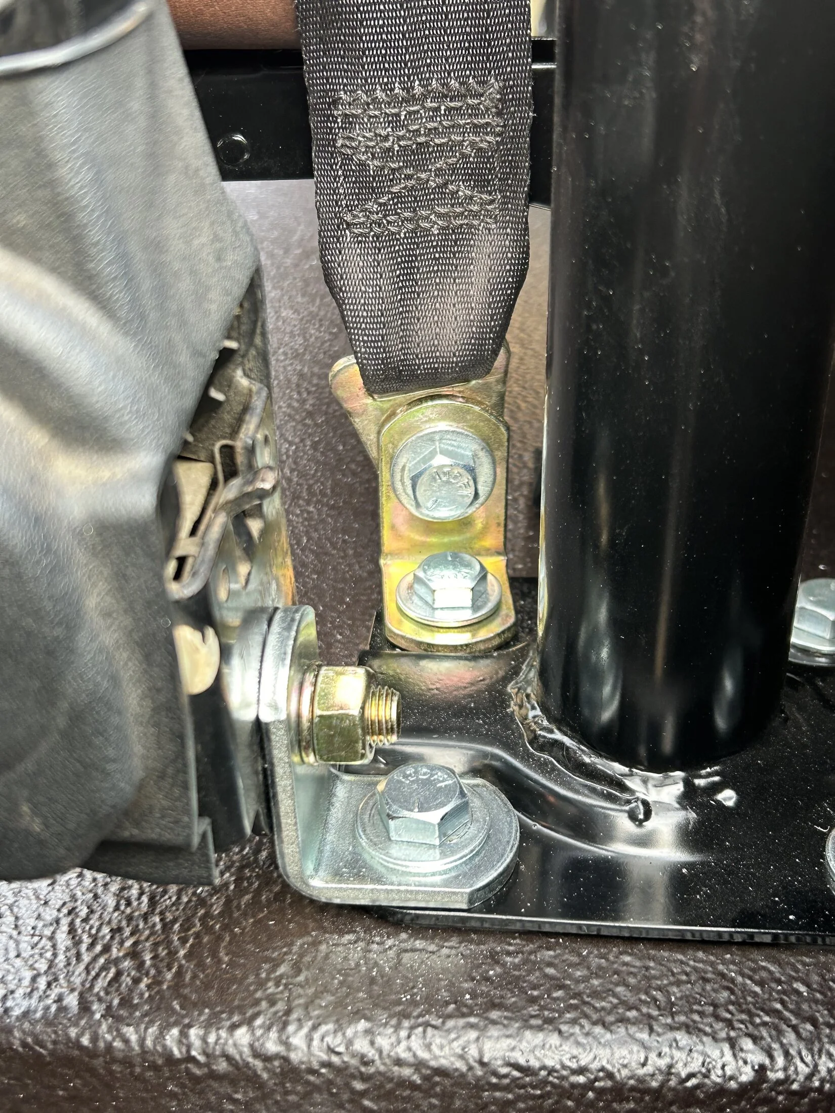

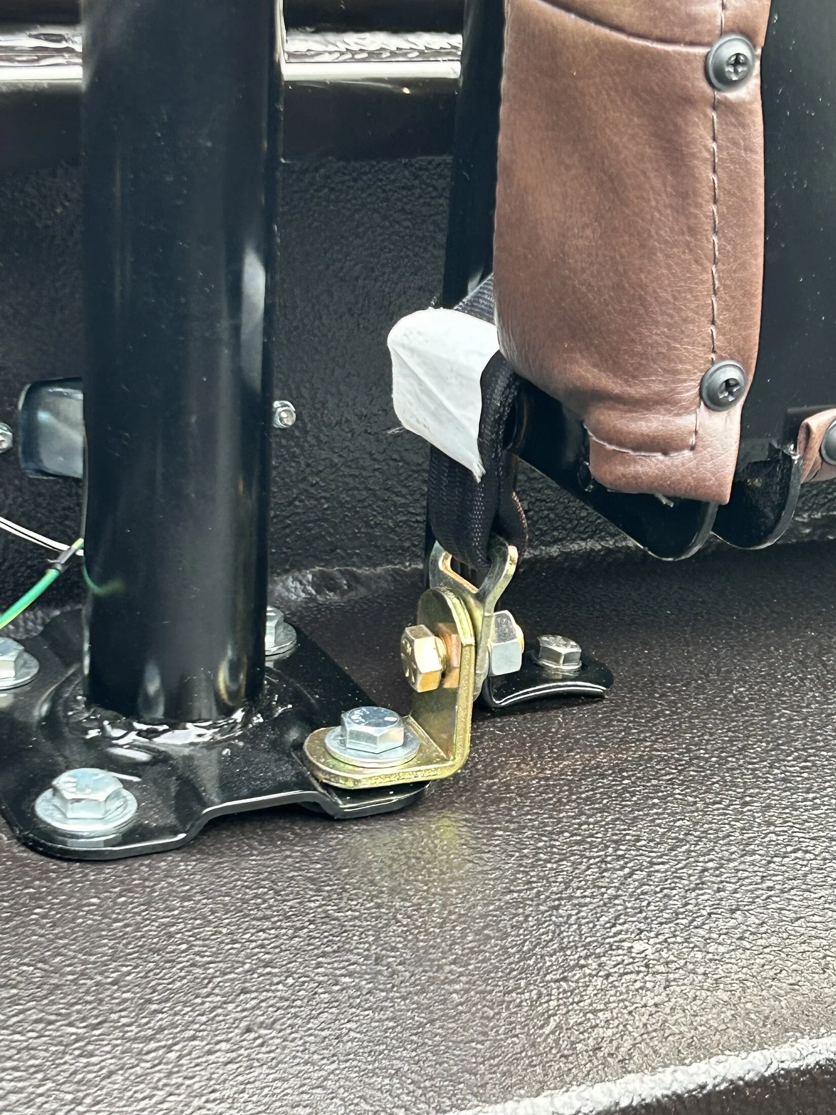

CR, are you using a 3 point belt or lap belt?
Yes 3pt. Anchor point is different on 2.0 vice OE tub. I added the 90* on the Jseats to ease the angle of the anttachment on the RB foot.

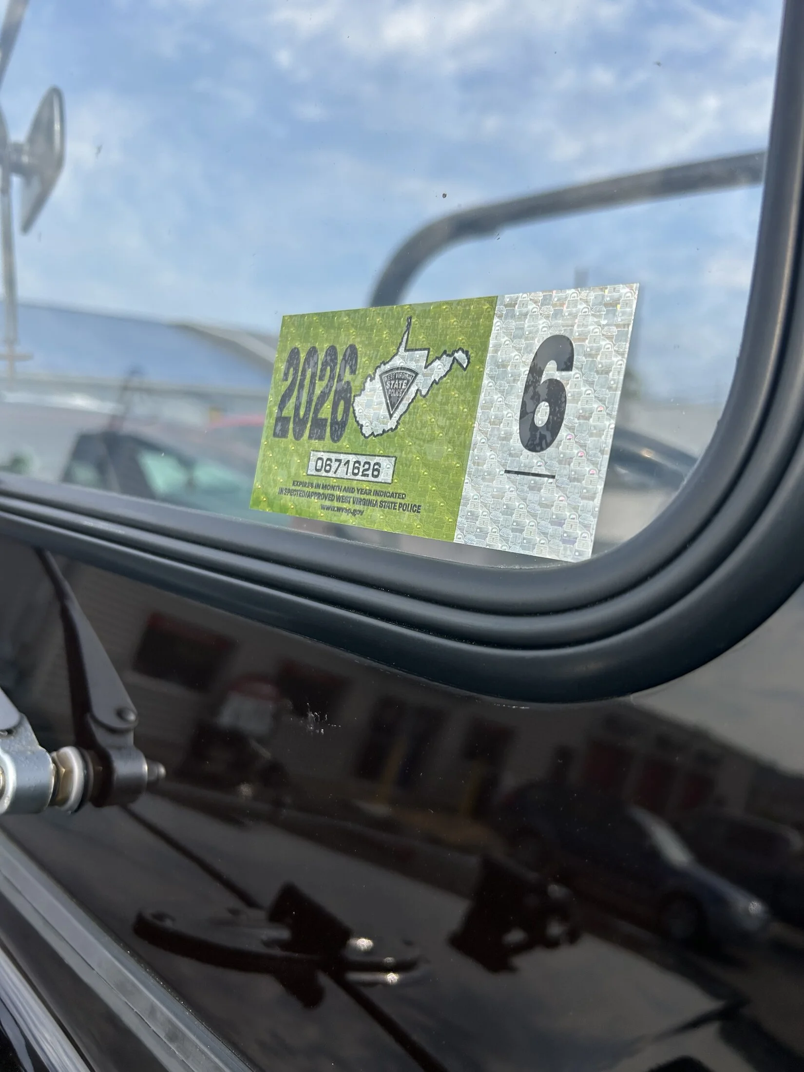

Official Land of Nod Inspection Sticker…
That’s high cotton right there…😎
Wait - - is that a WV bug splatter on the w/s frame? Tell me all you gotta do is use a little bit of all purpose spit and a bandana to get that off - STAT!
I’m leaving it as a talisman….

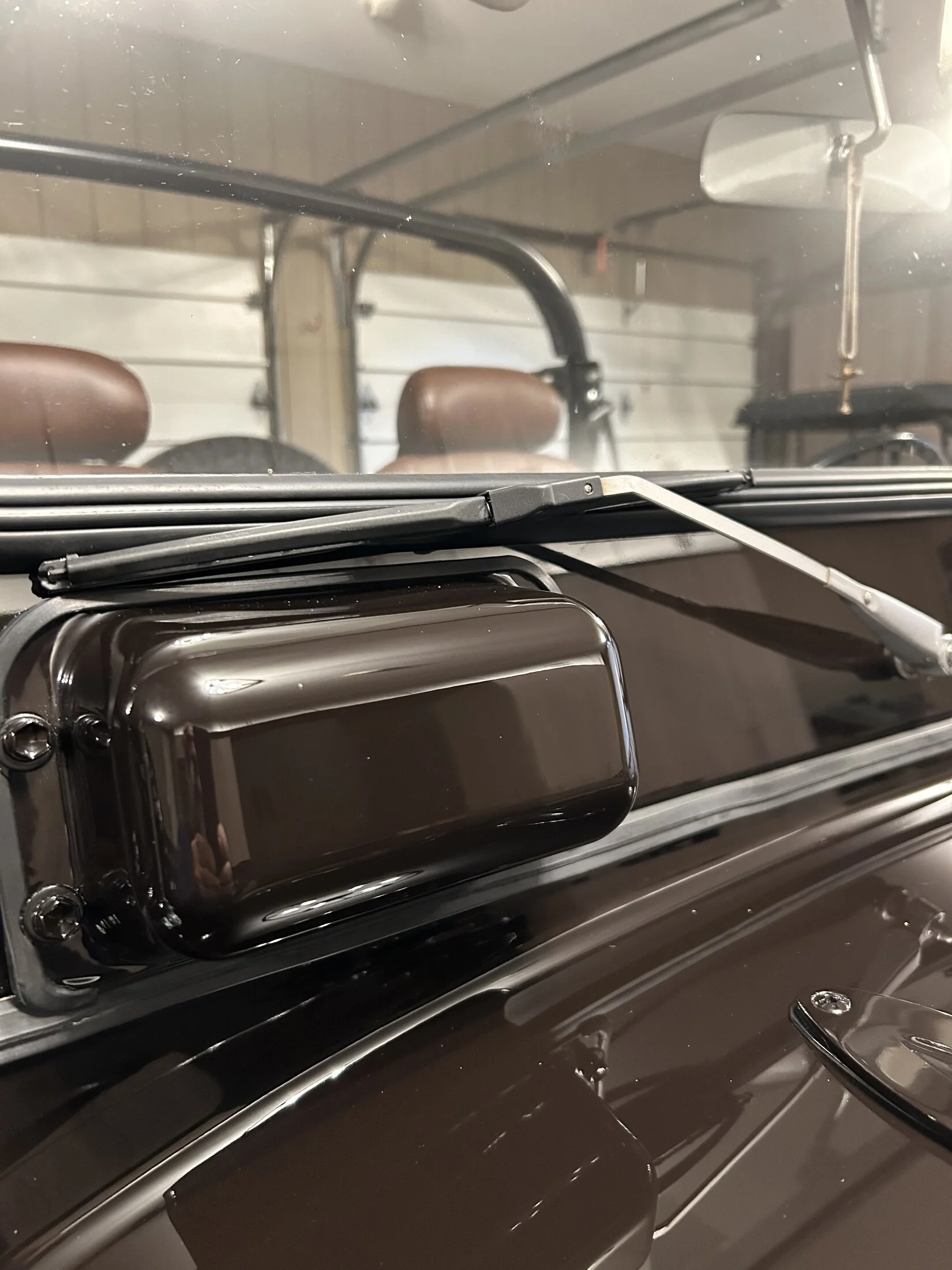

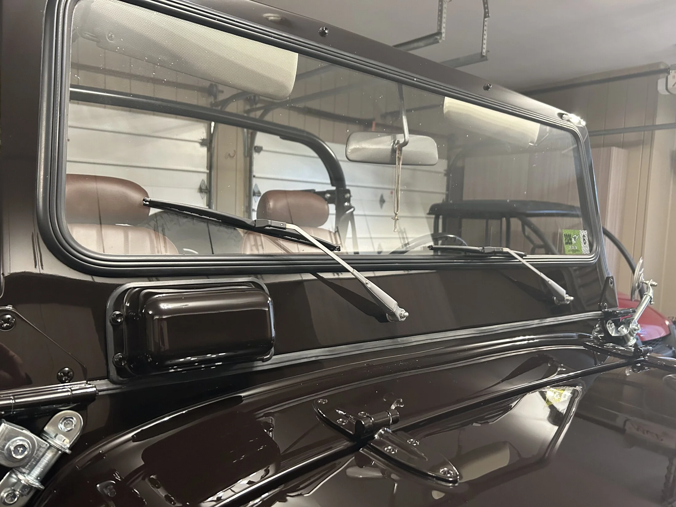

Adjusted the wiper arms. Putting a few miles on the Mule this AM. Headed to Grandma Chungas for an HVAC consultation. Also, putting some ideas to paper Ref: skeet/bird hunt shotgun storage…One of my High School/USMC buddies has a wood shop and we’re going to collaborate on this random neural firing of an idea. :idea:
