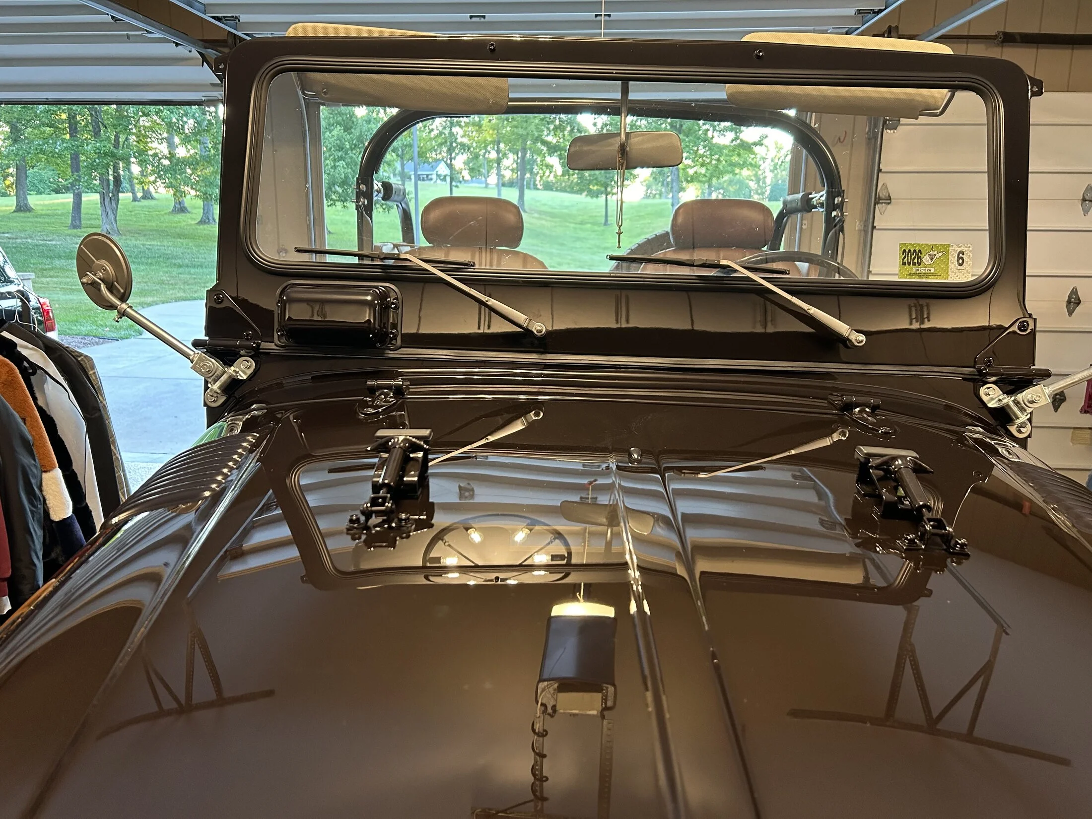

Nice! You know…one of the things that always drove me towards the deep end of my mind is the non-symmetry of a pair of wiper blades. When at rest, they need to settle in the same plane and near the weather stripping or bottom edge of the windshield. I had to bend the arm on my top mounted ‘74 50 years ago in a vice. Would you know, 48 years later, I had to bend the arm on my bottom mounted ‘75 to stay symmetrical. Heaven forbid, after using them, they did not return to the equal positions …..I would wet the window to insure a minimal friction drag and re-adjust

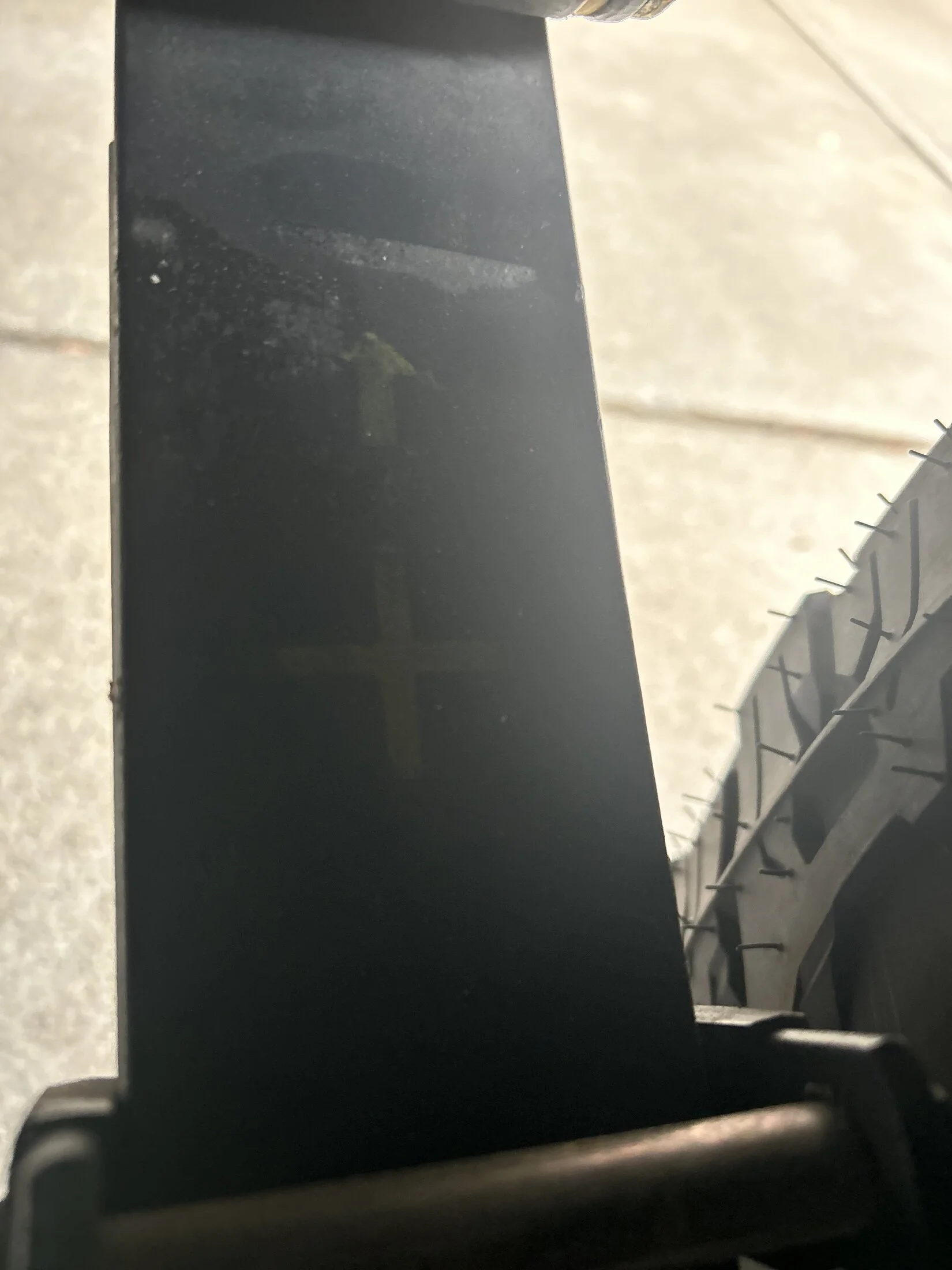

I got to puzzlating yesterday after reading your comments. You ever have that sensation that something wasn’t quite right, like that time as a kid, just before you whizzed on a buzzing fence? Well, my gangsta lean to the drivers side can’t be blamed on the Ohio University dining facility. Crawled around underneath 2.0 this AM for a photo op. My + and O (OME Dakar leafs) are not where they should be. I’ll swap sides here in the very near future and see if that helps with the driver side lean. It’s not horrible but, it would drive @knuckle47 🦇 💩 😜 to see it..
“OME/Dakar spring will often have a +, o, or a - painted on one end of the leaf spring, so what does that mean? The + means slightly over spec, and when we say slightly it wasn't enough to consider the spring an error rather it is by design. The o is exactly at spec and the - slightly below spec, again by design. As the drivers side of a vehicle often has more weight, its common to use a + on the drivers side and a o or a - on the passenger side”.
Currently:
Pass side with the +
Driver side with the 0

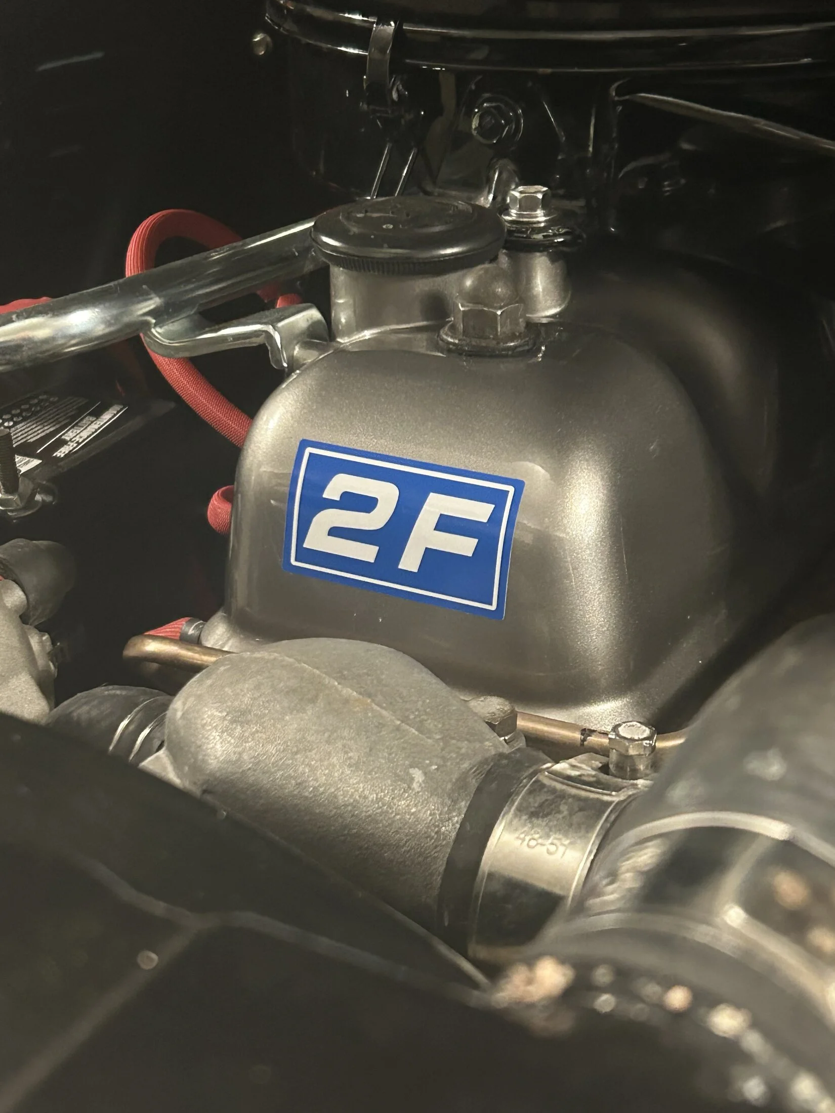

That looks like an interesting clamp from the radiator to the thermostat hose - can you provide deets?
At least!
Stainless worm drive hose clamp (shouldered). Purchased from the interwebs during the 1.0 storage bld build.
