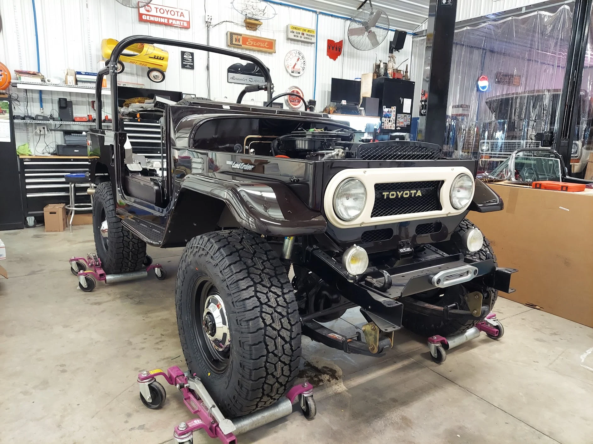

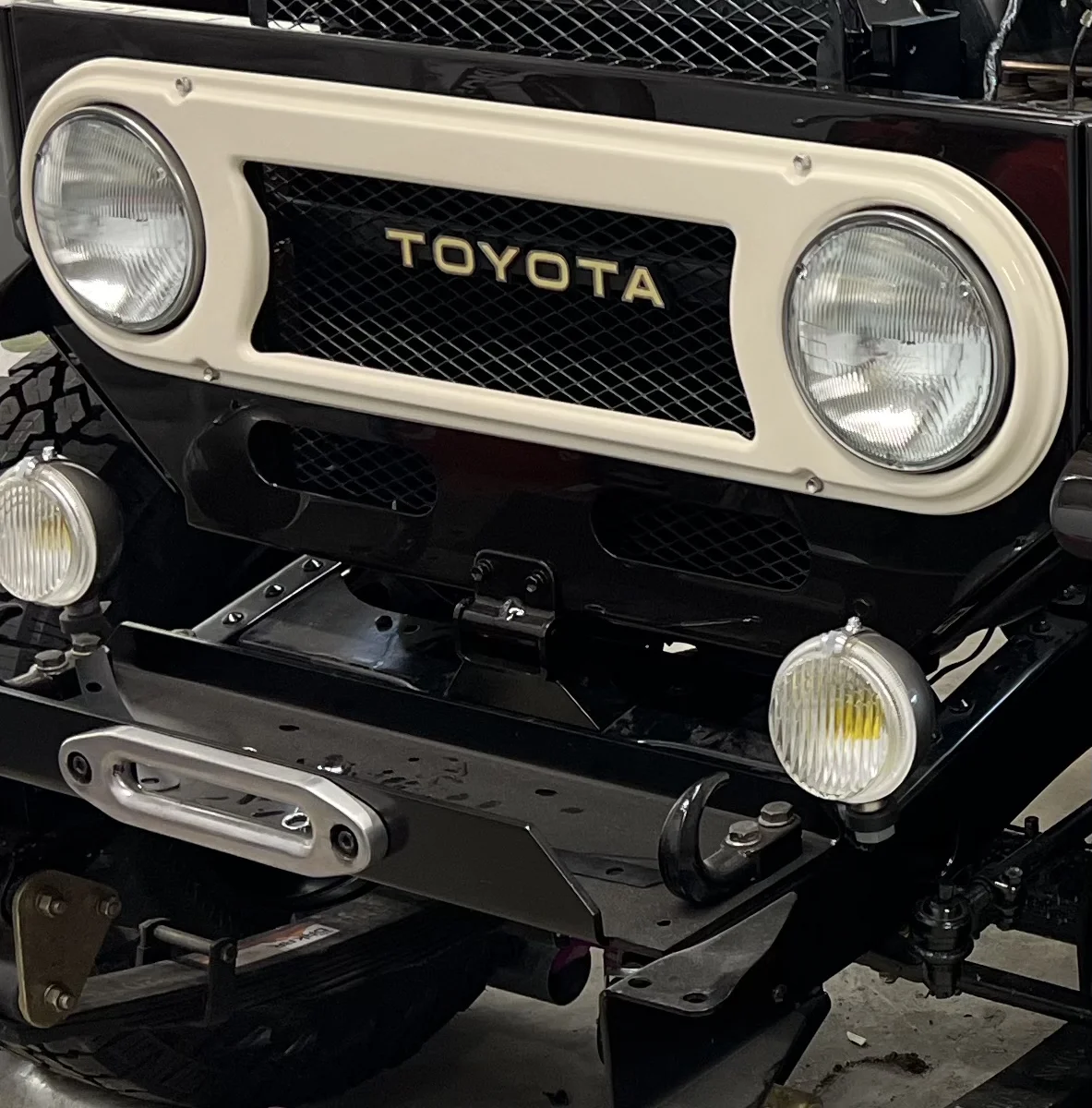

Winch plate is in place and it’s looking like a front end..I donated the “Engo” to a local homesteader for use around the farm. Looking at options in the Warn lineup. It’s a 200 meter target so I still have some time.

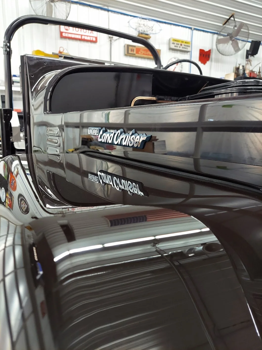

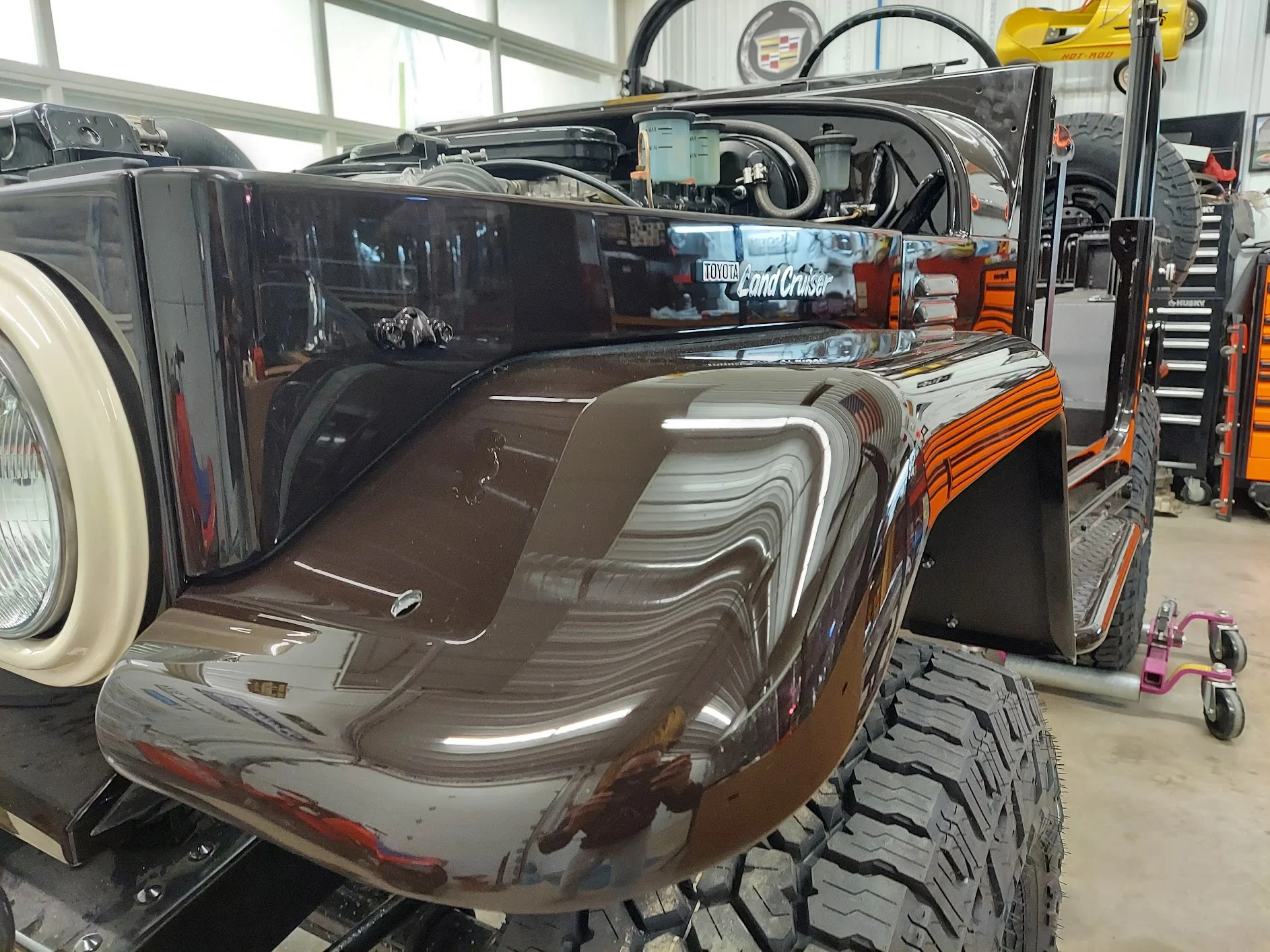

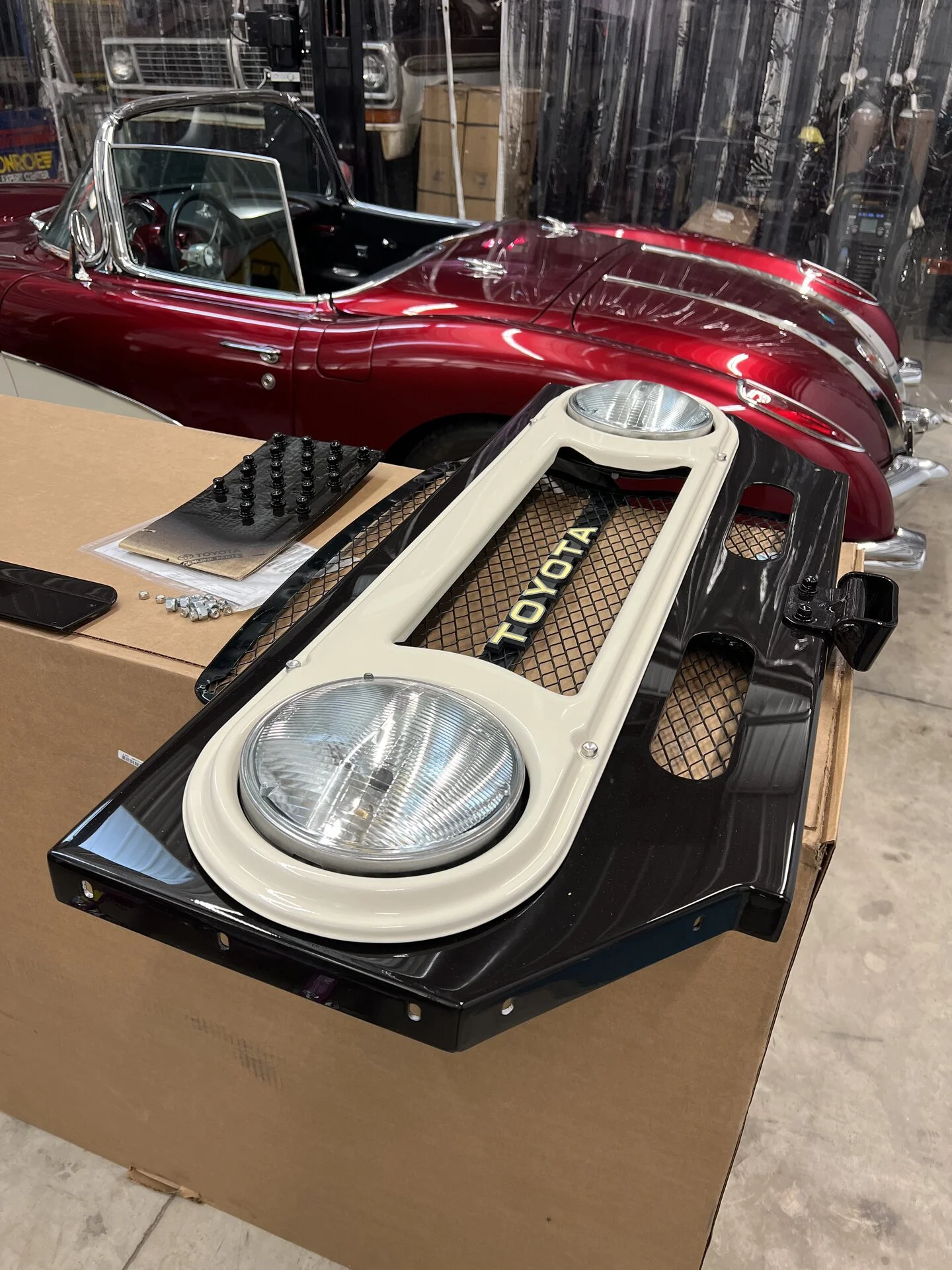

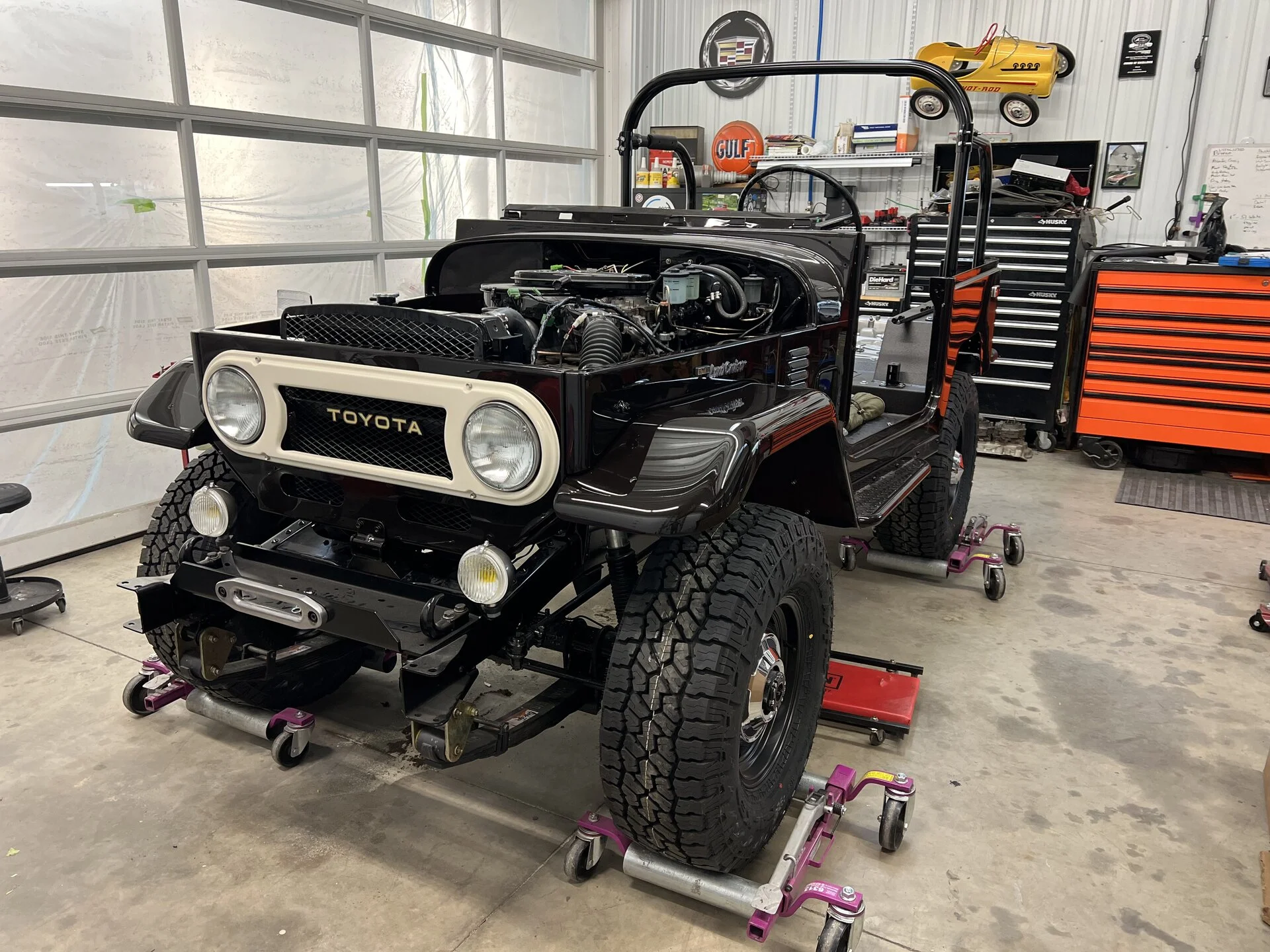

Now it’s getting real…🍻 Fenders /Aprons mounted. The new lines look very nice. Some subtle differences in the Aq vice OE fit.

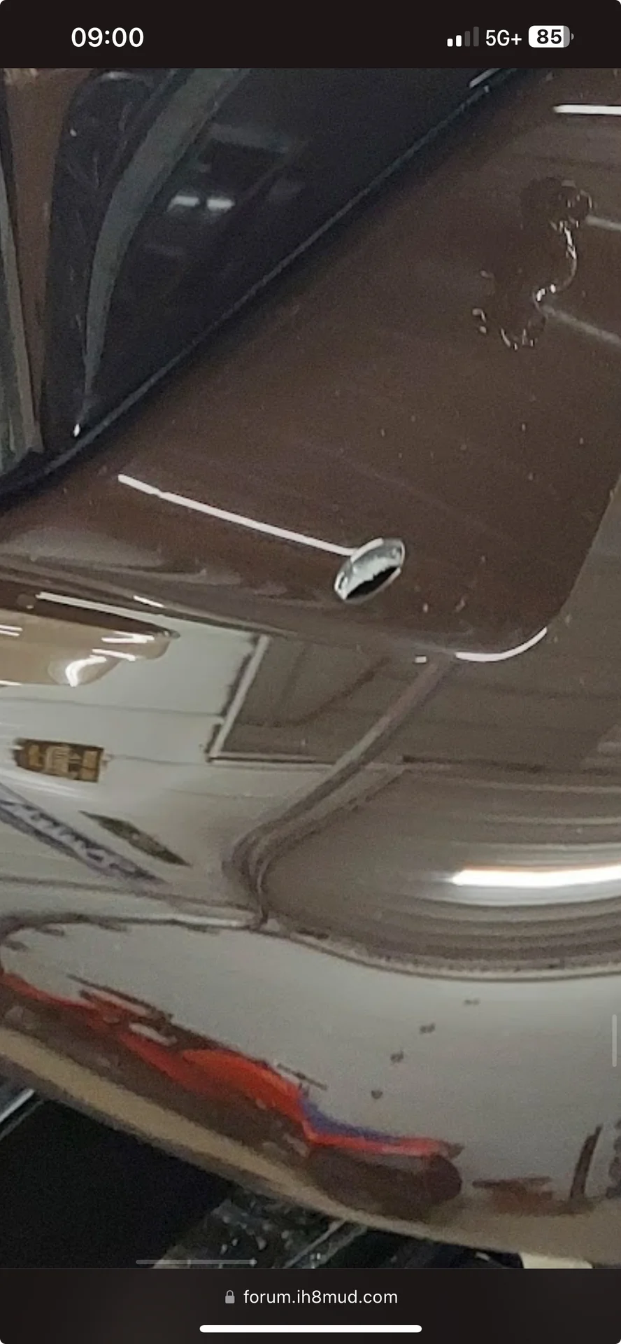

Good lord I thought this was a scratch!
also, I love checking out the shop in the reflections.
I was going to do a write up of all the human reflections I’ve spotted. A “ghost in the machine” kinda thing..

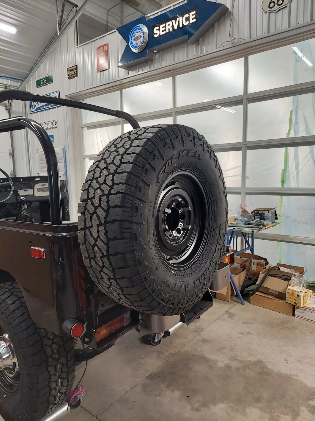

I see that spare tire, if needed, is a 2-man job. Got some weight to it…any flex somewhere?
Should be good to go. I hung a 265-75R/17 on homemade extensions for 10yrs or so.

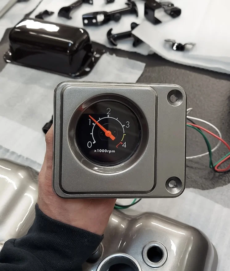

Out of curiosity only…. What made you decide to place the screws on the right side. Tach looks great regardless. Are you mounting it where the headlamp switch would have been?

When I switched 1.0 to 17” FJC steelies and the 265 Coopers I had to mod the sheet metal carrier to accept the new setup.
You can see the spacers I made to handle the larger spare tire. Used grade 8 bolts, 3/8” tubing and dual large washers to handle the additional stress. You can just make it out in the sea of black DP.
The big ol honker is really a much cleaner/easier/less intrusive way to modify the stock carrier.
