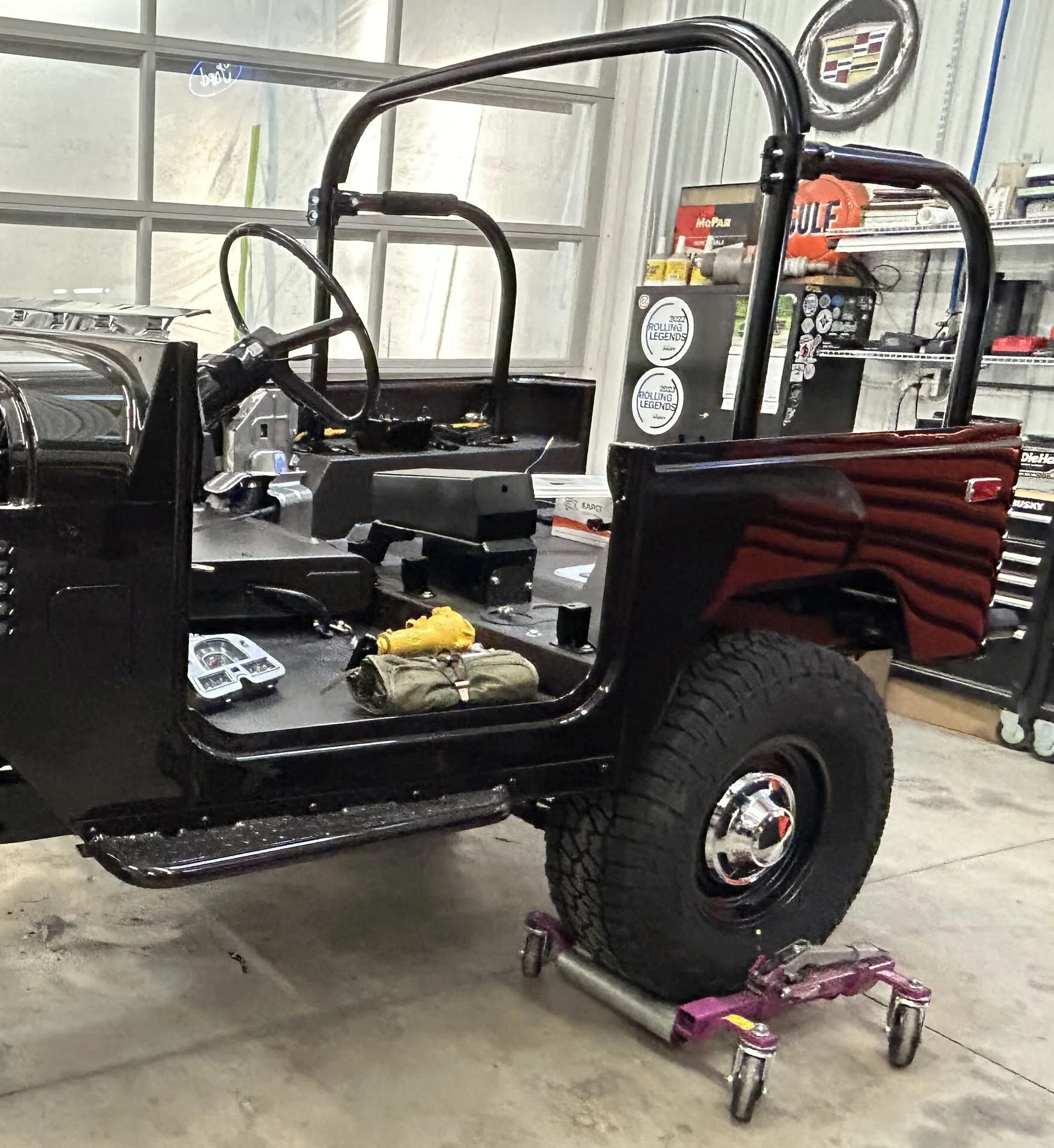

With the discussion on the wheels and tires, I had to go back and really look….those sidewalls are huge. Do you have any side profile views of the truck with these tires and wheels? Really sweet looking
Edited: it’s amazing the junk auto-correct will insert

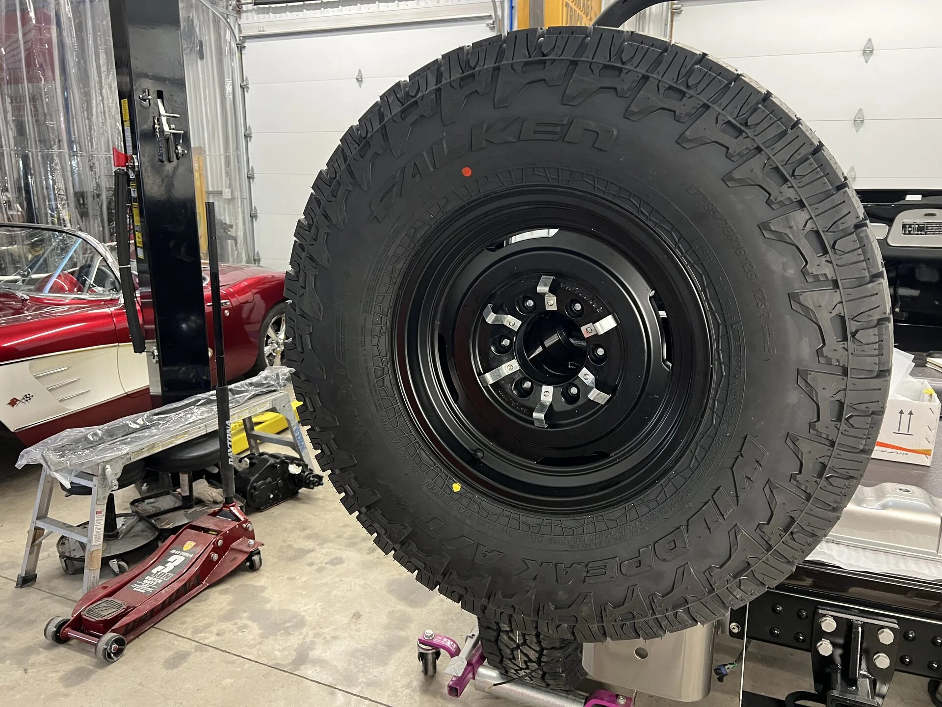

I don’t have any Full Monty shots of the tires. Stayed tuned for later in the week. 1.0 had 17” FJC rims and 265’s. I really liked the ride height and profile that setup gave the mule. The new combo maintains the ride height and adds just a smidge more width. Not a tall skinny or a short fatty, they’re somewhere in between.

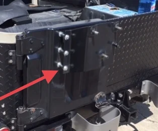

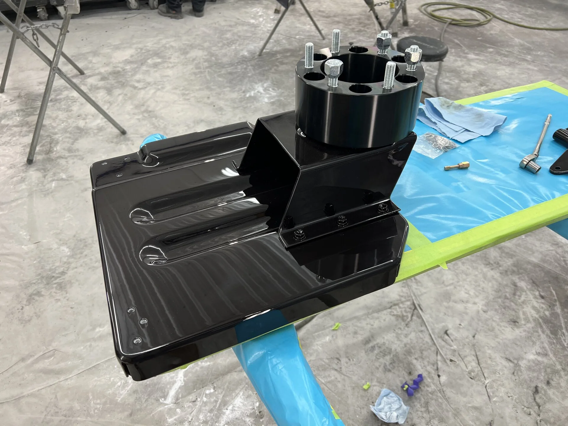

Ridden’ ole school. Spare tire carrier with spacer.
That is a big ol honker of a spacer!
Does it need that much space?
Short story is yes- most just use a section of tube, this is quicker and cleaner without building a custom spare mount(1972 build). Needs the space to open to 90* as well.
Short story is yes- most just use a section of tube, this is quicker and cleaner without rebuilding the entire spare mount(1972 build). Needs the space to open to 90* as well.
Ah, I get it.
He’ll also have spare bazooka parts should the need arise. 👍🏽
Quantum Redneckery-
1st rule of Quantum Redneckery is “For every idea extrapolated from the mini fridge, there’s probably a better way to do it, but you go with it cause your on a roll”.
When I switched 1.0 to 17” FJC steelies and the 265 Coopers I had to mod the sheet metal carrier to accept the new setup.
You can see the spacers I made to handle the larger spare tire. Used grade 8 bolts, 3/8” tubing and dual large washers to handle the additional stress. You can just make it out in the sea of black DP.
The big ol honker is really a much cleaner/easier/less intrusive way to modify the stock carrier.
