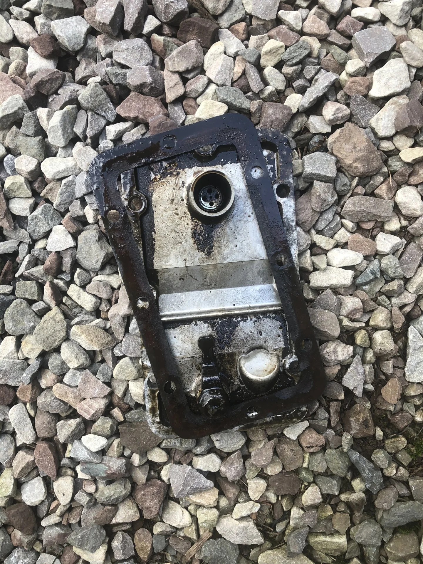

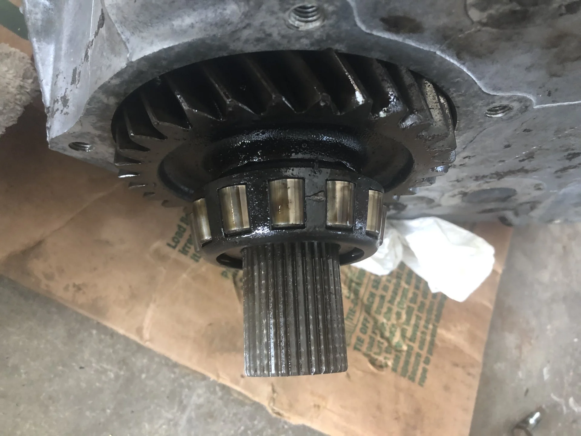

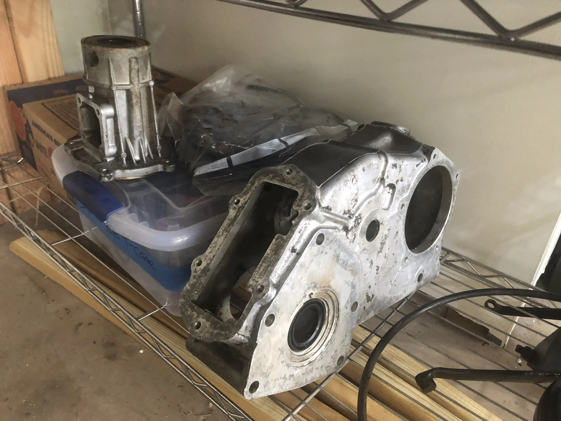

Started tearing down the spare/lab/practice T-case..
More of the days effort. Difficulty in the one man show is “grunt force vice camera man”.
What started as a genuine effort to document quickly turned into a last chance effort into what the hells the use.
Soo, l‘ll skip forward to post slippery hands, scratching of the head and checking my saved threads on Mud.
Pics are for those that are visually entertained.
Results (later) will be posted…😎
I just didn’t have enough hands to capture the destruction. I did learn that the 12mm ratchet, Pb, Kroil, and a Neanderthal mind set will take you places…
So, fast forward to mission complete. Everything is disassembled, coated with a lube, tucked away and ready for a sophomoric reassembly. This was a practice/learning/pray for success piece of Toyota legacy.
Learned a great deal from this. IE, don’t let the Mini-Fridge stand in you way of success.
Sooo, lessons from the YOTA-Verse. Go big, go heavey and go often.

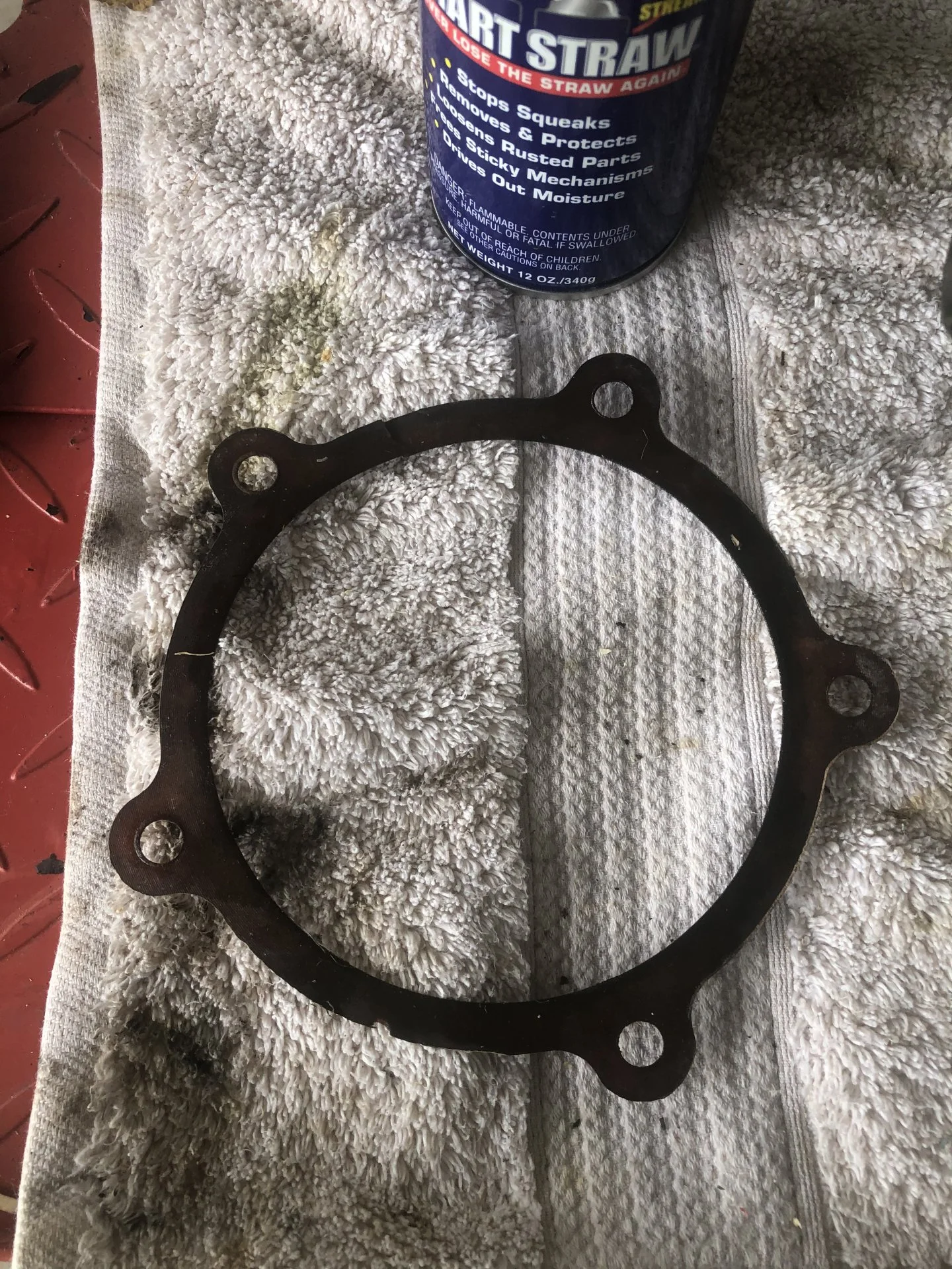

What I noticed was on this “spare”, was a wee bit unexpected.
IE. None of the gasket surfaces had any FIPG. Interesting..🤔 Heres a gasket that I removed to illustrate my observation(s). Not sure what I expected but, I thought there would be a trace of the “orange”…
In any event, it was a good hands on lesson without sacrificing time/$$$/effort…

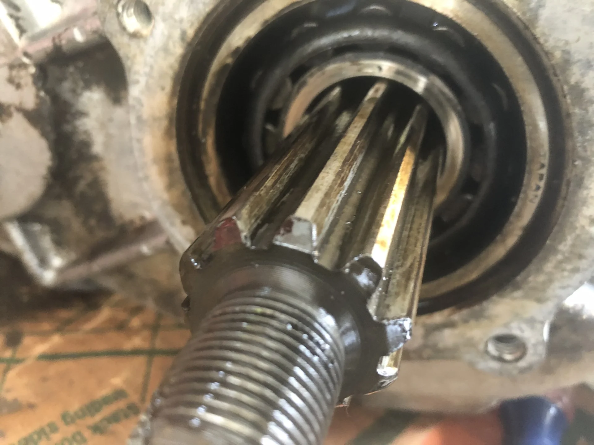

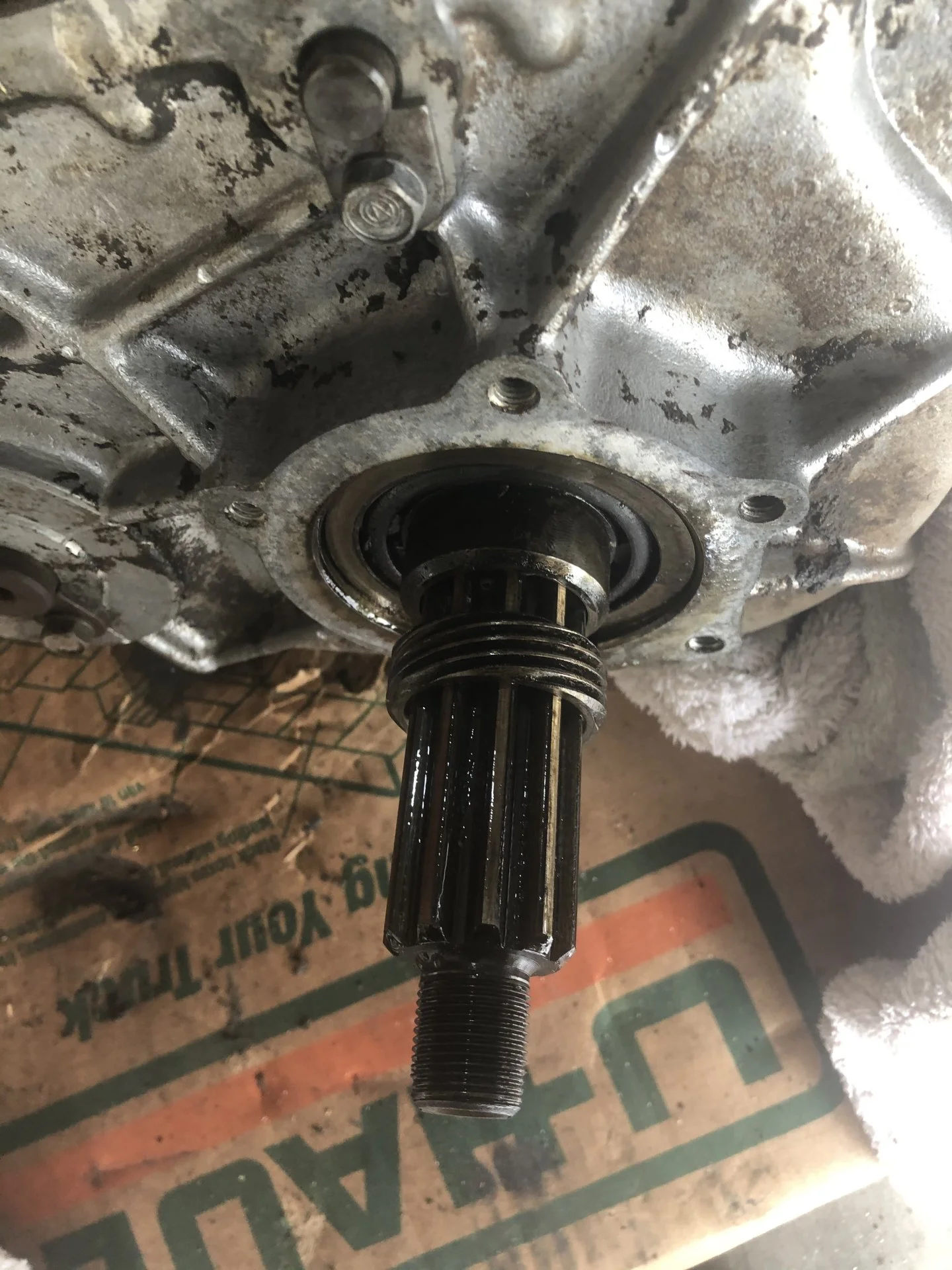

If the output shaft separated from the rear output bearing without the use of a puller or a press, that is not a good sign.
Mr Mark, I’ve been away from the enchanted kingdom and will return next week. If memory serves me right, and it often doesn’t, I was able to remove the low speed output gear then remove the output shaft as an assembly without separating the rear out put bearing. Does that sound right? I may not be describing this correctly so I’ll shoot a few pics of what I have (or didn’t do) when I get back. Thanks for the “Eye in the Sky”..🙂
