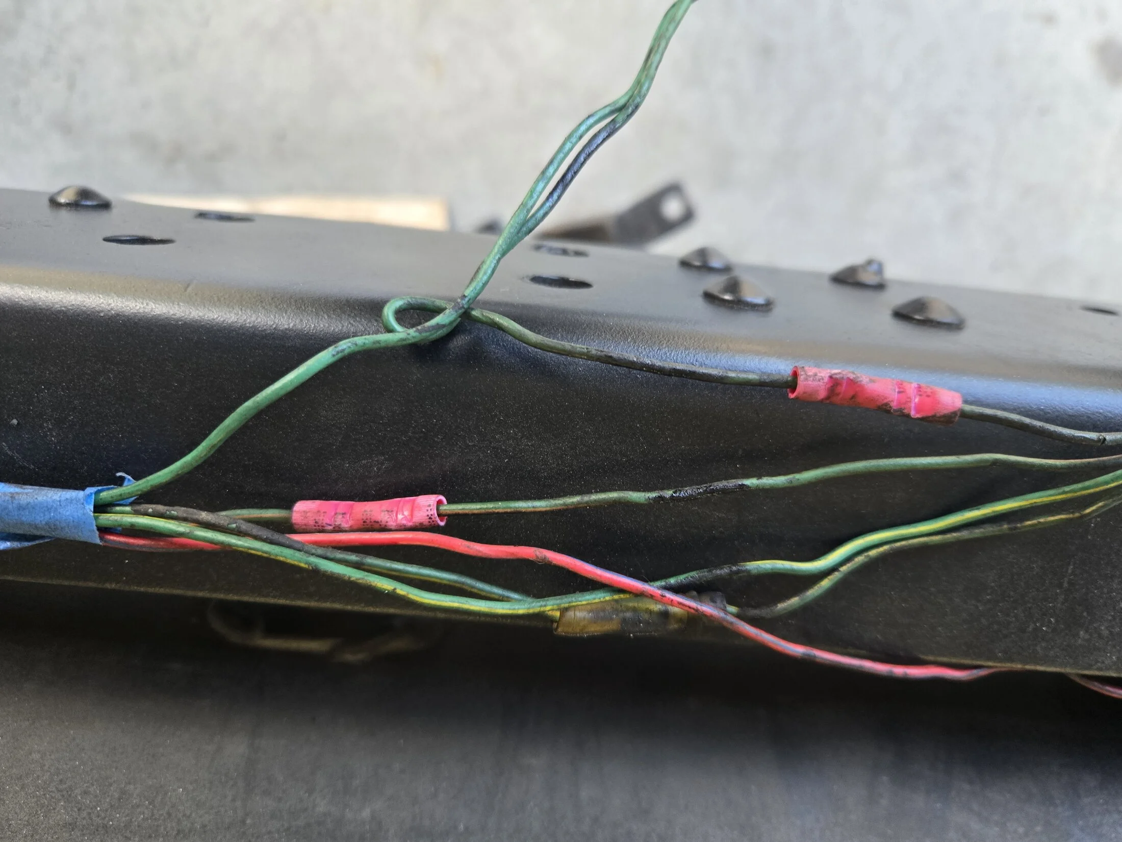

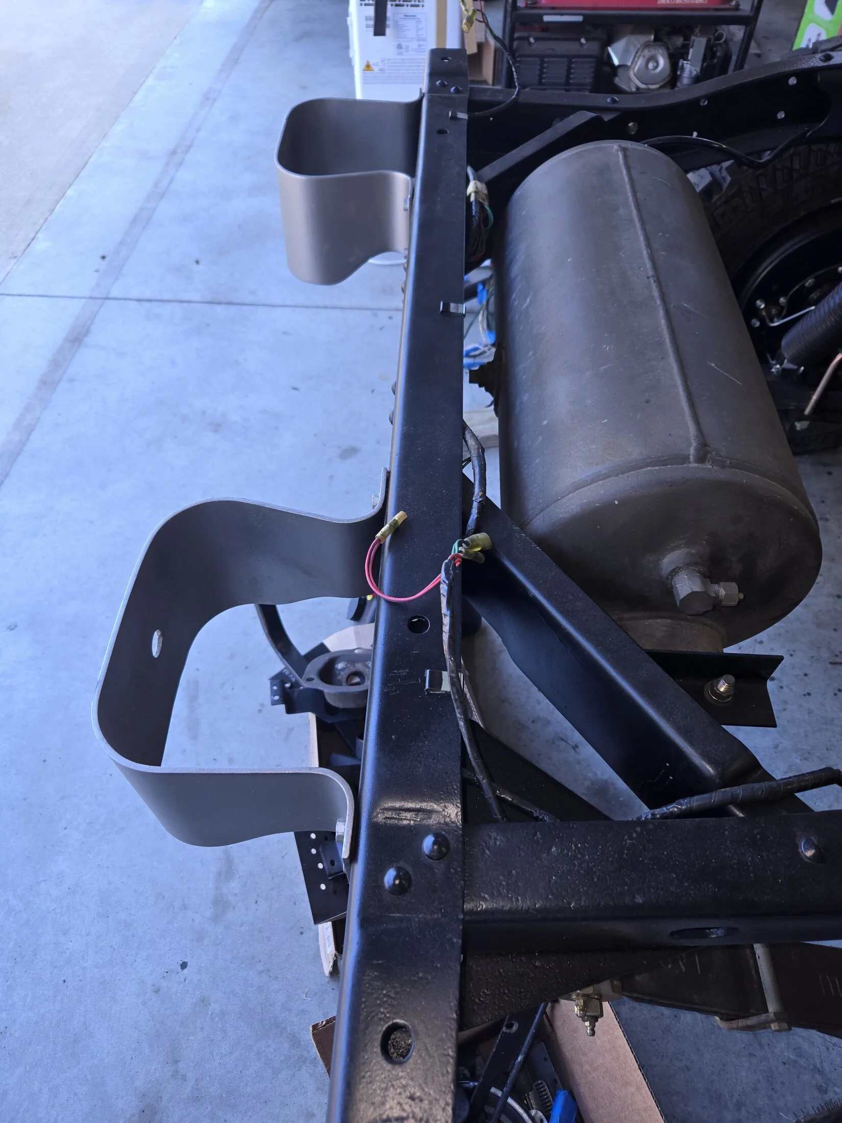

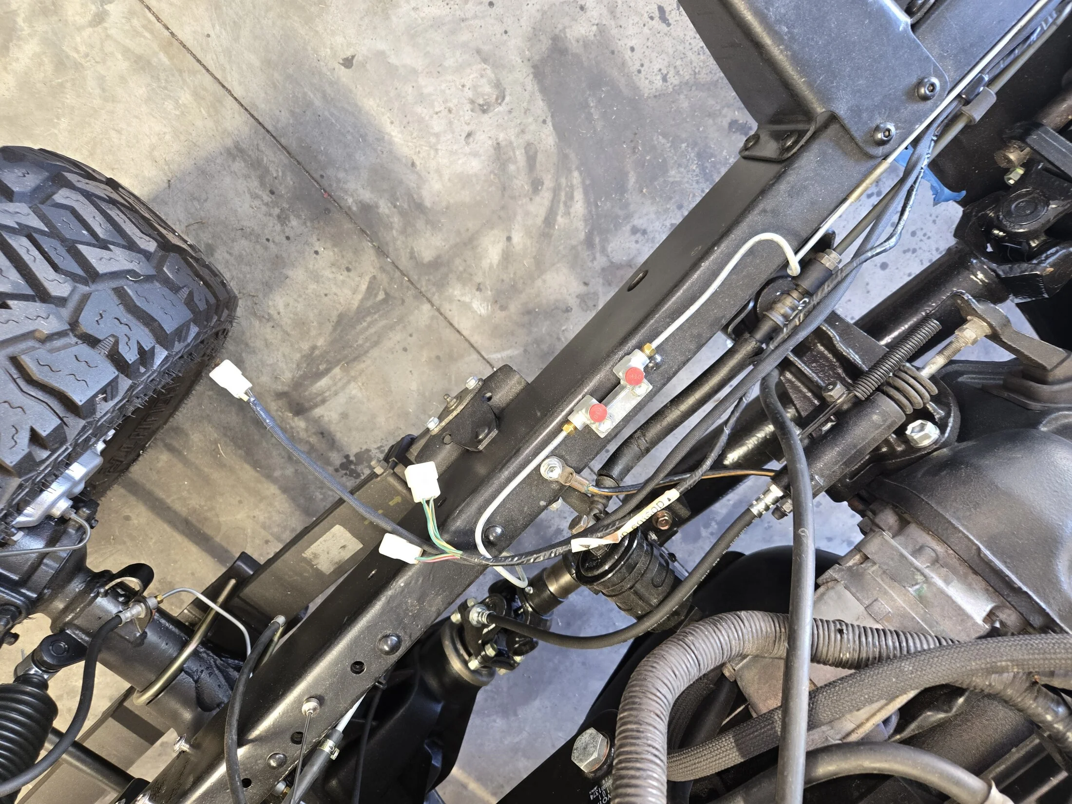

Spent some time unwrapping and documenting my rear harness. Found a few sketchy splices and damaged wires. In the second picture, I have a Blue/Yellow wire with a bullet connector, then further back a red/blue wire with no connector. These were buried in the wrapped harness. They appear to take power from the backup light circuit but are not part of the backup light switch. Maybe something to do with the transfer case indicator? The 73 wiring schematic is not that great. It would be interesting to see what wires are in the two rear harness plugs for a 73, I'm just guessing. Note - I have a third 2 terminal plug in addition to the two 4 terminal connectors in the rear harness. One wire for the electric fuel pump for the fuel injection, and one heavy white wire to get Aux power to the console area.

I ended up repairing and reusing my original rear chassis harness because the NOS one was for the earlier 3 on the tree style where the reverse light switch is not on the trans. That one will be up for sale soon.
