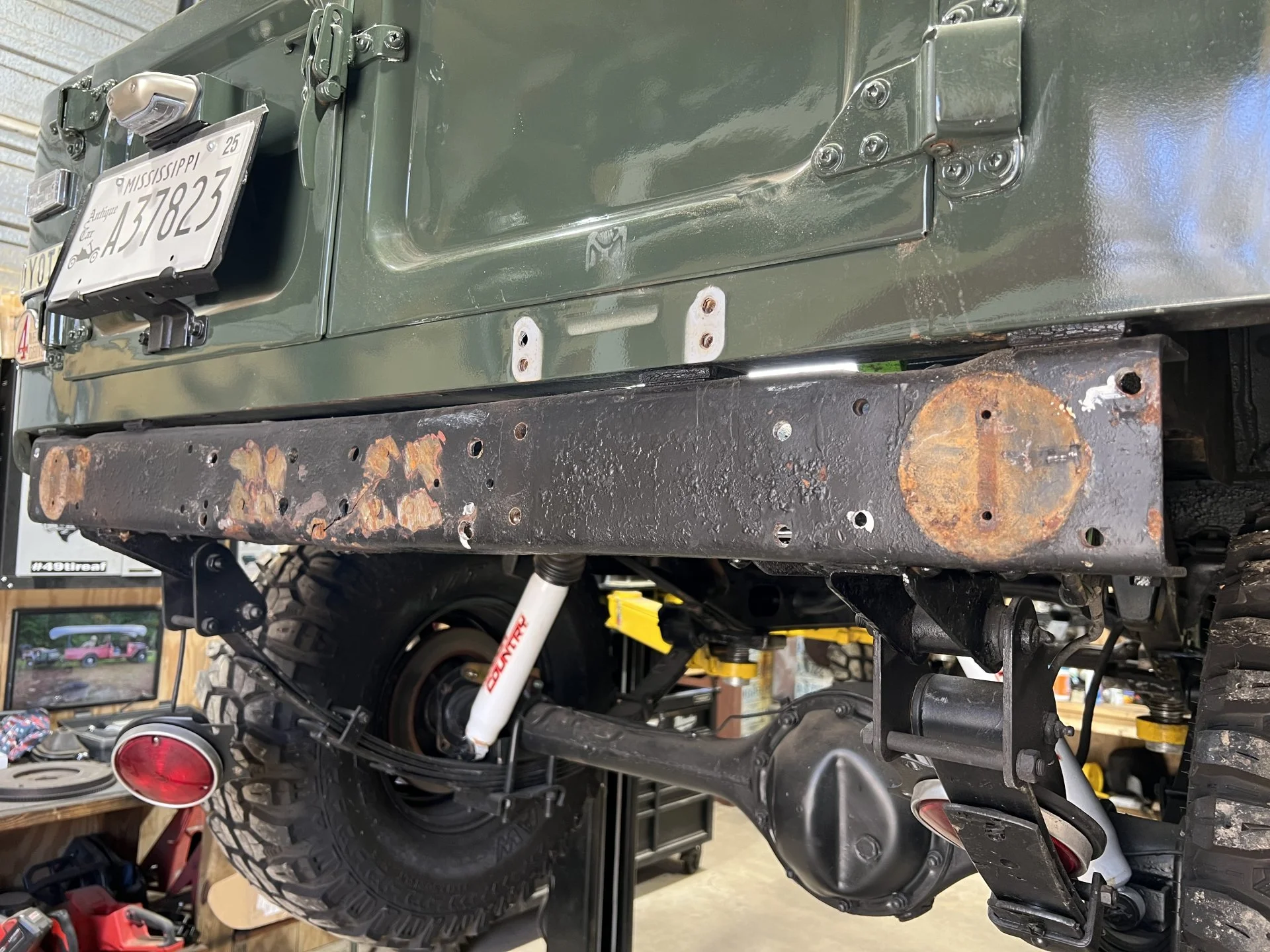

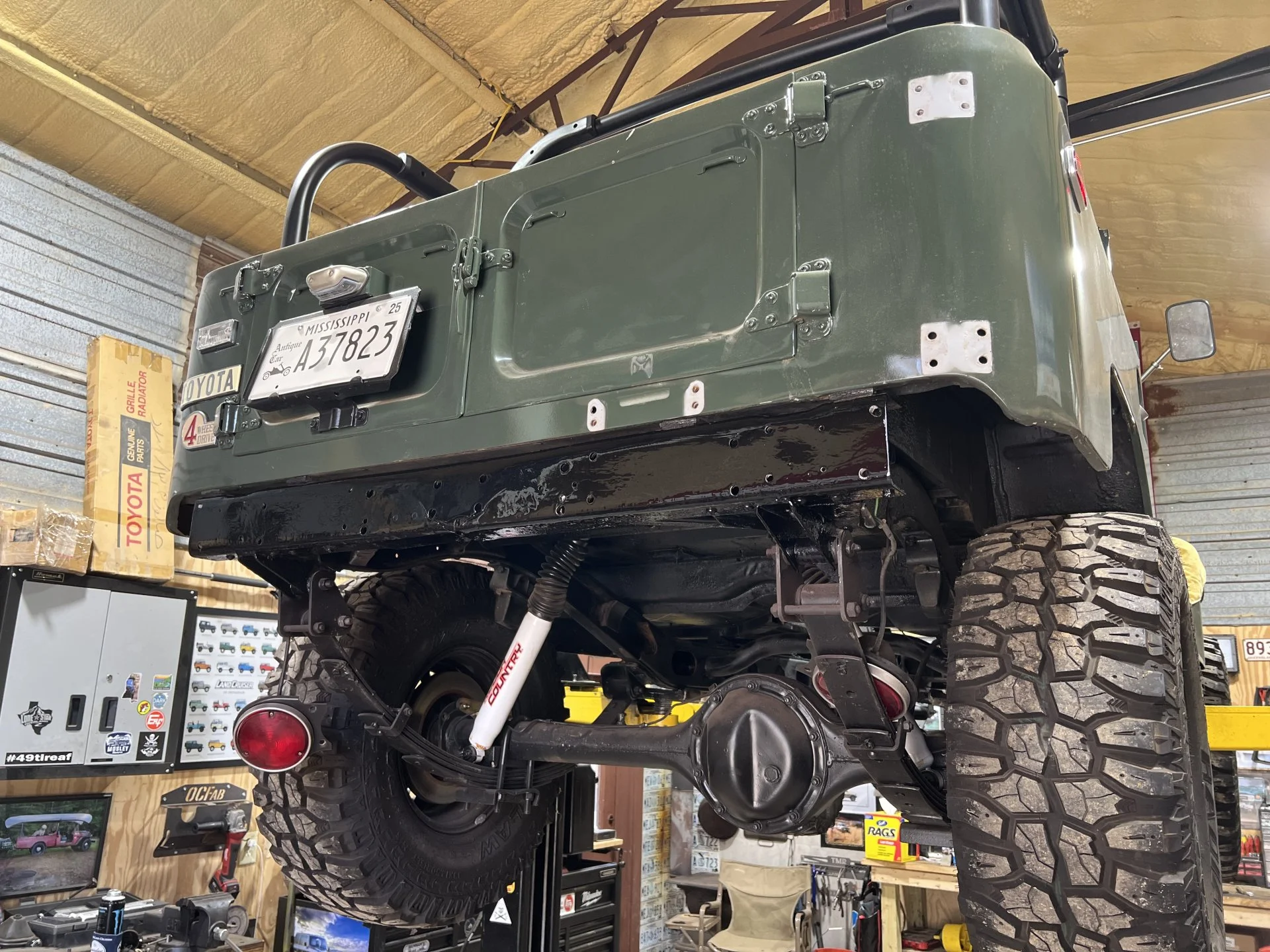

In preparation I decided to go ahead and pull the old Con Ferr bumper off.
Of course, the steel diamond plate was there for a reason.
Jesus. Who bolts a piece of steel on a non-prepped frame? What a hack.
I got the frame cleaned up and did some metal repair from the back. Luckily the 4Plus carrier is so stout. It will shore up the cracked main frame.
I broke out the POR15 for this and brushed on a heavy coat to soak in good to give me a nice base to build this back correctly.
Also working on a solution for the body where the stock carrier came off. Normally if the truck is a patina truck or correctly painted I just stick stainless bolts back in the old holes and roll on. This one will need more. Stay tuned.

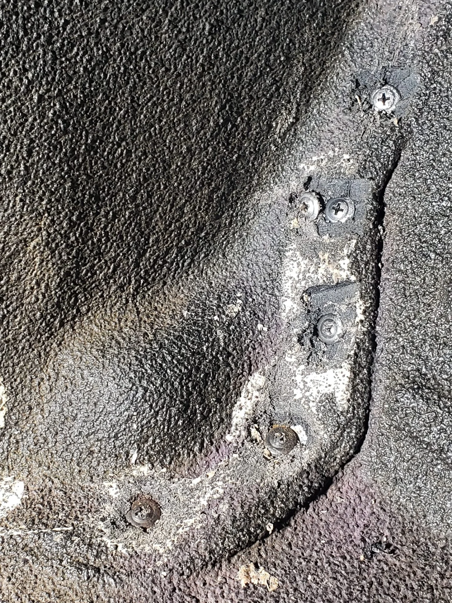

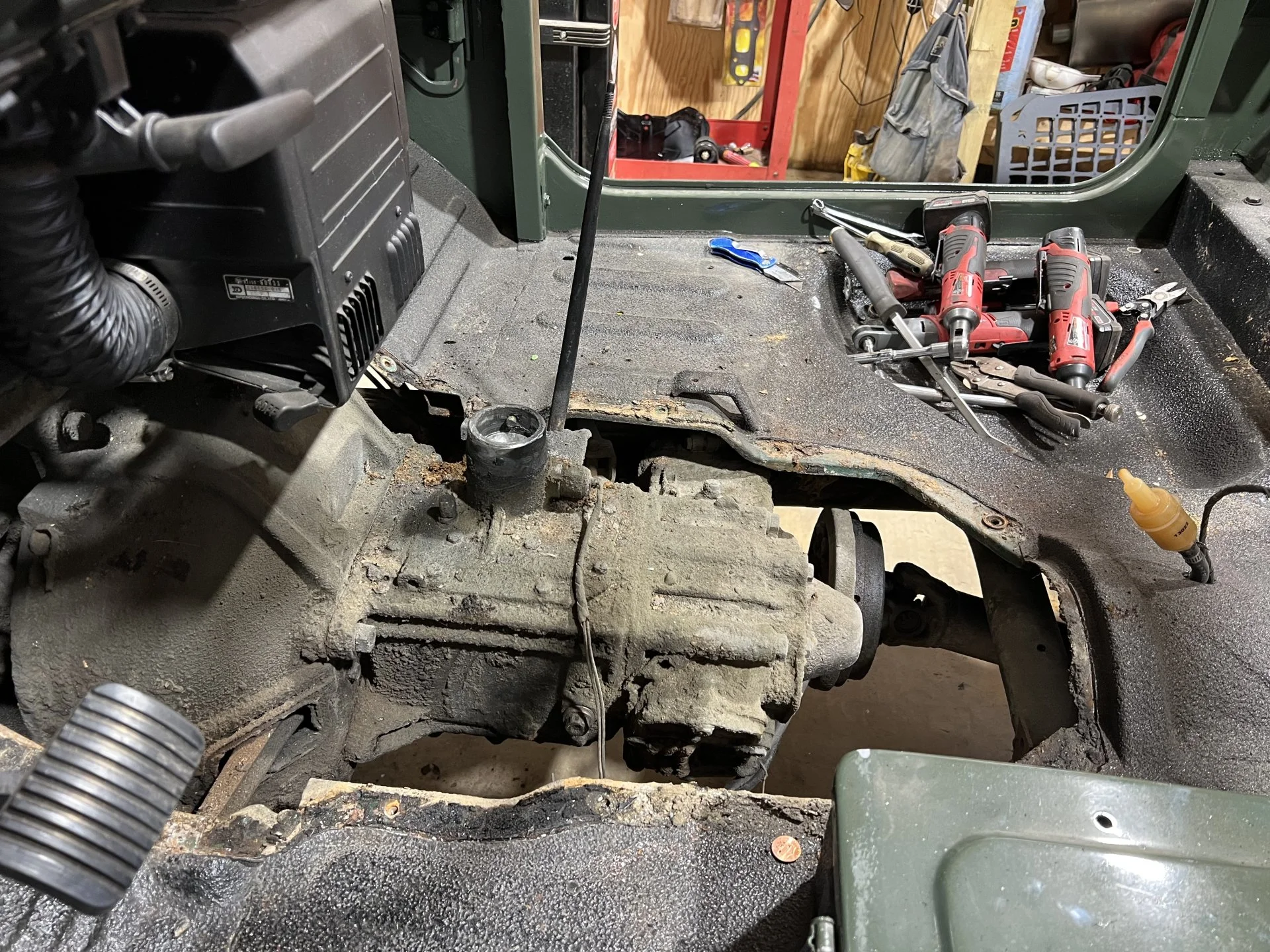

When I got home I tore out the interior to get the driveline ready to pull from the top and ran into my first problem. The painter who is a good painter obviously does not work on Land Cruisers because he covered all the tranny hump bolts with bed liner. LOTS of bedliner.
I had to use a wire wheel to grind the heads clean in order to get the 10mm on them and a razor to cut out the hump View attachment 2959131
No surprise, this is just a paint job over a dirty ass truck. I’m not sure how people do this, but they do.

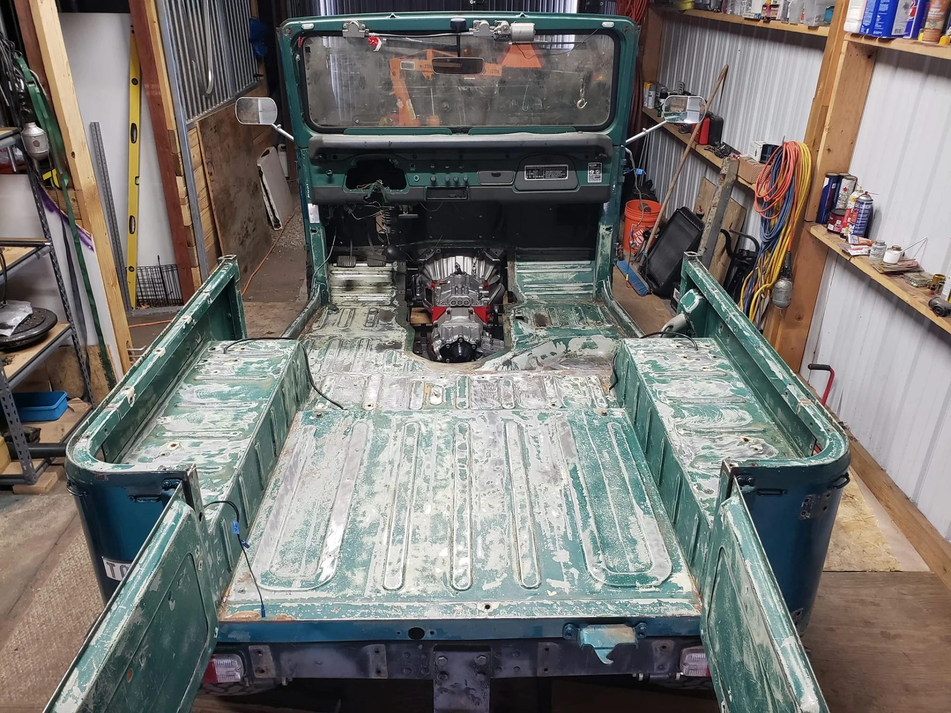

No, I am restoring, well resto-mod, a fairly rust free '74 out of Southern California. It has previous owner problems from a half-ass preservation attempt. Line-X coating over dents and holes. 1/4" thick coating in some places.

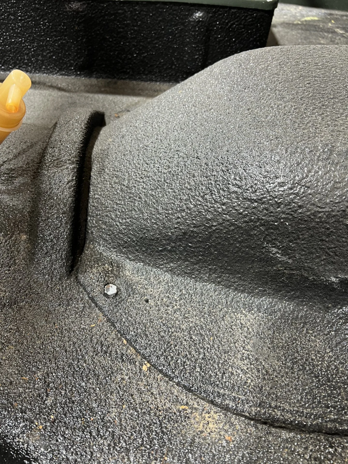

These early tanks have a sweet spot. I missed it by about 1/16th and had to run a Dremel inside the tank and clearance the vertical baffle a bit
Any tricks to finding this exact spot. Going to attempt this same thing, your photo kinda shows the spot. But missing it by 1/16th inch makes me feel like it is maybe more than just eyeballing.
You can do some measurements through the sending hole. If your tank is exactly like this you will need to cheat it to driver more than I did but there is a valley there I was trying to avoid. Go all the way to the edge and you will be fine

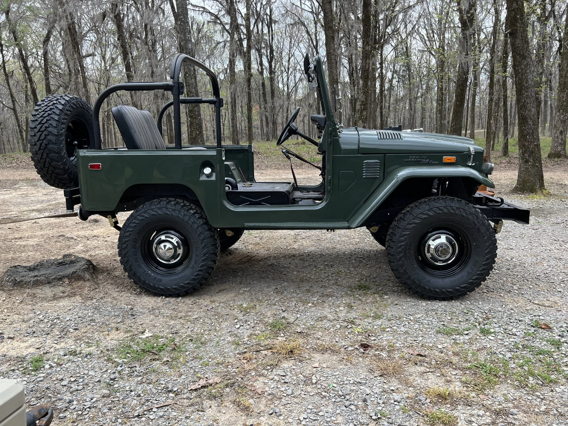

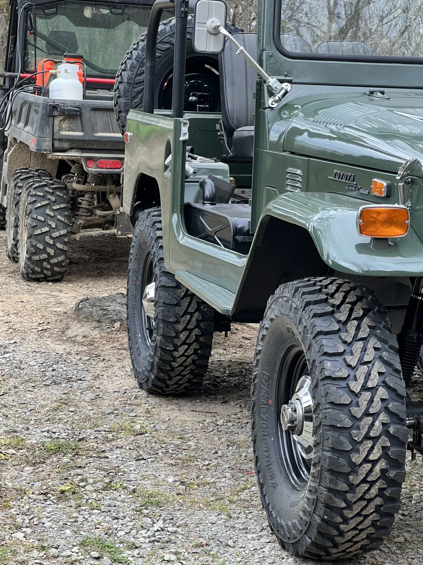

Plenty of clearance!
It will come down a bit with the drivetrain back in it. They are the same height as the 255/85s but a good 2” wider.
Nice photobomb :D

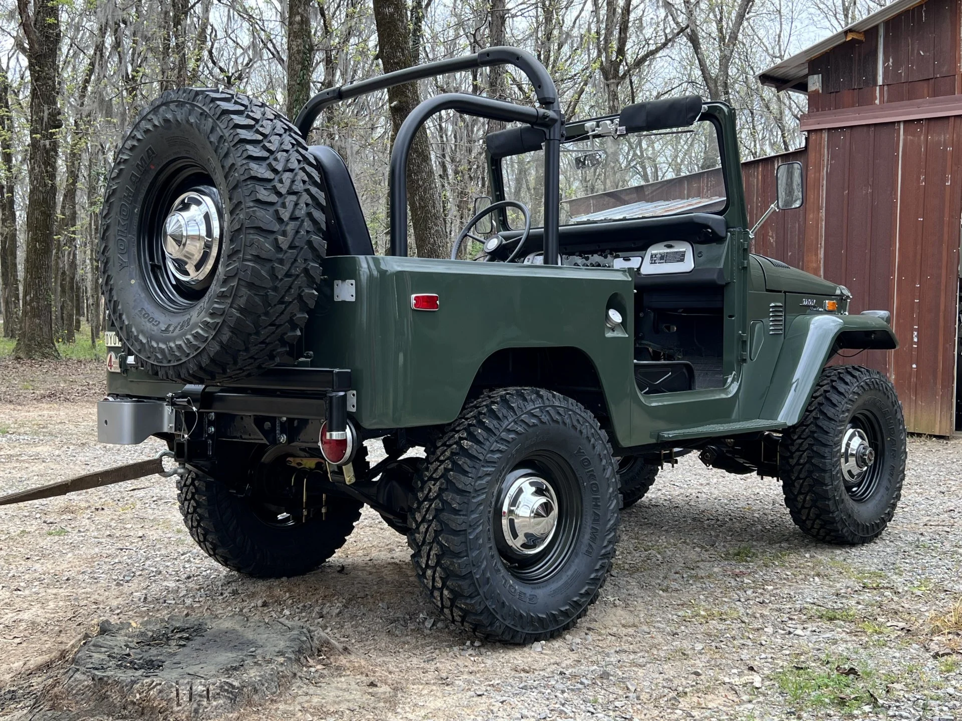

Rear shackle angle?
There is no weight in the truck. No driveline. That said, the Dobinsons springs are set up to have vertical shackles loaded. That was my first question with the first one I installed.
Surprisingly these suspensions ride amazing like that.
