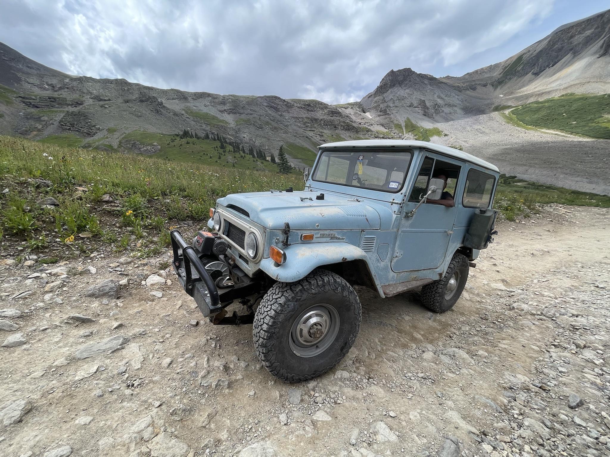

70 series rear axle works in rear of Fj40. Need to move perches a smidge on both sides. @SipLife maybe able to weigh in. Here is a side profile with stock 40 rims and 10.5” wide tires.
