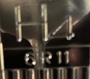

Thank you. Do those 81110-60P70 housings say 6R11 on the face? If so, it seems like those are made for RHD same as the others? Now I'm super confused.
The ones in 81110-60P70 say “6R11” indeed.
The originals off my HZJ77 say “6L13”.
The new Koitos from Japan that I removed the 24v bulbs from say “6L15”.
I don’t know how to decipher those codes. Anyone?
The E6 euro marking appears to point towards Belgium which is a LHD country. That jeep website is confusing and seems to be marking them up high for sale too.

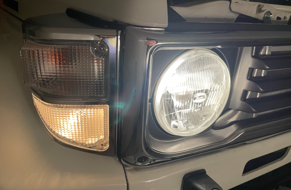

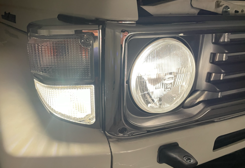

Swapped out the 12V bulbs with some 24V Hella P43T heavy duty bulbs. Color temperature is warm white 3200k, which is close to stock color. For comparison sake, white LED's are typically 6000k.
The 3200k headlight color did not match with the 1800k incandescent side markers, so I swapped the 24V 194 side marker bulbs over to LED. 3000k temperature (from Super Bright LED's part number 194-WWHP5). That got them matching nicely.

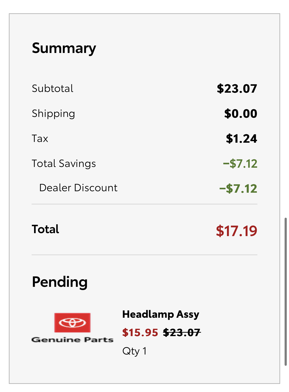

This week I bought and installed Hella 7” headlights along with some led bulbs. I wasn’t too happy with the outcome so I ordered headlights from my dealers website. I didn’t realize how cheap the Koito’s were.
