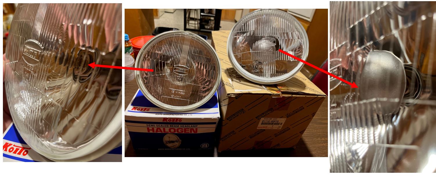

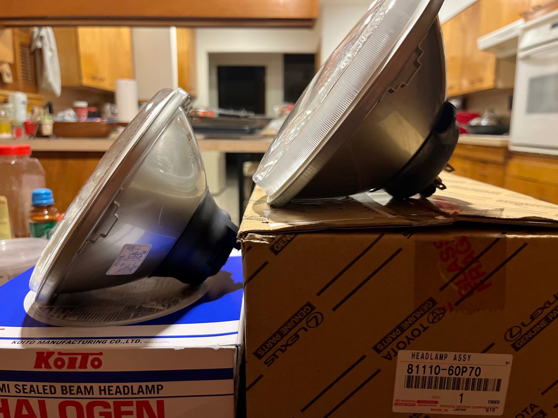

I got the Japanese market Koito 24V lights in the mail today. The pattern on the glass dome matches the pattern on the original (SB) sealed beam units on my HZJ77 which I assume is for RHD countries. Plus they are different than the 12V Koito lights that come under Toyota p/n 81110-60P70 with the relay harness and all. The glass on the Toyota supplied 12V ones sticks out a little bit more also. Lastly, the Toyota supplied 12V ones have a different pattern on the glass (assuming for LHD countries) and some kind of shield inside the unit.

Couldn't you just put a 24V H4 lamp in the 12V housings? It's the lamp that is voltage specific, not the housing itself. Then you'd have the correct LHD light pattern for driving here in the States.
yeah I could have….. :bang:
i'll have to look at the fluting on mine tommorrow and compare it with your pic, since the pattern and cutoff is perfect we'll see which way the flutes go.
dont beat your head on the wall just yet, differences in the housings and sheild between 12v and 24v could be for a reason, and dropping 24v bulbs in 12v housings may not reach full potential.

I would be interested in seeing the fluting on yours.

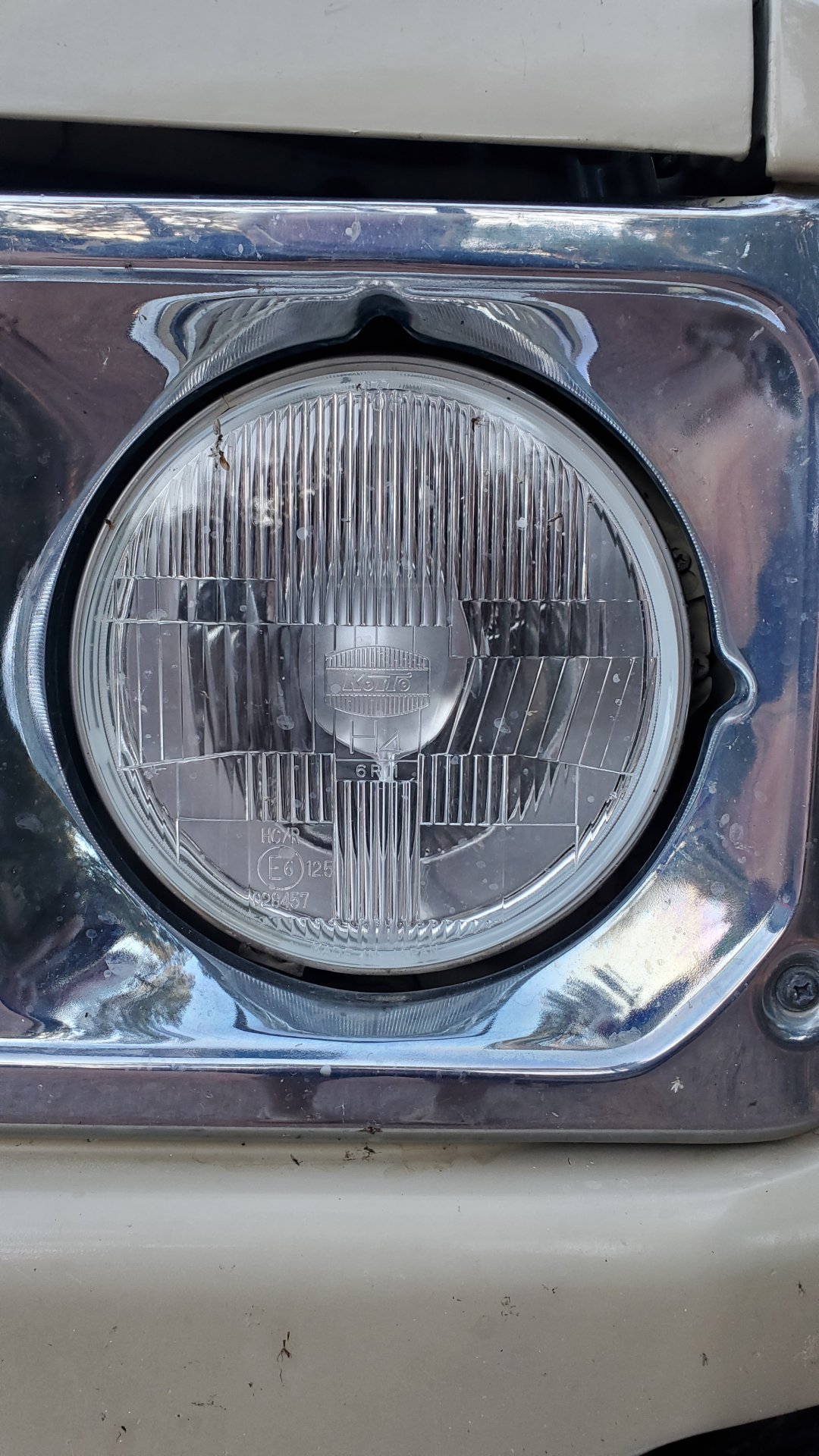

It really is hard to argue with these. It's what I currently have and the beam is perfect...
@RHINO got me sold on those. I just swapped the 24V bulbs from the other Koito set into them is all.. Still waiting on the new hardware then I will put it all in.

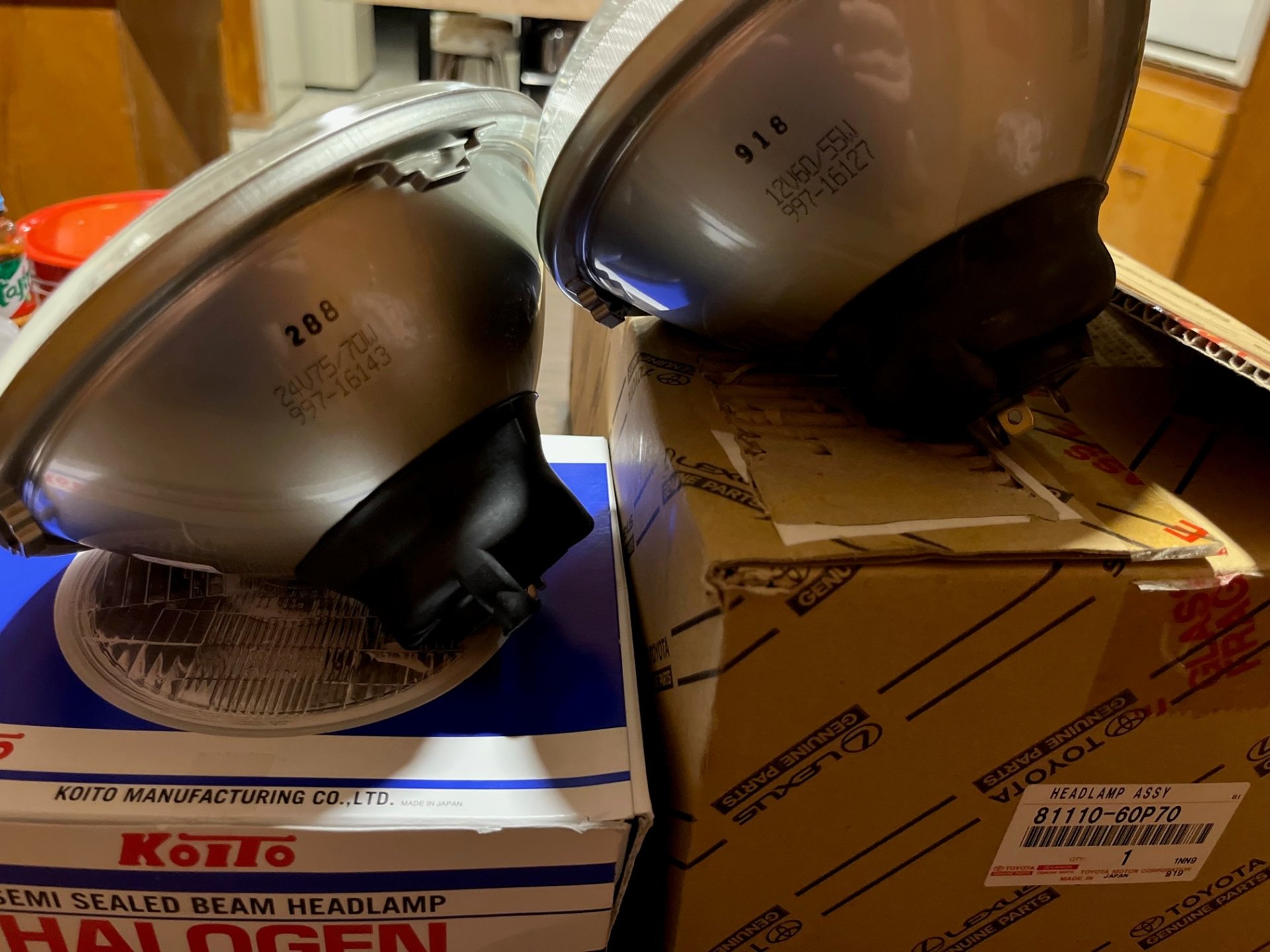

I finally installed the headlights today from set p/n 81110-60P70 but swapped out the 12V bulbs with the 24V bulbs from Koito. All went well and looks great. High beam indicator shows on the dash.
I didn’t have to use any of that extra wiring that is provided with the 81110-60P70 kit.
So to confirm - the 24V Koito housings. Those are for RHD countries and project differently that the Toyota housings made for LHD countries?
Sorry, I'm confused.
Which housings should I buy to drive my truck here in the States?
I probably did a poor job explaining what I did in this thread. Sorry.
You should buy 81110-60P70 if you want proper LHD projection but they come with 12V bulbs. In my case, I just swapped them out.
I didn’t have to use the supplied wiring, zip ties that came with it.
Thank you. Do those 81110-60P70 housings say 6R11 on the face? If so, it seems like those are made for RHD same as the others? Now I'm super confused.
