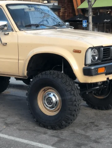

All of the older steel Toyota wheels I'm finding are 6" wide. Well, the ones I want are 6" wide. But to run 33/10.50/15 BFG KO2s I'm thinking 7" or 8" wide would be ideal.
Anyone know a source for 7" or 8" wheels - that will work with the old hub caps? This the look I'm trying to replicate:

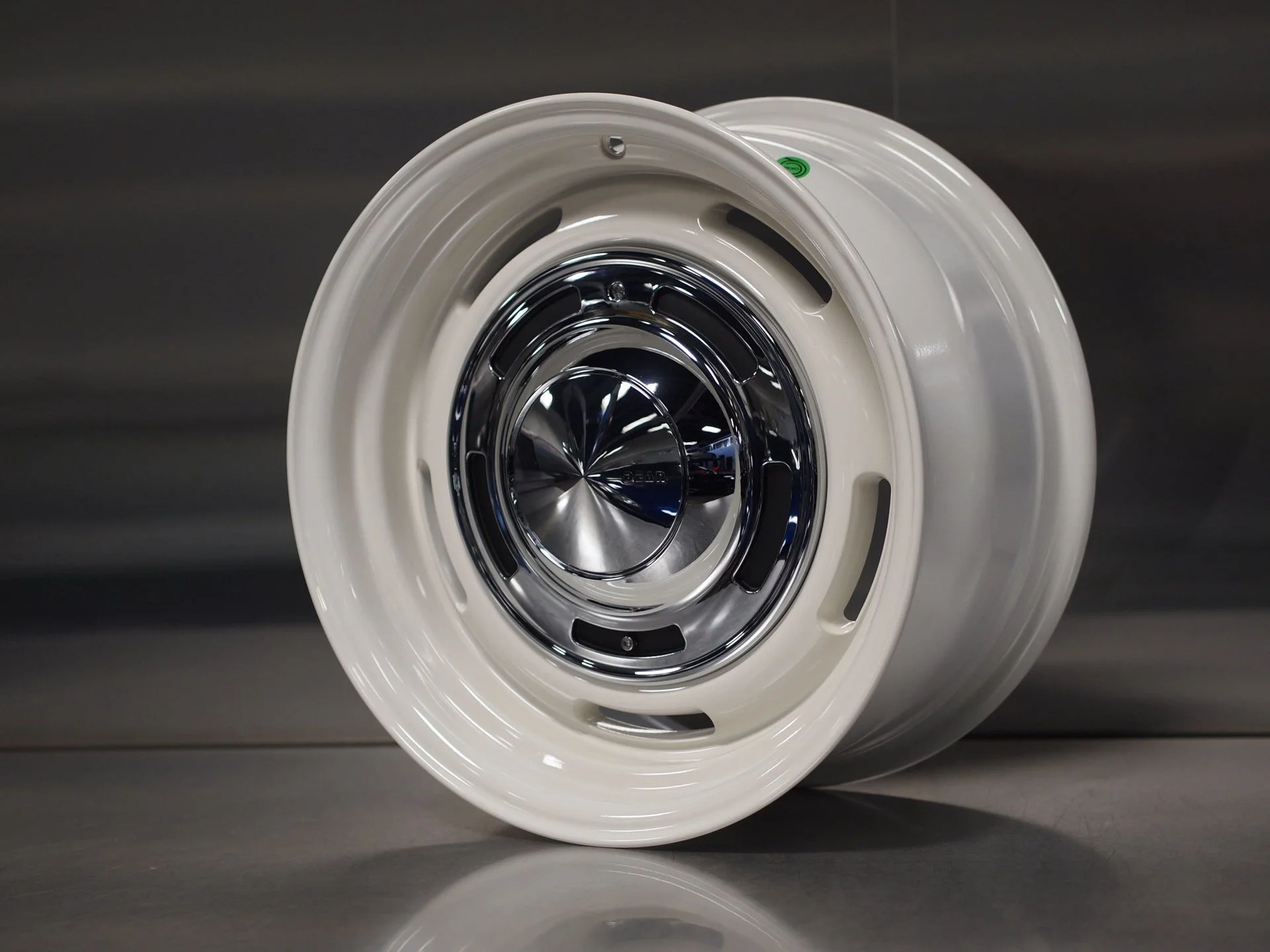

These are cool but they're 16s....https://www.cityracerllc.com/products/16-wheel-for-toyota-land-cruiser-fj40-fj45-fj60-70-series
Or for even bigger money, I can sell you these :)
16x7 and 16x8 aluminum wheels. Hubcaps included!
Damn. Those are badass. LOVE the white with the caps. But, I’m guessing they’re more than the Toyota steelies... at $95 ;)
Slightly. Shipping from Japan is probably $95 each. They are huge $ but they are so cool. The quality is incredible. I liked them so much I kept the cream colored ones for me :cool: I knew I shouldn't have ever test fitted them. Ha. They'd look really cool on an early pickup.....uh-oh...see how it starts? Need to immediately NOT think about this....:D

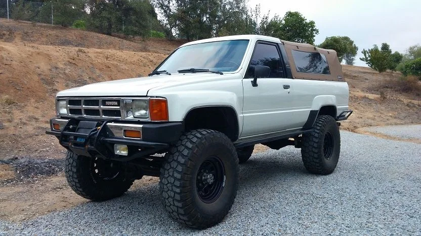

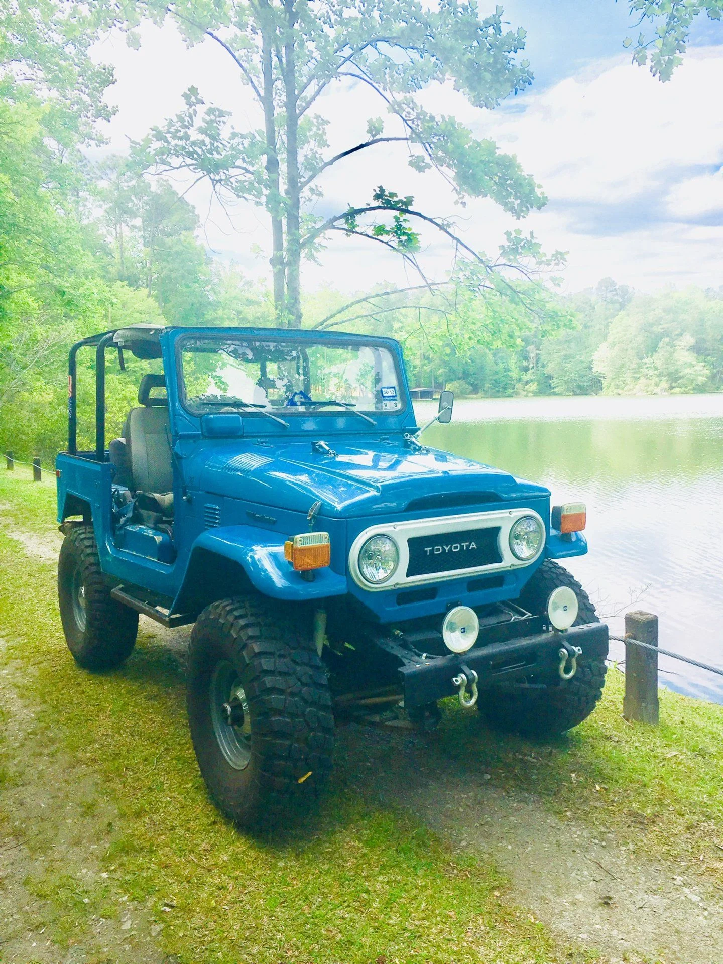

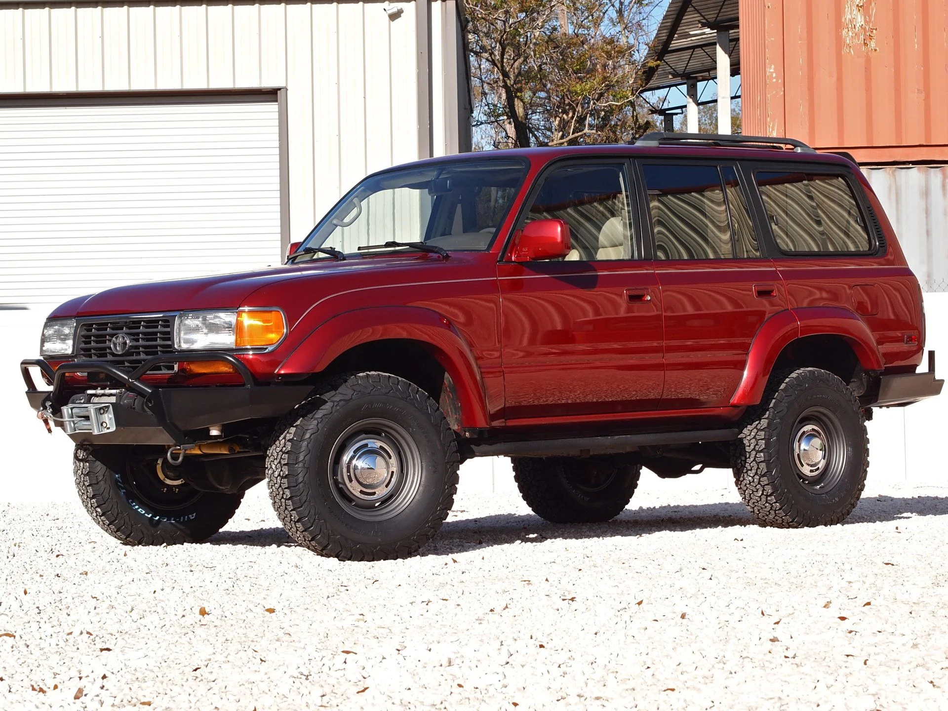

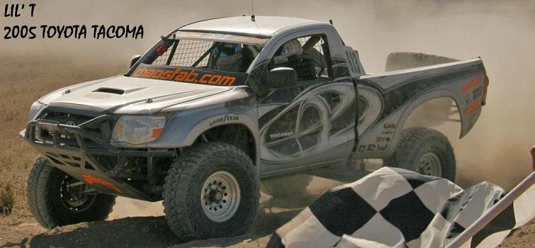

FWIW I ran 33x10.5x15 for years on 7 inch rims and thought they were perfect. I now run 35x12.5x15 also on 7 inch rims and I really like how the rims pull in the wide tires as I don't care for the "balloon" look. It rides great. It also serves a secondary function as a poor mans beadlock. It was common in desert racing to mount 12.5 wide tires on 7" rims to keep the rim out of harms way and to hold the tire on the rim more securely. I don't think you'll have any issues running 33x10.5s on 5.5 or 6 inch rims.
This Total Chaos race truck runs 35x12.5x15 on 7 inch rims
My 4runner with 33x10.5x15 on 7 inch rim
My 4runner with 35x12.5x15 on 7 inch rims
What @yotadude520 said - that's a beautiful 40. The 35s on the widened OE wheels looks killer!
@liveoak the 4Runner looks badass with the canvas cover. Diggin' the 35s on the narrow wheels. That just feels like the right look for these old trucks - pulling the sidewalls in.

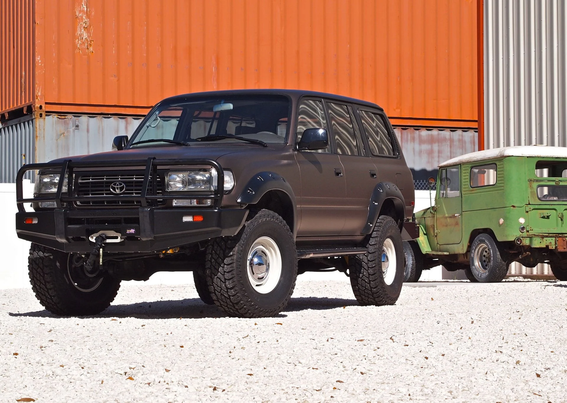

@c2dfj45 is that you're 80?! Dude... LOVE the creme wheels and caps! For a second (okay, several seconds) I got my hopes up - "$95 from Japan..." WHAT?! only $500 for a set of 5... oh... wait... that's to ship the $1,300 wheels. Whoops ;-)
