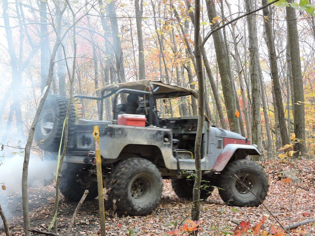

She smokes a little on the extreme downhills!!
Hey Chris!
Yeah, I freaked the first time that happened to me...back in 1986. Learned the best thing was just to shut her down on level ground and let it sit for about half an hour. If I ran it, it just kept smoking. I've also taken to running a little less than recommended oil level when I know I've got some heavy wheeling on the schedule. The factory service manuals are not the Bible, just a handy reference guide. You can still think for yourself.
Take care.
Mark

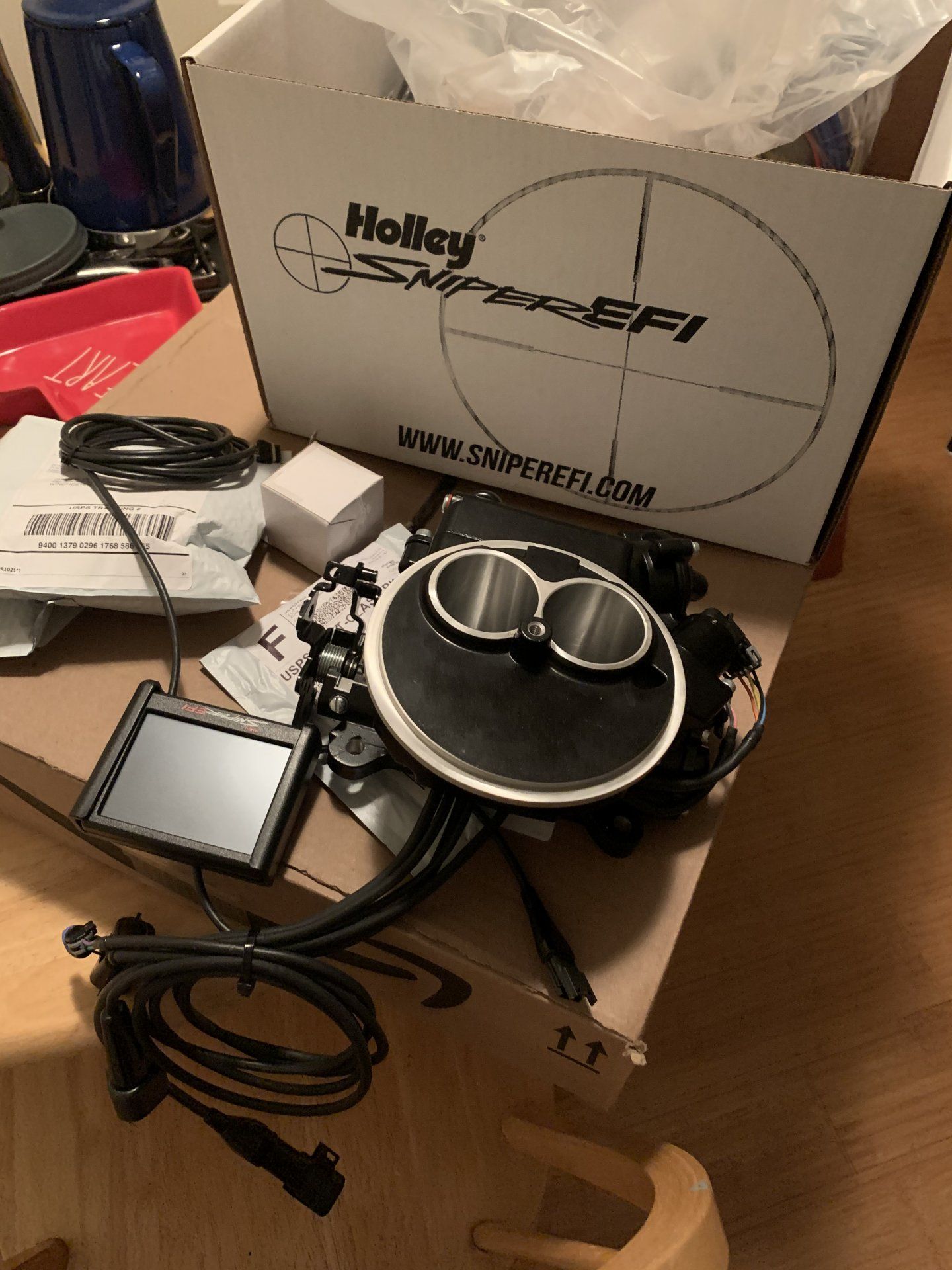

Sniper EFI!
It’s ordered a 2300 unit but they are on back order. So I’m collecting hose, AN fittings, electric pump, and adapter. I’m using a surge tank for my electric pump to start. I will end up putting it in my tank but just can’t pull the trigger and drill out my original tank.
In the meantime I’m fixing my daughter’s new used car.
Sniper is here. Time to get my daughters car out of the garage and the cruiser in!

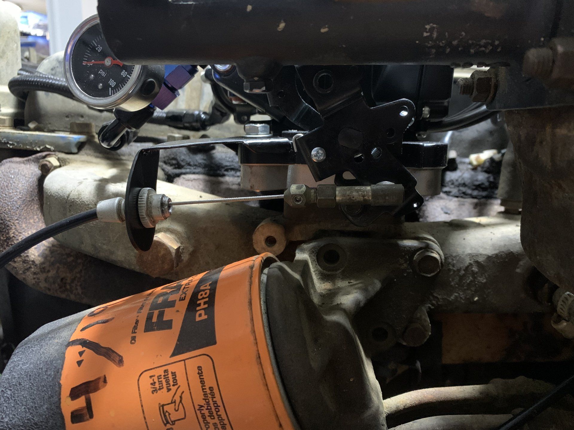

Got the throttle linkage and cable sorted out. Started to get the surge tank mount and fuel lines figured out.

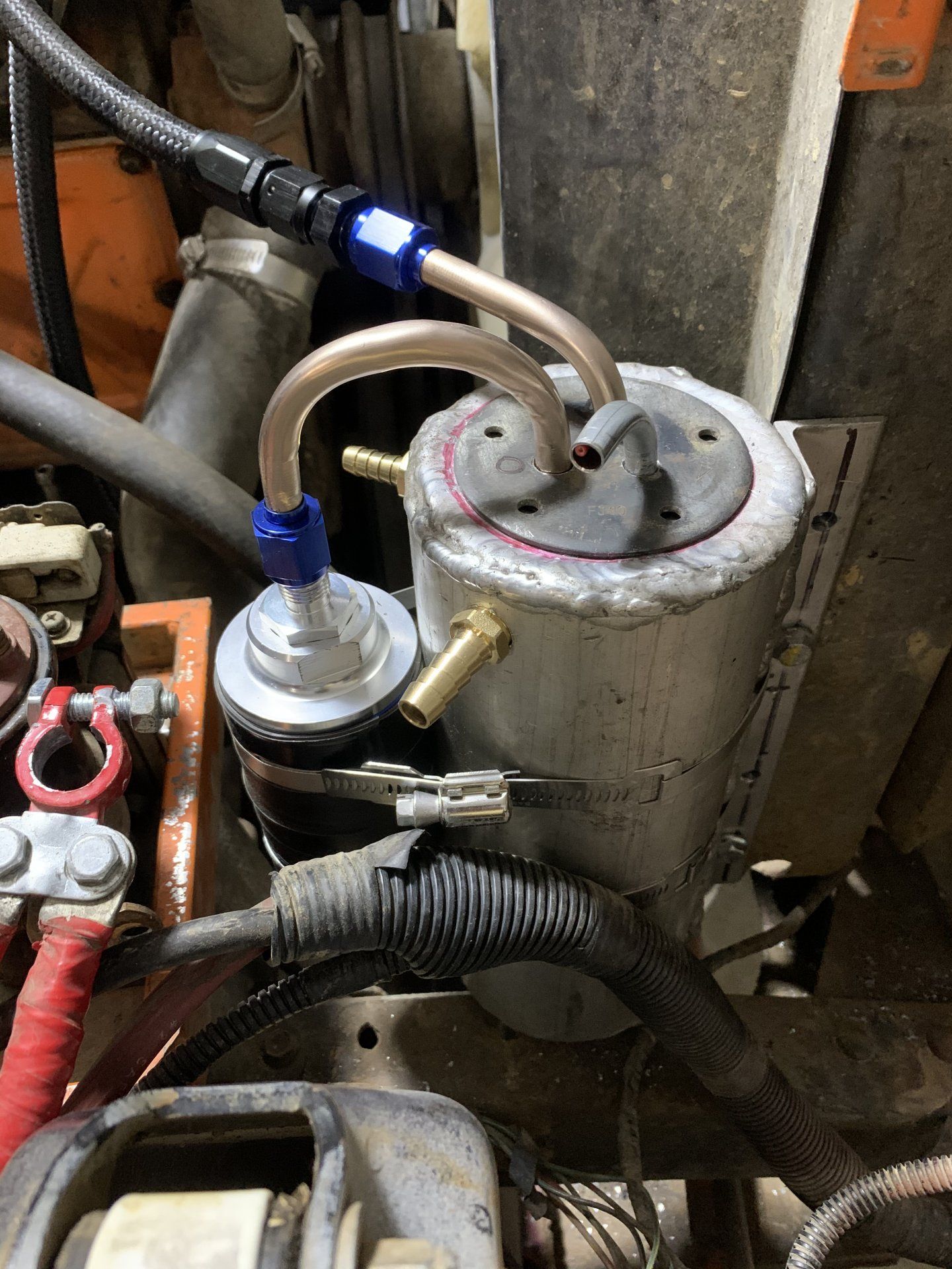

here is a pick of my home brewed surge tank

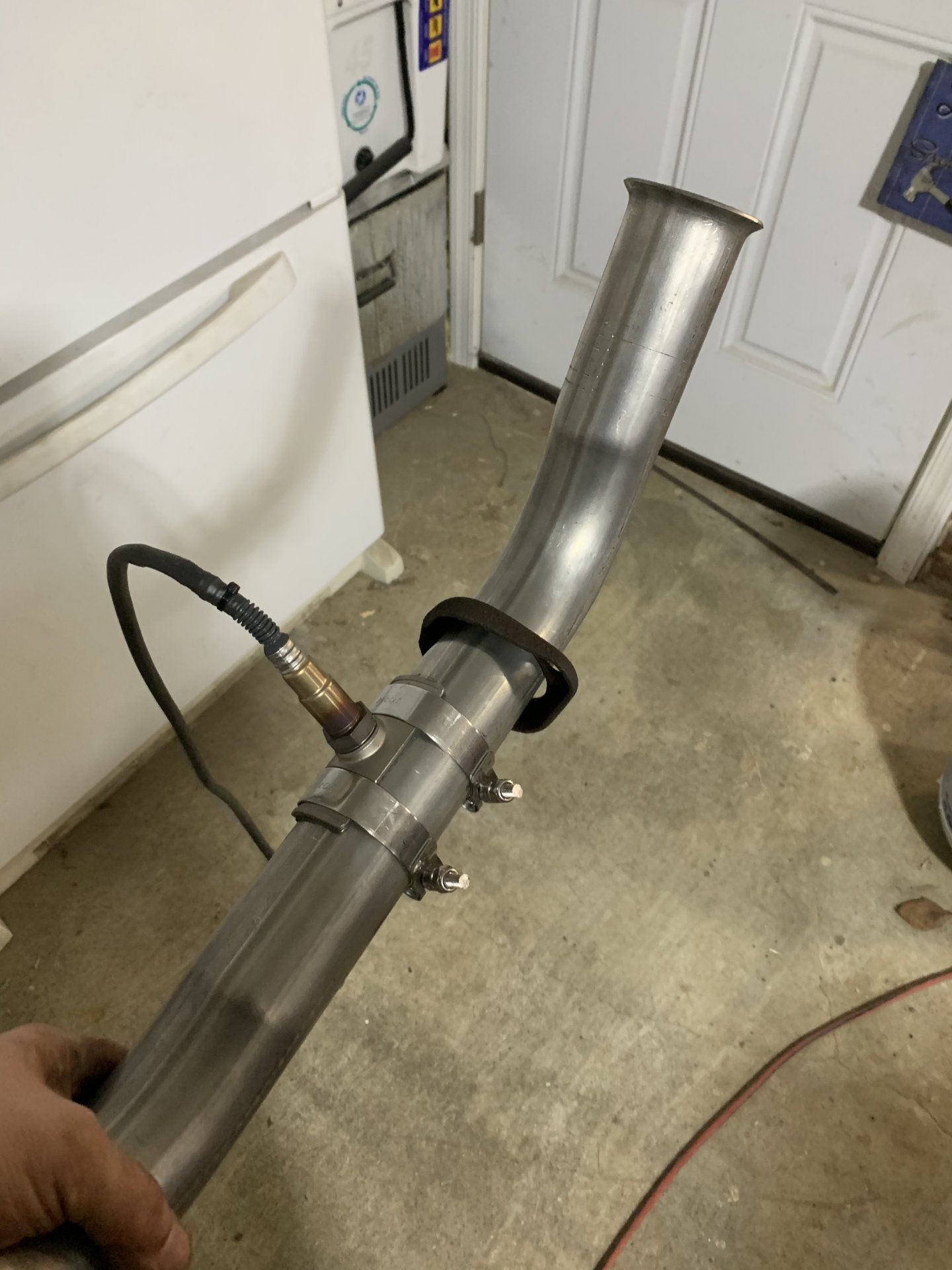

Here is a pick of the new head pipe with O2 clamped on.

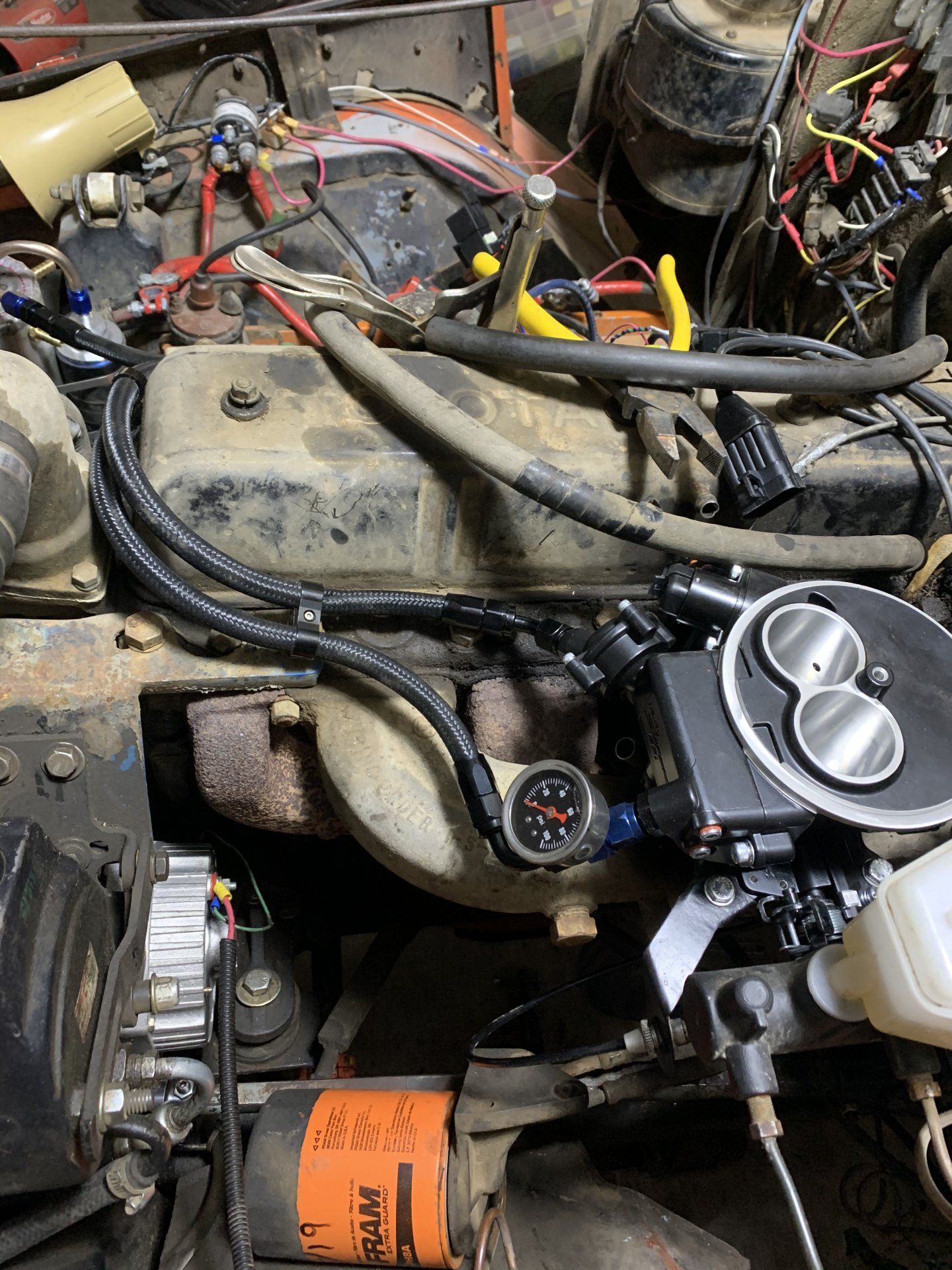

Here is a pick of fuel line run from the surge tank to the Sniper.

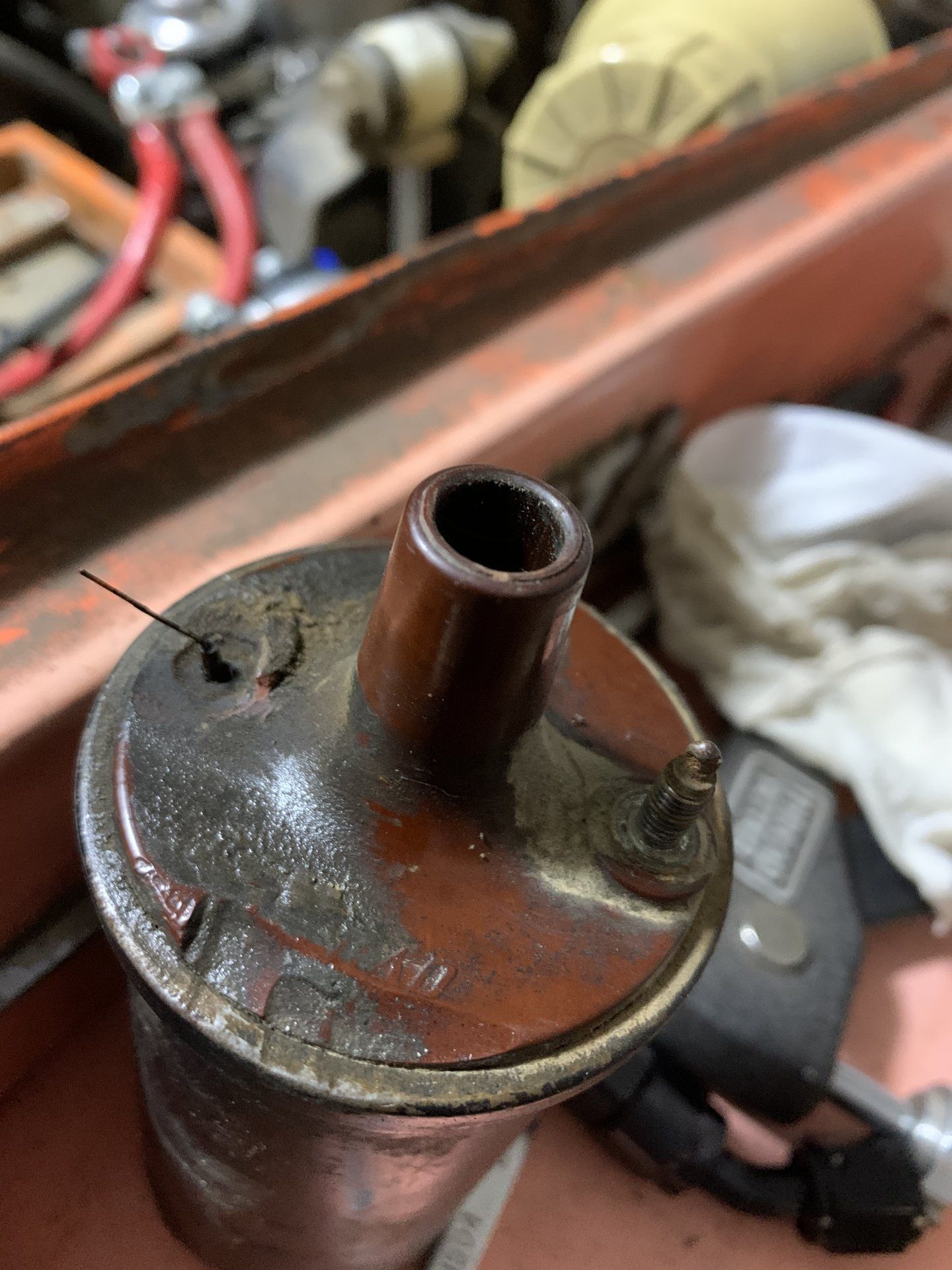

I think I found my problem with running like crap then running good!
